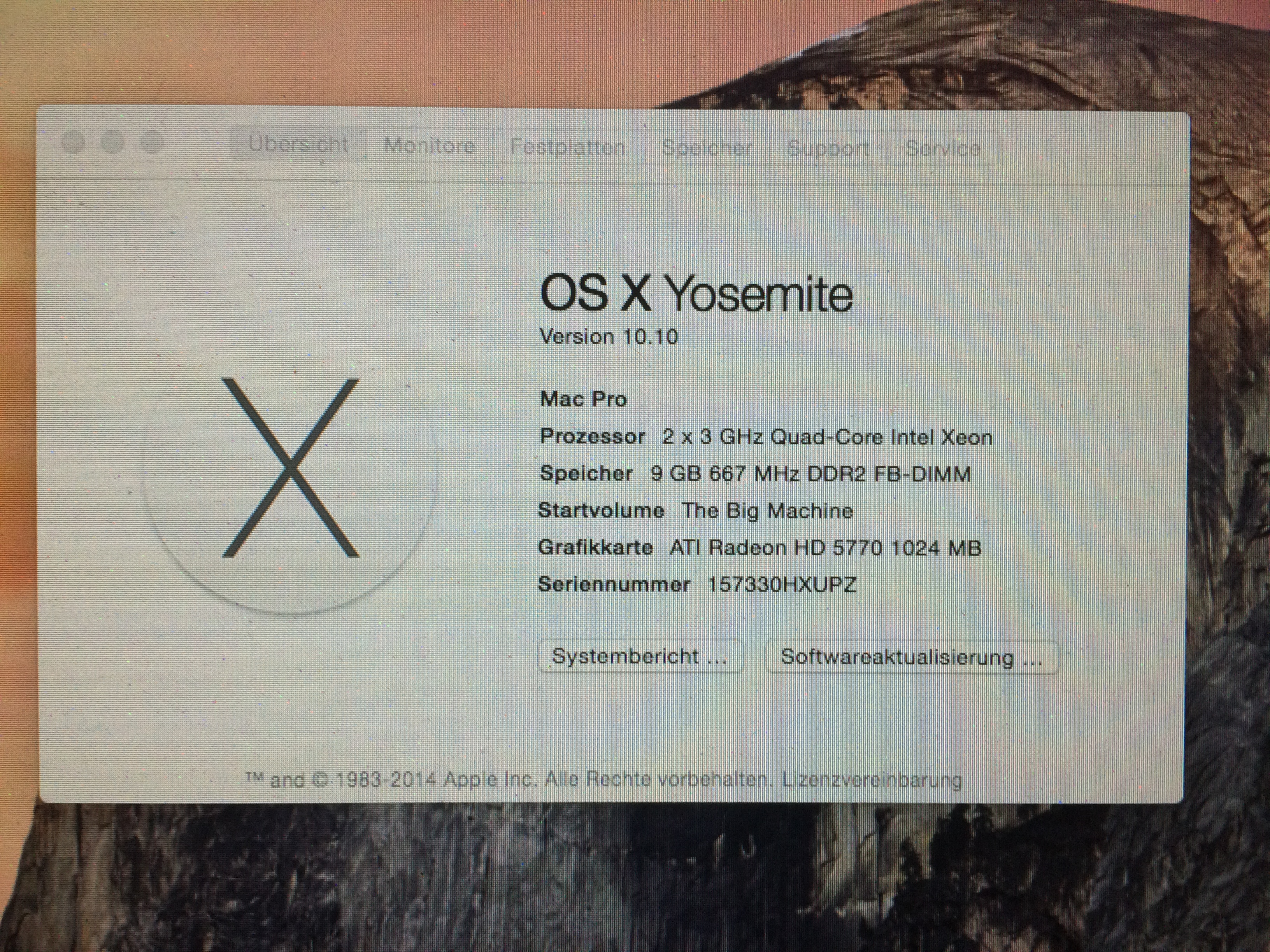

Thanks to the SFOTT Beta I now run OS X Yosemite on my MacPro 2,1!
Yep, installed the official Public Release with the SFOTT Beta.
That thing is truly fool proof. Even I had no problem whatsoever.
No manual handling of efi files or putting machine IDs with wrong quotes anywhere. The SFOTT does everything for you. I just followed this and that's it:
https://forums.macrumors.com/threads/1802986/
THANKS SO MUCH to EVERYONE involved!!! Most of all the SFOTT guy, Tiamo & Pike!

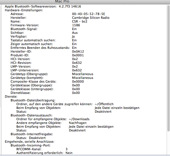

Hi guys,
thanks to all of you who made this possible!
I'm not (yet) on Yosemite, but installed Mavericks on the MacPro 1.1.
I will try it on another disk and report back.
So far everything is working but not:
-iMessage (have to contact Apple)
-Bluetooth (here I have to say, I don't have the Bluetooth board but USB-adapters, and strangely I can't disable Bluetooth, nor I can add devices.
Bluetooth is recognized for both adapters (1.1 und 3.0).
Does one have an idea?
Othewise I will try to get the Apple Bluetooth board on eBay.
Thanks again for making this possible.
Best,
yassi
