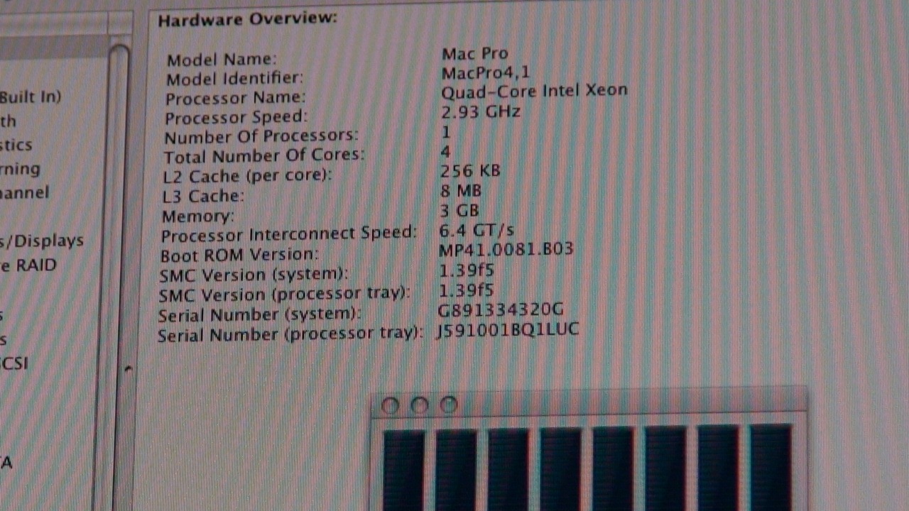

here's a pic with 1 of my 2.93's installed. 2nd socket is empty. notice the QPI 6.4 GT/s (QPI stands for QuickPath Interconnect). the 2.26 GPI is 5.8 GT/s.

Geez... Look at the size of the L3 and L2 cache... No wonder they beat the old procs clock for clock... wow!
What does GT stand for again?
