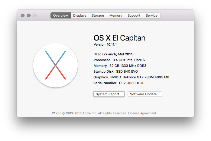

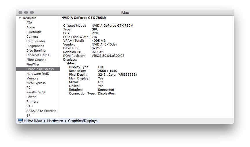

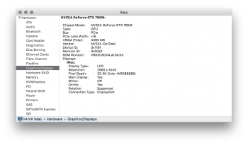

Hi, are you still using this? Could you do a screenshot of the Graphics page of System Profiler? I am curious if it is device id of 119f. Also if you ram shows up as 4095 or 4096.
I succeed too. No startup screen and no brightness control as expected.🙂
Dell 780m 4gb, device id 10DE-119F.

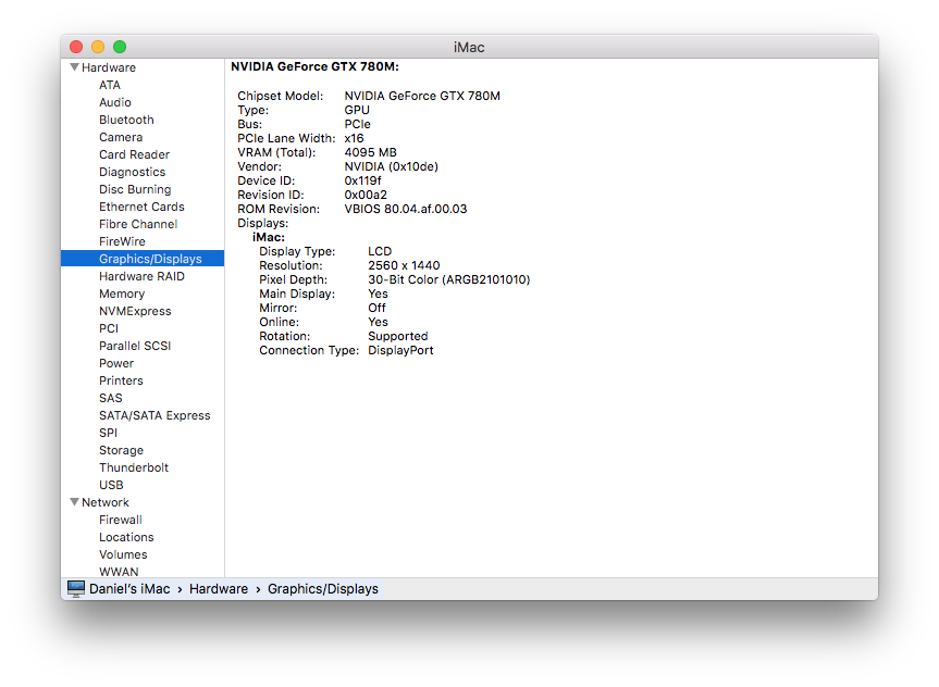

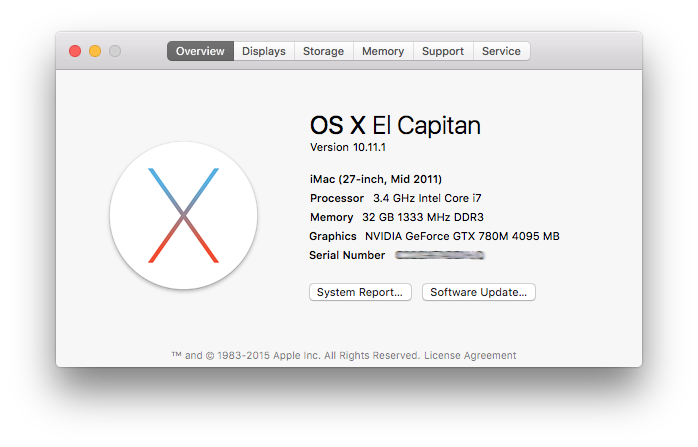

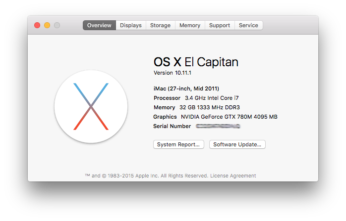

Yup still using it. Previously on ElCap 10.11 the RAM shows 4096MB but after 10.11.1 updates it shows 4095MB instead with device id of 0x119f.

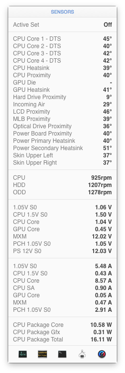

How is it going with temps? Are your fans loud? I believe the 780M runs cooler than 395X (for example) but not sure how it performs in your iMacs chassis.
Here's my system temps and fans (idle mode)

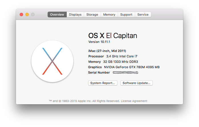

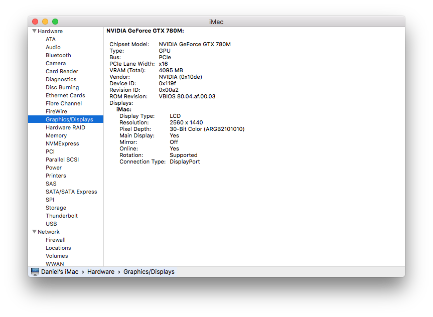

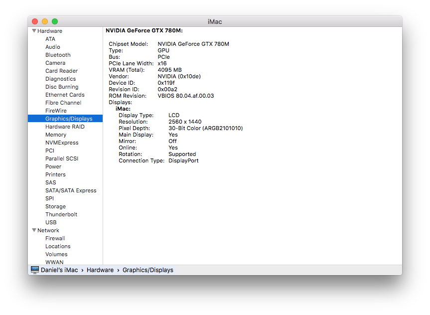

Hi, I just registered to thank all people in here helping, especially mhafeez and MacVidCards.
The card I got was the GTX 780M for Alienware, as expected no boot screen and no brightness control, but it worked without installing any Nvidia Web Drivers, no need to access OSX through screen sharing at first. The first, second and fourth diagnostic leds were on. Also, the System Profiler was showing 4096 MB VRAM on OSX El Capitan v.10.11.1.
After that, I got into my Windows system using Remote Desktop because the display was not showing anything, and installed the Nvidia Drivers for windows; but everything went wrong after that, I lost the display for OSX as well and was not able to get into OSX using screen sharing, neither Windows. Only the first and second diagnostics were on.
I knew that the system was booting because I had access to my files in OSX. I reinstalled the old AMD video card, enable the ssh access, reinstalled the Nvidia card and get into OSX using ssh and installed the Nvidia Web Drivers.
Right now, my iMac is working well using the Nvidia Web Drivers, No Bootcamp and the system profile shows the same info as mhafeez.
Sorry, for my english, is not my first language.
Screen Shot 2015-11-28 at 11.29.55.pngScreen Shot 2015-11-28 at 11.30.08.png

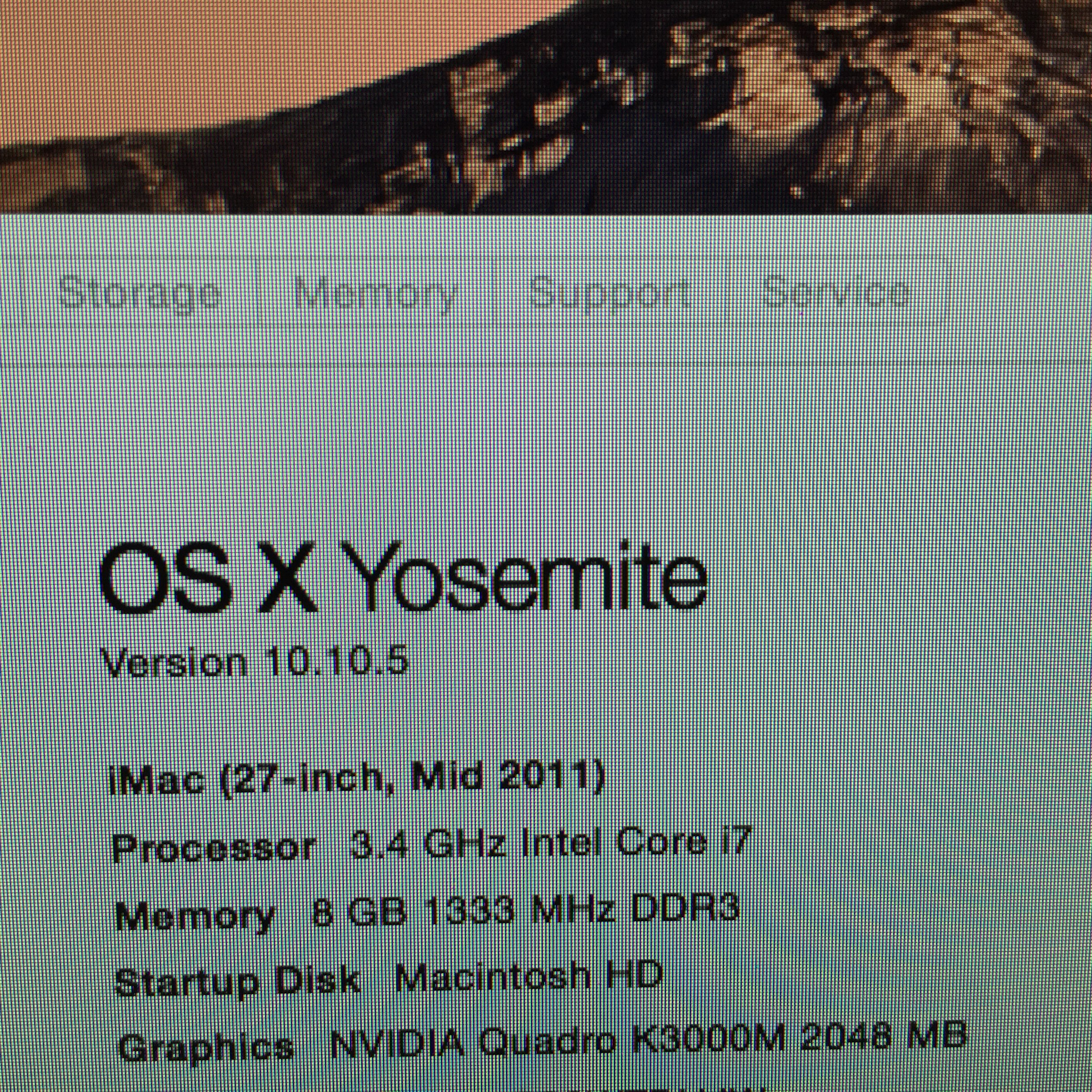

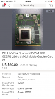

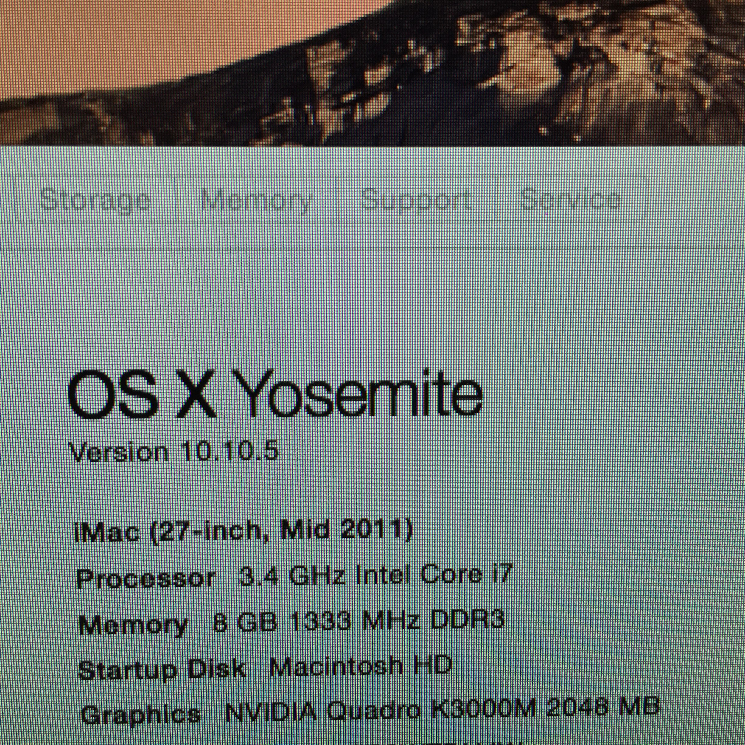

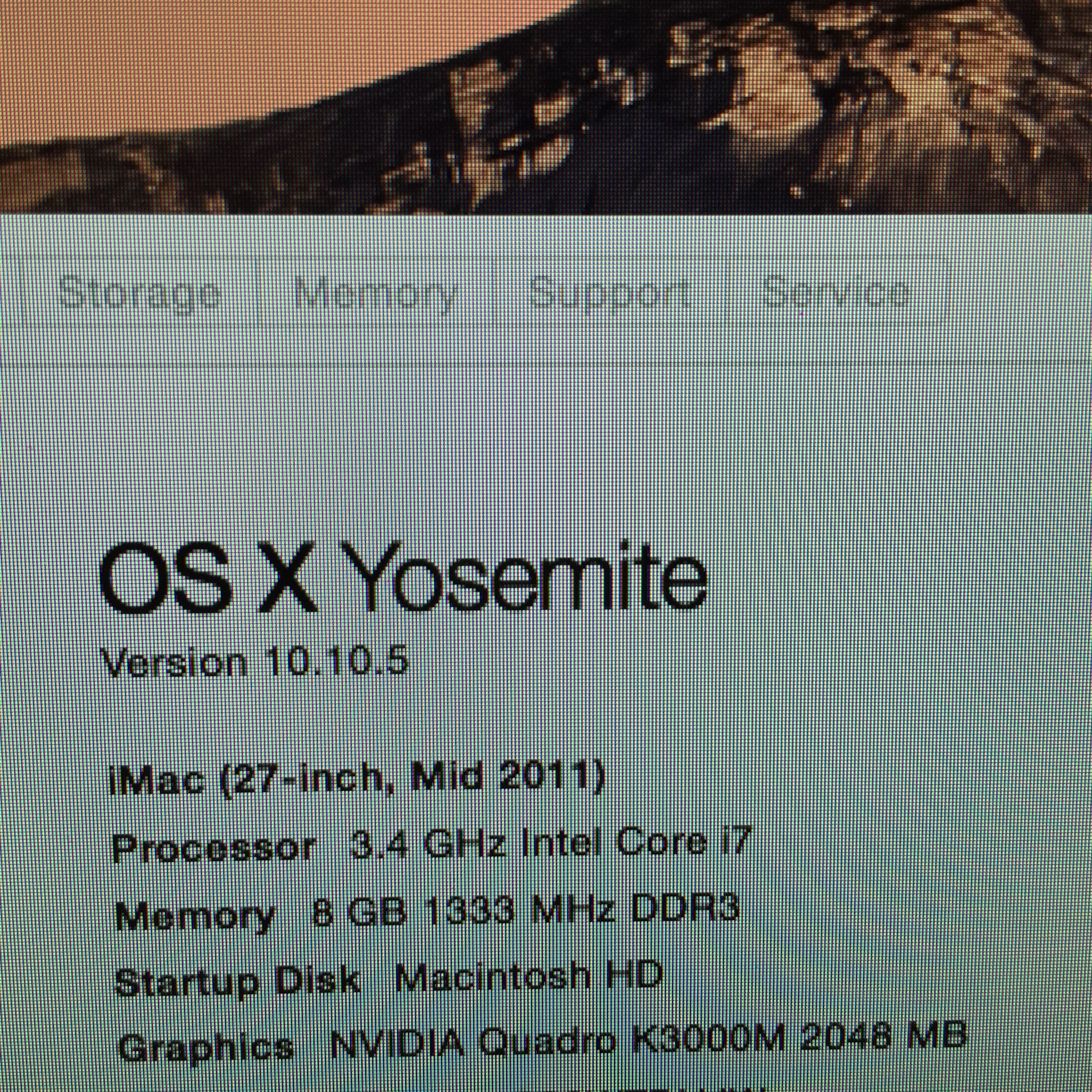

Alright guys so I got no help from this forum and I have to say this: I got a cheaper card working in Yosemite and it's a DDR5 MXM-A video card. It's the Dell Quadro K3000M 2GB DDR5 vRAM that I picked up for $50 on eBay. It works perfectly, no additional drivers needed (web drivers might make it more badass cuz it's the Quadro Series) and it's solid! Installation was standard and I need to put a bit more thermal paste before I run games on this bad boy but other than that, she's solid. Thanks for no help but I'll help everyone with that i can.
Reactions: Climber_FX
very interesting. few questions?
was it as simple as just opening the mac, taking out the 6970m and sticking in the new one?
would it then be easy to put back the 6970m?
was it easy to do? any difficulties?
does it work in bootcamp?
was it just random or did you choose that card for a reason?
how much of a difference does it give to games?
