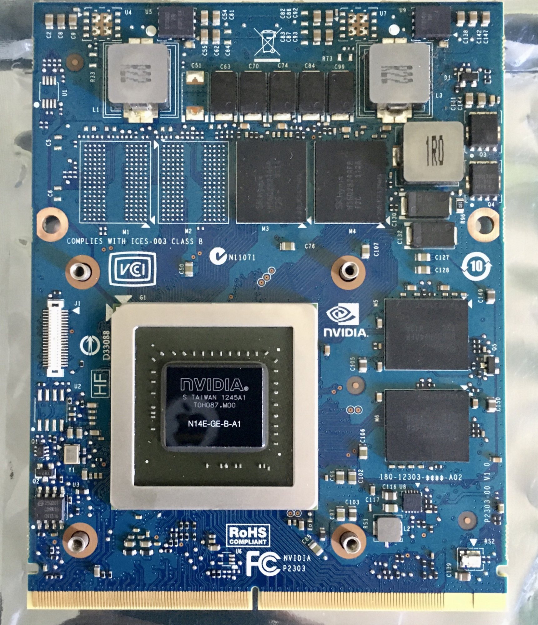

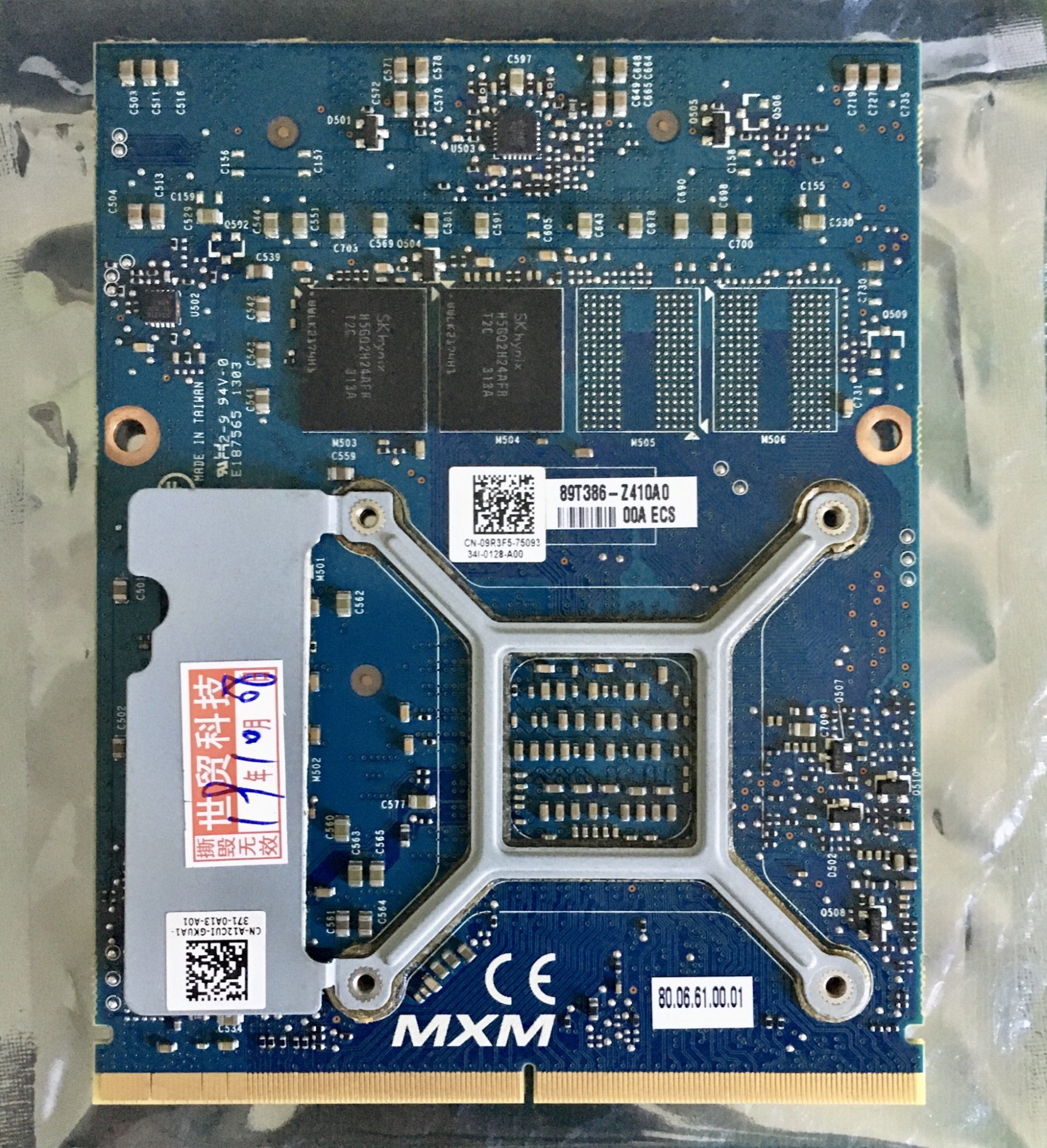

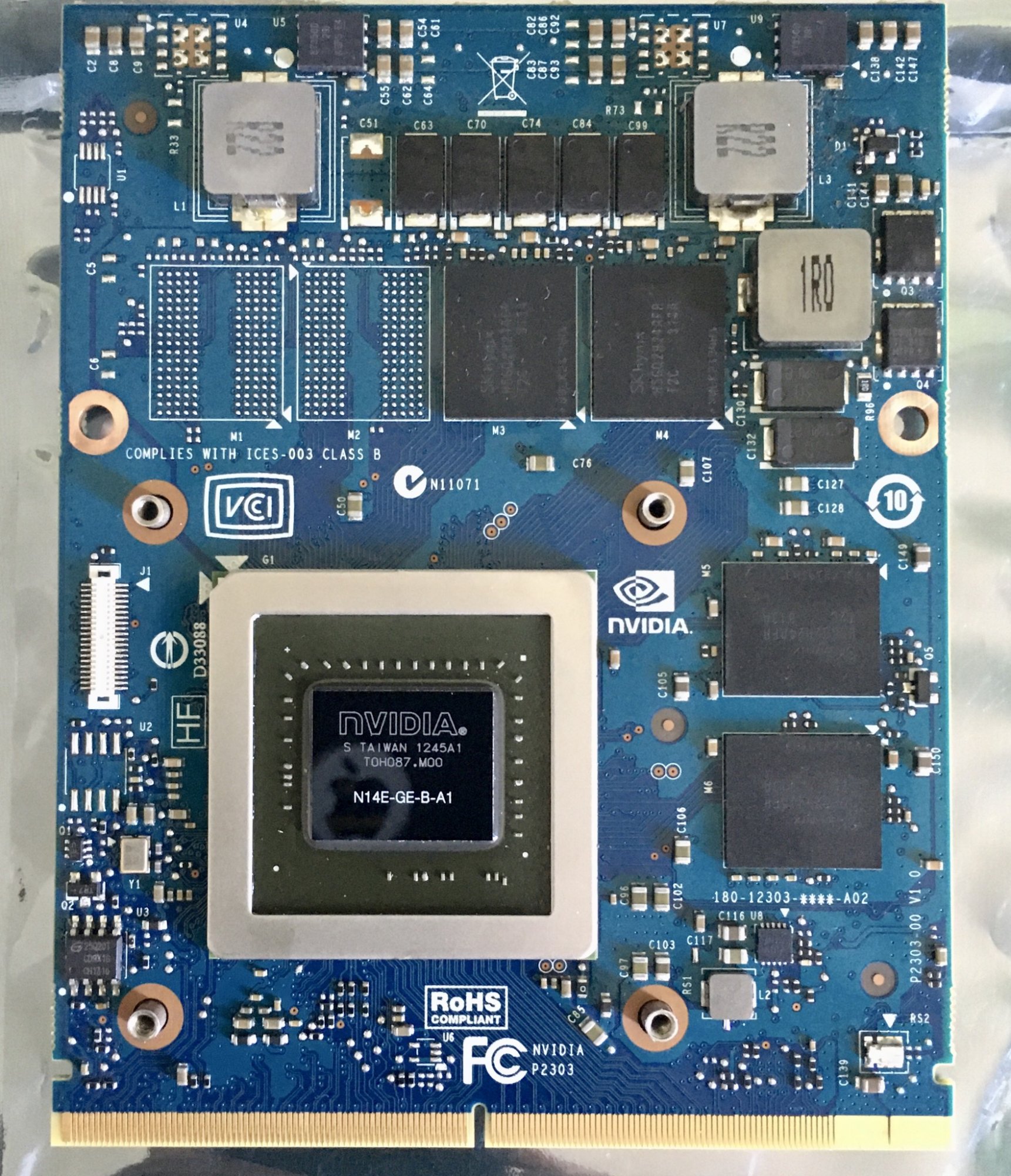

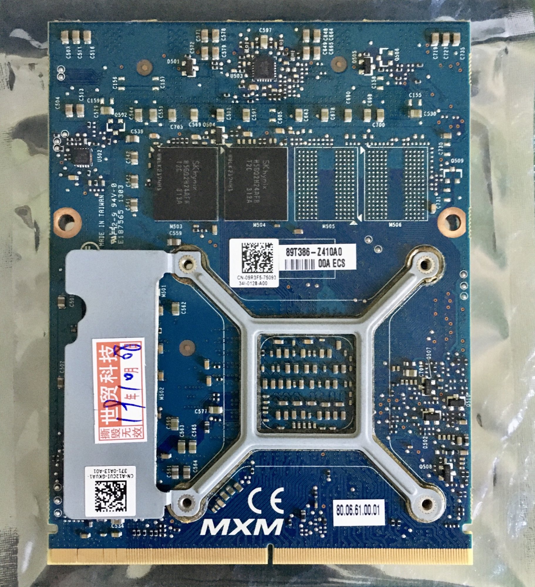

Hello everyone! I hope someone help me! I installed the Dell/Alienware GTX765m video card in my imac 27” model year 2011, but I got only black screen, no startup sound. I thought that with this card the system started up without the bootscreen, but I was wrong. Do you have any suggestions? the current system is High Sierra 10.13.6. please help me, thanks!

At present, there is no boot screen mod applicable to the GTX 860M. The only reason to flash the card would be for no display, indicating it is likely running incompatible vBIOS. IF your 860M is working, then you are all good.
Thank you for the sobering answer... maybe there will be a solution in the future...

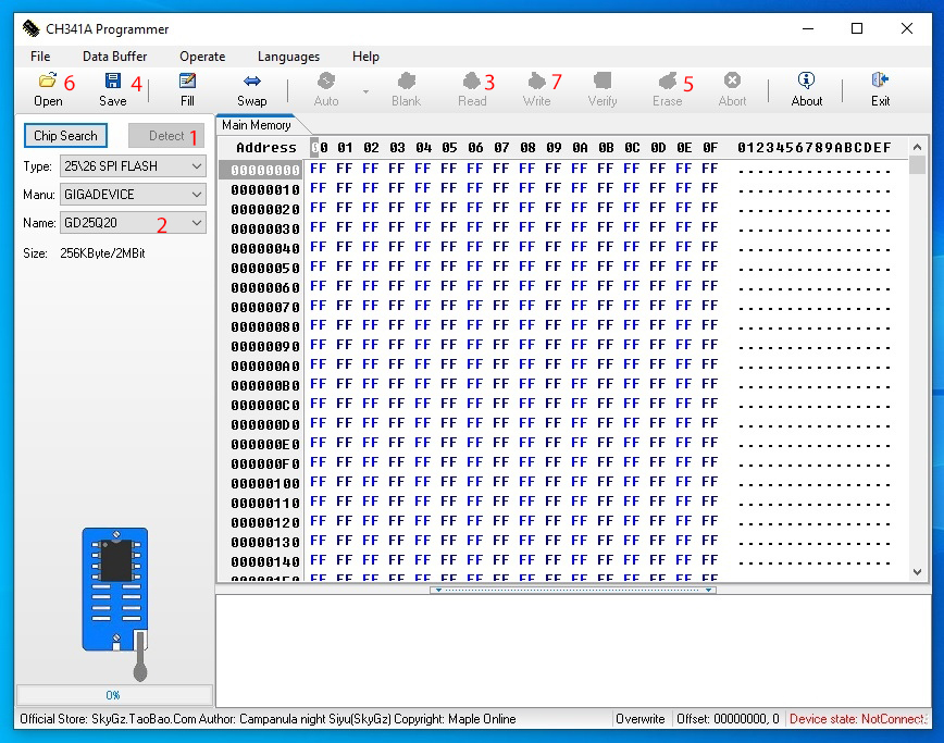

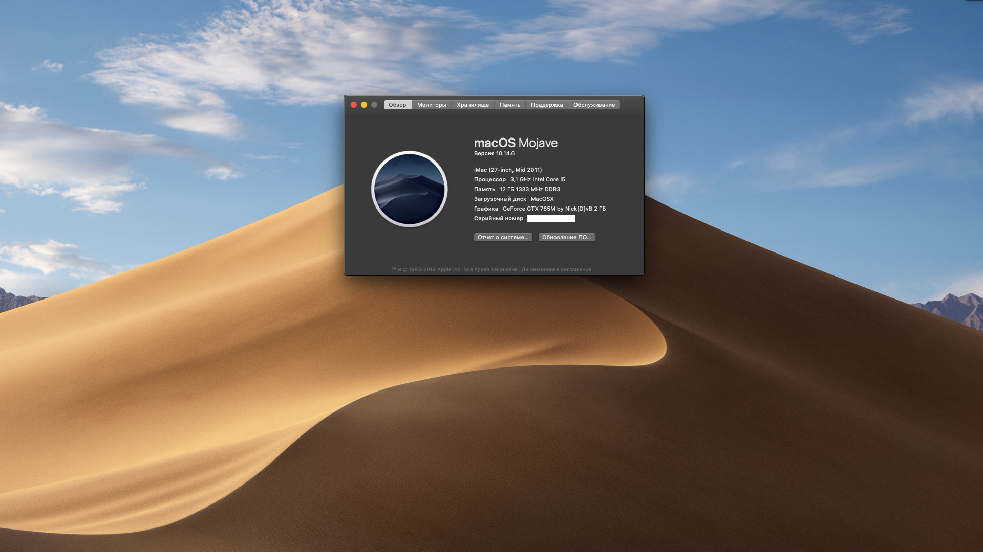

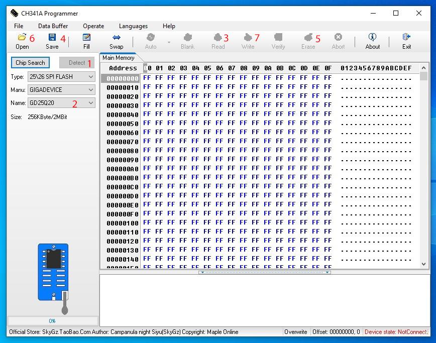

Yes, I did it!) Finally, I waited for the programmer and updated the new Kepler Beta3 BIOS from Nick [D] vB. Thanks bro for doing such an excellent job!
How did I do it:
I disassembled the iMac, took out the motherboard from it and then the video card.
I took a Windows laptop from a friend, installed the ch341a programmer 1.34 software and drivers for it.
I connected the clipper to the BIOS chip and stuck it in the USB port, opened the ch341a programmer 1.34 software, selected 1- Detected, 2- Selected the exact chip model, 3- Read, 4- Save (dump BIOS, just in case), 5- Erase, 6 - Chose the bios of Nick; 7- Write
Done!
Assembled iMac, everything is ready.
