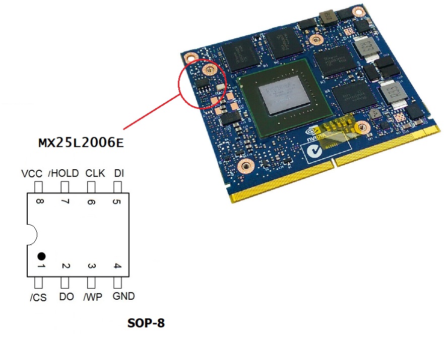

still struggling with a K2100M, I'm trying to flash it with no success - I've measured vcc-and across the W25X20 - and I get nothing, is that normal?
How are other people flashing this board?

@markfoody
- I used a CH341a Black edition program, they already solved the 5v vs. 3v problem long ago with this newer edition. It should output about 3.3v to read this chip. You can measure pin 8 and pin 4 to verify you are getting 3.3V.
- I used a SOIC-8 pin clip (best to use Pomona 5250)
- I used Ubuntu with flashrom version 1.1 on a separate laptop
- Make sure the red wire of the clips is on pin 1 of the 'U2' chip
- Make sure you are on the 25SPI BIOS section of the programmer
- After a few tries, it should dump & write

@markfoody
Thanks for your answer - I have the black edition of the programmer, but I seemed to get 5v across the power pins .. I'll play about more this afternoon...
I think I'm going to give up !
I don't think I 'screwed up', but, at some point, perhaps, I've hit something, or broken something, or ....
But - the net result, on the K2100M card I have, I am unable to program the flash, using a ch341A.
As a test, I have taken my old AMD card, and read the rom on that, with no problem.
I've tested a little around the device - on the AMD card, as expected, there is no short from Vcc to GND... on the "new" card, - there is !!!!
I'd be very interested to hear other peoples advice, thoughts, etc - I've somehow hosed this card....
Some pages back in this post #4363 there has been a Linux Boot Stick solution announced. I used it yesterday on my already patched and installed iMac/K2100m just to check if the linux nvflash version would work on my already installed card. I could read the BIOS, but just half of it (131 ok 262KB), probably I used it not entirely correct :)
But I guess this may by your solution. From all what I saw you can do this also remotely, i.e. without having a working display on your iMac from a 2nd machine in your local network. Just follow the documentation in that post step by step.
I programmed 10 cards during the last three weeks with my cheap CH341A, sometimes you get no connection, sometimes it comes up with two BIOS chip definitions to choose from, but in the very end it worked.
