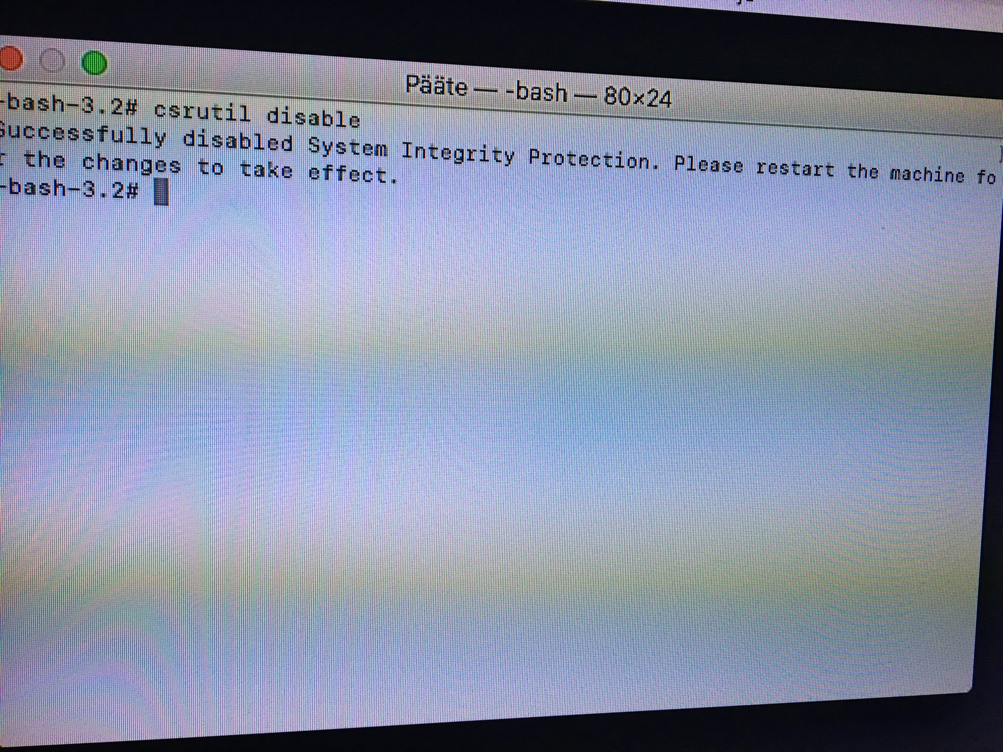

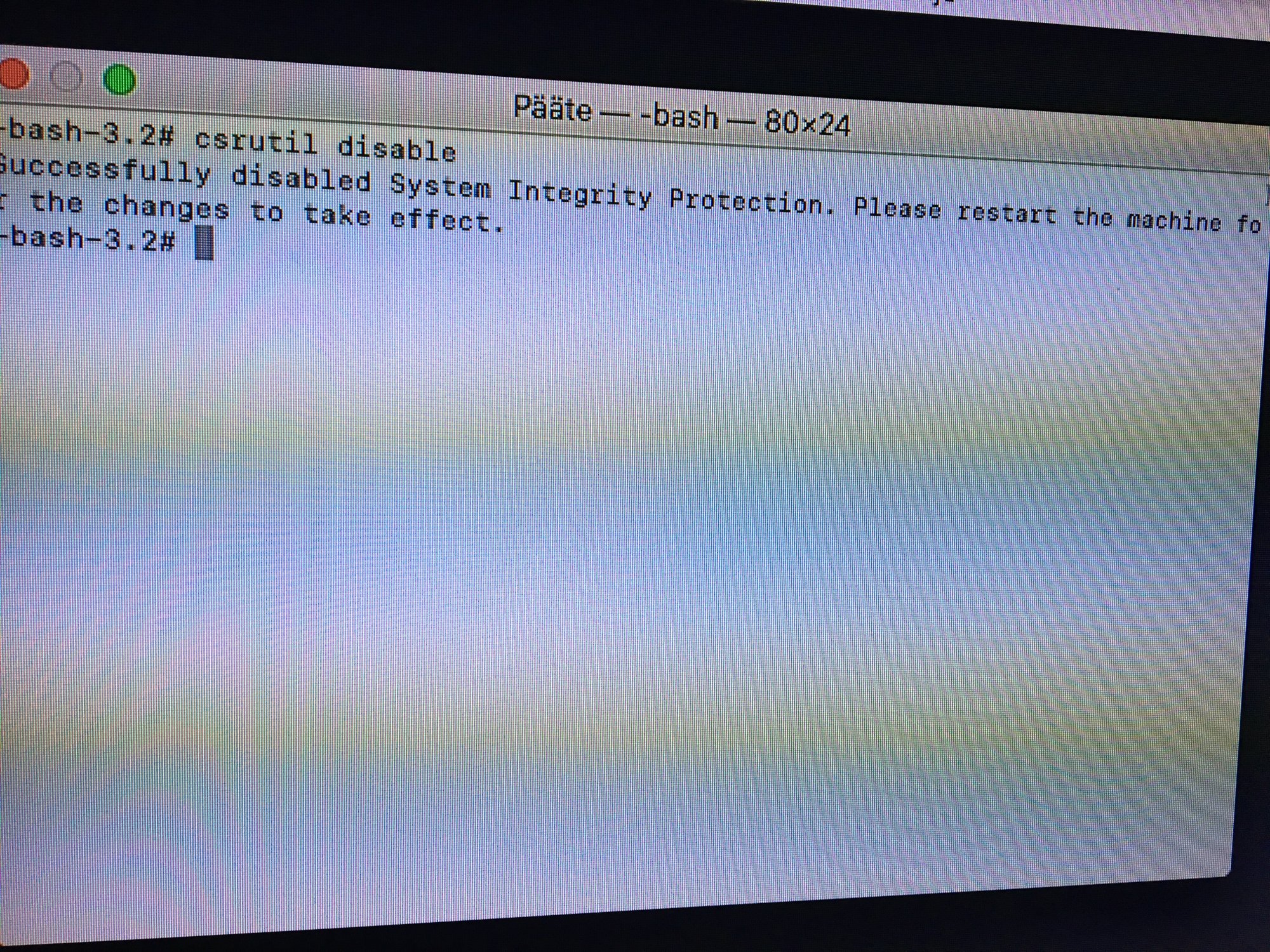

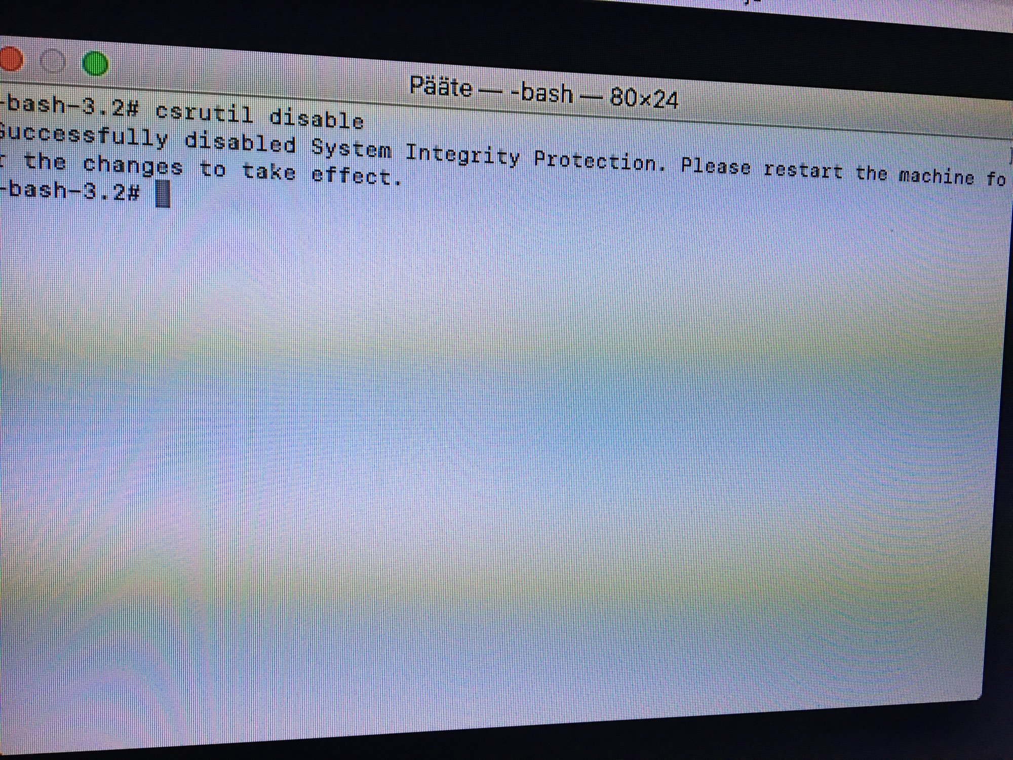

Ok. Now I noticed that I cannot disable SIP with new card on. Is that a problem? Command R is a blank screen. No secondary display.
With new GPU without Nick's Vbios mod you will not able to use Apple hotkey on boot.. So you can NOT use Command R to boot into recovery disk
what should you do to boot into recovery boot and disable SIP is via Terminal command

your mac will reboot to recovery disk.. Then using Terminal type

csrutil disable

This is one of the missing things: You will not see the die temperature because the bios does not deliver this. To survive the heat sink temperature will be enough especially with these small type A cards which barely draw power.
Code:
sudo nvram "recovery-boot-mode=unused" && sudo reboot recovery
Code:
csrutil disable
Ok. I got it to boot recovery mode but blank screen. Now I start to get this. This should also be done remotely because no picture again. Of course I could navigate blindly. But yes. Need the Remote Desktop etc. big work for me.. no. WhAt: it started to external as I wrote this. ****. It works: now I can write to terminal. Ok. Thank you. Wow. Now I get the SIP done =D

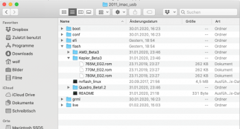

Here you see the content of the stick. It contains Nick's 780m ROM. In any case of doubt you may reload the ROM files from page one and do a binary comparison (diff command in terminal or calc hashes using shasum) or just replace the files on the stick. My value using Catalina shasum
Code:
wolf@WolfsiMac27 Kepler_Beta3 % shasum 780M_EG2.rom
6e76077efb27c0d4712747bf3a777044193edd4c  780M_EG2.rom
