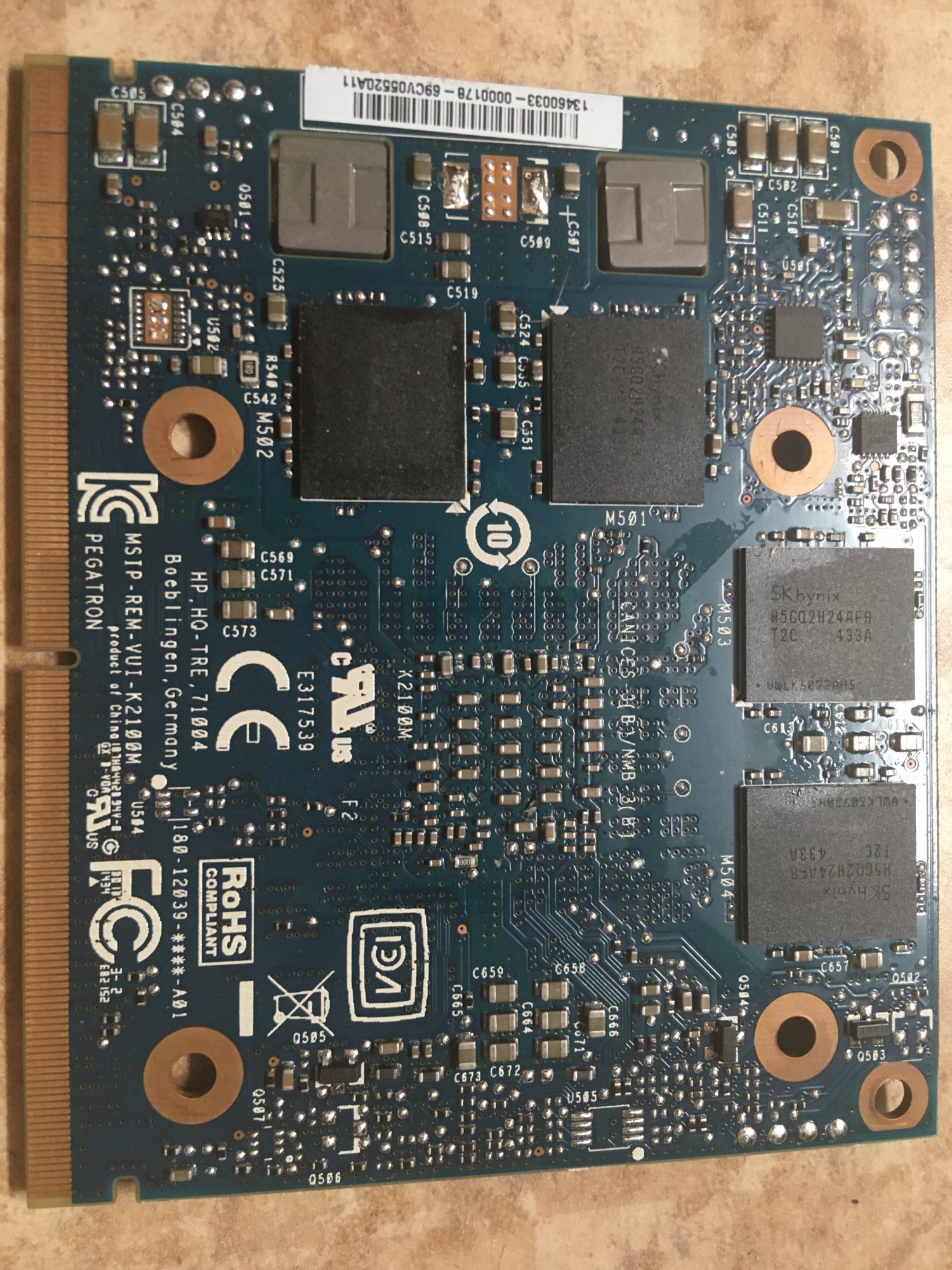

Do I understand correctly that the best option for the iMac 21.5 mid2011 (A1311) will be the NVIDIA Quadro K2100M?
Where do you recommend purchasing this card (taking into account the rational sending to Russia)?
Thanks! (sorry for my English)

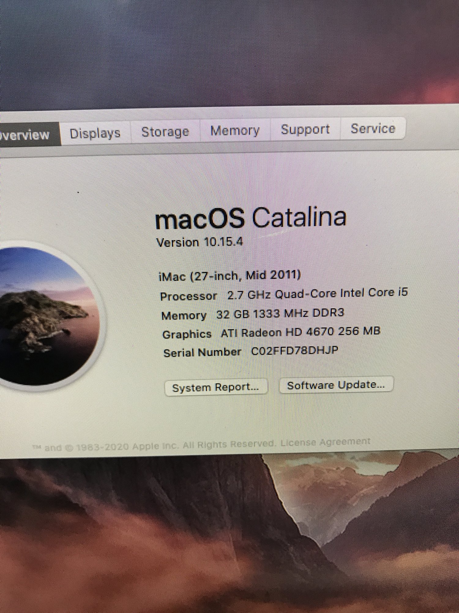

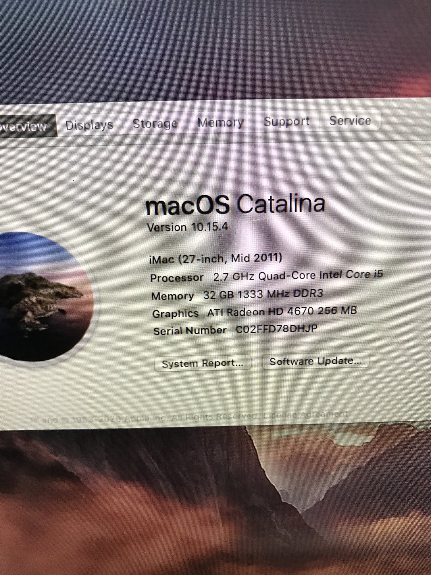

I am sure this is listed somewhere else in this long thread, but if you really don’t need a killer graphics and you want an oversized internet machine you can do like I did and add a 4670. I know they suck but they work.
I got a 27” 2011 from an internet auction for 350 and instead of doing a ton of modding I just paid 60 for a 4670 out of a 2010 21” model. After getting the parts in I had to swap the cards and redo the paste, but it runs Catalina just fine.
On my machine, I am using the stock 1tb drive and 32gb of sodimm I had on hand from my last 27” that I had to sell. I made sure and upgraded the firmware for APFS and went back and added the legacy graphics card patch ( normally you don’t use this and it works ok without it, but better with it).
so yea, I know the card is lowsy and barely cuts it with 256mb of ram, but it is a cheap option if no other exists. I actually happen to have a 780 (from way back when I did this about 150 pages ago), but I just want it to work. Plus it will instantly sell if I get broke again. People see Catalina and click buy, patched OS and all.

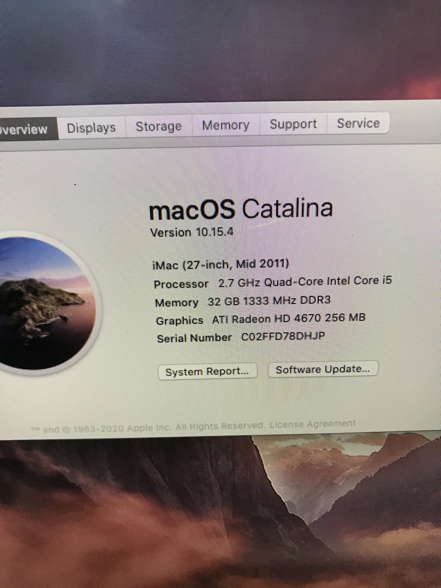

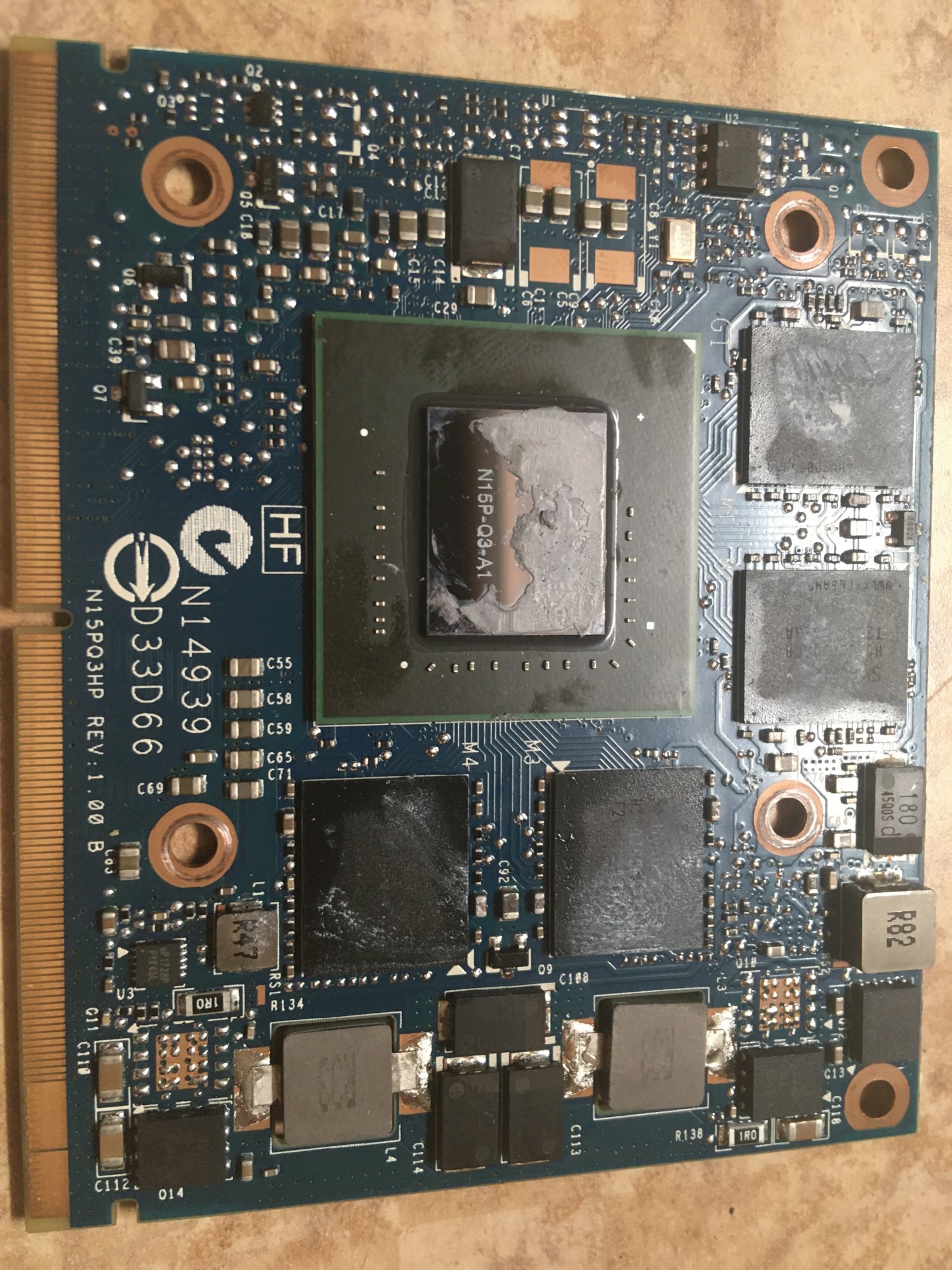

The consensus is that K1100m and K2100m have everything that work, provided you use OpenCore BootLoader. These two cards need to have the firmware updated. However, using the USB with Linux is pretty easy. A lot easier than replacing a graphics card on these iMacs.
Reactions: 0607557

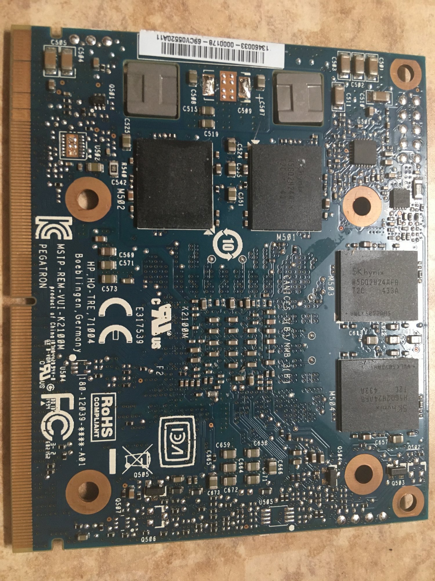

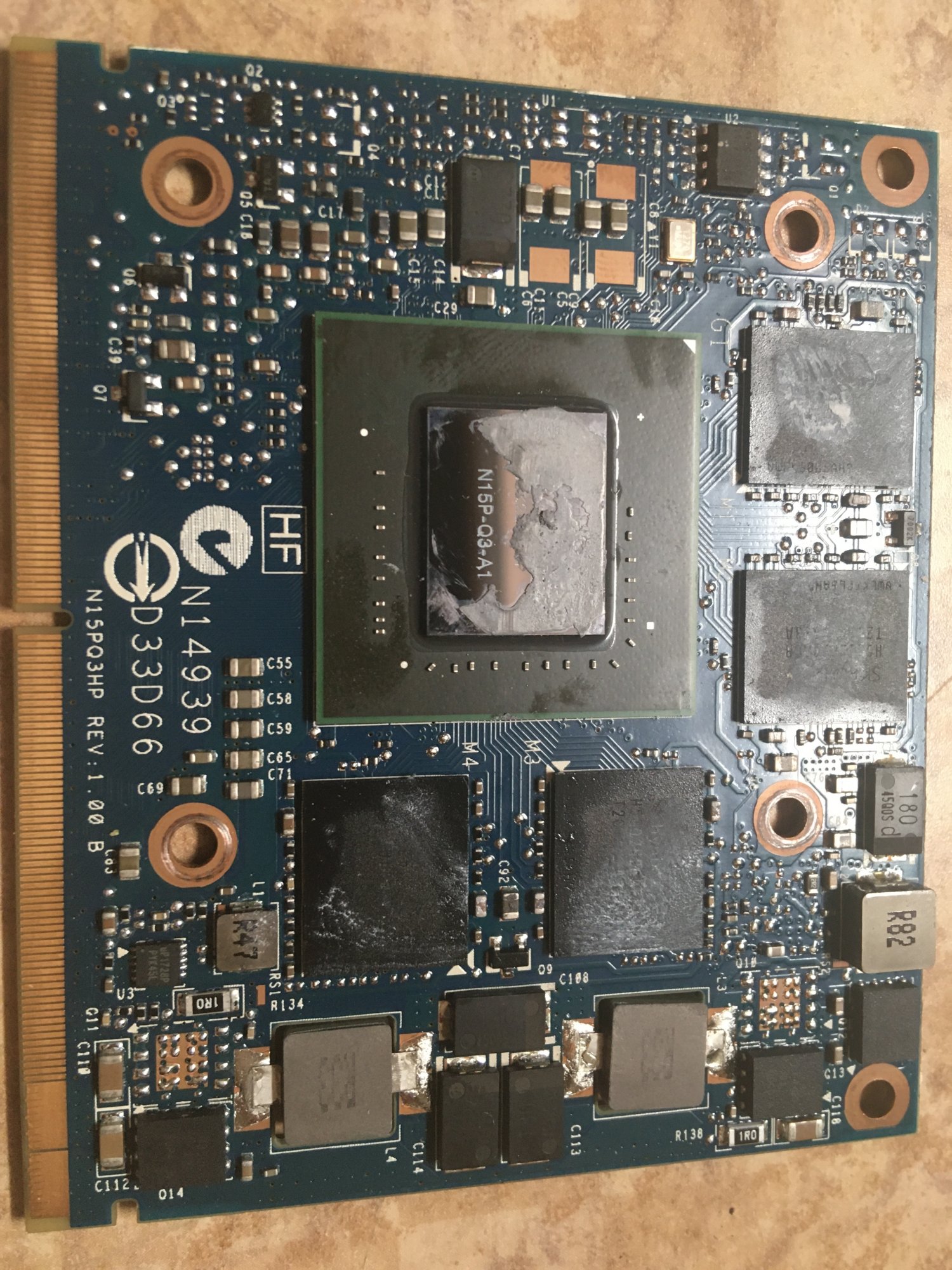

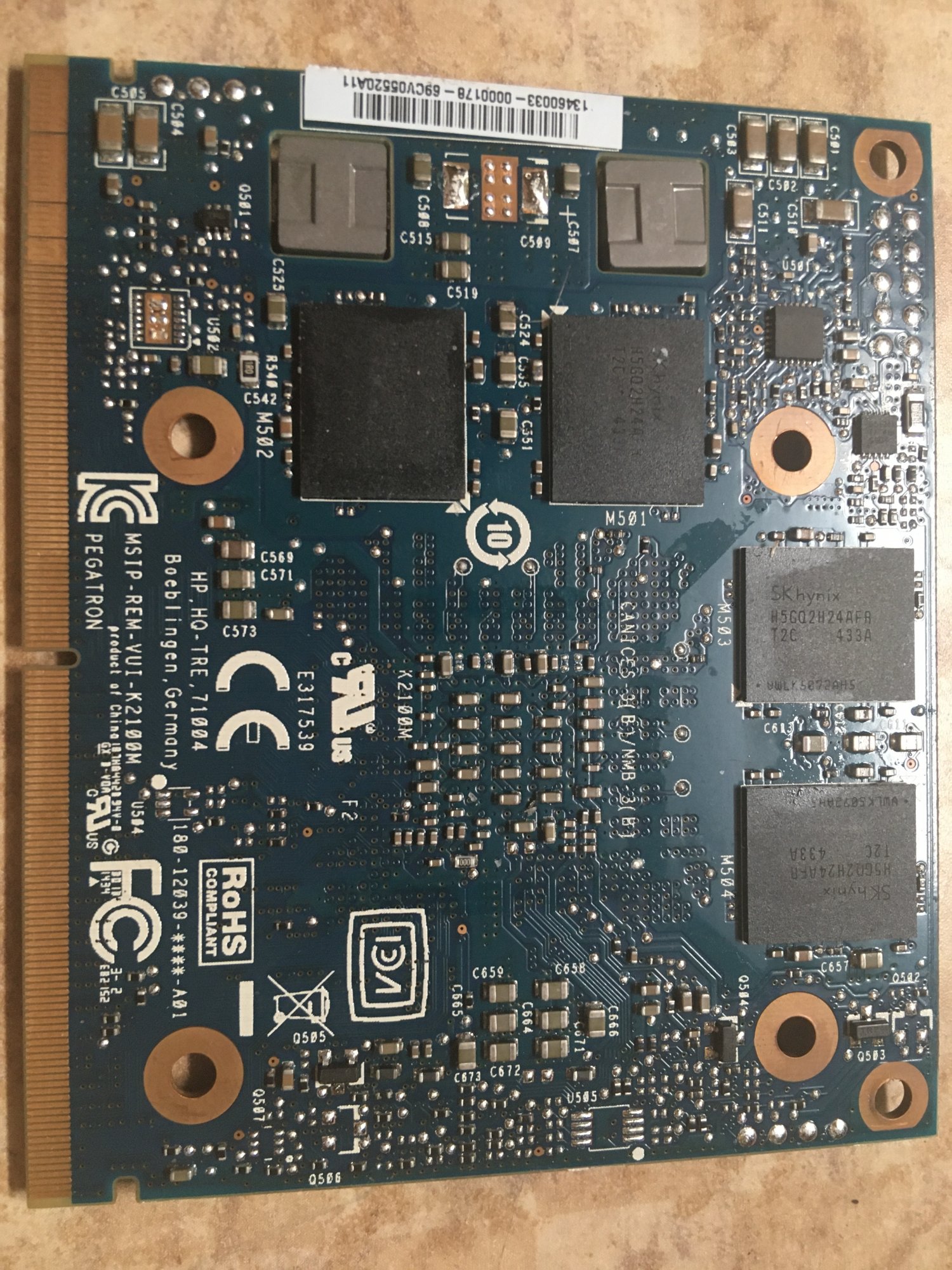

Yes, I know it's a K2110M from the code—if we bought from the same place on eBay (Asendtech I think it was), I have no idea why you receved a 660M and not the K2100M or why the flasher software thinks it's a 660M. I used a ch341a programmer with chip clip on a RPi 4 to do the flash and it was uneventful.
Yep... that is the identical card physically, same seller.

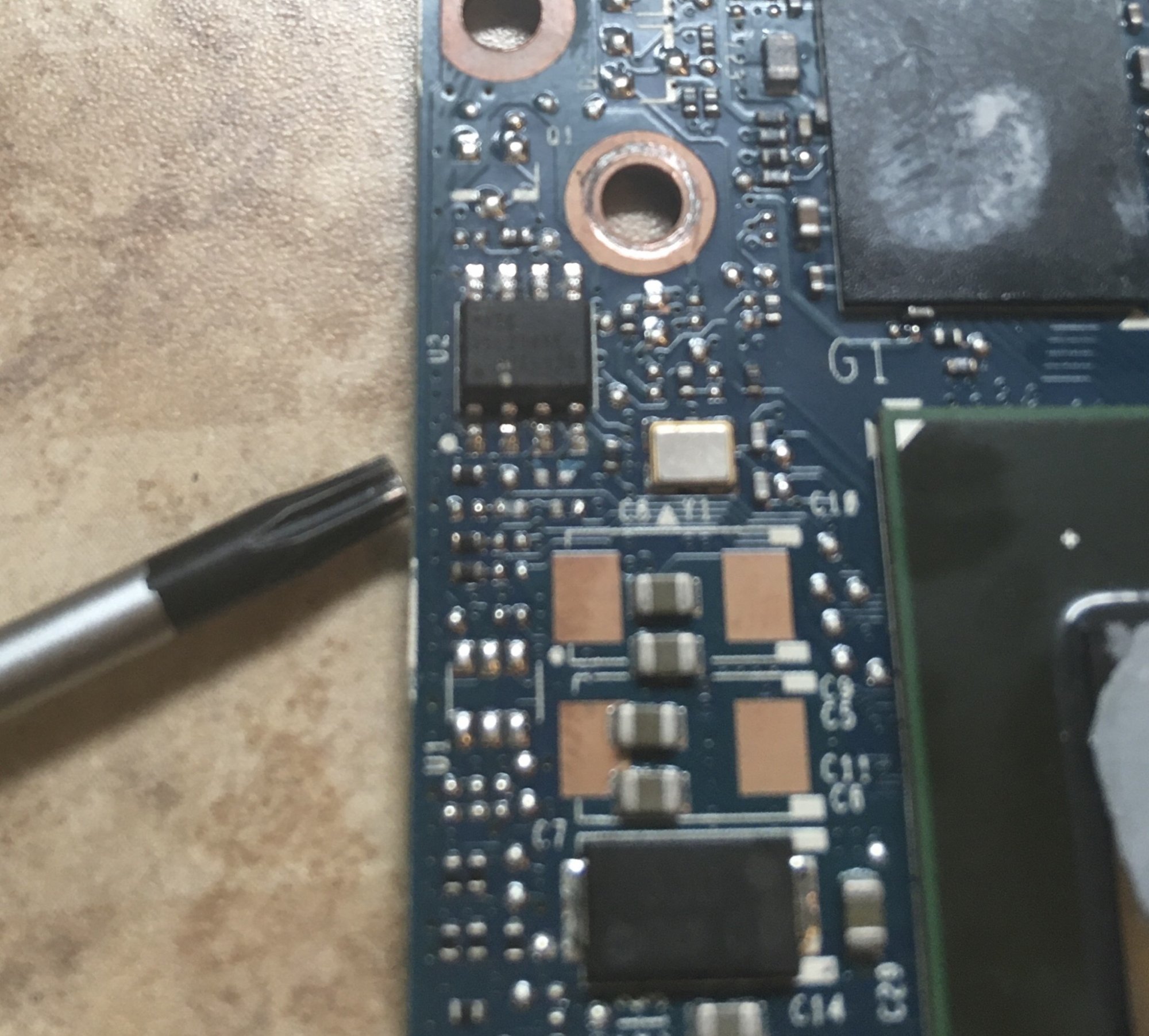

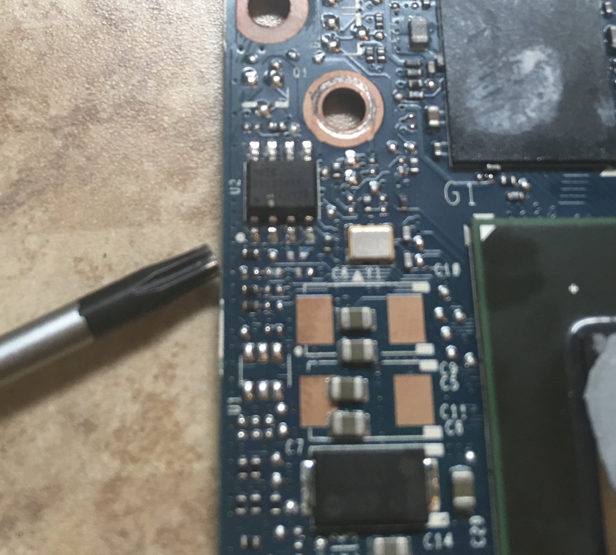

I am certain it is a K2100m but nvflash in Linux refuses to overwrite given the device ID mismatch. Someone must have been playing around with this card before me.

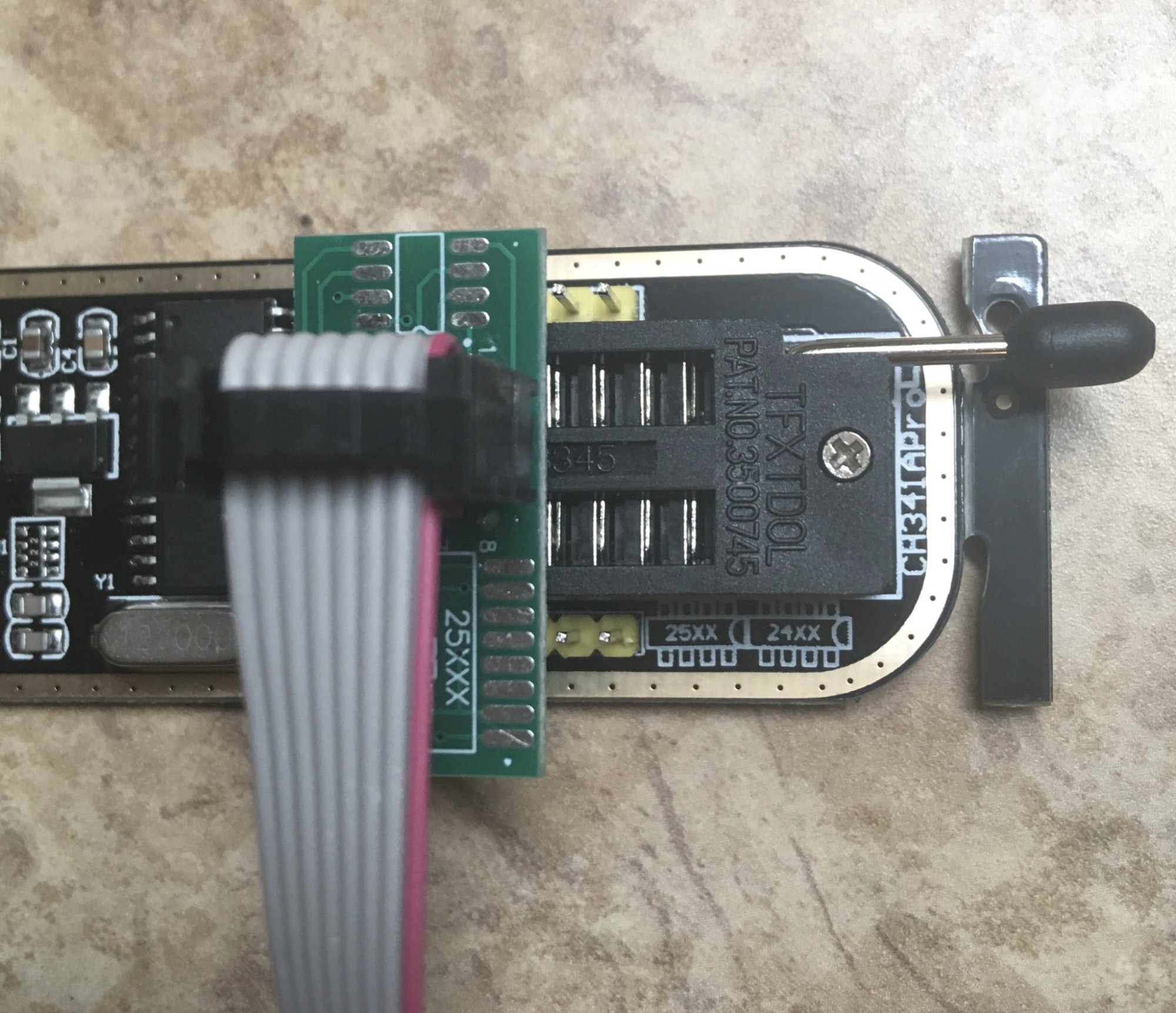

So I attempted to reflash with a programmer + clip, but the one I have was not making a solid connection. Looking at the construction of the one I got, I’m shocked it could work at all.
Next stop before removing the eeprom is flashing in Windows with a modified nvflash.
Anyway thanks for confirming. Will report back when I managed to get it flashed and working.

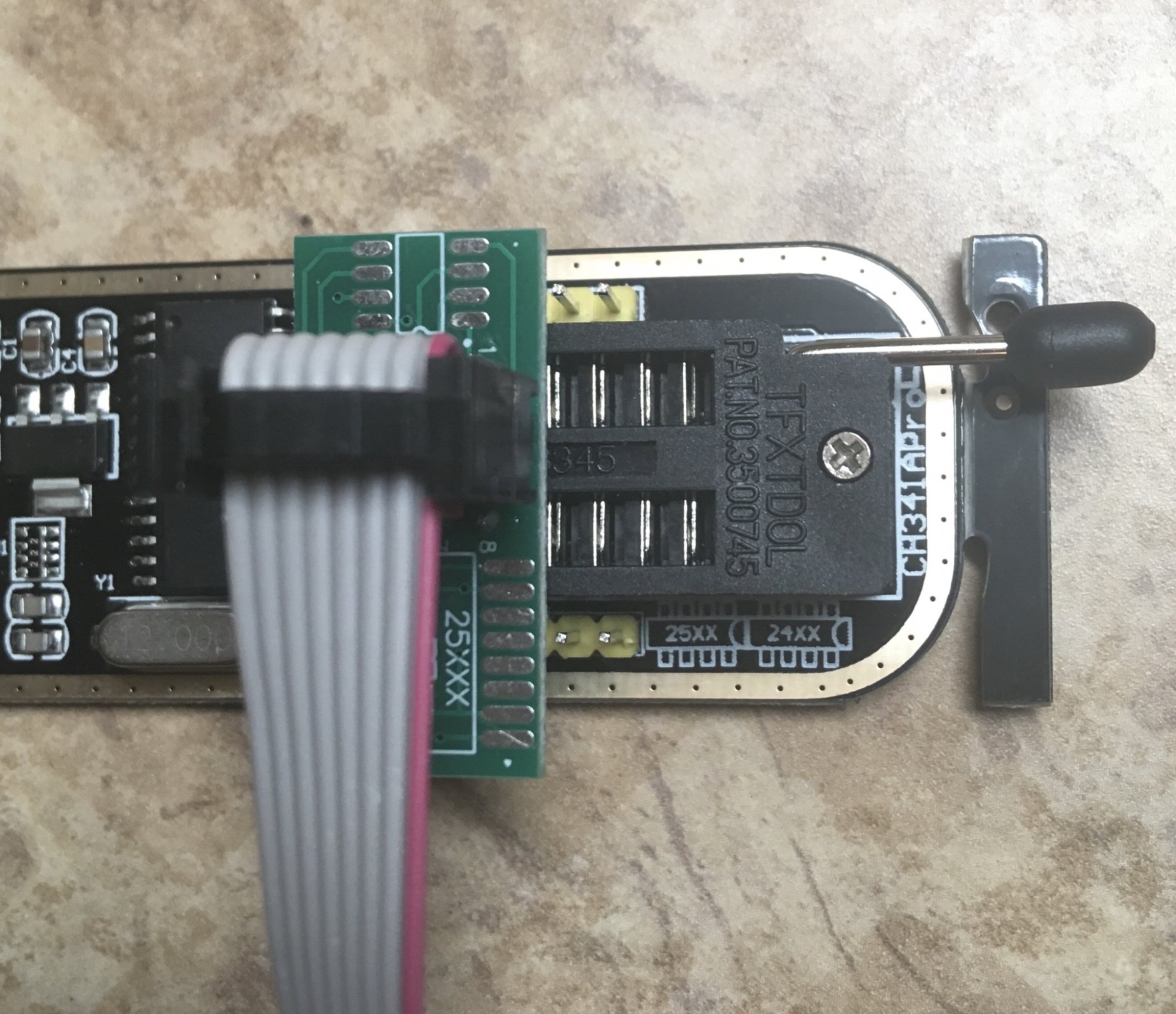

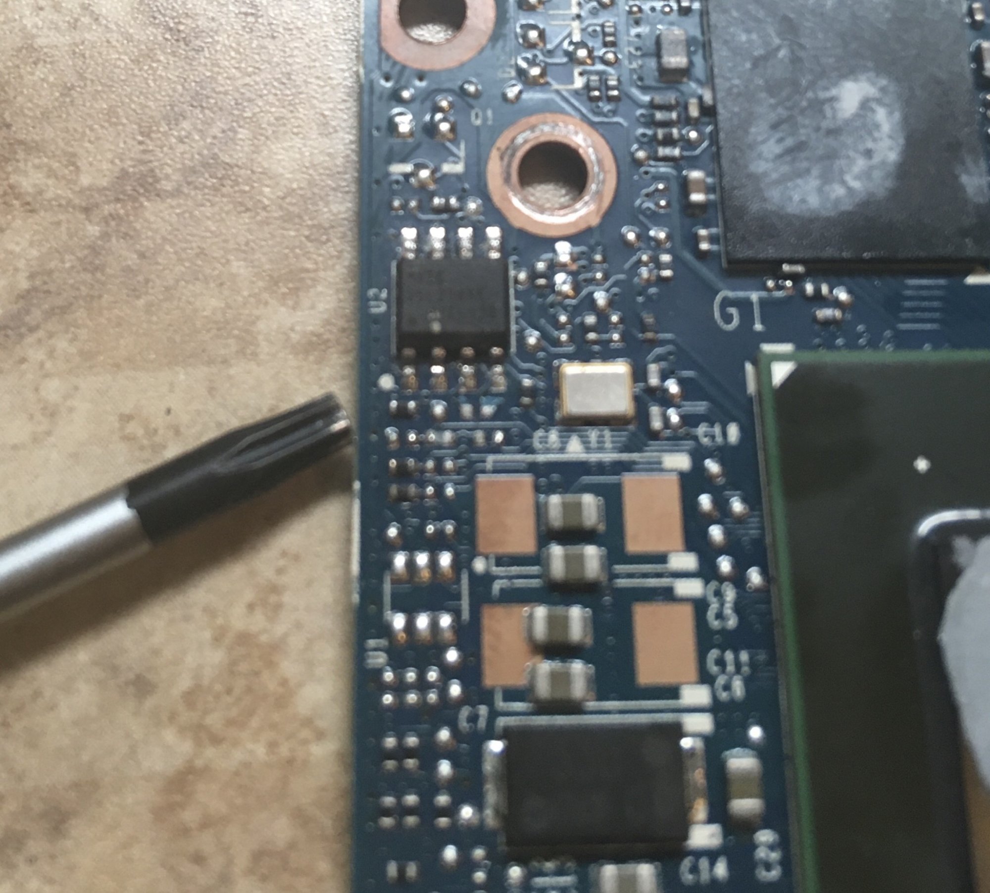

edit: While I’m here, is this the proper way to cable the programmer?
And on the board side, pin 1 (red) on the clip would connect to the eeprom pin near the white dot?

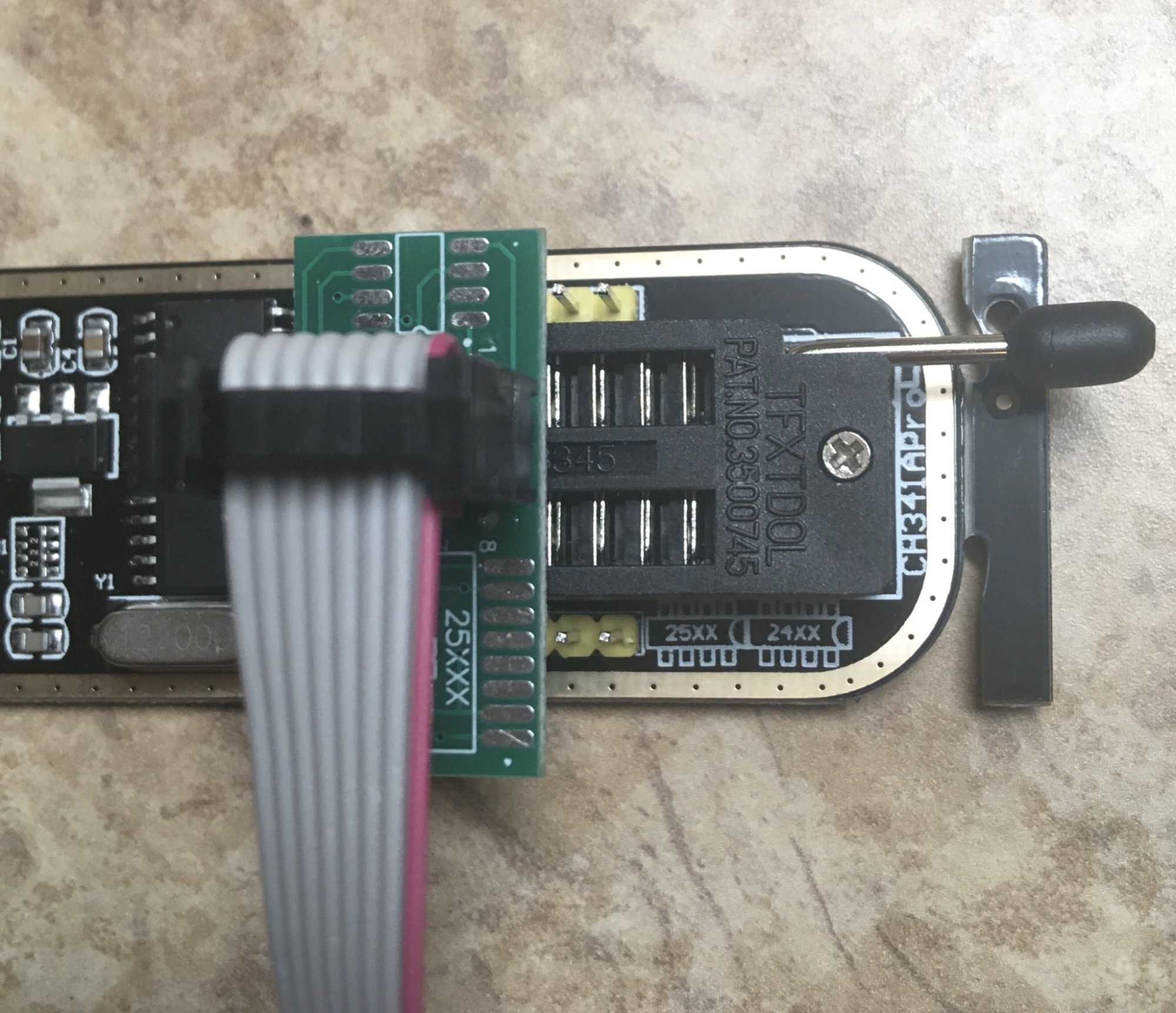

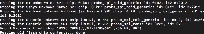

Yes to both questions above. Getting a good connection with the clip is hit and miss. Make sure the black polycarbonate parts of the clip are as close to the board as possible. I used a RPi to run the commands:
sudo lsusb (to make sure the RPi is seeing the programmer first and then)
sudo flashrom -p ch341a_spi -r testbin.bin (to read and dump rom)
sudo flashrom -p ch341a_spi -w [path to K2100M.bin] -V
Notice I am using flashrom in Linux (latest version for RPi4) and not nvflash.
