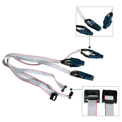

Okay last question. Best way to flash myself will be using one of these:
And one of these:
Correct?

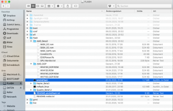

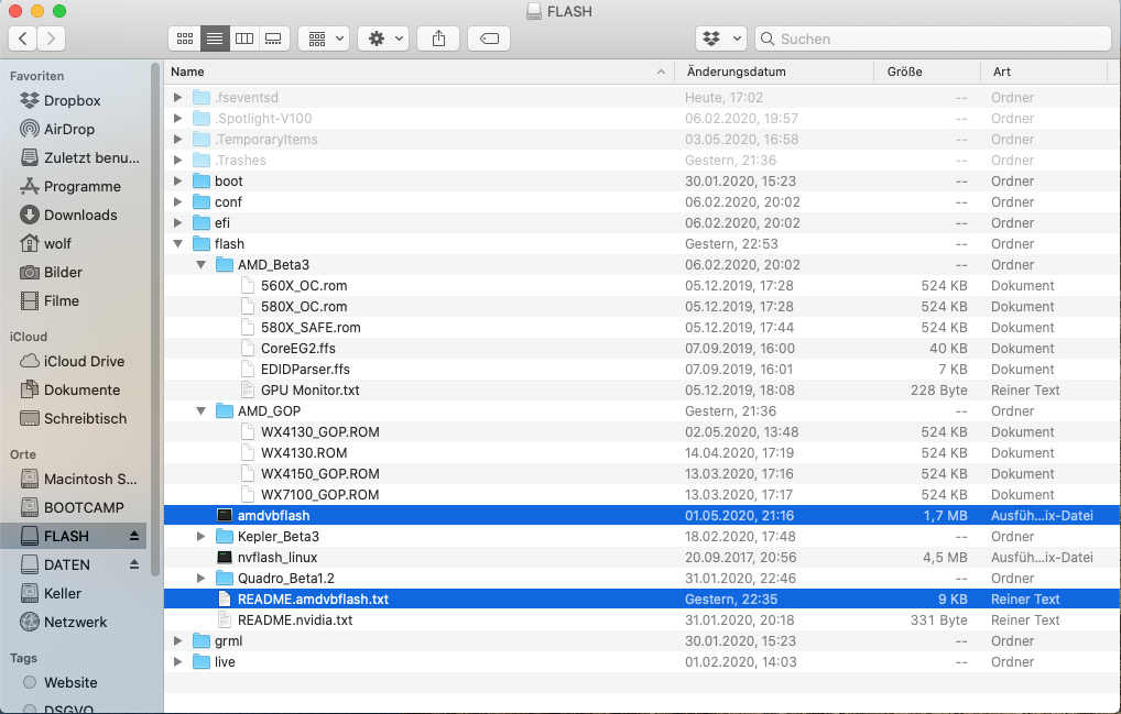

You have to get the latest version of amdvbflash from the link a above and you place both files using the Finder in the flash subfolder on your USB stick (my is called flash from an unknown reason, too) as shown in the attached picture.
Creating and using a new Linux flash stick has been described in the original post linked on page one and post #1 of this thread. Please use the msdos aka FAT files system on the USB memory stick! Otherwise it will not be bootable on every iMac.
And one of these:
Correct?
Also will it be worth upgrading to Mojave or Catalina for Metal instead of Open GL?
Correct.
But there are different qualities for chip clips. I would go for a Pomona clip. I have tried before this one, another cheap brand and had enough problems trying to plug it onto chip than i finally bought a Pomona clip.
