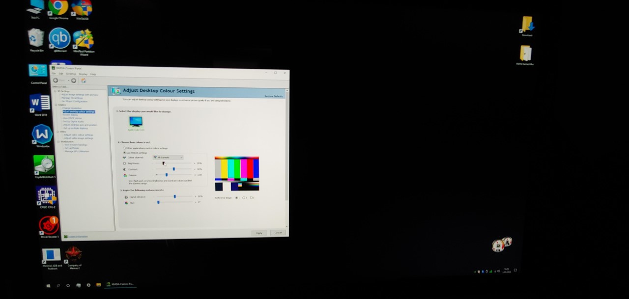

[Unrelated question] Is there a way to control brightness while in TDM? When engaging TDM backlight goes full blast even if it was dimmed in MacOS prior to that. Any solution would be welcome.
i've not upgraded my GPU yet but when i use TDM to switch to my PC (which uses a K600 quadro) i can set the brightness with the nvidia software. Is this not an option for you when you use windows? I can also use the brightness controls on the keyboard to increase/decrease or have i went off on a tangent here totally unrelated to your problem? lol
either way i hope you get it fixed because it sounds like i'm going to have a similar setup to you!
Do you use Nvidia Control panel
Can you make a screenshot of your brightness control and your nvidia application you use to control it with ?

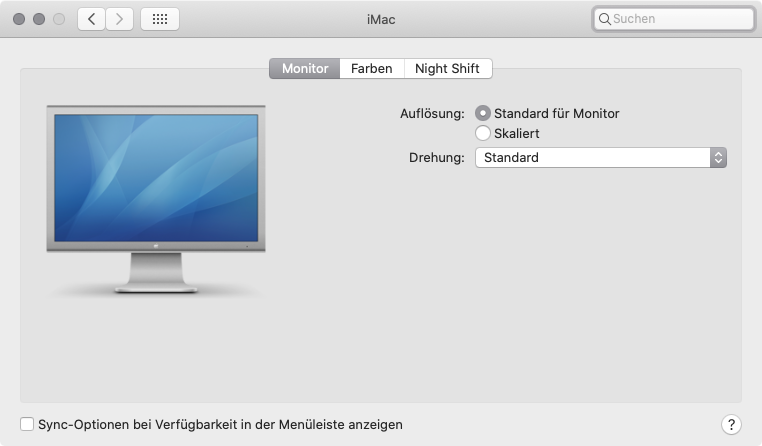

is it correct that I have a wrong internal monitor on an 2011 iMac? and is this the reason why the machine is not going to auto sleep?
sleep kext fixes from highvoltage are installed.

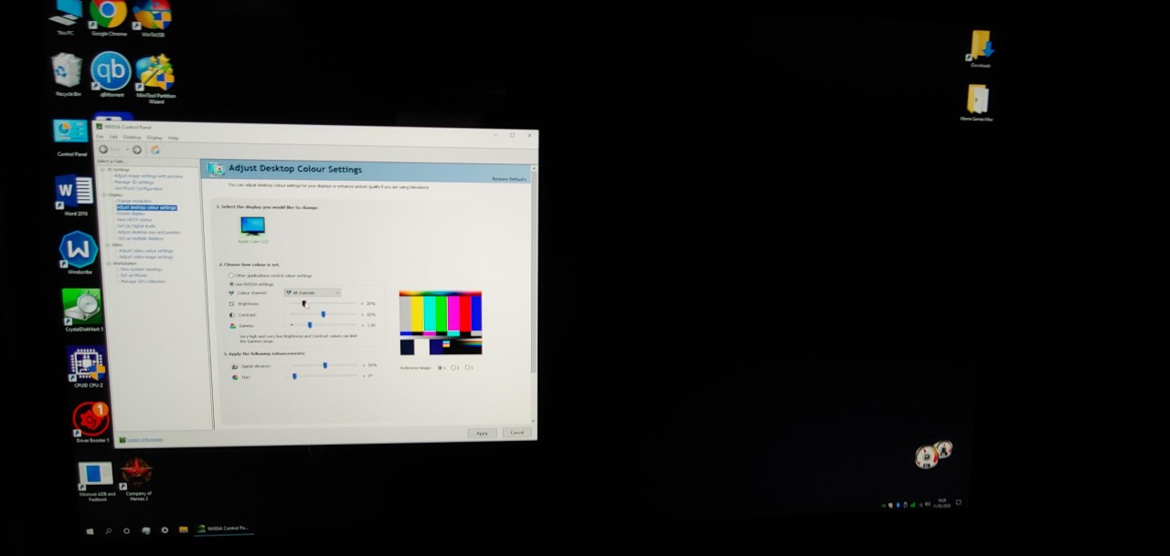

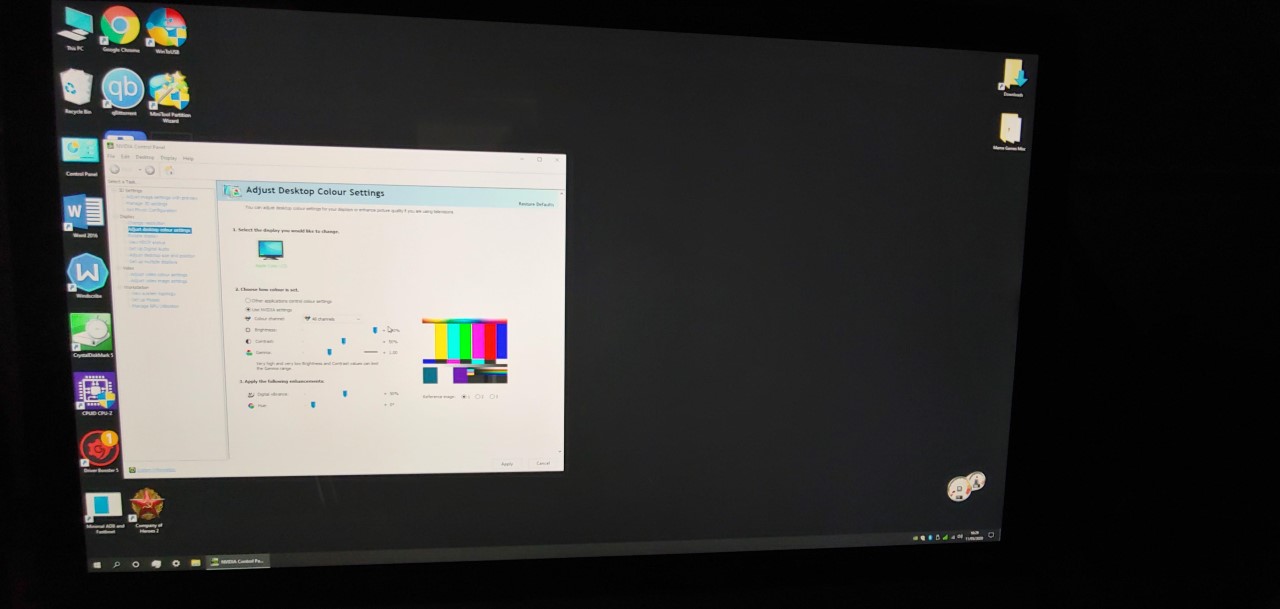

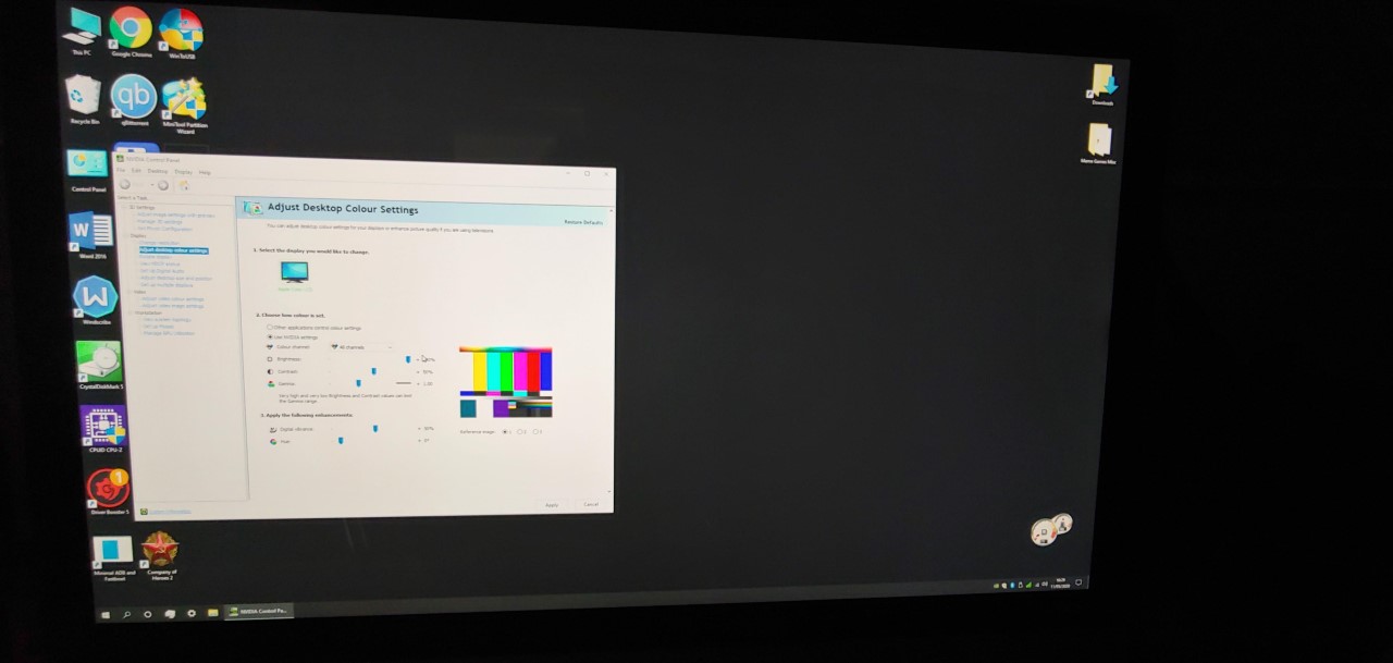

here are 2 photos showing 20% and 100% brightness using nvidia control panel. I can control the brightness natively using keyboard when in TDM. I hope you can see the difference between the two :/ I've ordered a Asus 1030GT for £85 with DP and HDMI as the K600 is dated by a long shot! This will be the last upgrade for my slimline before i venture into new pastures.
No, this is just another sign of the same fact:
No native brightness control because the internal LCD cannot be recognized as the internal one. Your OS believes it is an external display which normally comes with it's own brightness controls.
There is only one way out: A hardware PWM mod.

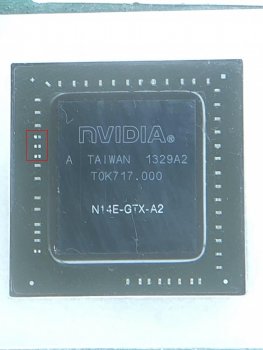

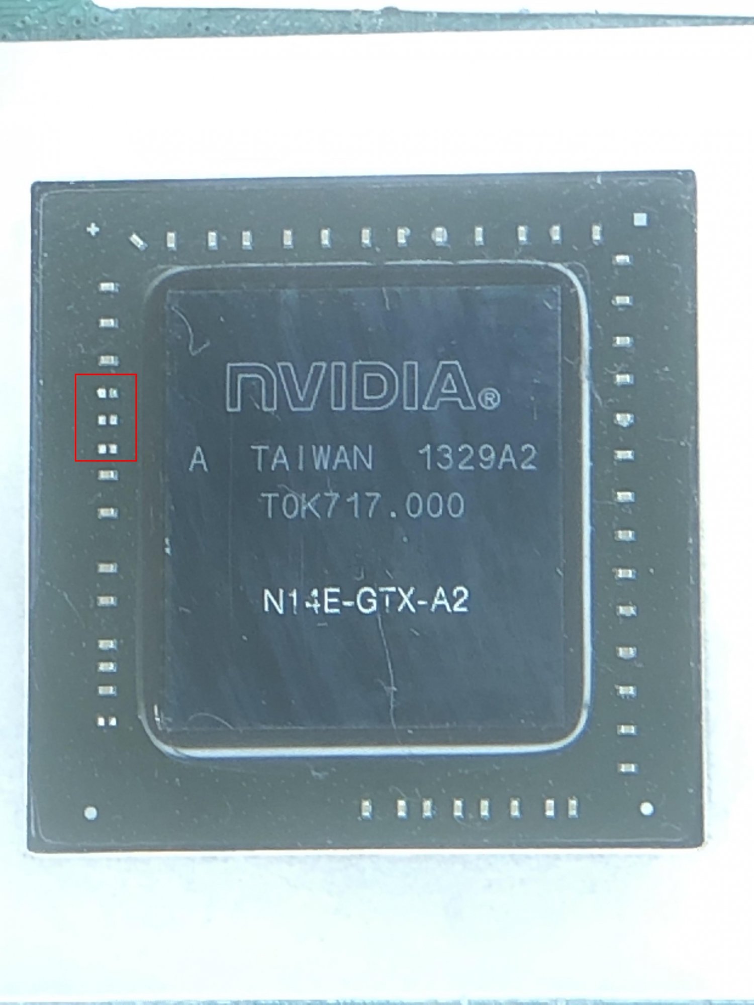

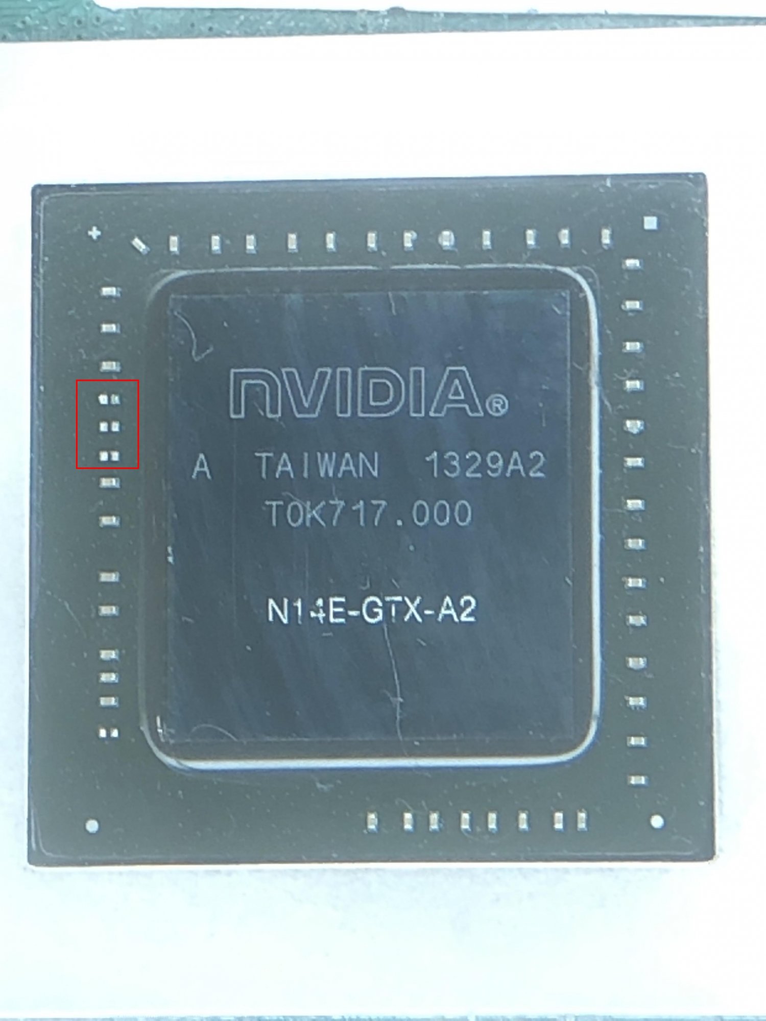

a little help from all the 780m users: does your gpu has those missing caps too (the 3 caps in the red rectangle)? or this gpu is damaged somehow?
thanx
