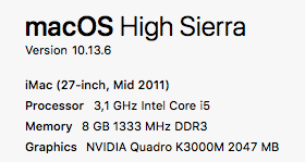

Interesting... Nvidia Webdrivers are giving worse results. I just disabled the Webdirvcer and got some much better results in Valley.
I used this vBios: https://www.techpowerup.com/vgabios/134051/hp-quadrok3000m-2048-120606

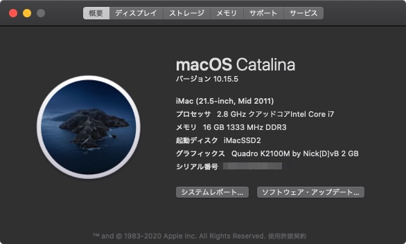

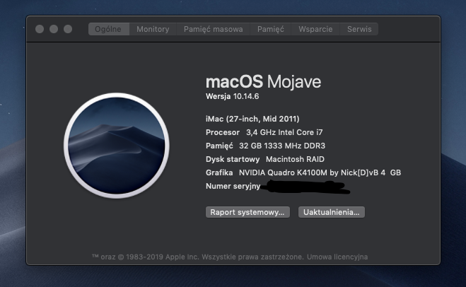

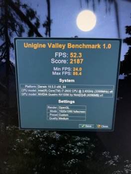

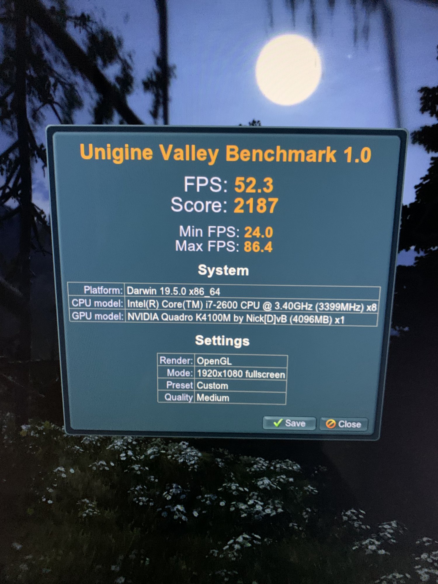

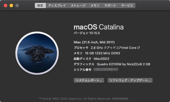

I have imac 2009 with K2100M, works very well in the second month, thank you for your help and for all the work.

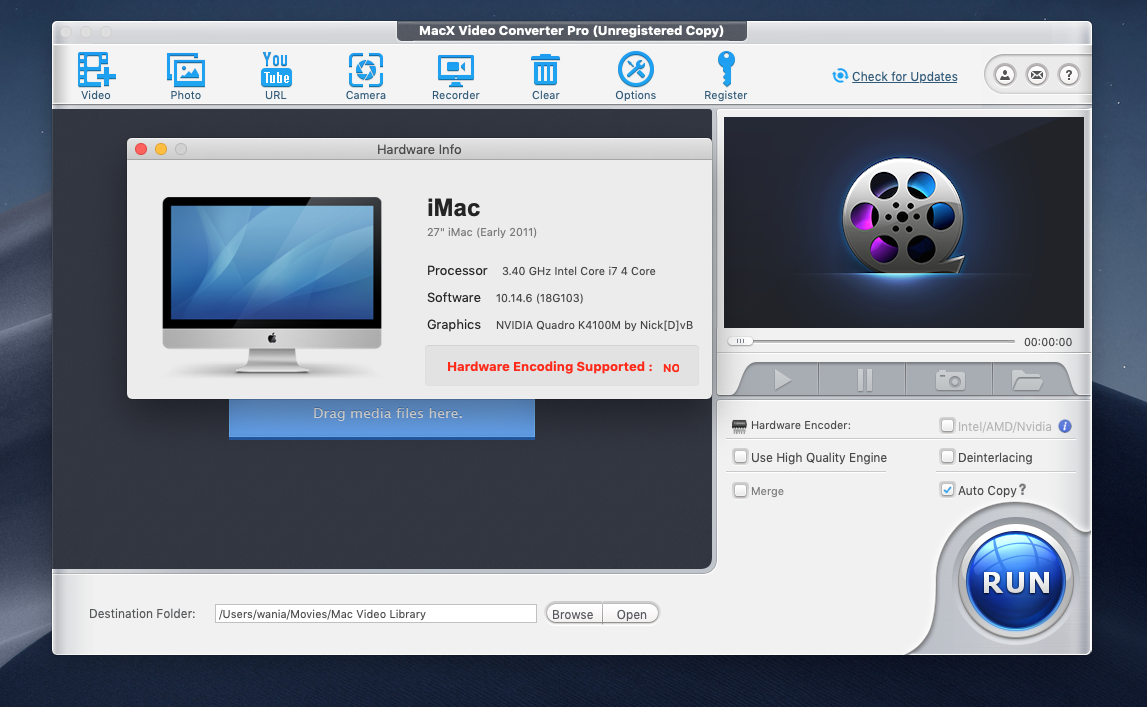

Now I'm starting imac 2011 with K4100M, the first tests on screenshot. I only have a problem, on Catalina MacX showed Hardware Encoder. I had to go back to Mojave. Installed the AppleGraphicsControl kext and the rest of the kext files after installing Mojave. MacX does not show Hardware Encoder.

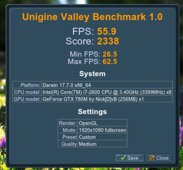

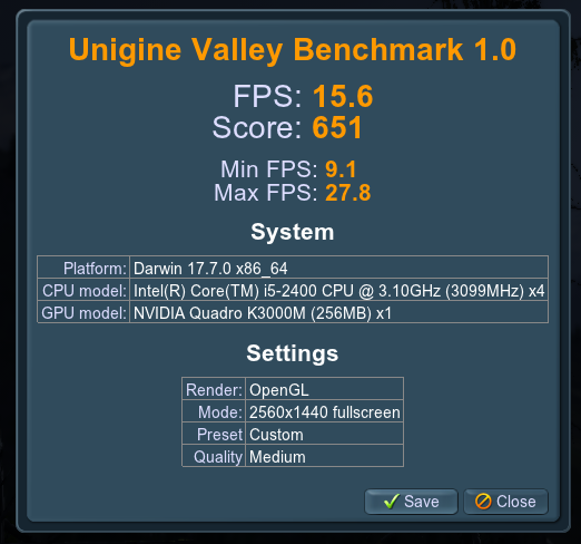

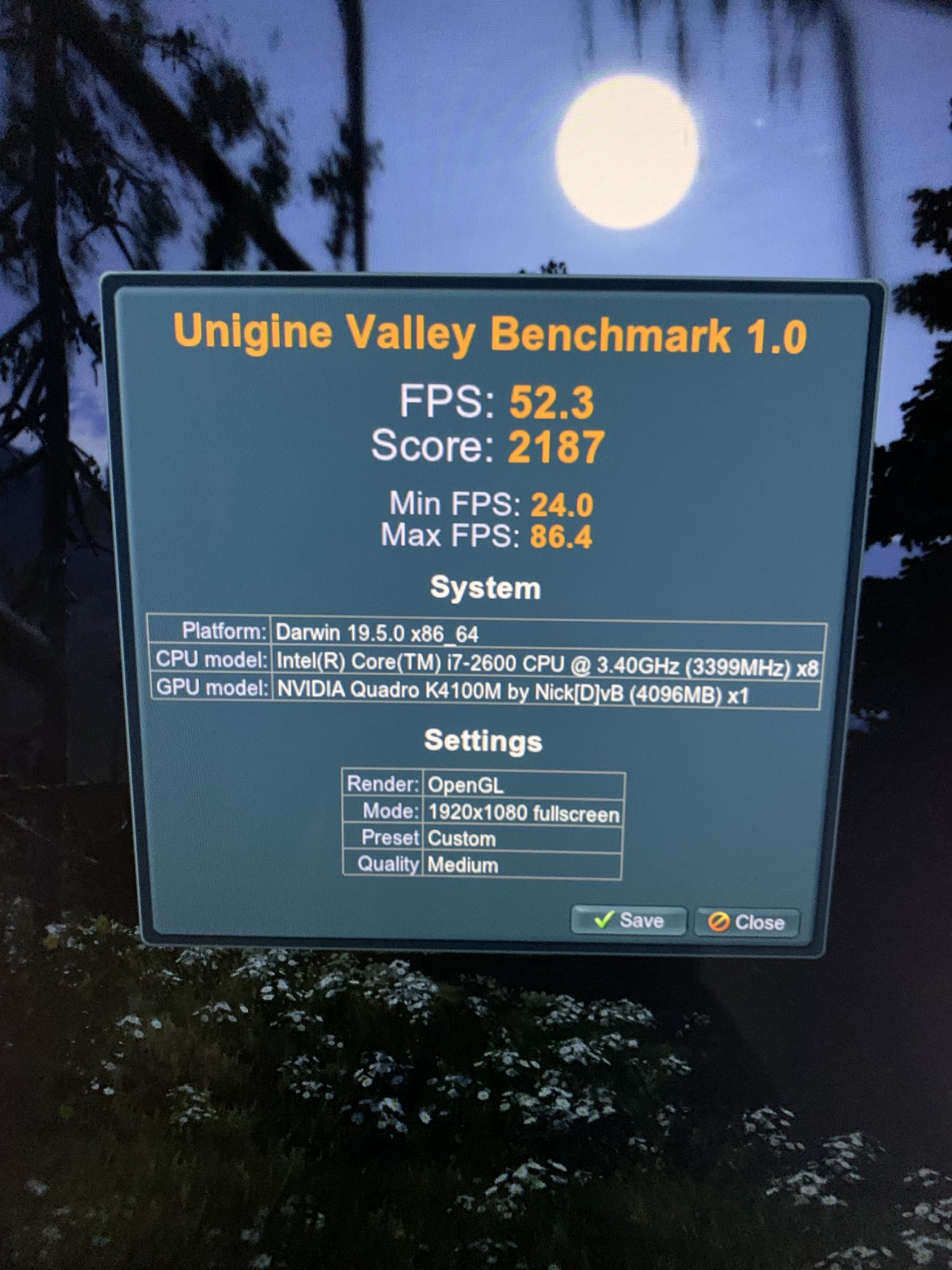

After a failed attempt to upgrade my GPU to GTX780M a month ago I bought another GTX780M from Aliexpress.
The card works (see attached Valley benchmark), but wake from sleep mode doesn’t work.
Couple of other miner things too;
- Boot up from power off doesn’t work without a PRAM reset each time before it will boot.
- When it does boot; from hearing the chime to seeing a white screen with progress bar takes just under 90 seconds. Is this normal ?.
Running HS 10.13.6
QuickSync needs the single AppleGVA.framework...Did you install it, too?
Running HS 10.13.6
Time lag until screen comes up has been described on page one and post one. This is normal.

Re the lack of wake up from sleep mode. Do you know how to solve this ?. Is it related to AppleGraphicsControl.kext ?.
Thanks
No idea! I do not use High Sierra, but the AGCM is the first difference, the OpenCore to get brightness control the second difference to the stock Apple config. Here you may search for a reason.

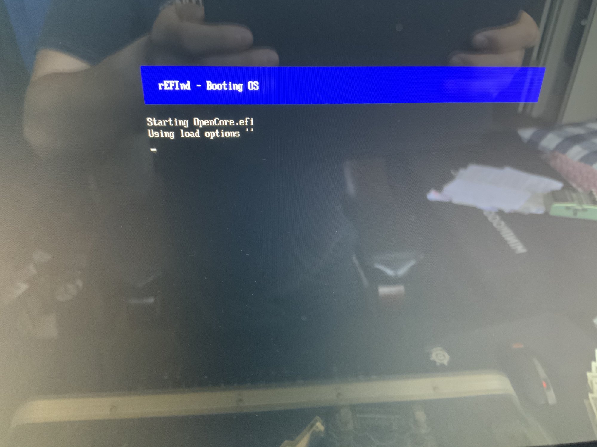

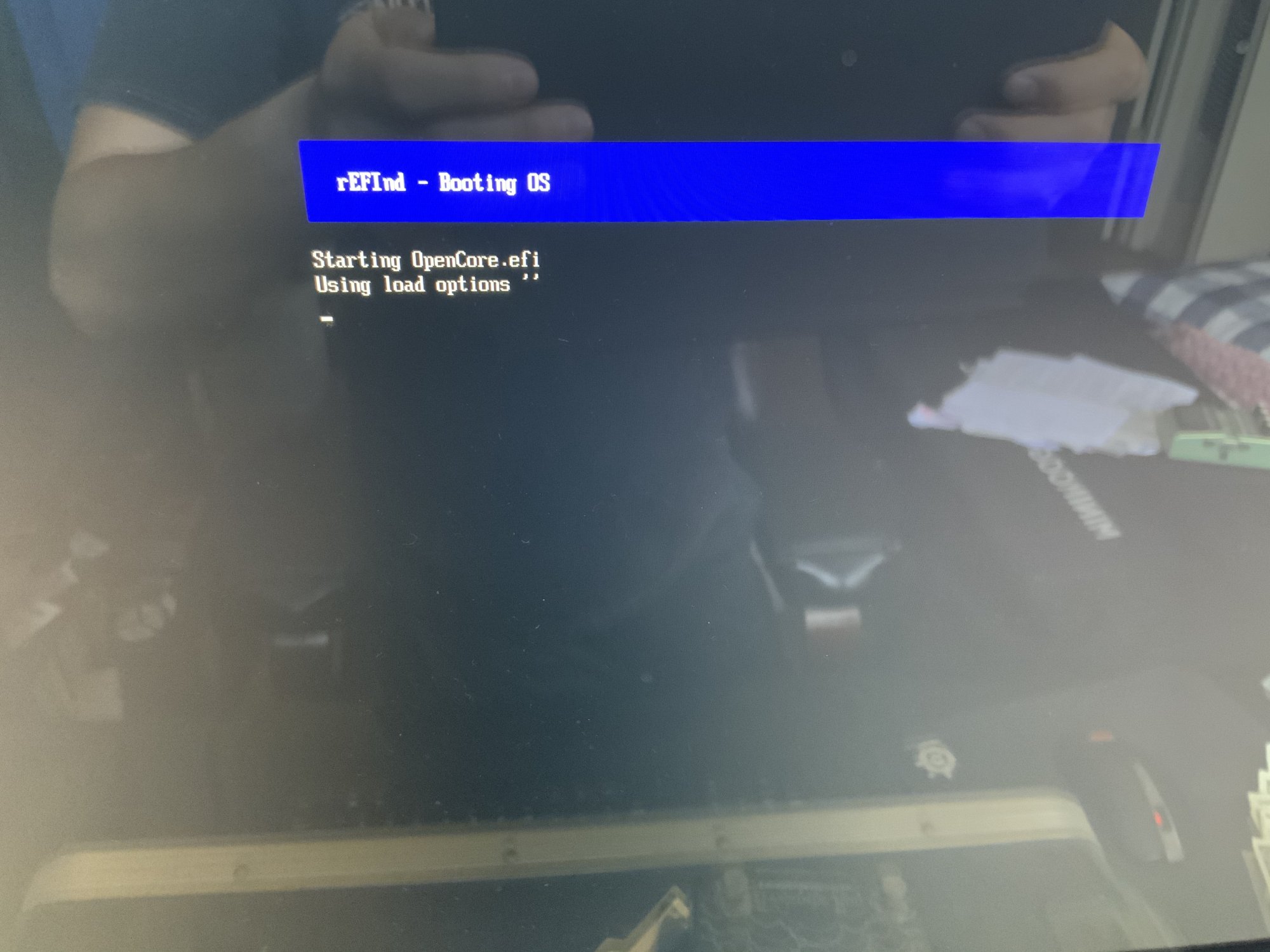

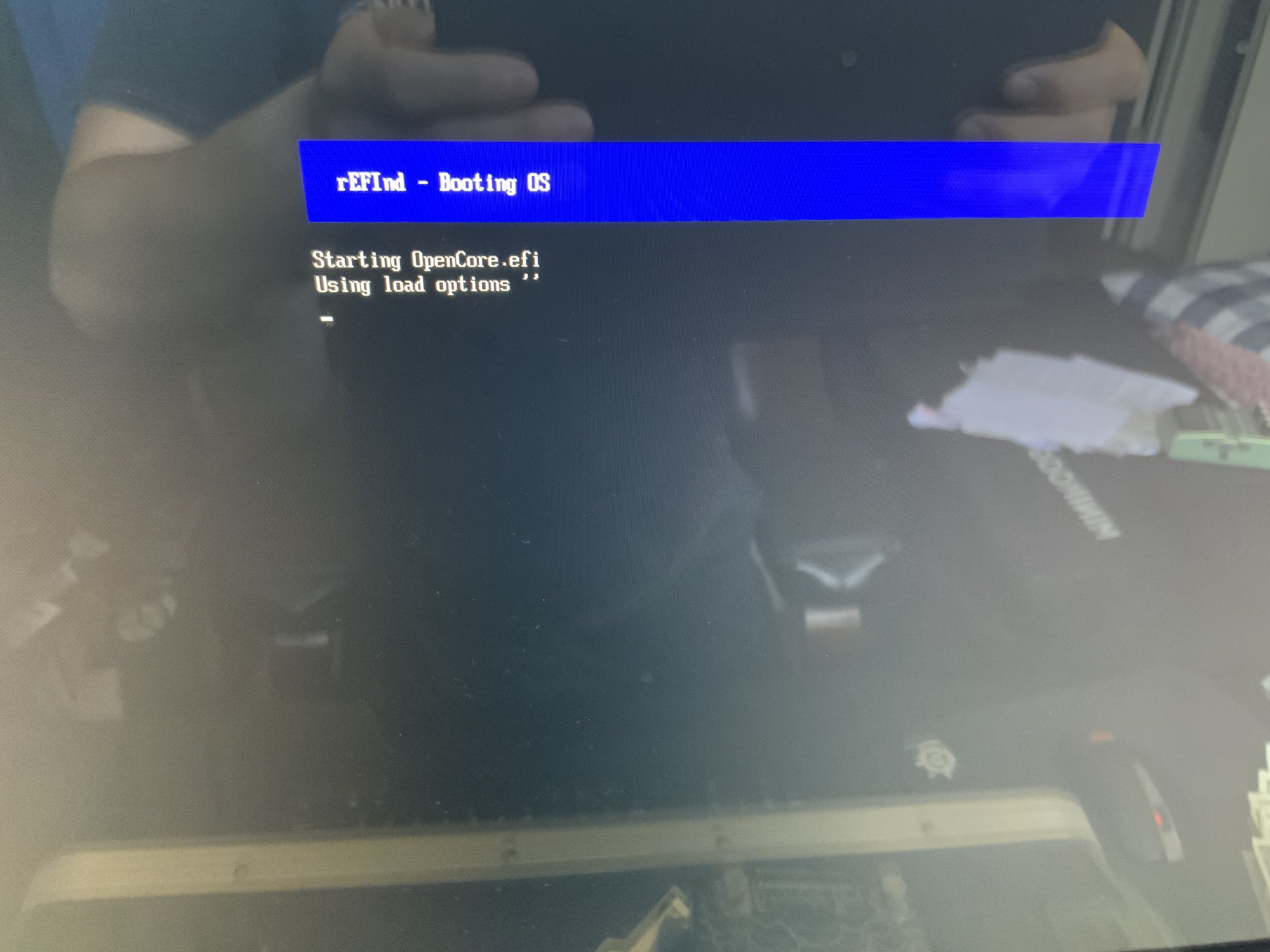

Hey guys, my imac freezes here using the Catalina loader for opencore on high sierra:
I already have REFIT installed (which is a similar version of REFIND) so maybe there's some confusion? SIP is disabled and I reset the PRAM after. When I originally was setting up the loader, the flash process failed several times, so I had to try again, I used Balena etcher. Is it a bad USB or a bad flash? Did I miss a step?
