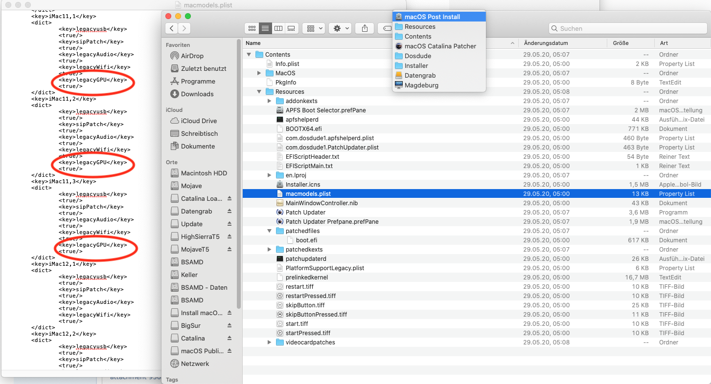

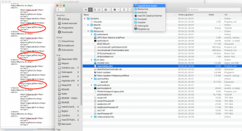

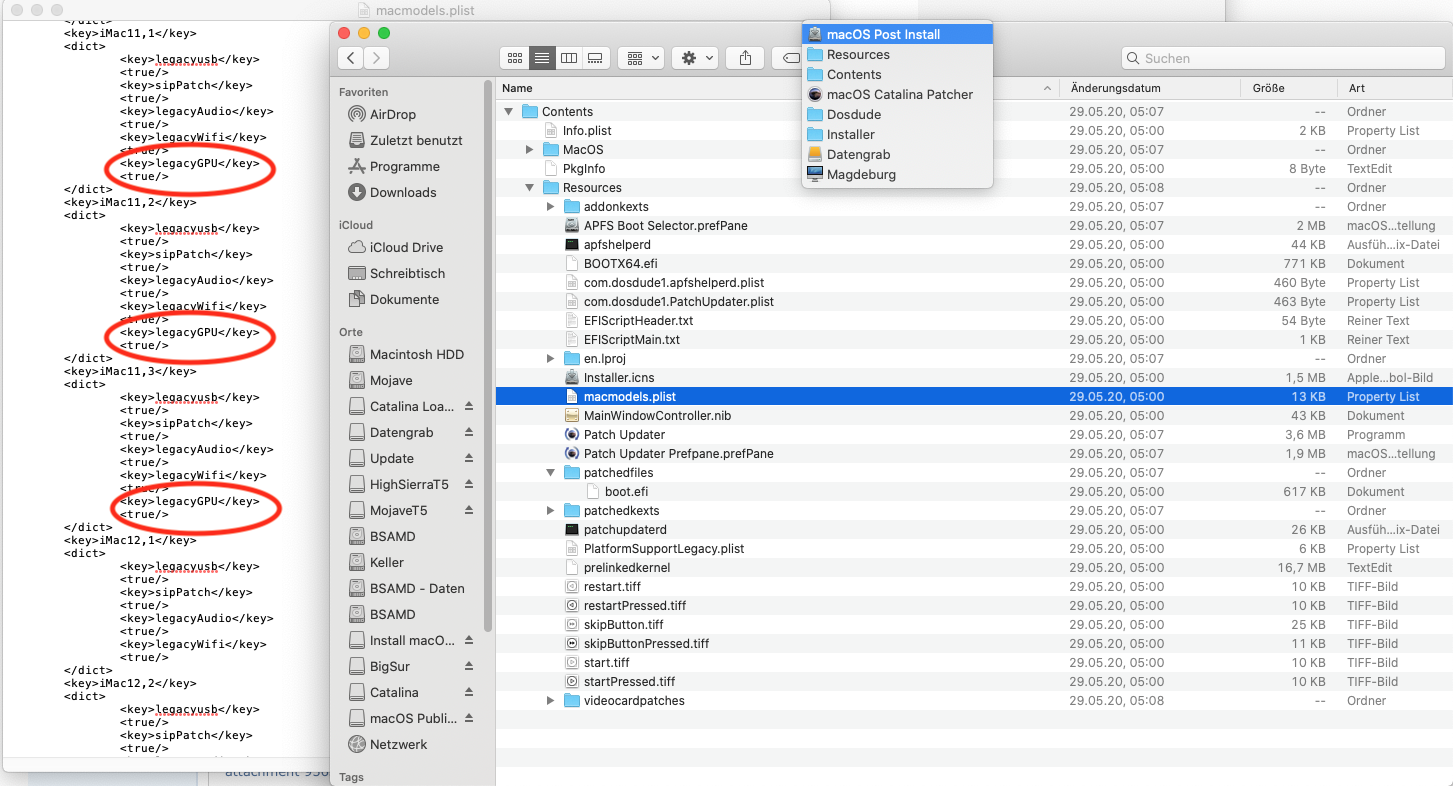

@dosdude1 Catalina Patcher 1.4.4: Install to disk with late 2009 and mid 2010 models
The Catalina Patcher has a method to install a downloaded and patched image directly onto the running system for a while. Unfortunately you cannot get around the automatic patching using this method. This ends up on the late 2009 and mid 2010 models with getting the unwanted und unnecessary Legacy Video Patch installed.
There is a way to modify the Patcher in a way to avoid the installation of this Legacy Video Patch. Take a look at the attachments, there is the location of the plist file named macmodels.plist documented and I added an already modified plist file. You just need to replace this or delete the lines within the red circles. Basically you get the same settings as for the 12,1 and 12,2 models from mid 2011.
Of course you need this patch to be applied to the patcher each time you download the patcher again. So keep this patcher until @dosdude1 publishes a new one. I have checked the functionality out by now on a single late 2009 system! This is nice short cut avoiding the creation of endless series of (sometimes not working) USB installers.
To open the contents of the @dosdude1 patcher file (which is in reality a folder) just right click on the file and chose open "show package contents". If you have never done such a patching have fun!
Please report success or errors...

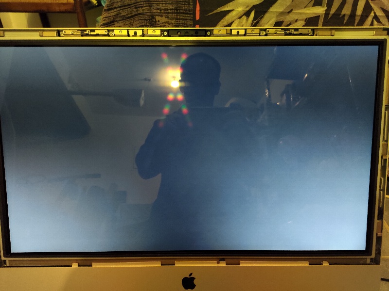

Hello
Il nées sole help for upgrade an iMac 2009, i7
Il have bought a k610m. Flashed it with nvbios
The iMac start, chime and all thé 4 diag led are on.
Il have backlight
But non picture, even if i wait for minutes.
My HDD IS blank and i created an install USB disk
I Can Do a ram reset but it does the same
If i want to shut it down i have to push some seconds on the power button as if the system works.
What Can i do next please ?

Hello
Il have backlight

Thanx for your reply
In fact i have no picture and no white screen at all
Like this..
First try a PRAM reset as described on page 1 and post #1 (probably three in a row).
If this does not help check all the cables internally. This looks more like a hardware problem related to a bad display cable. The backlight is partly working. Try to plug in an external display (miniDisplay<->DVI) and check if you get a picture on the external screen. Having all 4 LED is a real good sign.

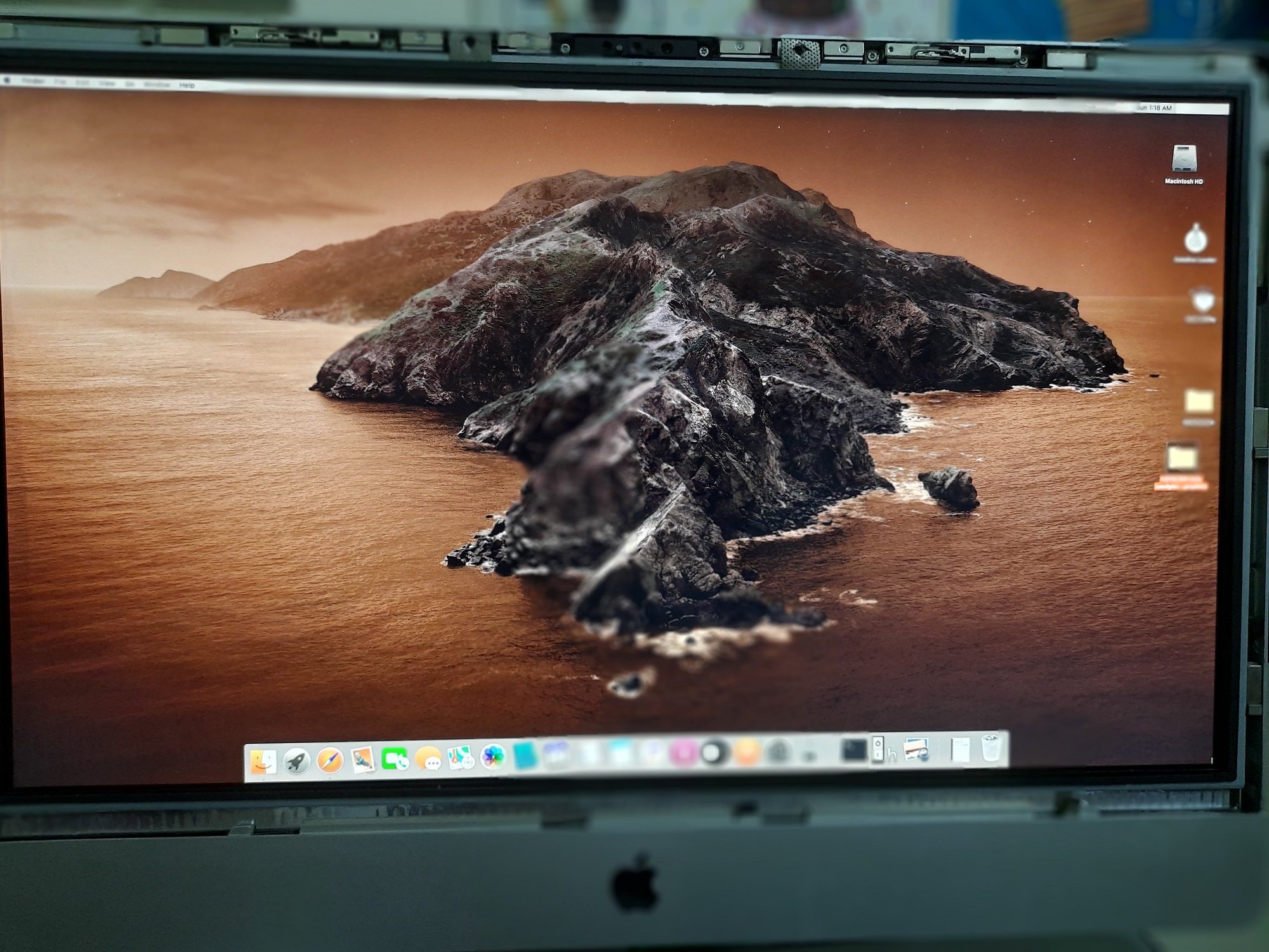

Hi Highvoltage, thanks so much for your work - got my 2011 working well with Catalina using an 880M, nice and bright. I am wondering if you can see a way to get the backlight fix to work back in Yosemite? I have some software that won't run stable beyond Yosemite and would be amazing if the brightness can be improved with a kext fix rather than one of these involved hardware hacks I've been seeing. Any thoughts here? Much appreciated if you have any tips! Cheers, Hugh
Hi am swapped K2100M on iMac 2011 ,working fine on highseira & Catalina with out native brightness ,after the Catalina Loader for Native Brightness screen colour was changed with little yellow and delay on startup no native brightness .
These kexts are used in S/L/E
  • AppleIntelHD3000Graphics.kext
  • AppleIntelHD3000GraphicsGA.plugin
  • AppleIntelHD3000GraphicsGLDriver.bundle
  • AppleIntelHD3000GraphicsVADriver.bundle
  • AppleIntelSNBGraphicsFB.kext
  • AppleIntelSNBVA.bundle
  • AppleMCCSControl.kext
  • IOSurface.kext
AppleGVA.framework was transfer to PrivateFrameworks for intel quick sync with Permission
OpenCore Configurator changed Picker Mode” from “External” to “Builtin
For native brightness for Catalina 15.5 Lilu.kext and WhateverGreen.kext needed for K2100M,please
mention what is reason for the colour change issue for the screen,if we installed nightshift patcher on the iMac 2011 ,has any issues.
