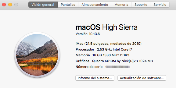

got a K610M card for my 2010 21.5'' iMac 11,2. Flashed it with bios from the first page and installed it, and now iMac is booting fine on High Sierra, card is recognized by OS and seems to be working fine, but on power up I don't see boot screen (screen remains black until OS loads up to the login screen). I though I should see boot screen. Am I missing something ?
[Have not installed OpenCore yet]

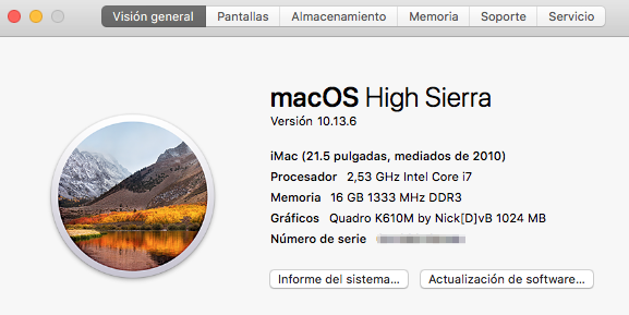

Hello,

On k2100m cards, no boot screen is seen unless 1. You request it on boot with the ALT/Option key.
2. You set OpenCore as your 1st boot device (system preferences) and then use the bootloader on every boot. OpenCore also gives you Backlight control.

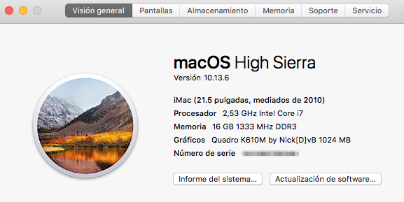

Hello,

Hey can u please make a screenshot of your about this mac screen?
also after flashing on reboot do a PRAM Reset with CMD + ALT + P + R
As @highvoltage12v already explained you will only see a boot selection screen and boot screen if you press alt/option on boot or if you have already installed the Catalina Loader. The BIOS has a "wait cycle" of some seconds, booting an SSD has often finished before the internal screen switches on.
Long story short: The internal screen will not power on unless you
1) press alt/option on boot
2) use the catalina loader
3) wait the "wait cycle" of 10-15s
What you currently experience is "it works as designed". There is no problem, there is a lacking Catalina Loader installation.
Yes, I did PRAM reset. Boot progress screen is shown when I do PRAM reset, but not on subsequent boots.
It behaves just like @highvoltage12v said: boot screen does not show unless I hold Alt/Option on boot.
Gonna try OpenCore next, thanks!

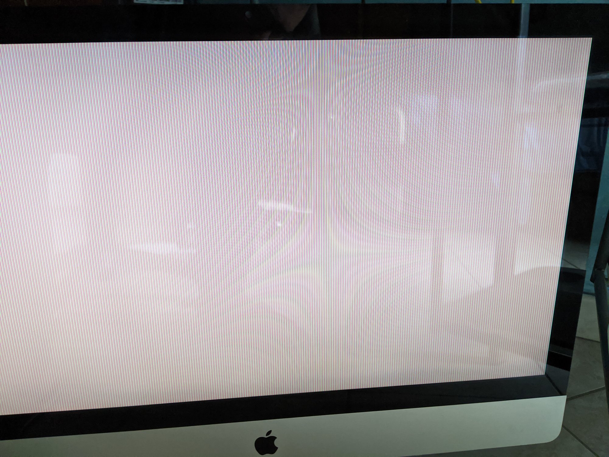

Hi guys,
I get the iMac. From serial I found it is a mid-2010 27". GPU is so damaged that I Can't see anything on the iMac, only colored vertical lines. Problem is it do not have any internal disk because my friend has to take it out, so now it is without disk. I do not know how to make it working for use as target display. It is possible to install macOS on an external drive and than attach it to the iMac from usb? Can the iMac boot up directly from USB without me doing nothing?
Hi guys,

An update, this is what appear when I turn on the Mac. It make correctly the sound. Thus it is a gpu problem?
A defective GPU will not show anything useful on the screen. @Nguyen Duc Hieu has a working GPU installed.
