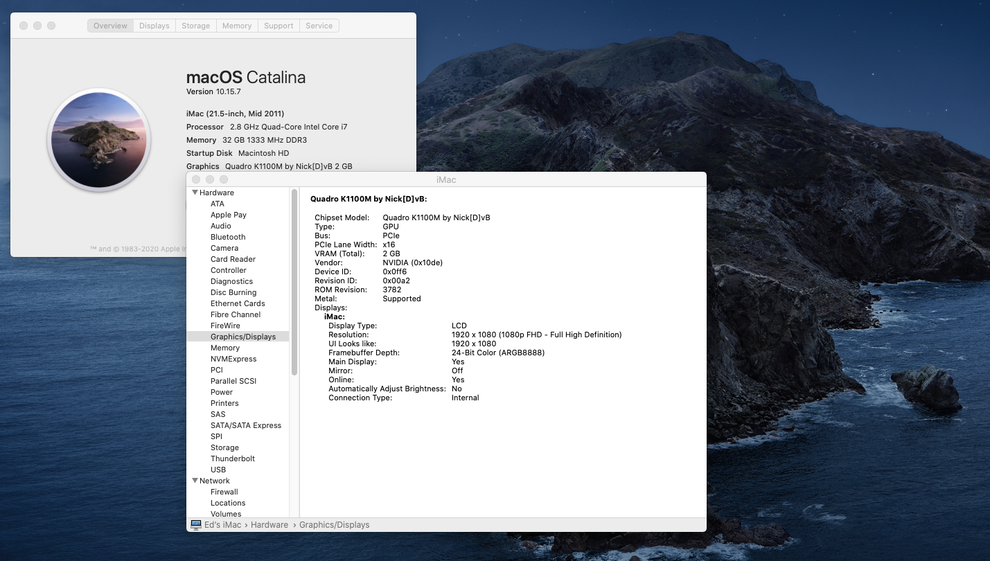

Just upgraded my iMac 21.5 2010 from i3 to i5 and a k2100M 2GB successfully.
Hi, i want to upgrade My 21.5 Mid 2010 iMac, You just flashed the BIOS into the new GPU and got it working right? The Open core is to regain brigthness control, and you didnt mod your heatsink. Am i right?
well I don't know exactly how, but I seem to have successfully installed 10.15.7 using dosdude1's Catalina Installer and have gotten the brightness control using the Catalina Loader... this is on my hard drive which was an exercise to getting to load it on my system SSD... which is currently running High Sierra...
Having the second solid system to boot to when I was trying to figure out what, exactly, was going on was essential.
I had many instances of "black screen" but basically got to the point where Siri was asking about setting up with voice command... then rebooting, working through the system setup with a couple of instances of "black screen," rebooting, etc, until getting all the way through to setting up an account.
Either I'm lucky the machine hasn't panicked, or it is cured... but I'll be looking at this Open Core stuff which is way convoluted, at least as described in the well intentioned documents....
gotta run now.... no fan yet, but seems like progress....
Reactions: Nguyen Duc Hieu
