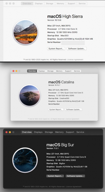

Been following this thread for some time and I finally did it - upgraded my iMac 2011 27" i5-2500S 12MB RAM with Radeon HD 6770M 512MB on High Sierra with a nVidia Quadro K2100M. On a separate 256GB SSD running off Seagate's Thunderbolt Go-Flex adapter, installed Catalina first and a few days later Big Sur 11.0.1. TL;DR: It all works!
I wanted to say a big thank you to @Nick [D]vB, @dosdude1, @Ausdauersportler, @nikey22, @highvoltage12v, @Barry K. Nathan, @xanderon, @Curtis Gross and those involved in making brightness control work with OpenCore. You have all keep my iMac 2011 alive and well, and I cannot thank you all enough!

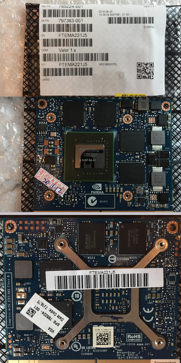

I purchase my K2100M from Aliexpress and bought the cheapest one available - on sale it was US$68 with free delivery. In hindsight, it may not have been the best choice of seller. The card arrive with Elpida memory chips although the seller's photo had SKHynix memory chips. So only 1GB is recognised.

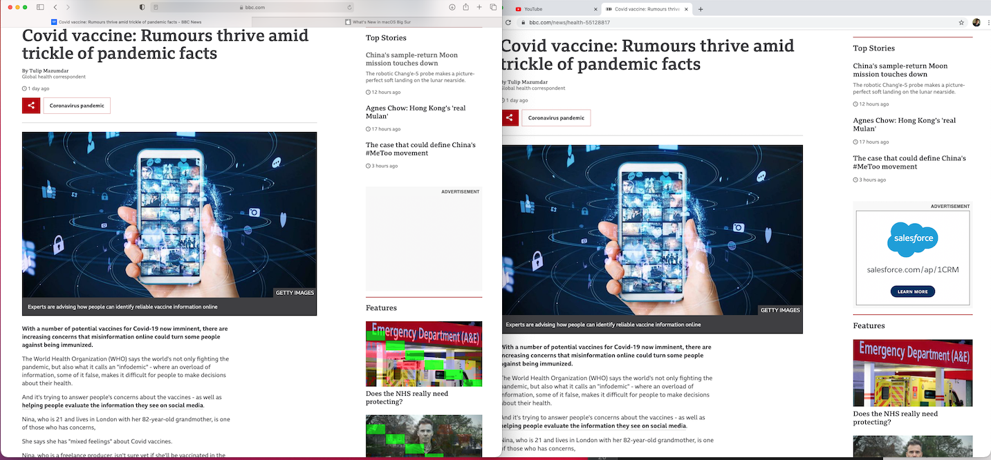

I am wondering if anyone has seen green square boxes on their images in Safari on Big Sur with this K2100M card? They do not always appear and they are not there when using Chrome Browser and I am unsure if it is an issue with K2100M or Big Sur. Apologies if this question is best asked in the Big Sur forum.
Lastly, I needed to keep working in High Sierra with the K2100M card and the LCD was getting very hot 65 degrees C (my ambient is 29 degrees C), so I edited OpenCore 0.6.2 config.plist and set the PowerTimeoutKernelPanic=0 because without that change Opencore would hang when I tried to boot into High Sierra. Now, brightness control works in High Sierra too with Opencore.
These green boxes are IMHO no artefacts showing a dying card, these are glitches observable with different Nvidia cards most likely when using Safari on Catalina?
I cannot explain in detail why this happens. It could be an error while the screen or parts of the screen gets a redraw command from the Finder/OS.
Have never seen this with AMD cards. Because on the Big Sur thread some guys are complaining about other GUI artifacts (color and transparency) with 2012-2013 iMacs having Nvidia GPU chips soldered on board one could come to the conclusion that we might just face another Apple/Safari bug.

Thanks for your feedback @Ausdauersportler.
Those green box artefacts were from Safari running on Big Sur 11.0.1 - installed Big Sur with micro patcher by @Barry K. Nathan and with the --useOC switch for patch-kexts - thank you @Ausdauersportler for sorting all the fixes for 2011 iMac. The card seems to run fine so I'd concur that the issue lies with some Safari bug. No such green artefacts with Chrome Browser.
Moved to OpenCore 0.6.3 - all good. Booting up fine in both Catalina and Big Sur with brightness control.

On the Big Sur thread there was this comment about the artefacts....
In Safari select Develop menu-->Experimental Features. Make sure 'VP9 decoder' and 'webRTC VP9 codec' are both checked.

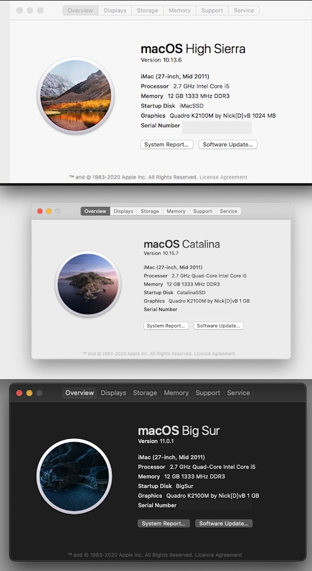

I have executed the installer as shown in picture 3 "NVIDIA-2011".
Should I only have been allowed to make the selection as shown on the picture "k610m- k1100m-k2100m"?
If so, is there a way to undo the installation?

Sorry, I have now added my signature.
If I select only the two programs now, I always have the message that the installation has failed. (surely because the programs are already installed)

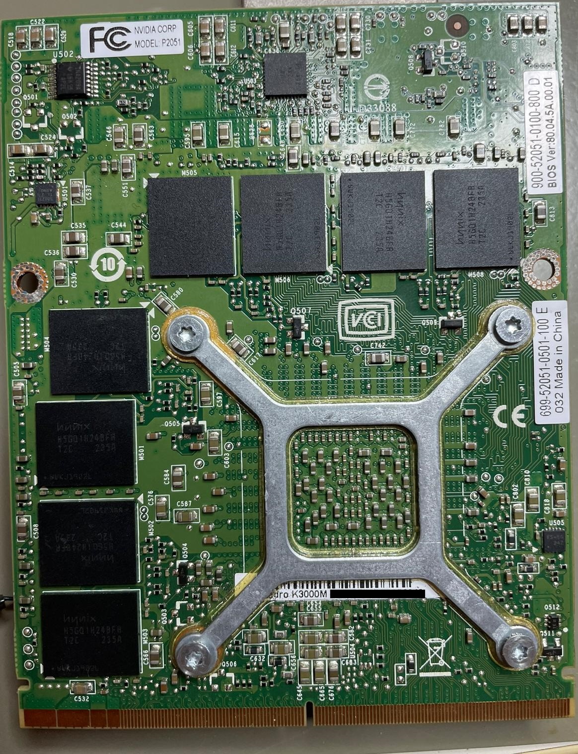

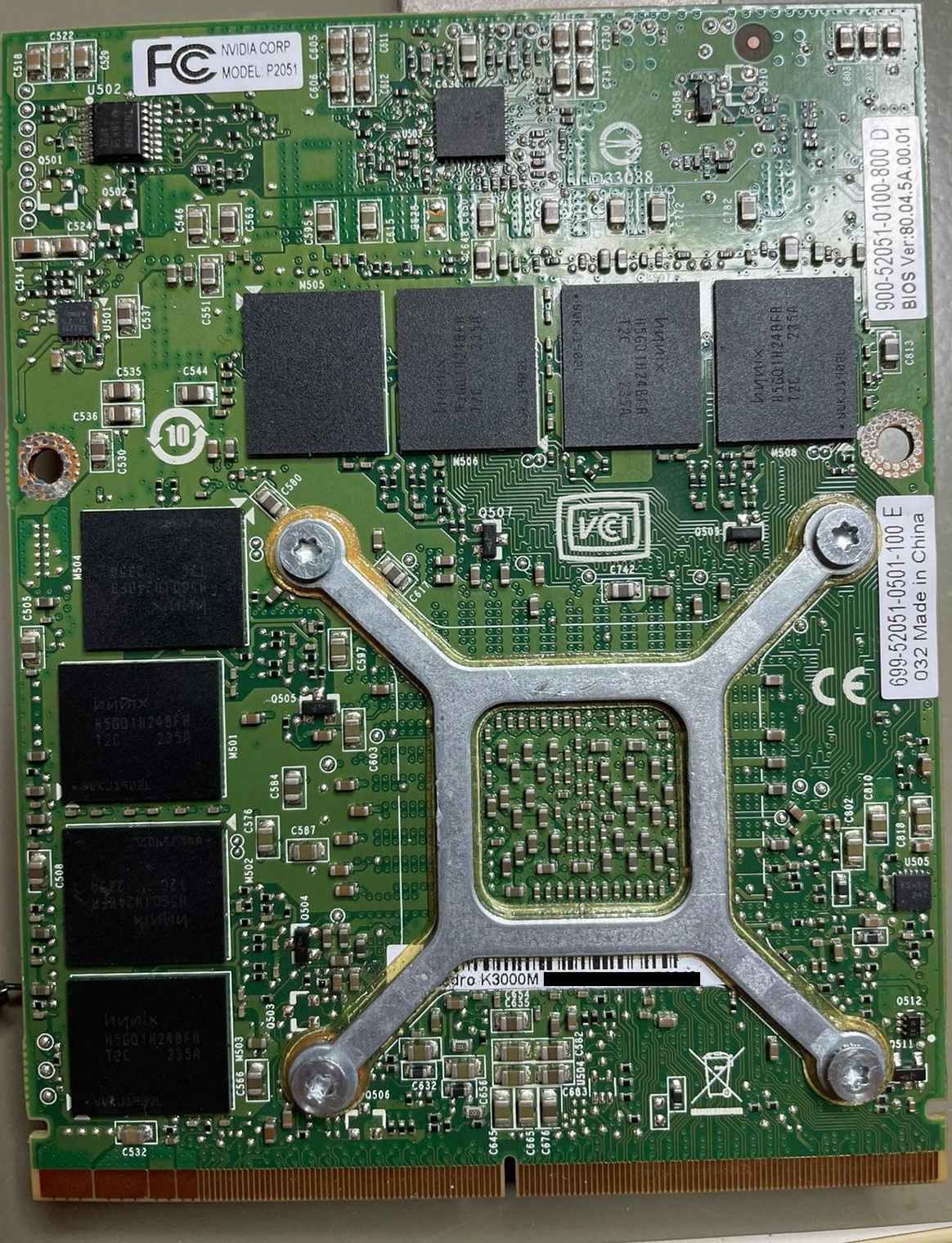

Hi,
first of all, many thanks to the developers of this VBIOS mod!
I collected all infromation about my Quadro K3000M 2GB variant to support the development of a fix for the issue with cards showing 4GB instead of 2GB of this variant.
Card Info:
DELL Part No. 07RPRH - 699-52051-0501-100E
Model Quadro K3000M 2GB
FCC Model No. P2051
VRAM Hynix H5GQ1H24BFR - T2C
Org. VBIOS Version 80.04.5A.00.01 (dump attached)
Strapping resistor is 15.4K on my card
With the VBIOS from the list this card shows functional bootscreen and brightness control and the issue with random crashing after around 5-10min.
This card is available for testing ROMs and I don't care if it doesn't survive this test.
