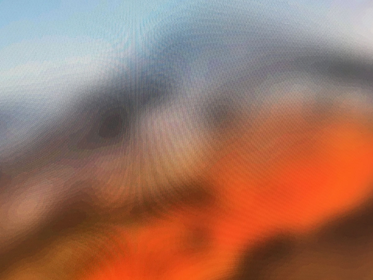

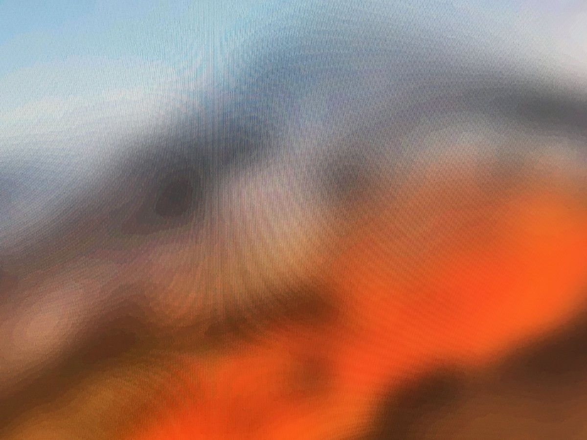

Hi,
first of all, many thanks to the developers of this VBIOS mod!
I collected all infromation about my Quadro K3000M 2GB variant to support the development of a fix for the issue with cards showing 4GB instead of 2GB of this variant.
Card Info:
DELL Part No. 07RPRH - 699-52051-0501-100E
Model Quadro K3000M 2GB
FCC Model No. P2051
VRAM Hynix H5GQ1H24BFR - T2C
Org. VBIOS Version 80.04.5A.00.01 (dump attached)
Strapping resistor is 15.4K on my card
With the VBIOS from the list this card shows functional bootscreen and brightness control and the issue with random crashing after around 5-10min.
This card is available for testing ROMs and I don't care if it doesn't survive this test.
maybe someday anyone look on this problem.
for this moment no one can just think about K3000M and say it loud to community.
its illegal.

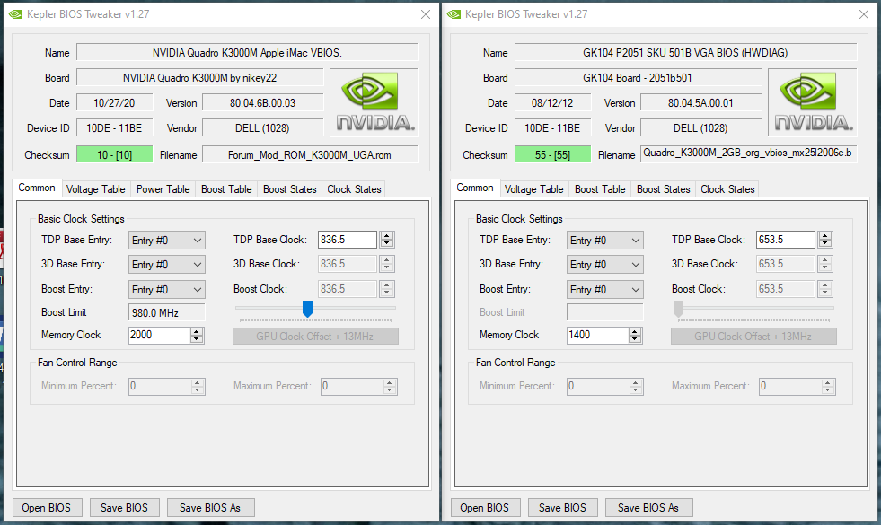

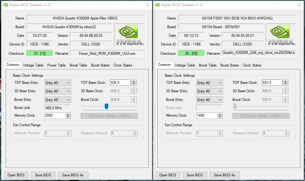

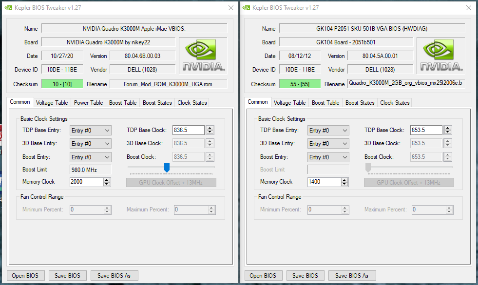

Hi all,
on my Quadro K3000M 2GB version I had some further experiments to get this thing working.
I had a look in the BIOS and fund that the GPU and VRAM clocks are higher than I expected.
I made a BIOS with almost stock clock settings and tested this on my card. With stock clock settings the my card can atleast run OpenGL apps like unigine benchmark and maps in 3D, but with higher VRAM usage (like multiple OpenGL apps running) the OS still keeps crashing (writing to VRAM address higher than 2GB I would expect is a plausible cause of this).
Does someone know where or in which block of the BIOS the total VRAM size is set?

Maybe there is a mix up with the K3100M. Just because:
Known working GPUs:
-Dell K3100M vbios: 80.04.5A.00.01
-HP K3100M vbios: 80.04.33.00.2E
