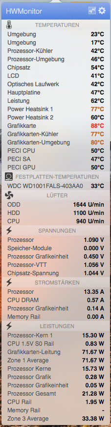

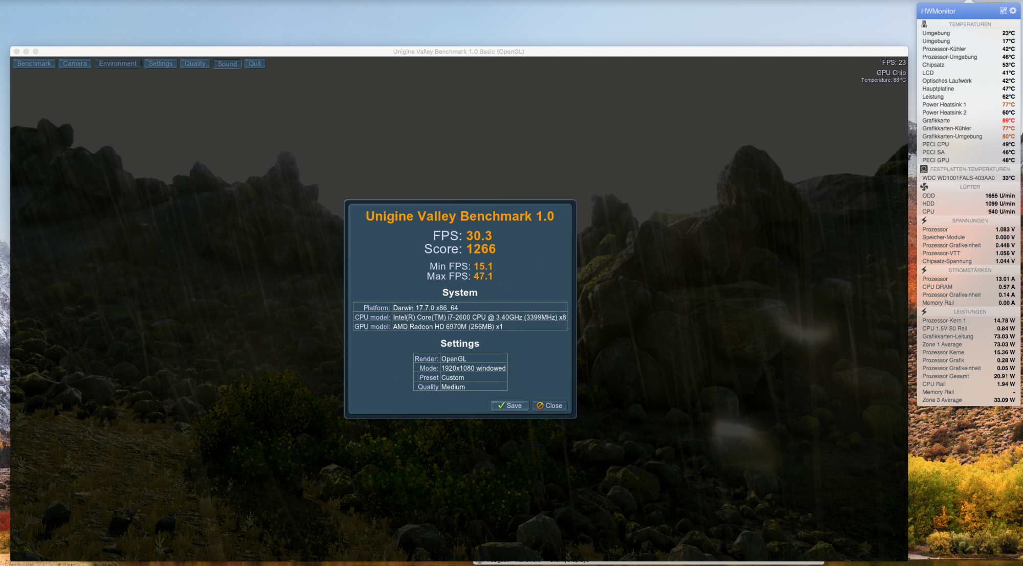

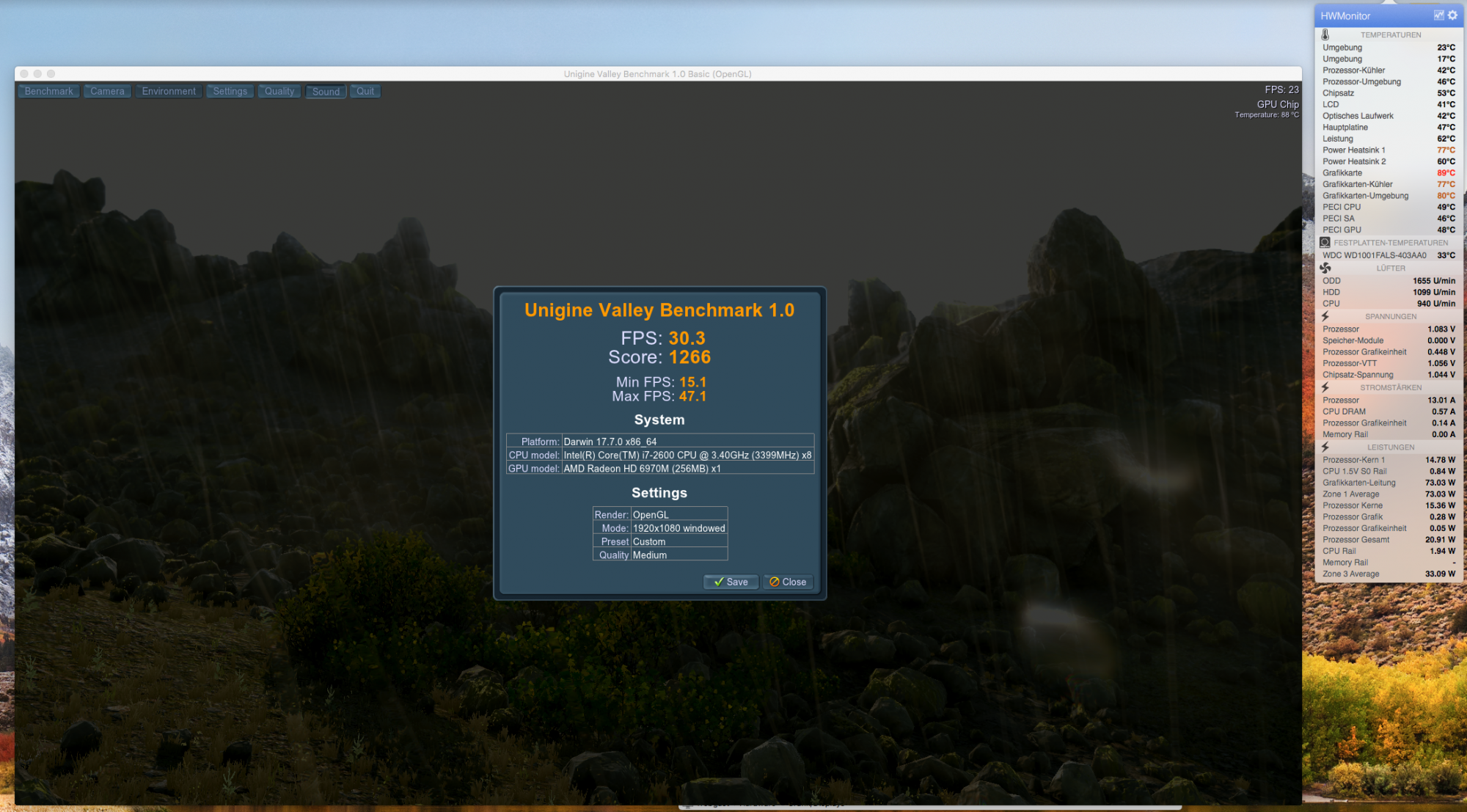

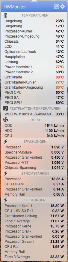

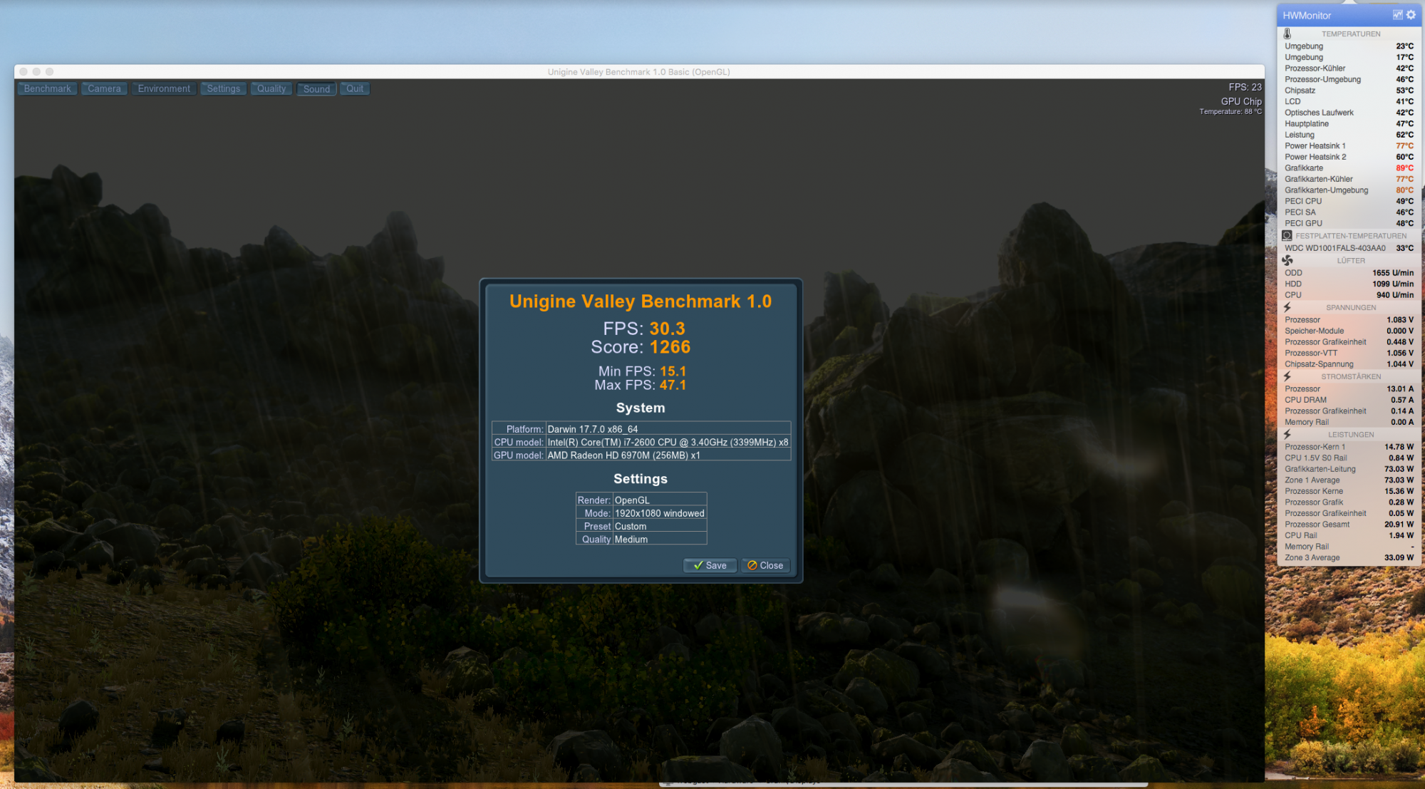

How to kill a Radeon 6970M?
Today I bought another used (announced to be defective) 27 Mid 2011. After opening the system it I found out that the connector cable from logic board to power supply was not connected into the power supply. Reconnecting it and the system runs like a new one.
Now the interesting part. I booted Catalina (Valley did not run at all) and later High Sierra to make a Valley benchmark. Got 30.3 FPS and 1224 Score, compared to the AMD cards lame, but enough for browsing. I let the Valley run for not more than 30 minutes and got the temps as shown on the attached pictures.
It becomes crystal clear why such cards died in numbers so fast. ODD fan did not came up more than 1644 rpm but temps hit 90C very fast, heat sink at 77C - I never had such values with the 780M or RX480, especially after moving the ODD temp sensor onto the heat sink and using the very same Apple SMC software.
Not even my RX480 gets that hot during a 70W valley run.

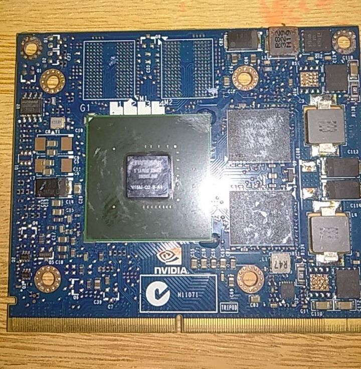

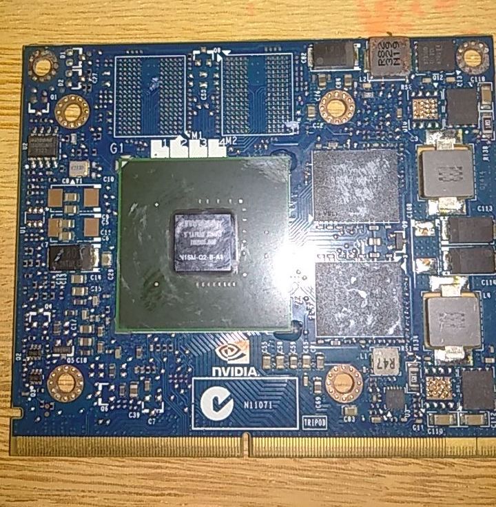

Hello, everyone. First, thanks for everyone who contributed to this thread, specially OP, @Ausdauersportler (nice guides and tuts!), @nikey22 and @Nick [D]vB (I hope you are OK, someone posted you were hospitalized recently), @xanderon and @highvoltage12v.
I got an used K610M board recently (MXM A, it identifies itself as a GK208 board - IIRIC it was made for some HP notebook) and tried to install it on an iMac 21" mid-2011 (iMac12,1), but although I can flash the custom VBIOS and the board is detected, there is no video, as explained below.
Board info
Code:
Adapter: Quadro K610M         (10DE,12B9,103C,2256) H:--:NRM  S:00,B:01,D:00,F:00
EEPROM ID (EF,3012) : WBond W25X20A 2.7-3.6V 2048Kx1S, page
WARNING: Firmware image PCI Subsystem ID (106B.1026)
  does not match adapter PCI Subsystem ID (103C.2256).
Please press 'y' to confirm override of PCI Subsystem ID's:  y
Overriding PCI subsystem ID mismatch
Current      - Version:80.28.54.00.02 ID:10DE:12B9:103C:2256
               GK208 Board - 20390504 (Normal Board)
Replace with - Version:DE.AD.00.BE.EF ID:10DE:12B9:106B:1026
               Quadro K610M by Nick[D]vB (Normal Board)
Factual data:
1. The iMac was tested with a stock AMD card and it was working normally, I have installed Mavericks and upgraded to the latest High Sierra to make sure firmware/SMC are up-to-date
1. If the iMac is started with the K610M using the VBIOS that came with it or the version from #5750, neither the graphics card nor the LCD panel (obviously) are detected. Boot and clearing PRAM are as fast as normal, but it seems that macOS does not start at all, I can boot Linux only (without video).
2. After flashing the custom VBIOS, booting and clearing PRAM takes much longer, the LCD is detected, it turns on the backlight but no video at all. macOS starts loading but it restarts itself before finishing (I have set up automatic login and screen sharing for testing)
3. I can startup in Safe mode, but still no video (same as above). The board is identified with the custom VBIOS, but the display is shown with a weird resolution (1280 x 1024 IIRC) when I connect remotely via screen sharing
4. It seems that there is no external video in any case
5. I can flash the original and PC VBIOS from #5750, verification says it is fine, but when flashing the custom Mac VBIOS I get the same error shown in #4363, so I guess it is normal. Using the (much) newer nvflash for Linux does not seem to make any difference. For some reason, the board is shown on macOS with the custom VBIOS as being 1023MB.
The chip used in the board is N15M-Q2-B-A3 (not A1 as shown in the custom VBIOS post), it makes any difference?
I have searched all this thread for K610M and found nothing special. It seems that some boards do not work with some Macs, even tho they seem to be fine. I have seen many reports similar to mine in this YouTube video, so I guess K610M won't work all the times. Maybe there is some VBIOS configuration or version that would fix those, or at least find a way to avoid problematic boards.
If anyone knows if this can be fixed, please drop a line. If there is no fix, at least it will be here as a report to help others. I am not sure if the board is OK, so perhaps mine is just a faulty card.
Regards
The K610M is a very weak card, and was more a proof of concept project really. Its only operates at 8x and has limited vram. I've never seen the -A3 variant.
Did you save the initial vbios that was on the card? VER:80.28.54.00.02
Send it to me, I will take a look at it. It could be a vram issue.
The K610M card that I used to develop the vbios used SAMSUNG ram, specifically: K4G20325FD-FC04.
I can make out that your card has hynix. So this will need to be looked at obviously.
Hey, @nikey22! Thanks for your reply. Yes, it seems that it uses hynix indeed (2 chips at both sides). Attached is the original VBIOS the card had in a ZIP file, it is much smaller than the one in the TechPowerup website.
Regards

I posted the report.
Can anyone tell me what happened and how I can solve the issue?
I don't understand the reports and can't help myself, so any help is more than welcome.
All the best and thanks in advance
Ekki
Good morning Canada!
This becomes an ongoing issue, can you make a short list of memory supported currently with each NVIDIA card? I will add this to the table on post #1 🙂
Thanks again, will I be needing CH341A for flashing vBios? or no?
The most important thing is that whether the GPU can POST in your iMac.
if it does, read the first post for the various options of vBIOS flashing.
My experience with the Dell WX4130 is that the Dell PC vBIOS (unflashed) can provide an external display image.
So, you can see the Linux flashing process on an external monitor connected to your iMac miniDS port.
If not, the ch341a may come into play. But I am not certain whether a non-POSTing GPU can be made to be POSTing by flashing. You have to try for yourself in such circumstances.
Ekki
You can put such panic reports into [SPOILER=„My really important panic report“]The long an winding report[/SPOILER]. It make posts more readable...
Can you comment on (patched) extensions you have installed additionelly to the stock High Sierra?
Reactions: Umarx
No, if the GPU refuses to POST (i.e. let the system turn on and play the starting chime) than it does not help to flash another BIOS. We tried this some time before with empty BIOS files (only containing a valid header). No changes. I guess we have to look into the iMac firmware in that case.
Reactions: Umarx and KennyW
That is also my experience. I have a non-POSTing Dell WX4150 and a HP WX4150, both of which can't be made to work despite my successful flashing with ch341a. But my experience is limited, unlike the more definitive findings of our developers 😉
