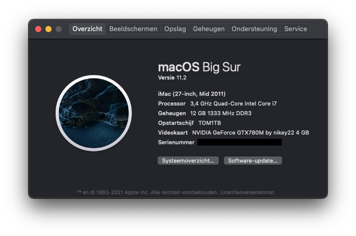

I think the picture says it all? :cool:
Very smooth installation on an external SSD for now, after installing the post-install patches it seems to work as it should.
As said in the description, the iMac will kernel panic when using the regular bootpicker, but the OC bootpicker does it's job and the iMac boots into Big Sur without problems.
Im going to try it out for a week and if all works well, I'll finally upgrade for real from Catalina to Big Sur as my second daily computer. It's fantastic that my 10 year old iMac now runs the newest OS, and it does it well! I rarely use my 2019 16" MBP since my iMac can do all tasks which I need it to.
Thank you @Ausdauersportler and of course the other dev's for putting this together.

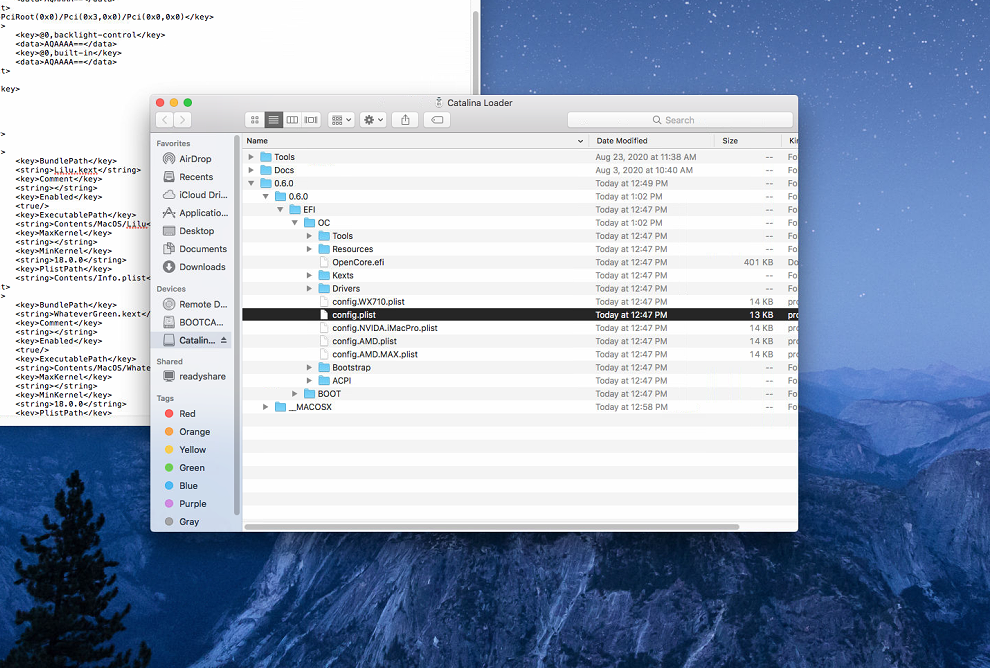

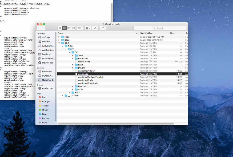

EFI folder must go to the root of the Catalina Loader. Move out and read docs :)

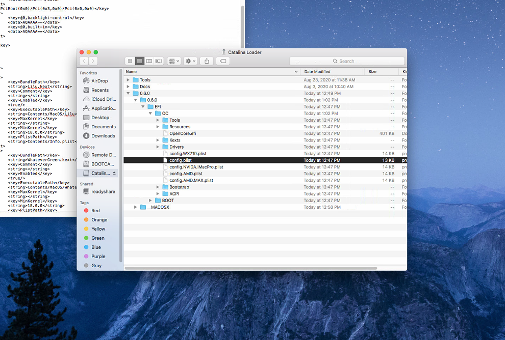

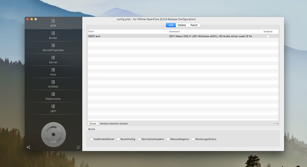

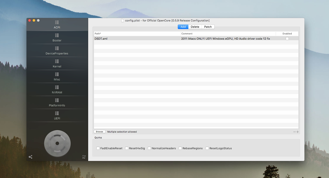

Thanks! Got it... Now the issue is that I downloaded OpenCore Configurator to enable the DSDT audio patch, but when I turn it on with the nvidia config.plist I get a stop code ACPI UEFI ERROR. Hopefully it's because I have the AMD card installed? I tried with the AMD config.plist and I got an ACPI BIOS ERROR stop code. Sorry for all the questions! The boot process seems much faster than when I was on BIOS mode, and I also dropped the Timeout from 10 to 5 seconds.
First, move on to a more recent version and second this patch should work with 27“ 2011 iMacs, only. The timeouts are needed because some vBIOS versions have the same timeouts and you would not see a picture before the 5-10s are gone.
The patch is needed for UEFI windows installations, only. BIOS installations do not suffer the sound driver problem.
