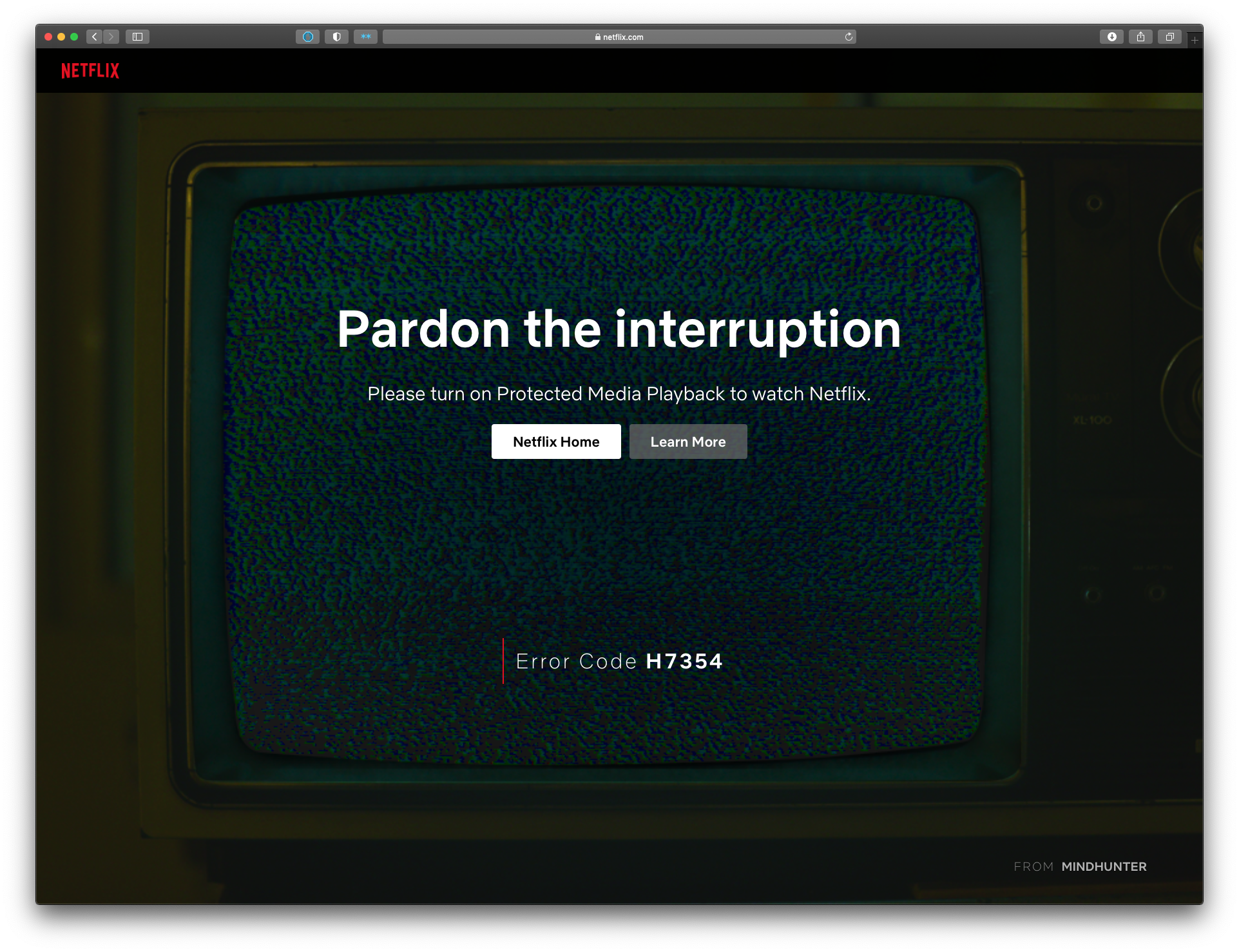

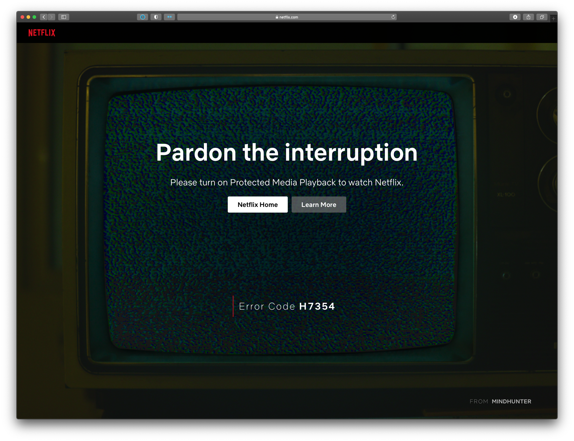

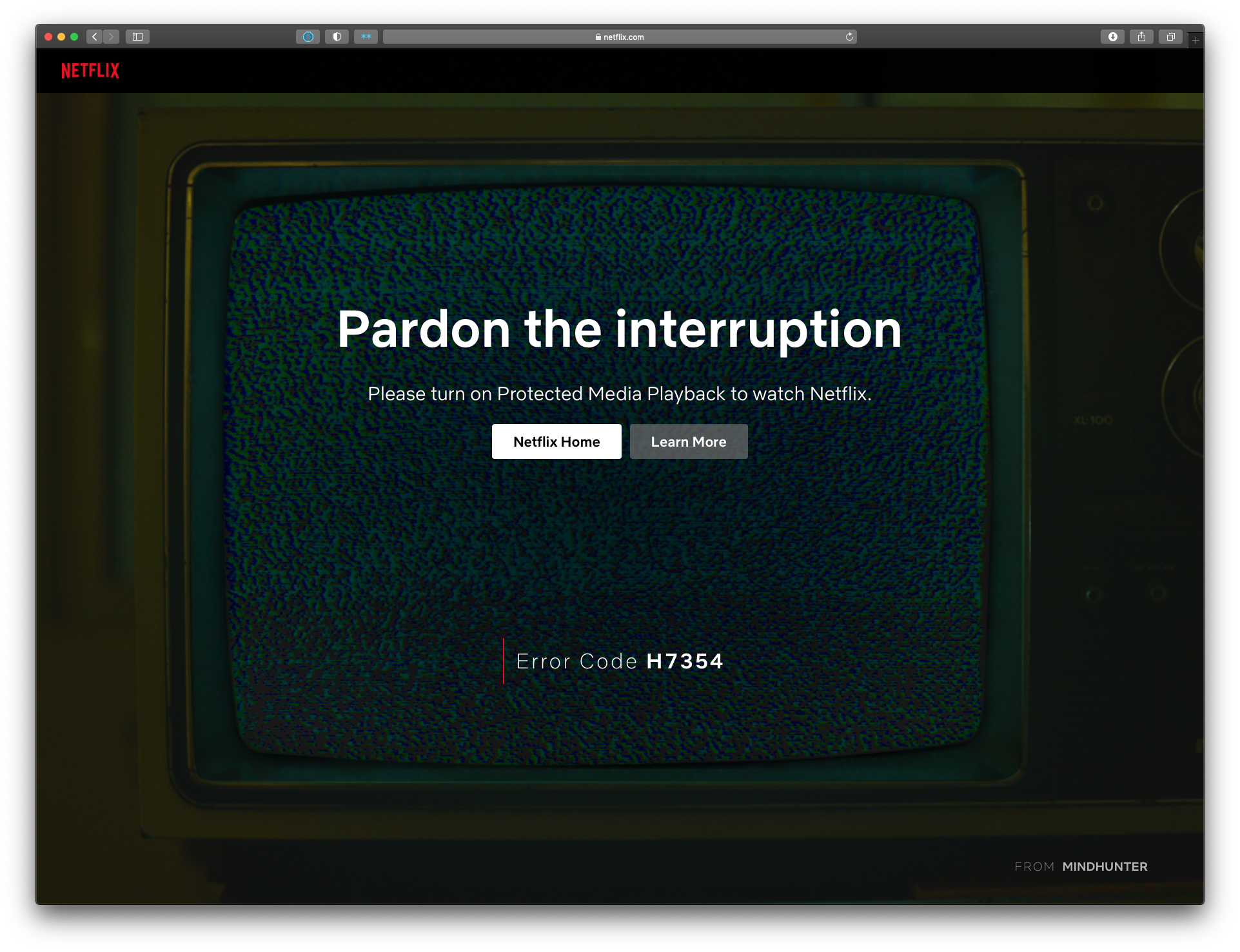

I don’t understand very well about DRM on Nvidia cards.
It’s not posible to watch Netflix/D+ on safari, no?

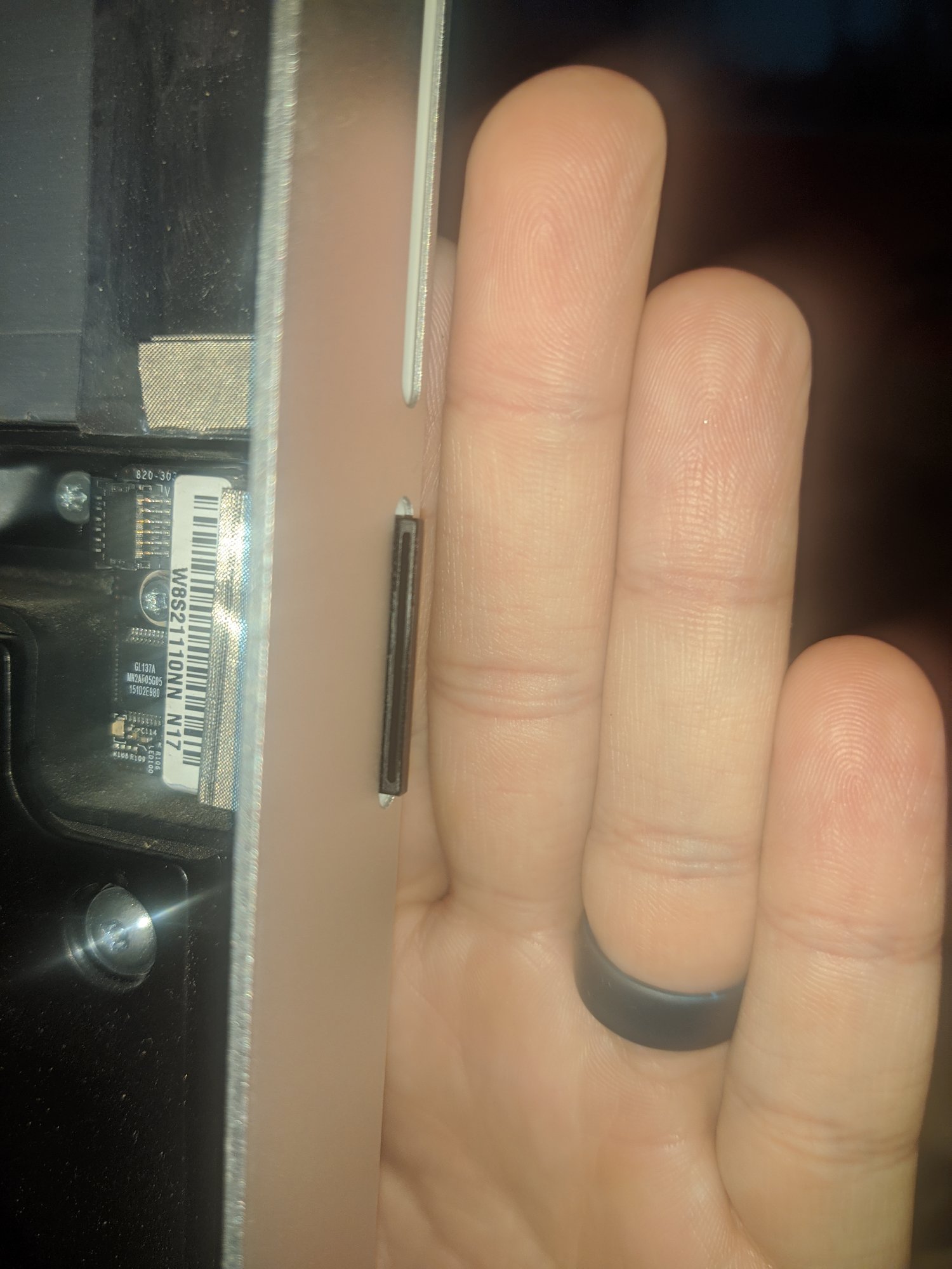

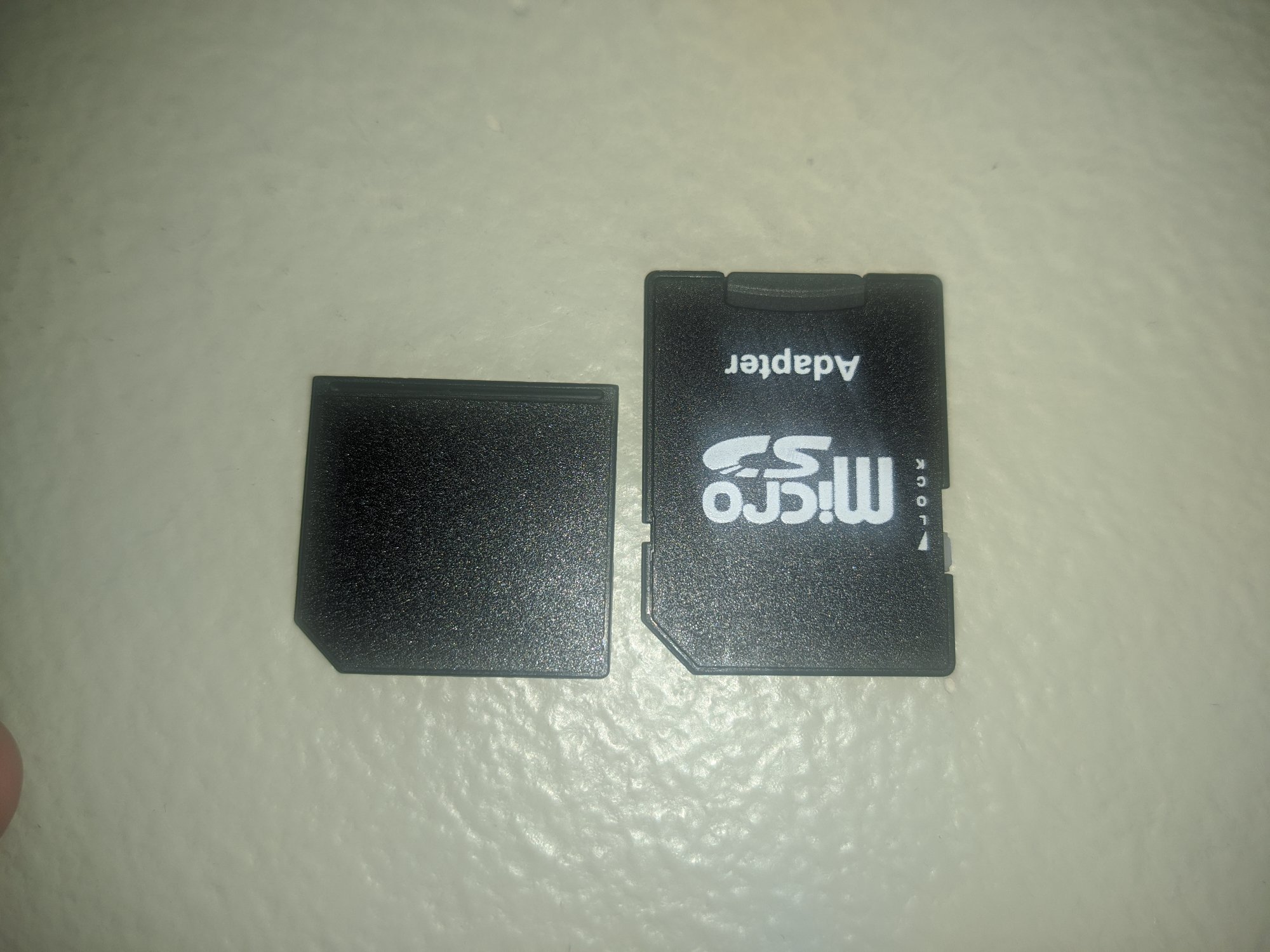

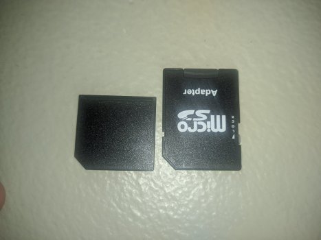

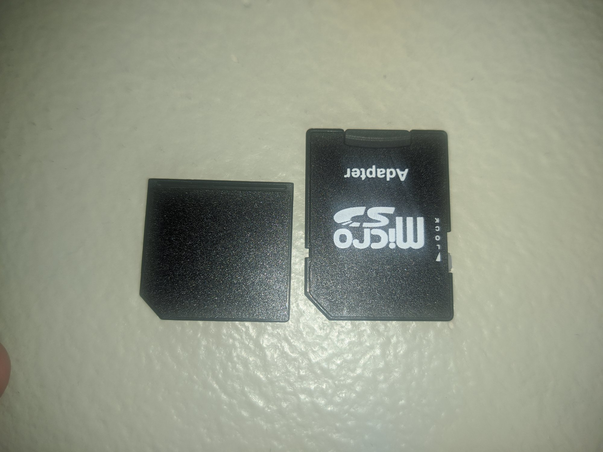

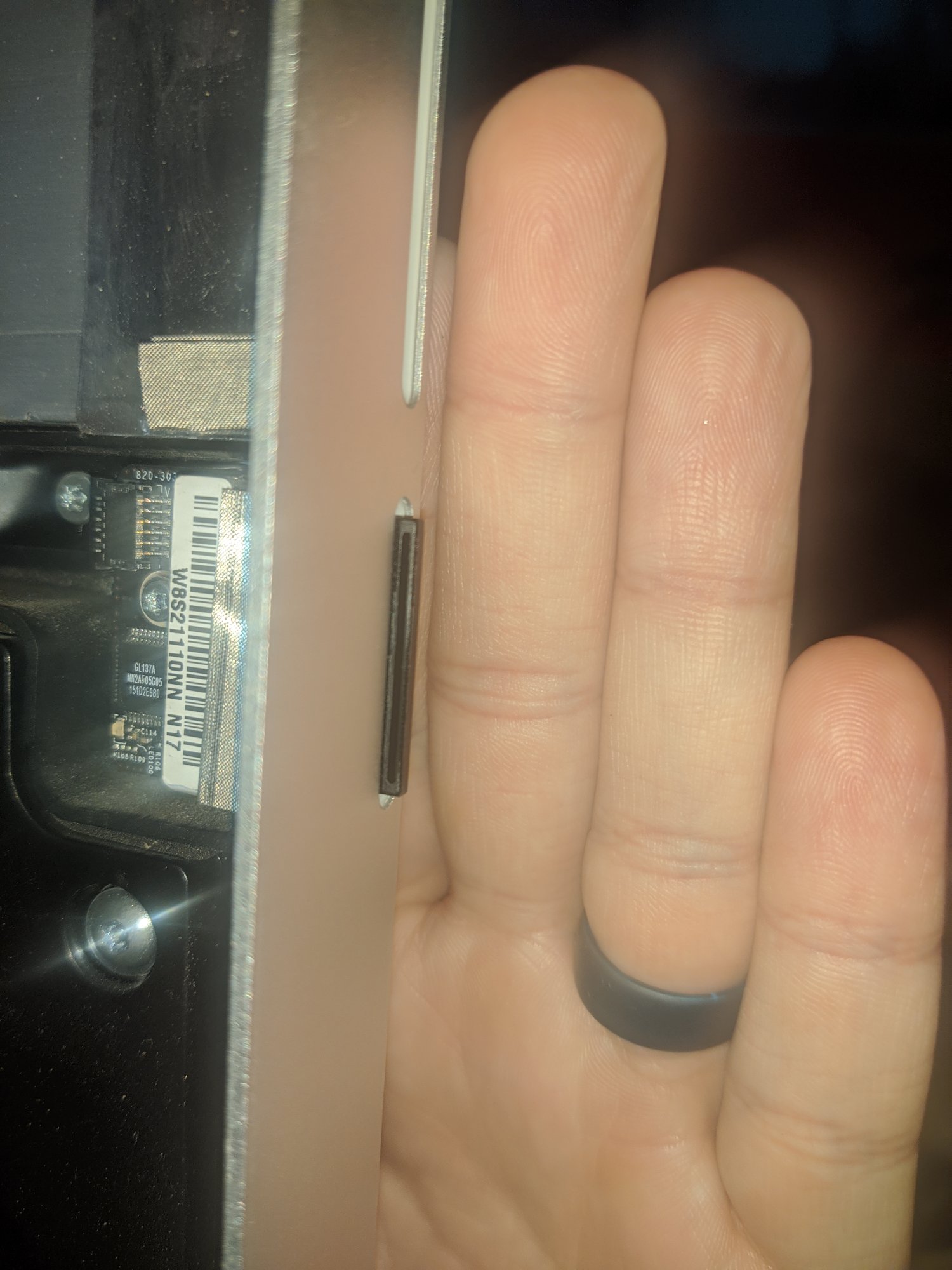

SD adapters arrived and are a perfect fit! Stick out approx 1mm, just enough to remove it if necessary.

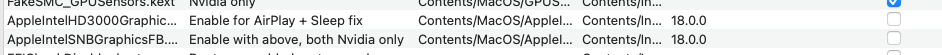

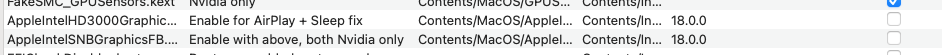

Installed the lastest EFI from @Ausdauersportler 's Catalina Loader post
- I don't have the Sleep Kexts to select anymore so sleep doesn't work 🙁
- Dim blacklight it's fixed and working 🙂

Before I update the EFI folder with the latest one from your post I had these kexts on the Configurator which I had to select to get Sleep working, but brightness was dim.
- AppleIntelHD3000Graphics.kext
- AppleIntelSNBGraphicsFB.kext
Now that I update the EFI folder I get brightness working but the Sleep kexts is missing for me to select and the slepp isn't working.

Okay, you mixed a broken very old OpenCore setup and a broken not so old Big Sur Patcher (broken for 2011 iMacs) and got a working iMac 2011. This is nearly a miracle.
Please compress the old EFI folder and load up and please make a screen shot of /System/Library/Extensions of Big Sur sorted by date - I need to see which files have been patched into you system.
To solve your current sleep problem just pick the AppleBacklightFixup.kext from the new and copy into the old (sleeping) OC config and use the old one for now.
I advice to use another patcher to come back on track.

I will try now thanks for the help... 😀
update: Same thing: dimmed.
Now I remember that by disabling the AppleBacklightFixup.kext it only disabled the Hud and Hotkeys, but I think it was working on Control Panel

Can you please copy out of /System/Library/Extensions of Big Sur both the AppleIntelSNBGraphicsFB.kext and AppleIntelHD3000Graphics.kext and compress and upload them, too.
You have both installed by the patcher and have to use another older one via OpenCore injection.
Thanks in advance

1. Safari / Preferences / Advanced / Show develop menu
2. Go to Netflix
3. Develop / User Agent / Microsoft Edge
4. Netflix works in Safari 🙂
You can setup a keyboard shortcut to open Netflix and change the user agent, so you don't have to manually select it each time. Maybe you could ask the developer of Friendly Streaming to add a feature to set user agent manually in the app, its not that complicated to implement i believe.
This almost works for me in Safari 14 on Mojave - the (annoying) trailers in the main Netflix menu start playing, which they don't with Safari as the User Agent, so something is obviously working better - but then I get this message telling me to turn on Protected Media Playback, which obviously I can't because I'm not actually using Edge. Did you encounter this or find a way round it?
Tried Firefox + Chrome as user agents too but Edge seems to get the closest to playing it.
I just quickly played around with the user agent settings to see if the video starts playing or not. I will check for a better solution.
Edit: looks like DRM protected content does not work. Yesterday i tried it with some random movie and that played fine with different user agent, but looks like most of the content is protected.

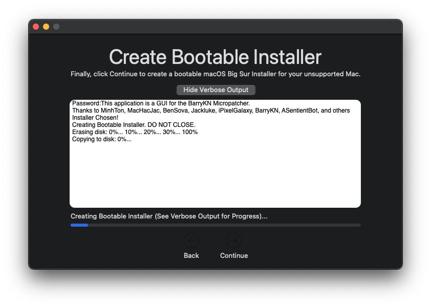

Hi all!
I did something evil, binary patched a Big Sur GUI patcher to include the Big Sur iMac micropatcher to get a (hopefully) completely command line free installation of Big Sur. I need volunteers to test it:
Have fun and report back.

Damn thanks for making this! I just tested it out and feel like I must be missing something fundamental (like the installation of OpenCore, does this not do everything involved with that?)
I made a bootable USB using the tool, Installed Big Sur on a fresh APFS partition, went through the installation, rebooted into the USB to do the post install patches and then rebooted into the Big Sur partition.
Now it won't get past about 10% on the Apple logo boot screen.
I'm trying to dual boot with a Mojave installation that's still using MacOS Journalled - I wonder if that might be causing an issue? I ran into the same problem when trying to install using your command line patcher, followed the step-by-step instructions twice to no avail.
Again thanks for putting the GUI tool together, I'm sure its something wrong I'm doing on my end!
I am not sure if the Mojave HFS partition affects in any aspect the Big Sur booting.
You should boot in any case the EFI partition of the patcher USB (this is your new boot selector for Big Sur) before booting into the Big Sur partition. You need to do this with the installation at first and with the installed Big Sur later. There is no way around this.
The OC was simply a choice to keep it simple - 90% of the possible config need OC today. Possibly I will work in the auto detection to get around this for the 10% remaining.
