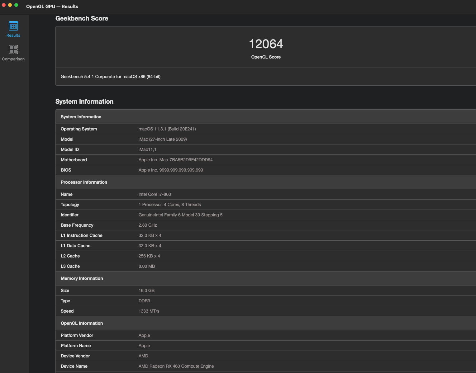

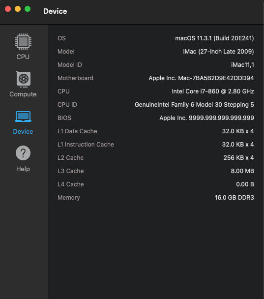

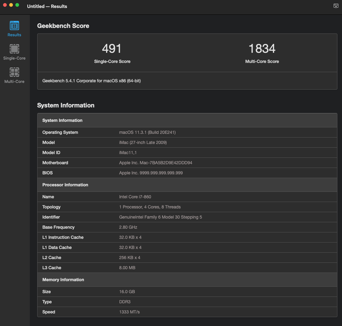

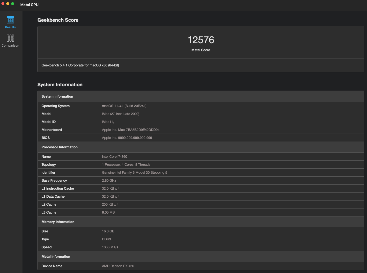

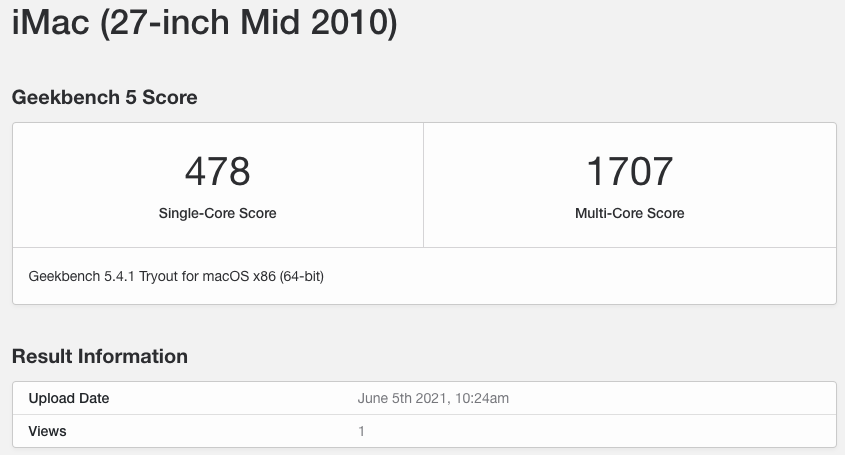

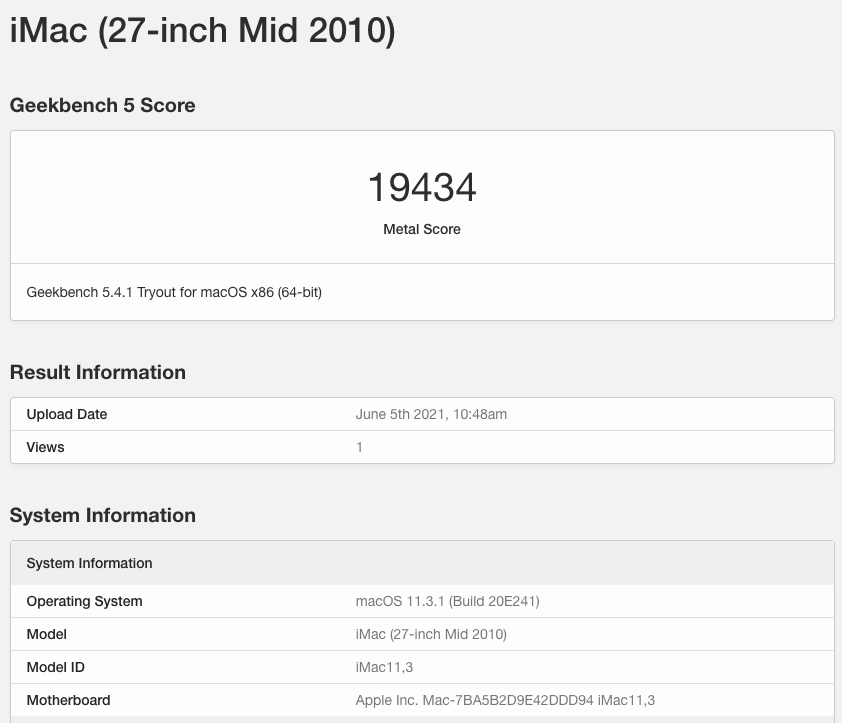

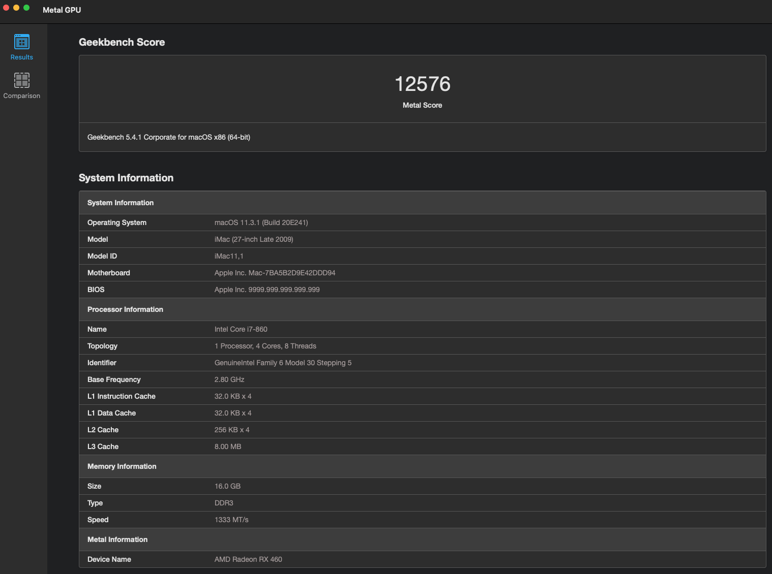

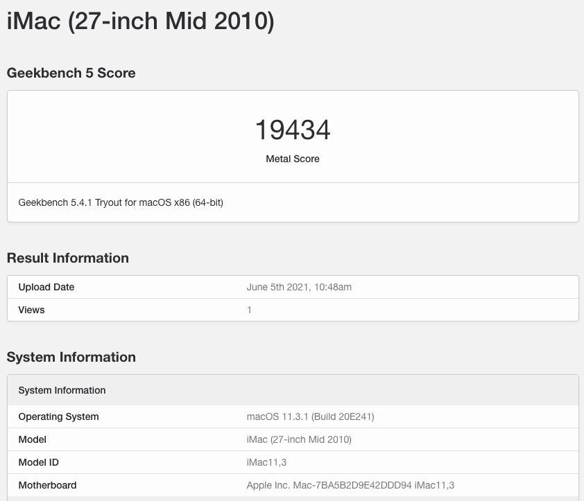

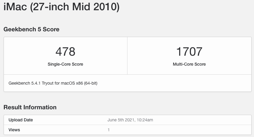

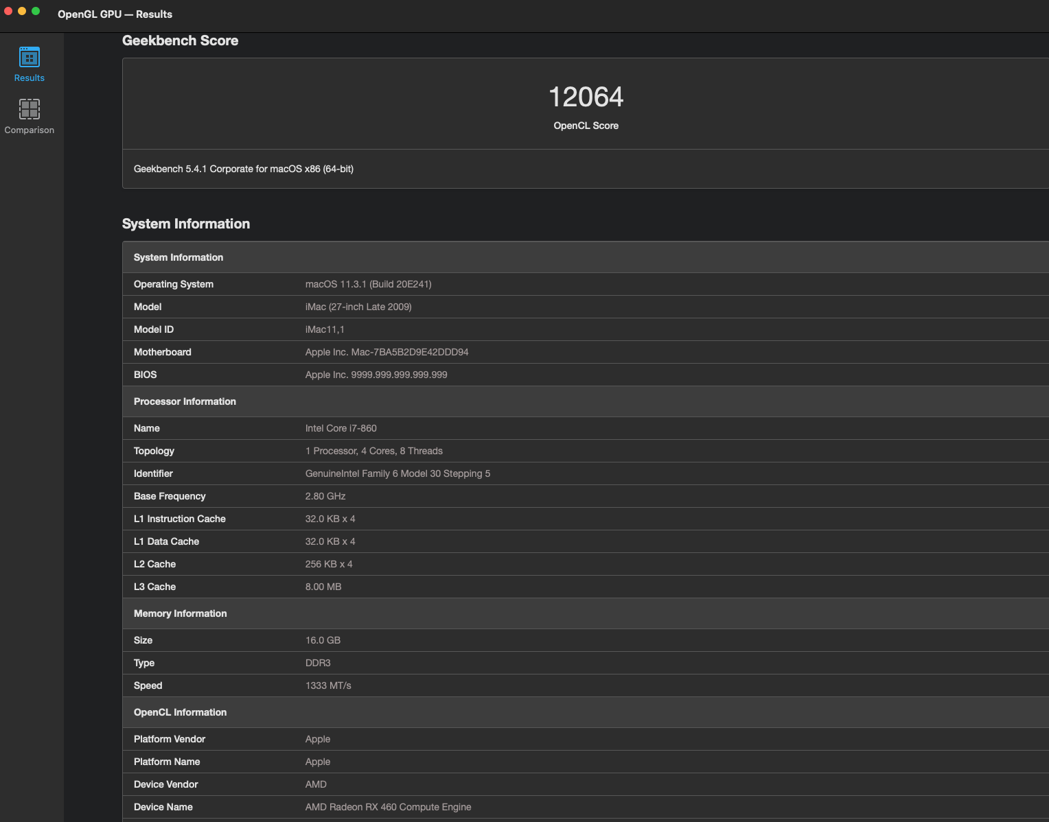

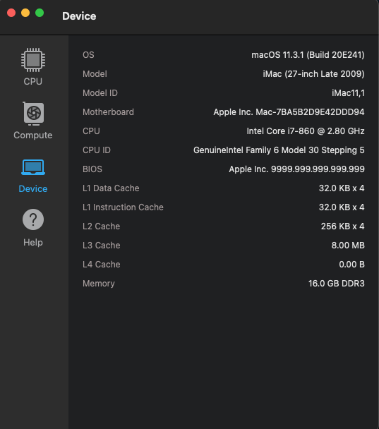

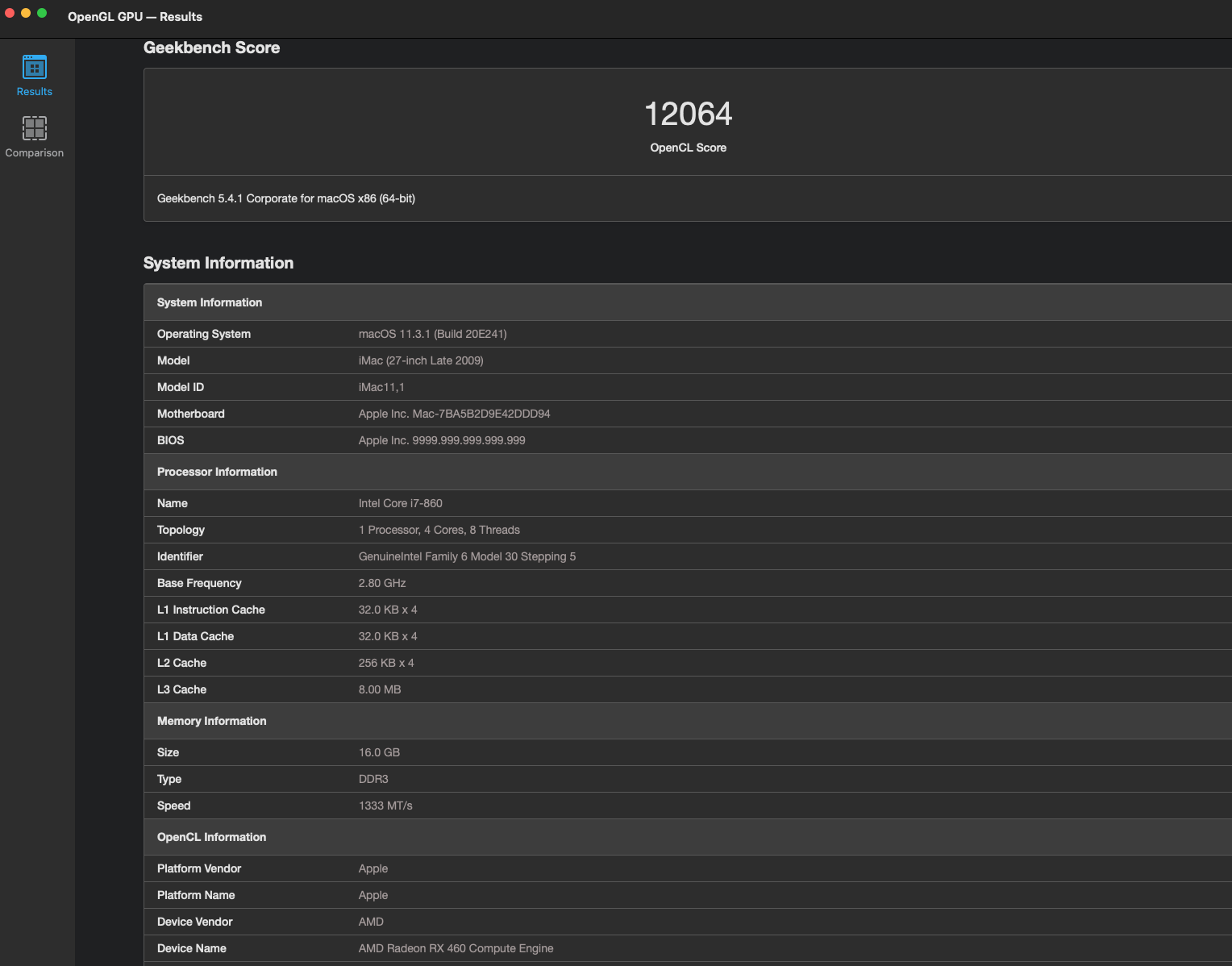

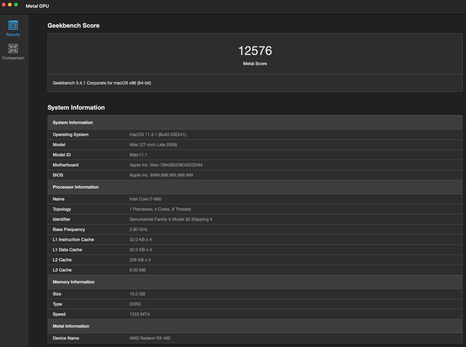

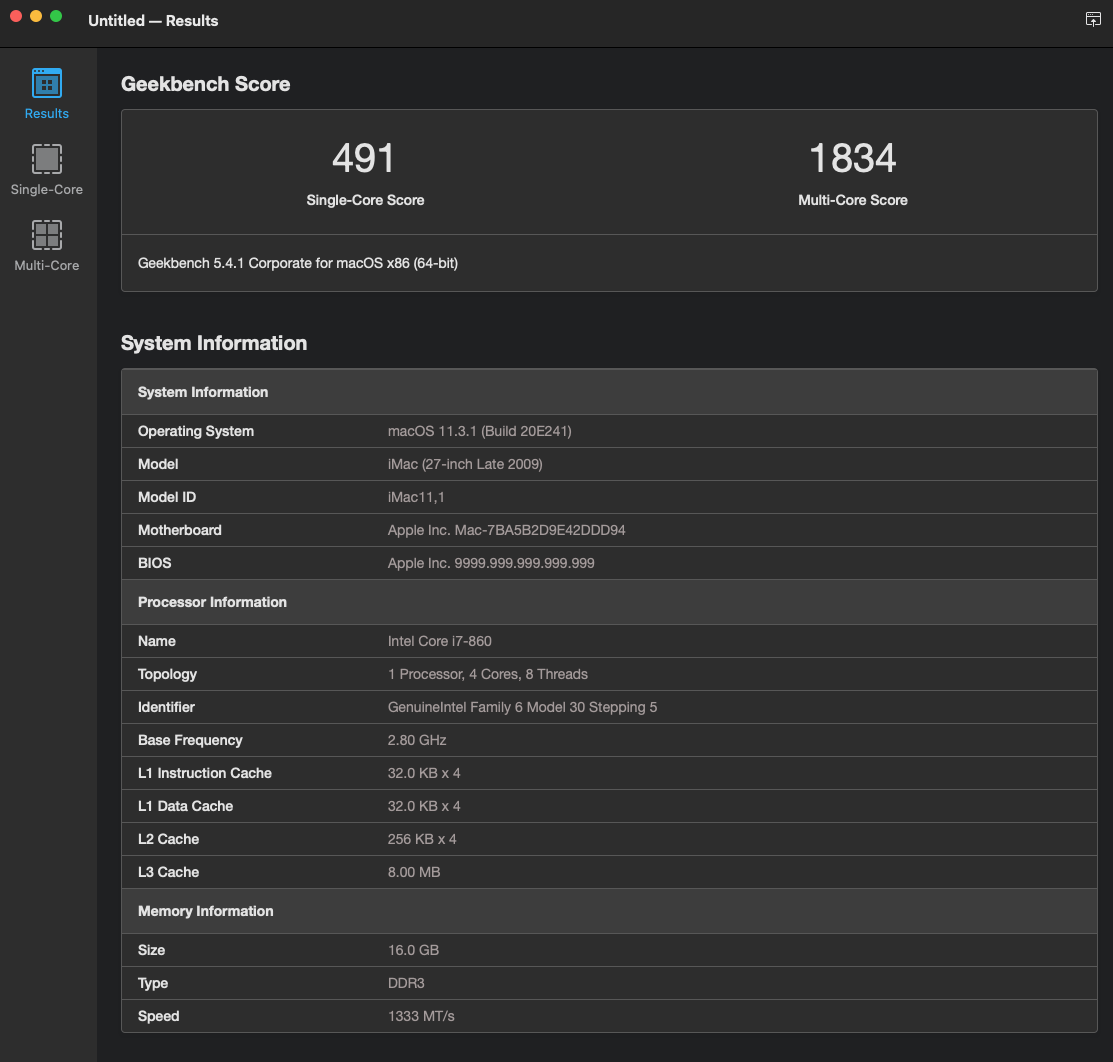

Hello All,
Following on my successful installation of the Dell Green WX4130 2GB (With flashed ROM from first page) into my iMac 11,1 Late 2009 27inch i7. Here are my GeekBench scores, the CPU is going to be on the low side due to the age, however I think the GPU is very impressive. GPU Temp has been very stable (40 - 50 degree temps).
I've been running Big Sur via Open Core v0.1.4 and haven't had any issues to date, it even did the 11.4 update natively without a glitch.
As I mentioned a few posts back the card wasn't cheap £100/$140, and also trying to find the correct one was pretty hard. It's very very quick for it's age and the GPU is better than most new modern Macs, more than adequate for my needs. I might upgrade to 32GB RAM (maybe overkill)
What? 12576? Insane!!!
I thought so too, so I had look at the other GPU's on the GeekBench site, as I didn't believe it, although it's not patch on the crazy expensive gaming cards. It pretty much beats anything in this range that fits this iMac.
It's completely native too, no kexts edits, patching. Other than the OpenCore Legacy Patcher which takes 1 minute to setup or either USB Stick/SD Card or you can install on the main Boot disk.
2k Videos, games, etc run so smooth, no glitches or anything. I'm very happy so far and again appreciate the efforts of those that made this possible and not to mentioned those who helped me narrow down what card to use.

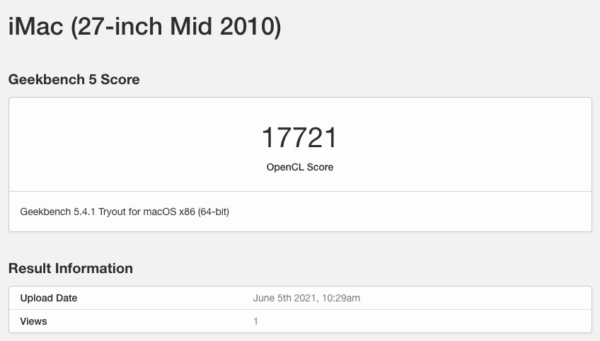

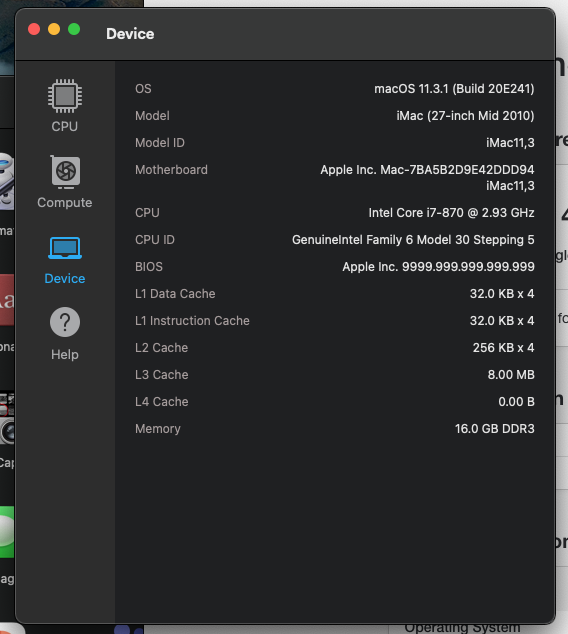

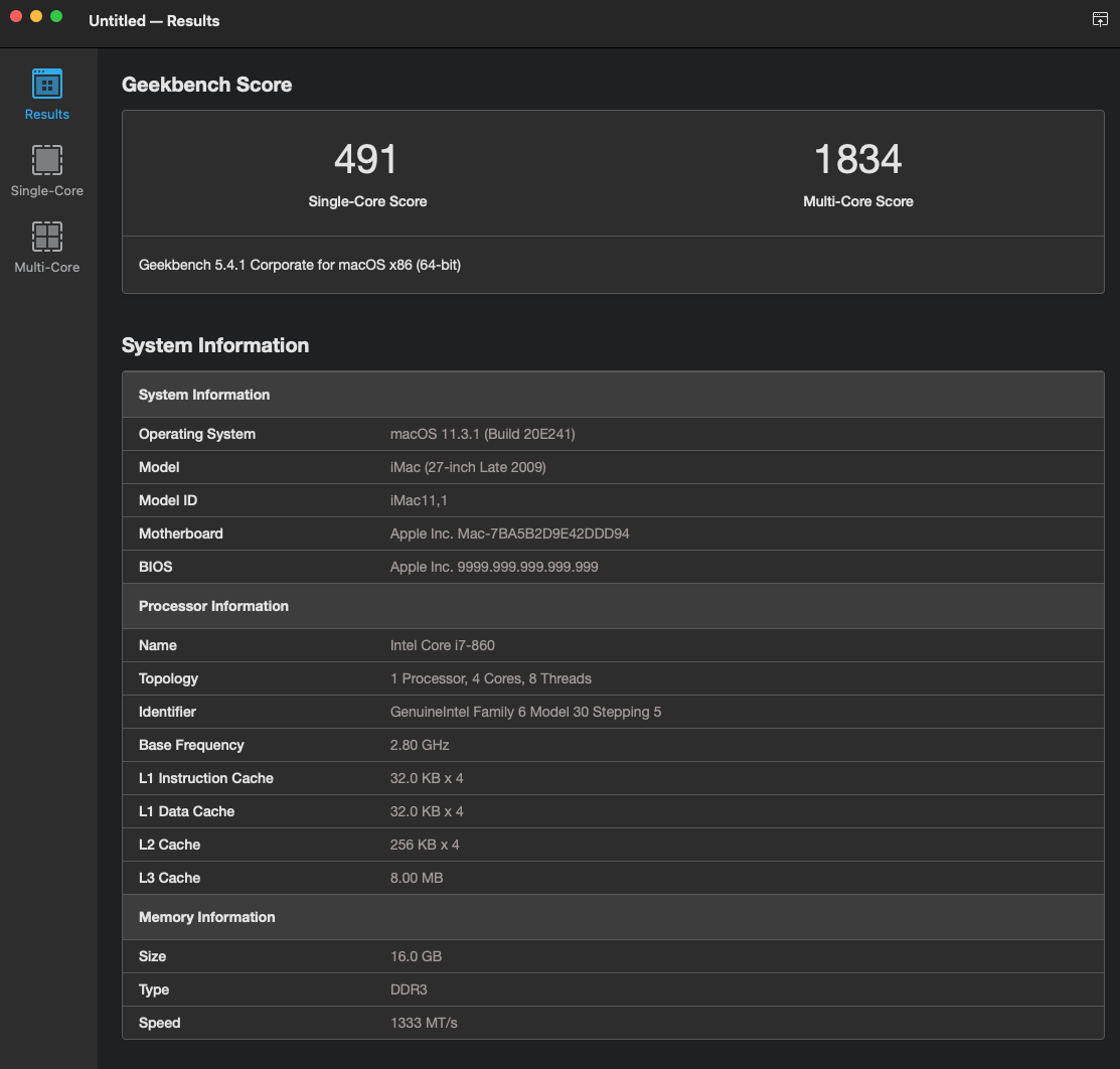

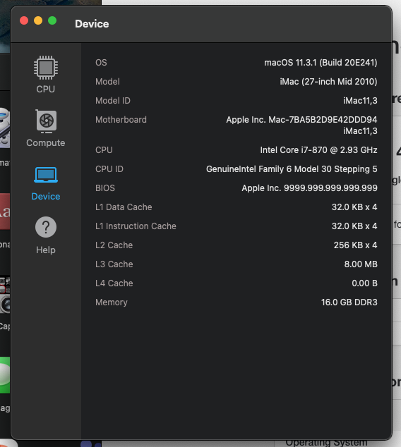

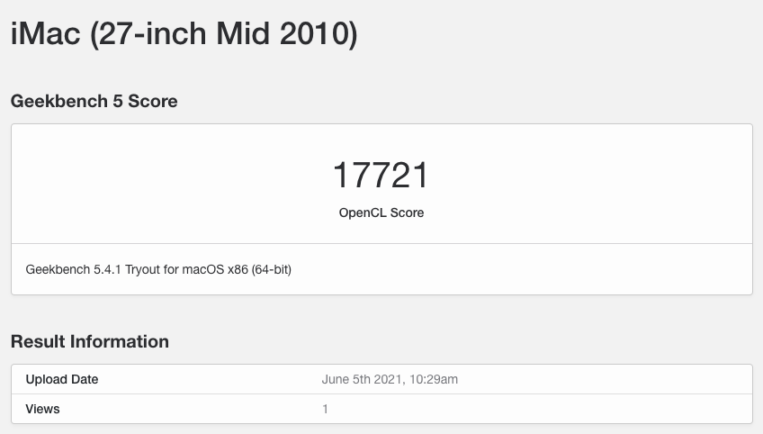

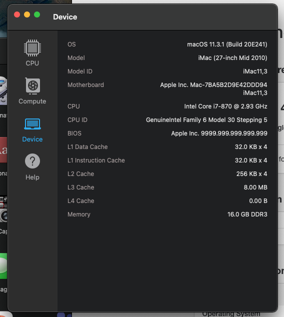

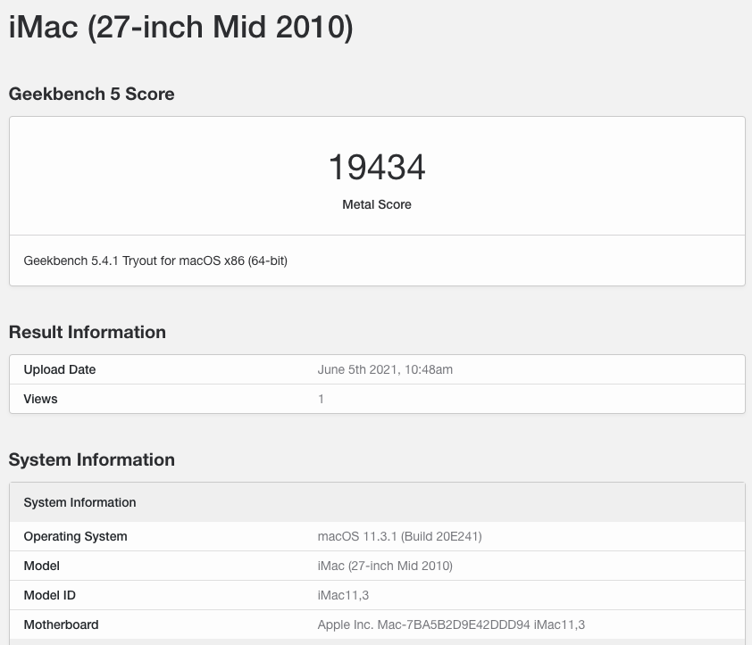

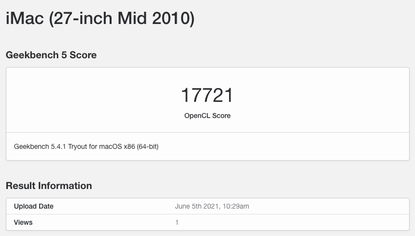

I have the same card in a 2011 iMac and i got 17234 on geekbench metal. So looks like the CPU might be your bottleneck, as mine runs a newer i7. With an i7-860, i think the max memory is 16gb, no? Here is the product spec from intel, it says 16gb max for 860: https://ark.intel.com/content/www/us/en/ark/compare.html?productIds=48501,48500,41316
Would be interesting to see if you could run i7-880 or the xeon X3480(which supports 32gb ram) and see if that would bump your max ram support, and also improve your metal score(probably not). Its not that expensive on ebay: https://www.ebay.com/itm/384081922956?hash=item596d110b8c:g:bFsAAOSw6bpgbSYy & https://www.ebay.com/itm/324658666855?hash=item4b972a1d67:g:8hoAAOSwrR1guUzk
Edit: i7-880 does work, based on this: https://mac-yak.com/2019/03/19/upgrading-a-2009-imac-cpu/ - and looks like a nice bump in performance based on the benchmark scores. So the question remains for X3480 and 32gb ram :)

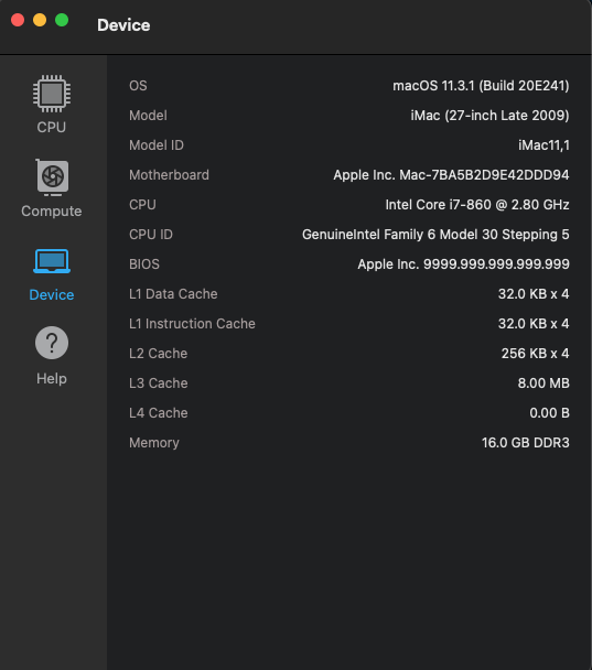

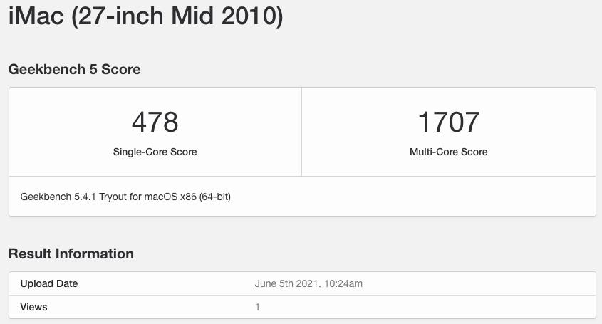

Your issue might be the DDR3-L memory, i would try with normal DDR3, that should give the CPU a boost to match mitesh33's results. Or upgrade the CPU as i mentioned above :)
I've got a CPU with higher specs (core i7-870 vs i7-860), but lower benchmark score.
I doubt about getting better score with slightly more powerful CPU. i7-880 and Xeon X3480 are also much rarer and more expensive than i7-870. I'm just happy with the current result.
