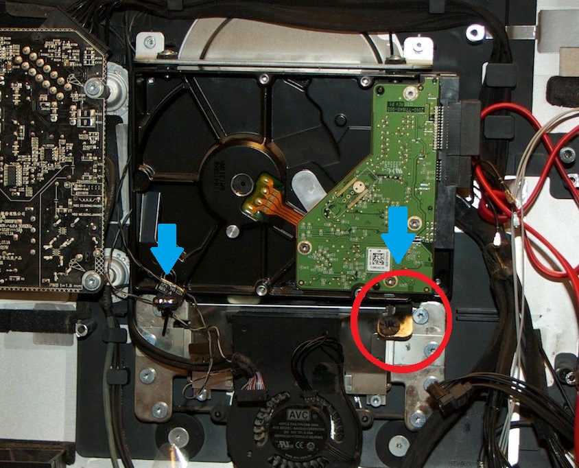

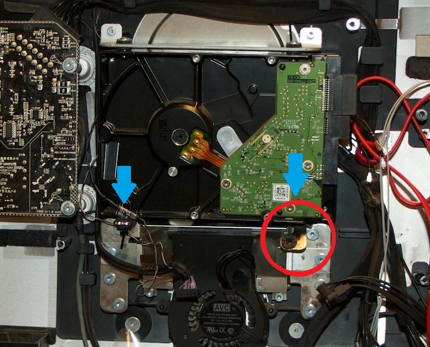

With extreme dedication, the logic board replacement could be accomplished but both the cost and effort might be prohibitive. You also need to align the different external ports on the chasis. Better save the money and energy perhaps for an actual iMac 2011 if you can find a cheap one, or even the M1 Macmini.
The doubling of the SATA speed doesn't have any discernible performance gain if you have been using SSD in place of the HD. While you can't add Thunderbolt to iMac 2010, you can perform a USB 3 hack as I do:
However, no PCIe USB 3 is bootable. They are good only for file transfer and backup but meet my need.
I do want to try this, but don't want to drill out the side of my iMac. All the low profile risers you had linked aren't available anymore though. I can't put the usb card in the CD bay since I want to put the iBoff board there when it eventually comes out so thats not an option for me anyways. Maybe I'll get one of those shelves that attach to the iMac stand and put the riser and usb card there, but I can't figure out a way to keep the airport card inside the iMac and do that
