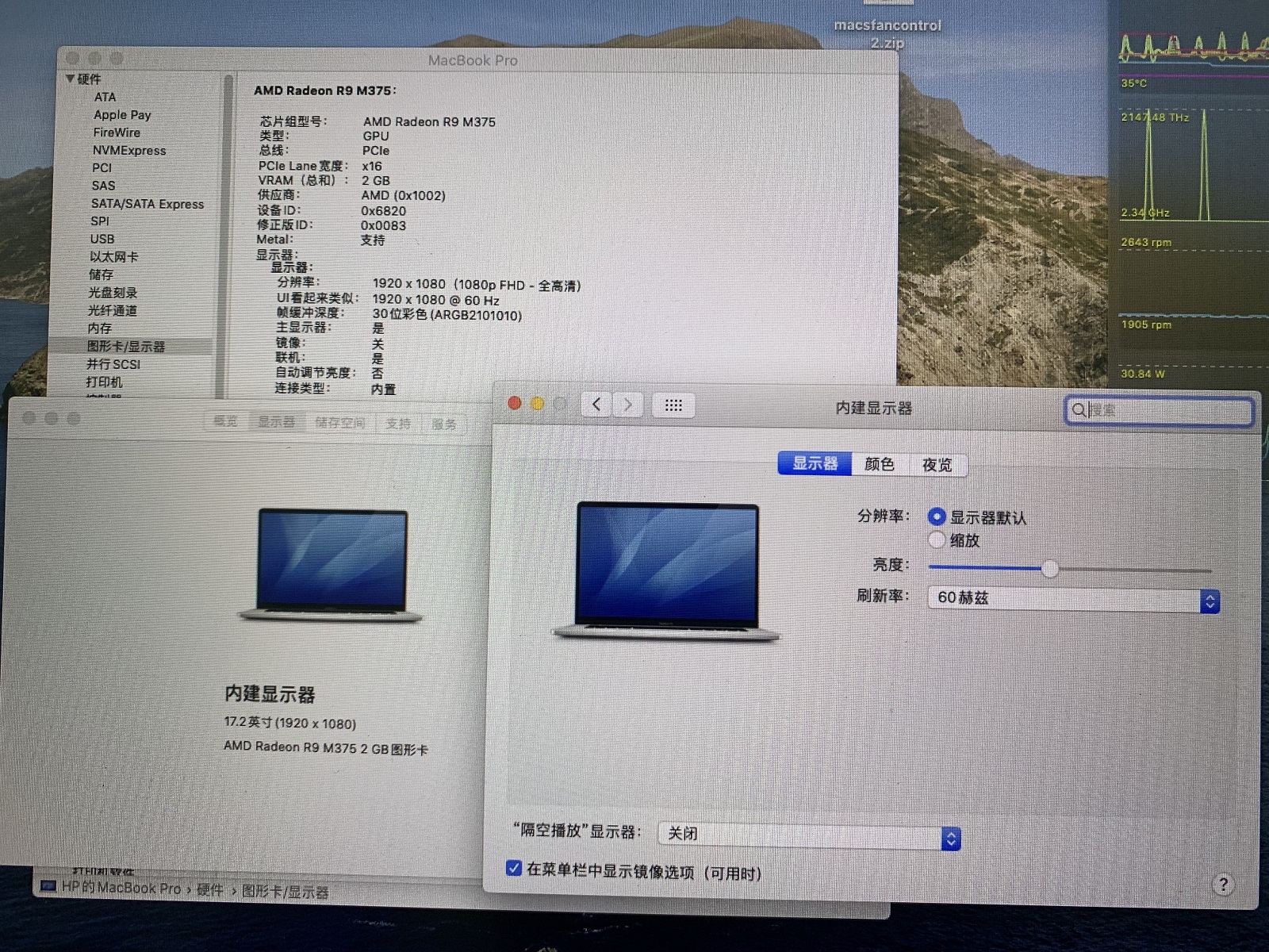

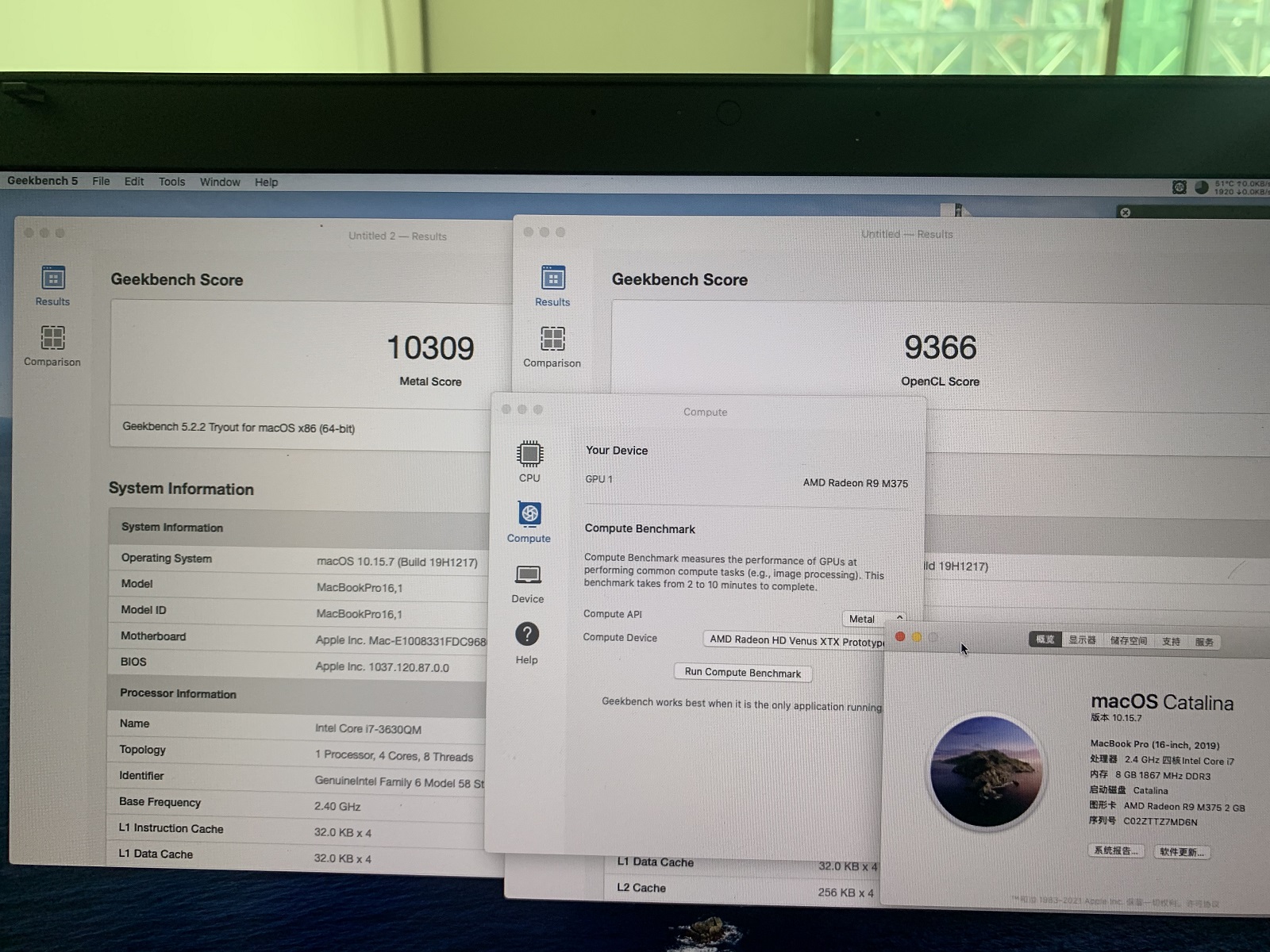

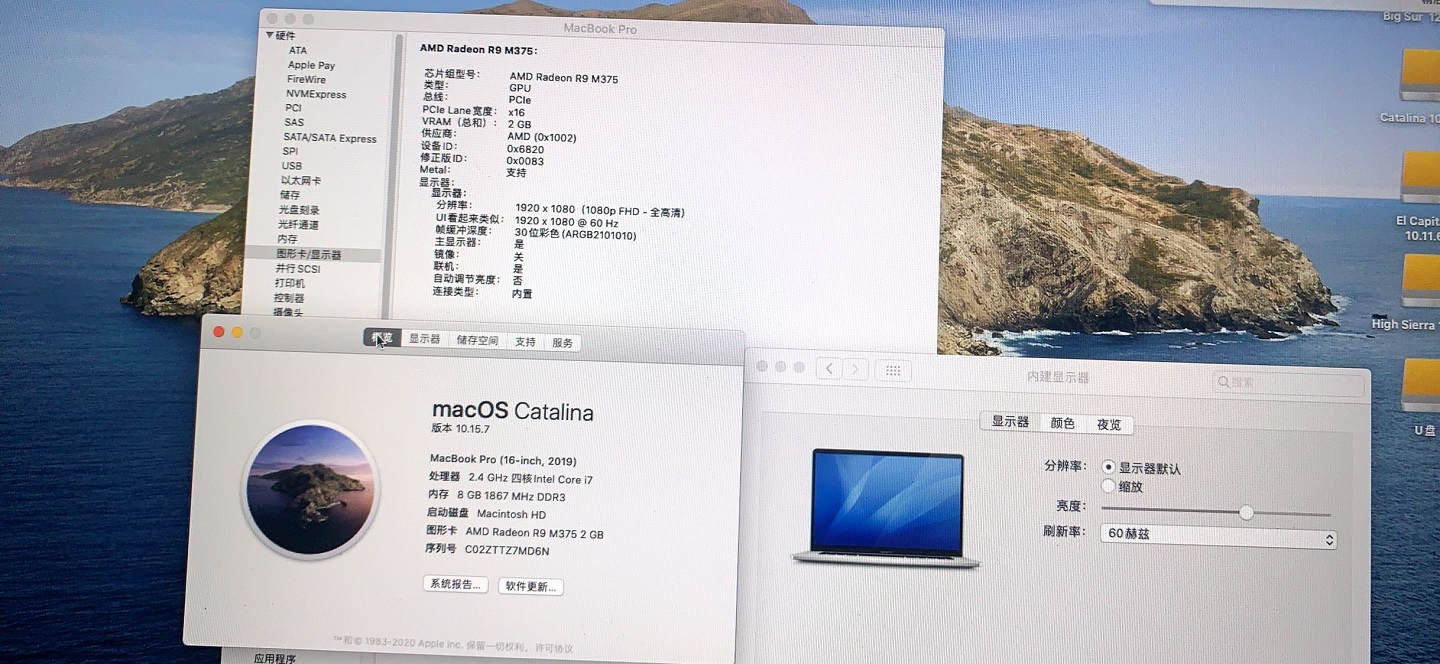

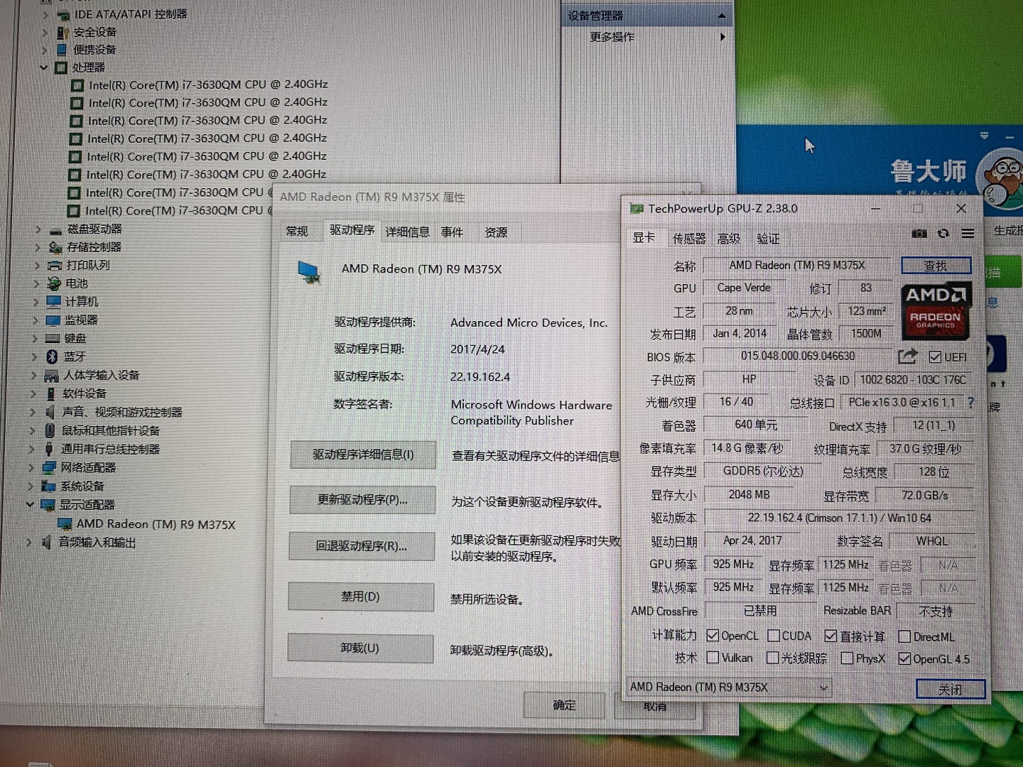

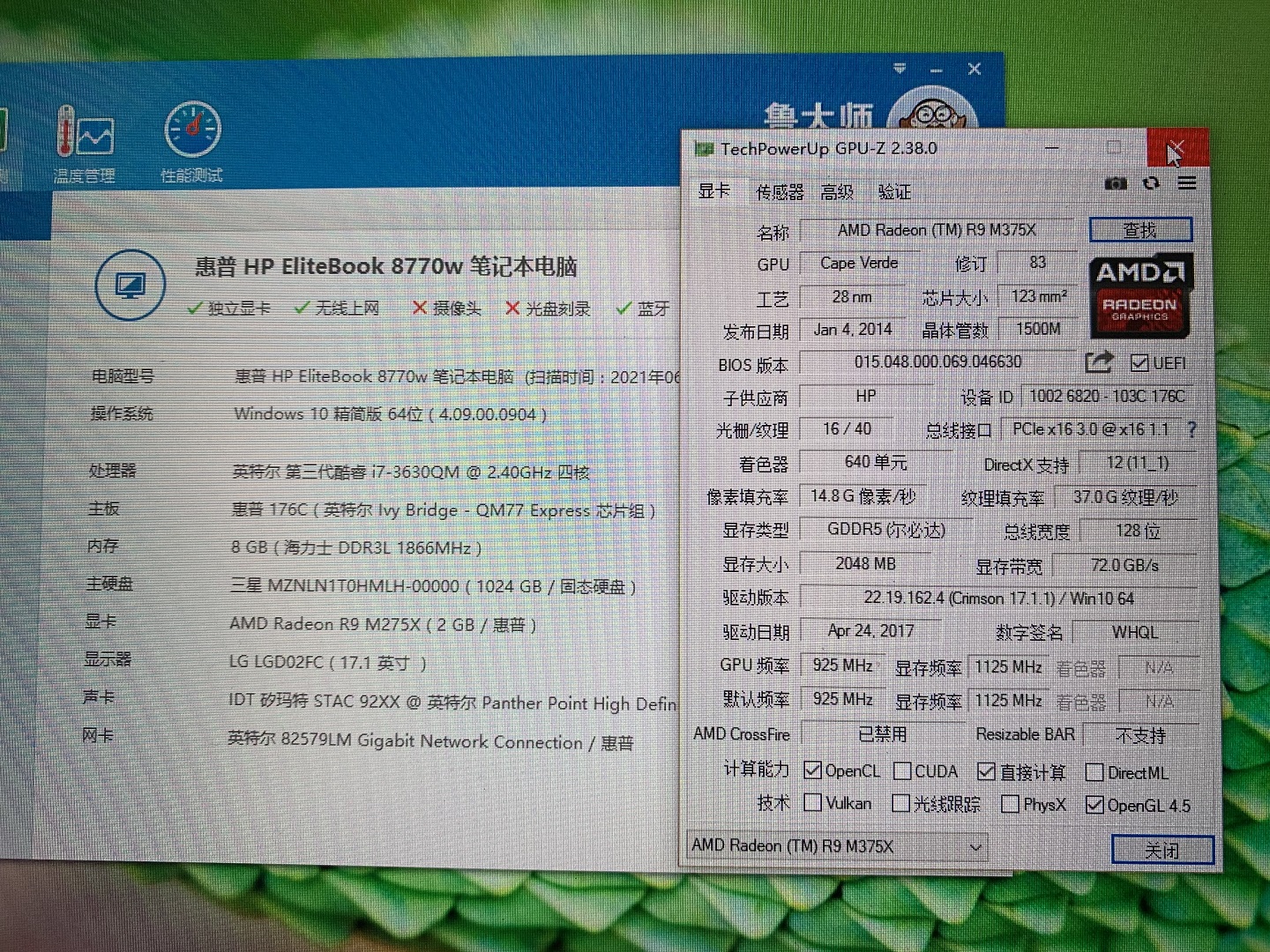

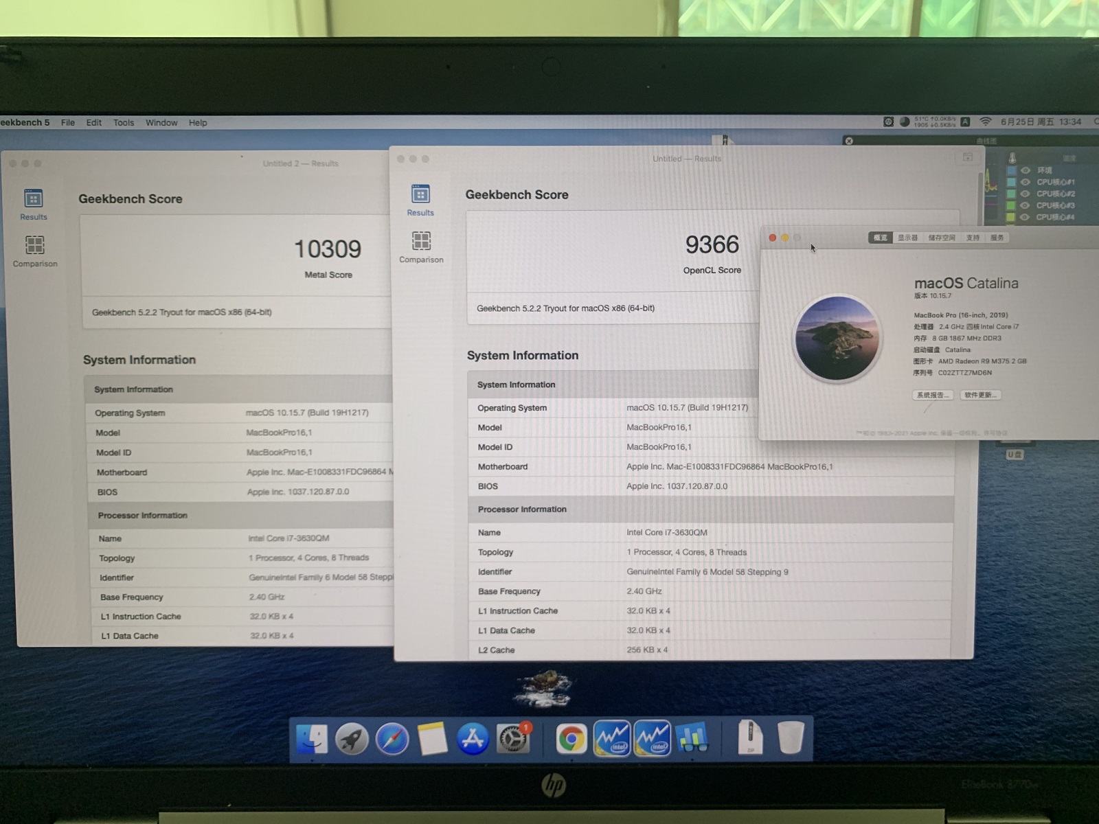

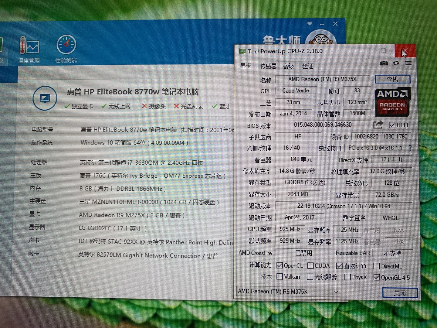

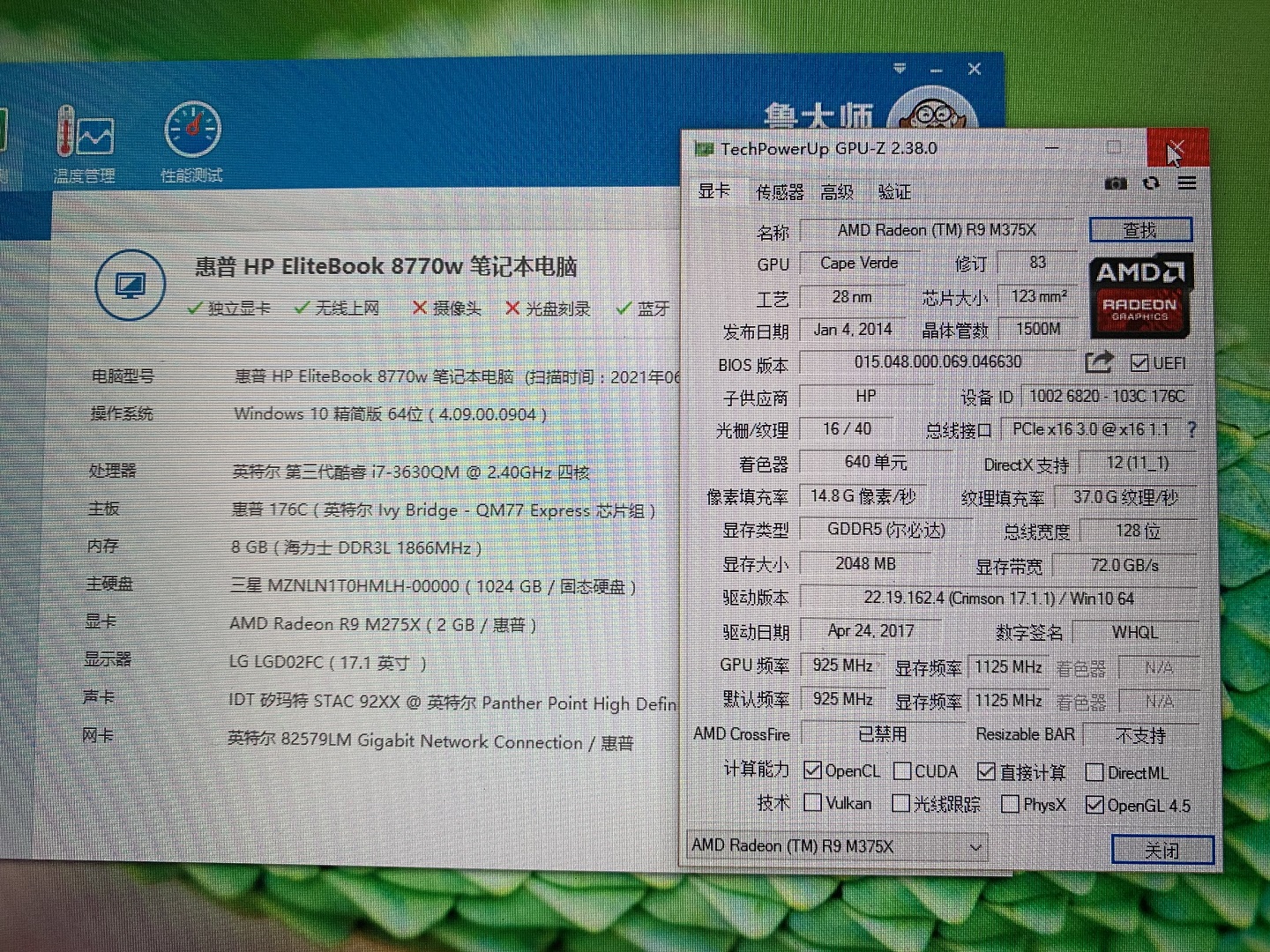

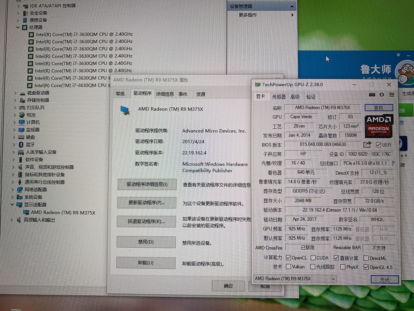

Hi @internetzel
I used Tropo architecture Dell AMD FirePro W5170M vest R9 3750X on HP 8770W with Black Apple installed with no problem. Can you modify VBiOS to use on iMac and can assist in testing .
Thanks

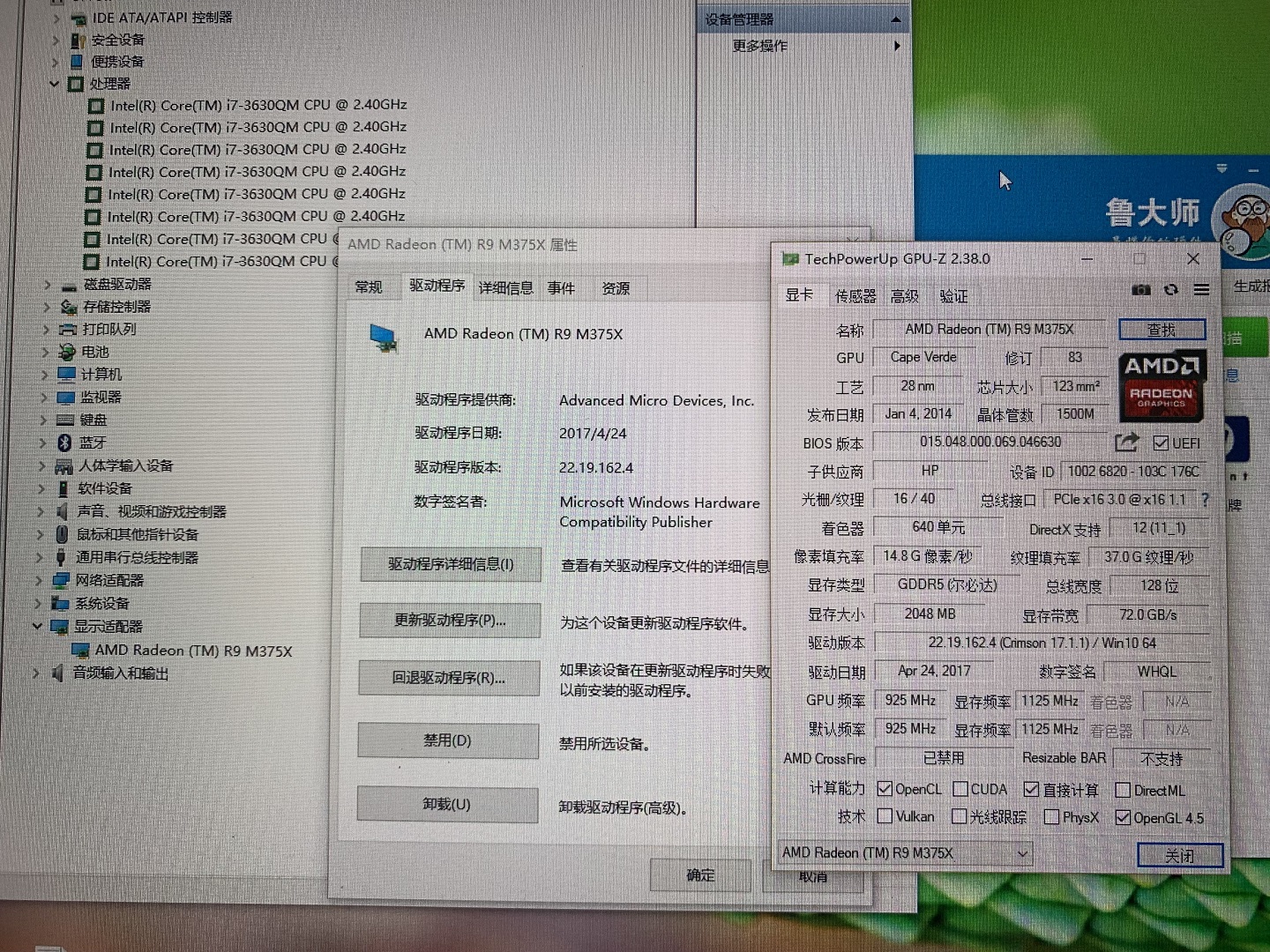

Hi @internetzel
Thanks
You'll first have to check whether the iMac in question would boot at all with the W5170M installed. You should try different VBIOSes and check which displays are working.
Reactions: 0607557
Agreed. He is using PC emulation drivers for the Cape Verde GPU which is why it appears to function in a windows environment. I haven't seen Tropo architecture drivers natively in MacOS.
If he does get it to boot, it will likely panic, but a printout of the panic log would be useful. We'll need to see the anonymous UUID in question, as well as have a look at the kernel extensions in backtrace to see what failed to load along with their dependencies. This is to say nothing of the framebuffer mismatch that could be going on.

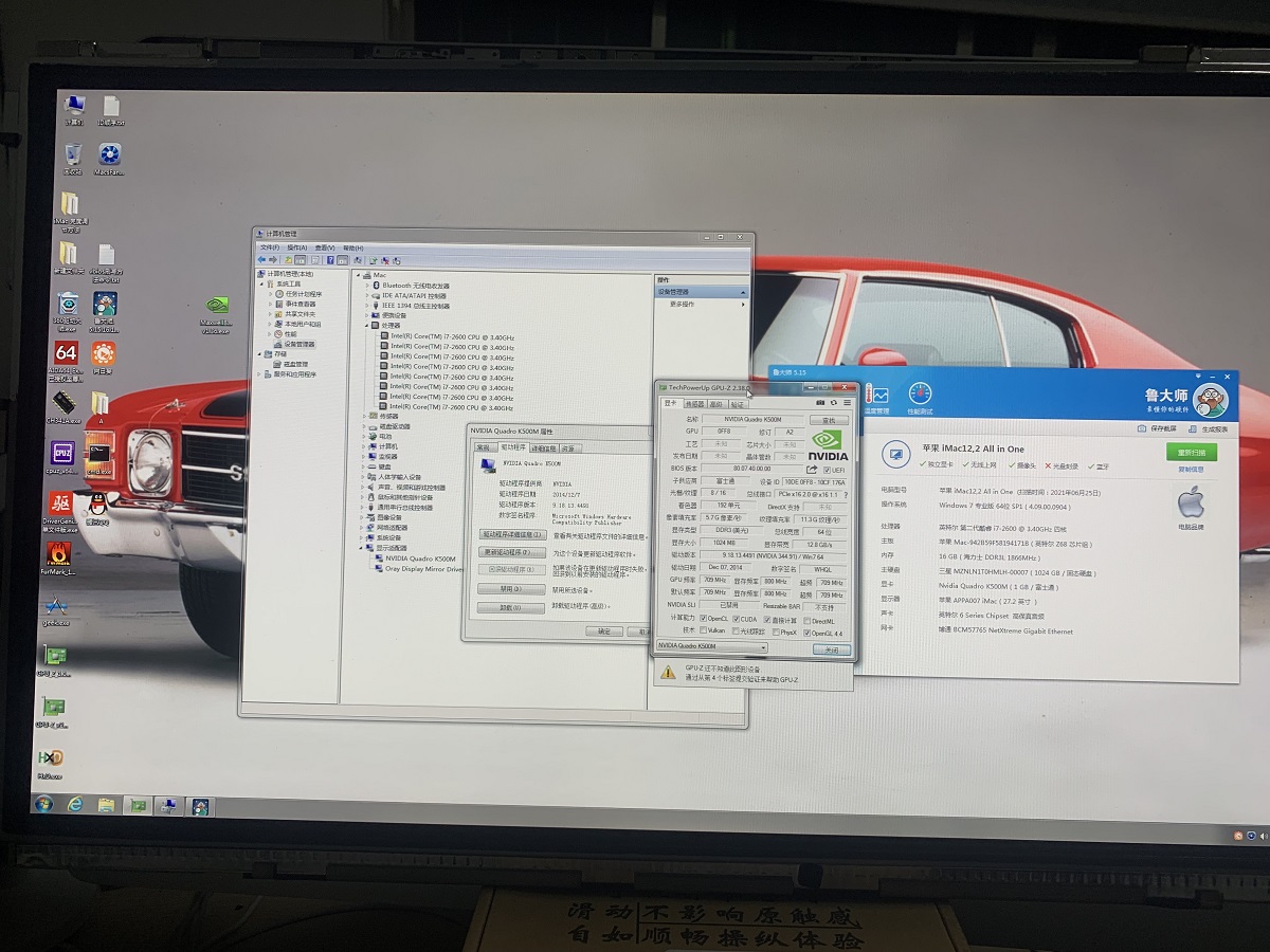

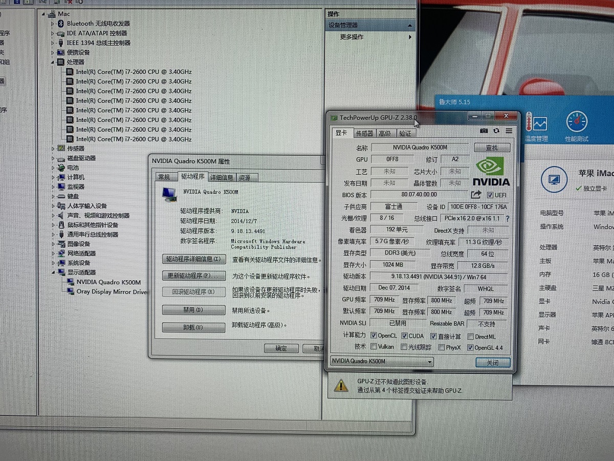

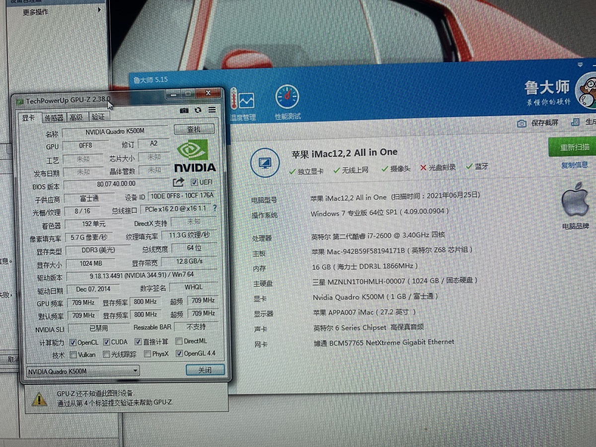

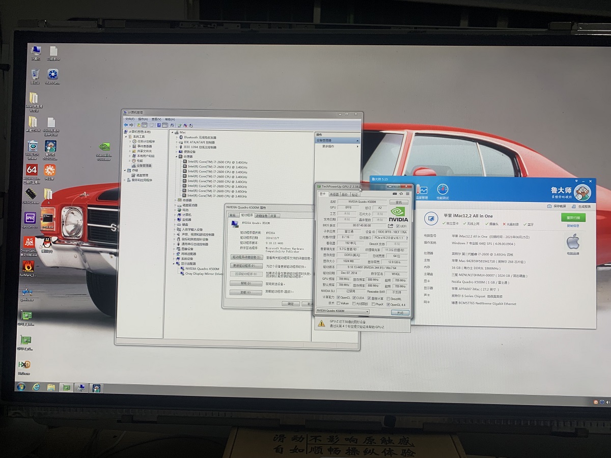

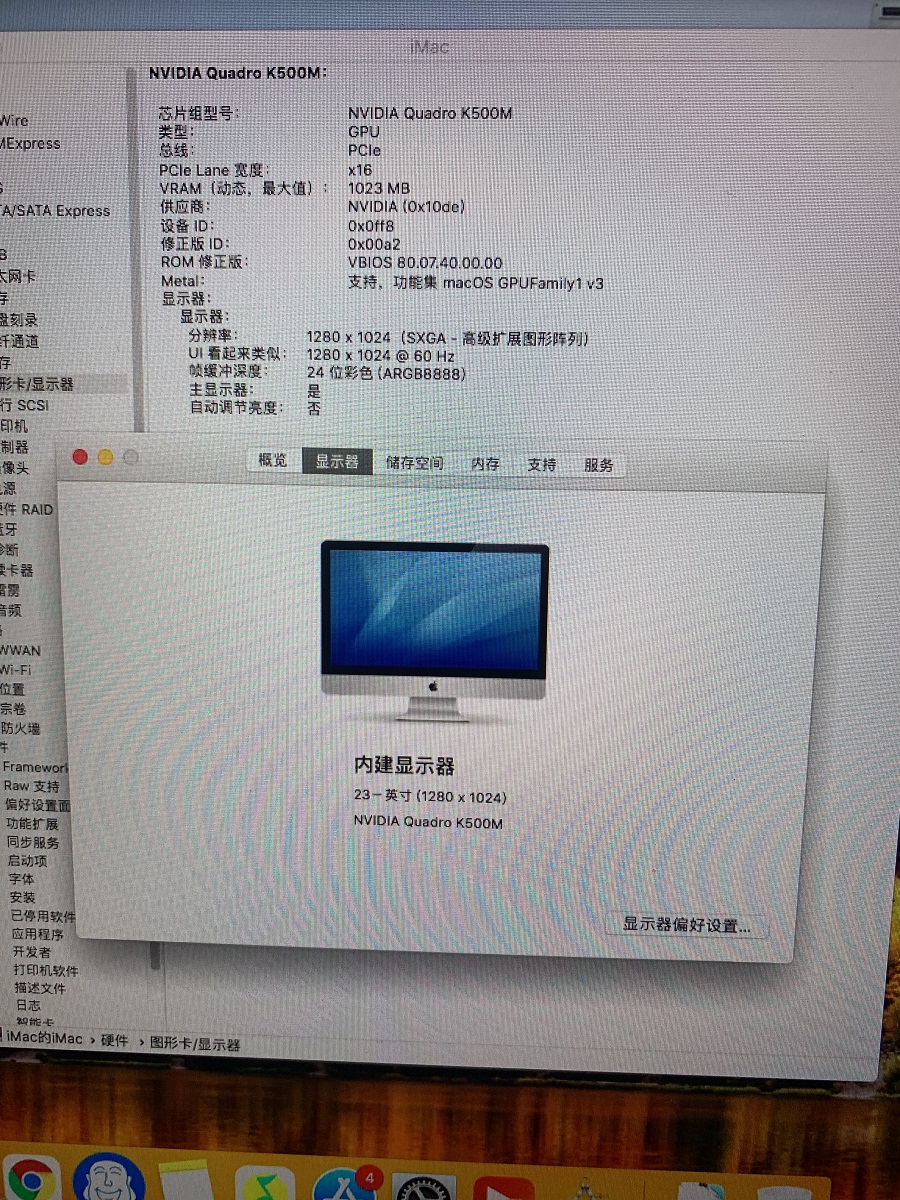

Thanks for the help. I had a burned k2000m sitting in my stack of old cards. I took the chip from it and soldered it to the k1000m. The k2000m bios chip works fine as far as size for the file. I am going to flash it today and install it. **fingers crossed**
Reactions: mdgm and 0607557

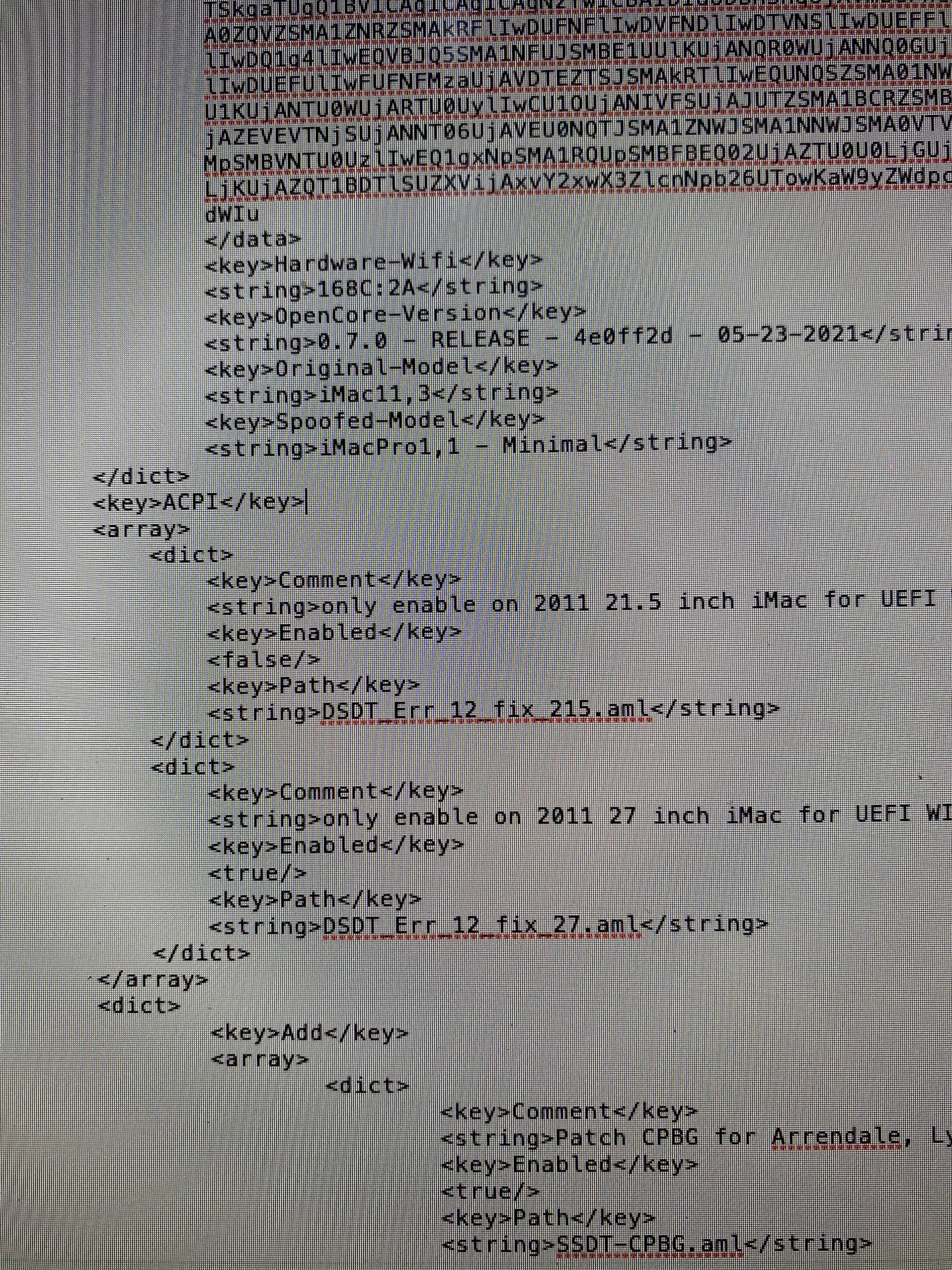

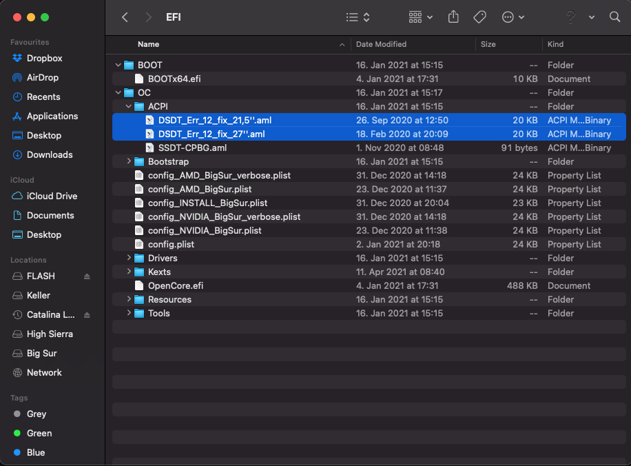

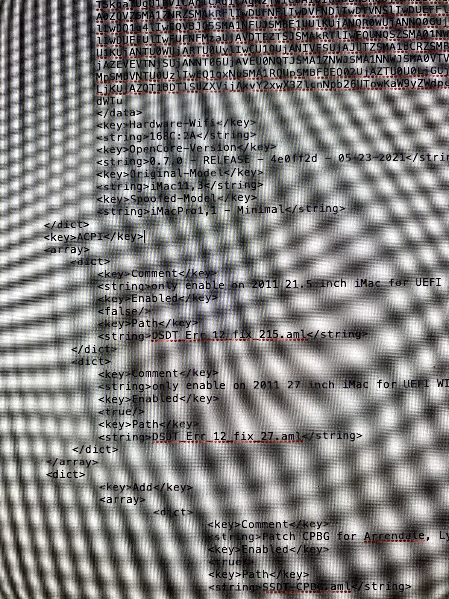

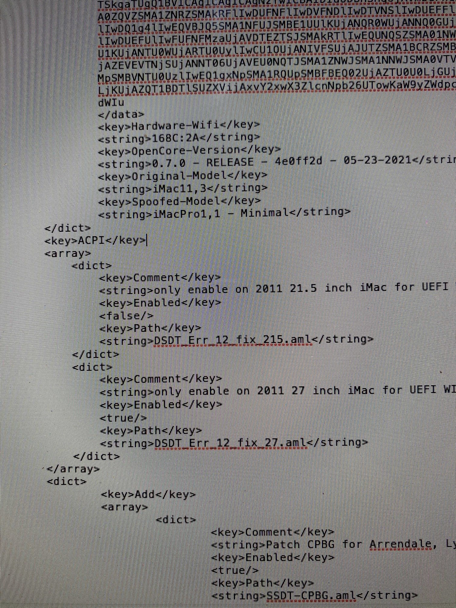

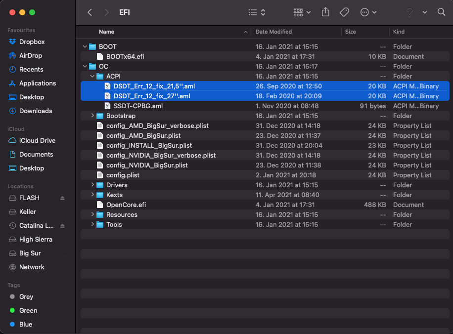

Hello everyone
I saw at first post the solution to audio on windows 10 UEFI, so I installed OCLP internally but it says will can’t boot the windows partition. I tested it anyways but it really can’t boot windows, so I uninstalled it and reinstalled on a USB, it worked but it doesn’t fixes the audio. Any suggestions?
Hello everyone

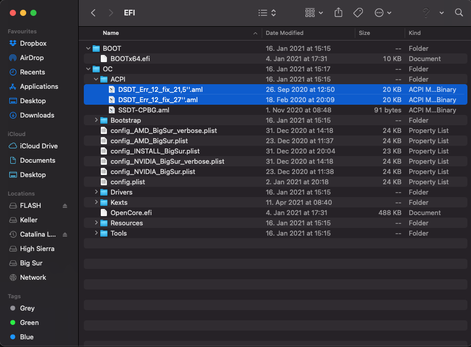

Two things:
1. You cannot install OCLP and the MS boot loader within the same EFI partition. You need either two partitions on one disk with in GUID format or two disks or a disk and OC on an external device like an USB stick. The BIOS of our old PCs is not capable of holding two boot loaders within a single EFI partitions. After installing OC id hides MS. Booting OC from another EFI partition finds MS in the other and offers a boot icon and option - you found this out by testing and this is great!
2. Unless the sound patch makes it's way into OCLP (and I am not in charge of the development there) you need to do some hand work and reading. Copy the files from the Catalina Loader from this post image and put it onto the OCLP EFI in the same folder as shown in the picture attached and adjust the config.plist (ACPI->Add section) by adding the array...
Code:
<array>
    <dict>
        <key>Comment</key>
        <string>only enable on 2011 21.5 inch iMac for UEFI WIN10 sound support</string>
        <key>Enabled</key>
        <false/>
        <key>Path</key>
        <string>DSDT_Err_12_fix_215.aml</string>
    </dict>
    <dict>
        <key>Comment</key>
        <string>only enable on 2011 27 inch iMac for UEFI WIN10 sound support</string>
        <key>Enabled</key>
        <true/>
        <key>Path</key>
        <string>DSDT_Err_12_fix_27.aml</string>
    </dict>
</array>
EDIT: I renamed the file to get rid of the quotes....
EDIT2: OCLP has since 0.1.2 these W10 UEFI sound patches included!

Two things:

Thank you! It works with 2010 too? I forgot to tell this.

Two things:
Code:
<array>
    <dict>
        <key>Comment</key>
        <key>Enabled</key>
        <false/>
        <key>Path</key>
    </dict>
    <dict>
        <key>Comment</key>
        <key>Enabled</key>
        <true/>
        <key>Path</key>
    </dict>
</array>
The sound patch has been in OCLP since May 3rd' 0.1.2 release. SSDT-PCI and associated ACPI patch. This was verified to work on 2011 and 2012 iMacs and MacBook Pros

Two things:
Code:
<array>
    <dict>
        <key>Comment</key>
        <key>Enabled</key>
        <false/>
        <key>Path</key>
    </dict>
    <dict>
        <key>Comment</key>
        <key>Enabled</key>
        <true/>
        <key>Path</key>
    </dict>
</array>

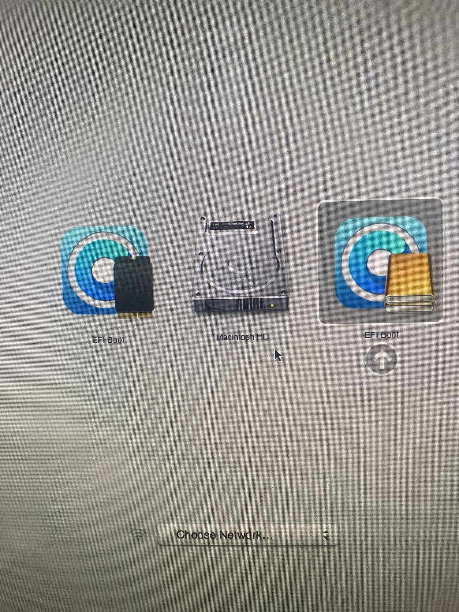

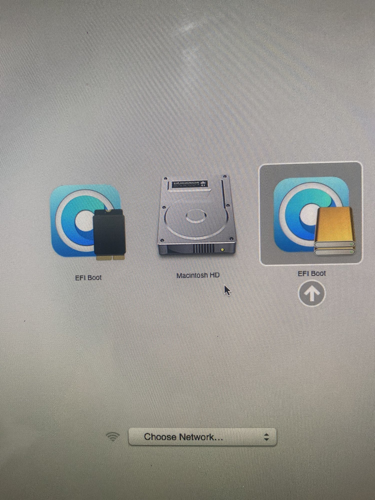

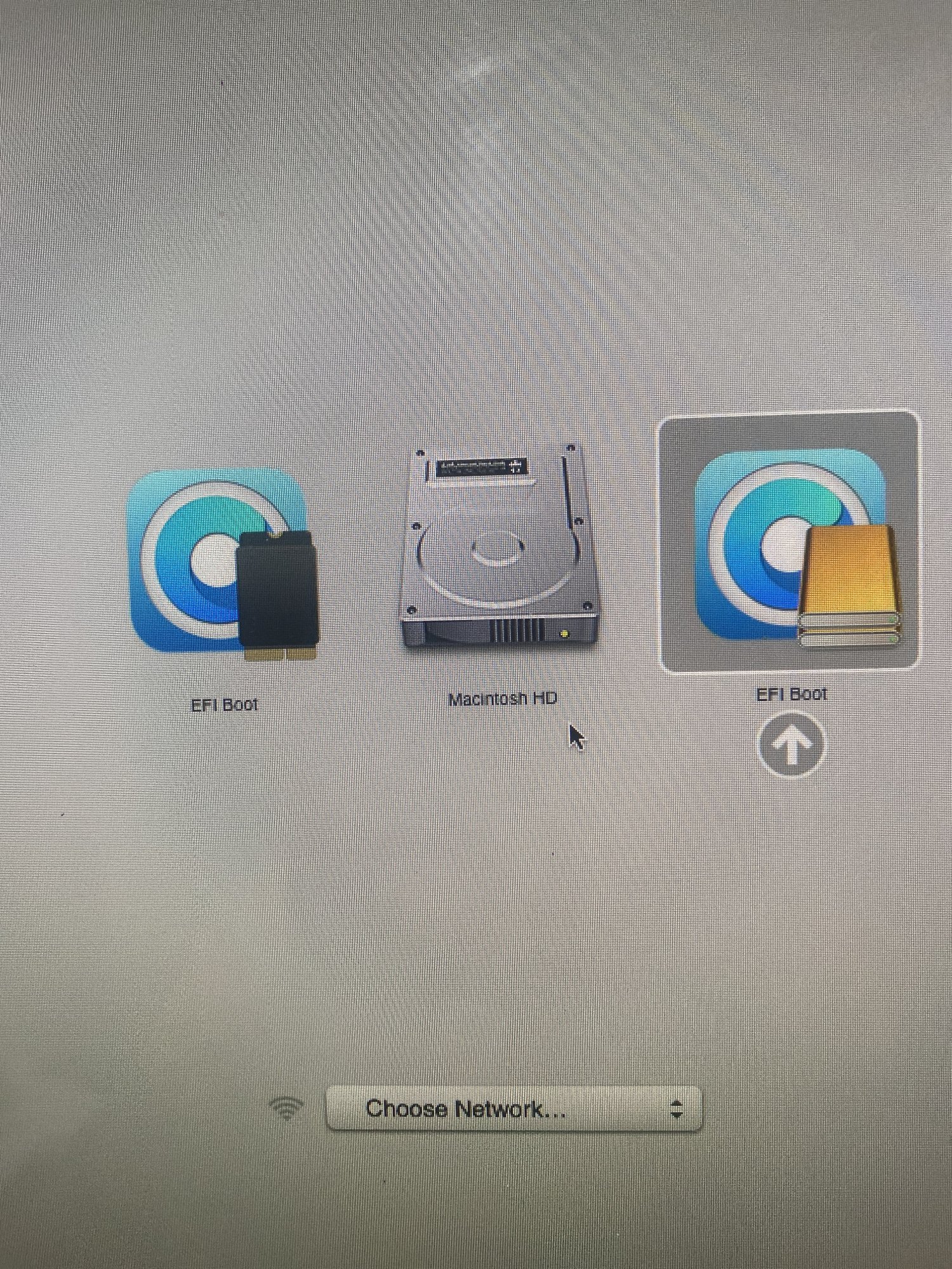

I did this but now the Mac get stuck with the bootscreen when I select the OCLP USB drive… don’t know why. I attached how I edited the ACPI section

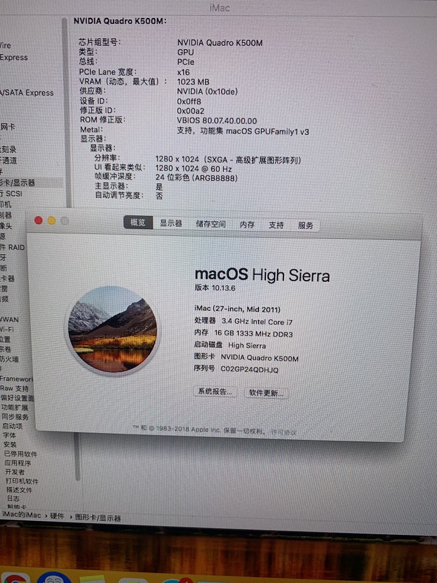

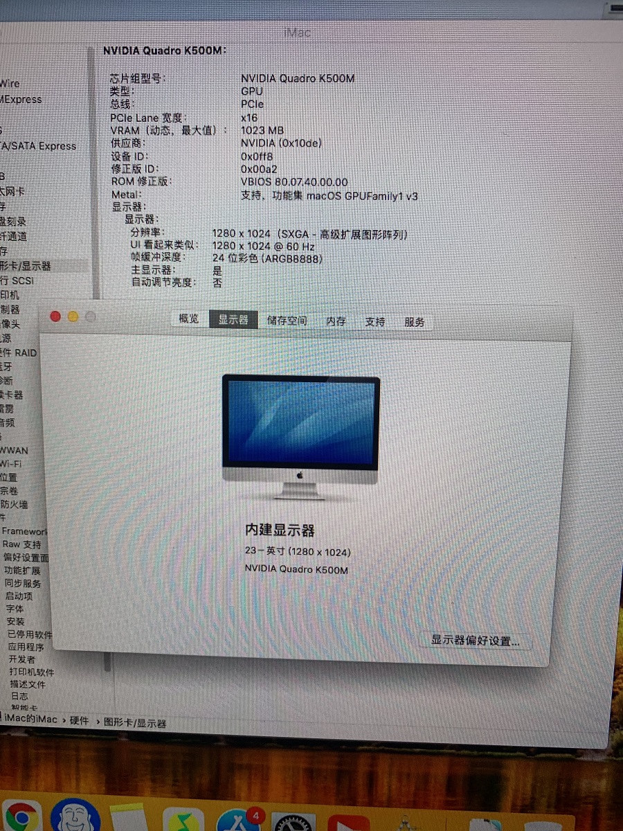

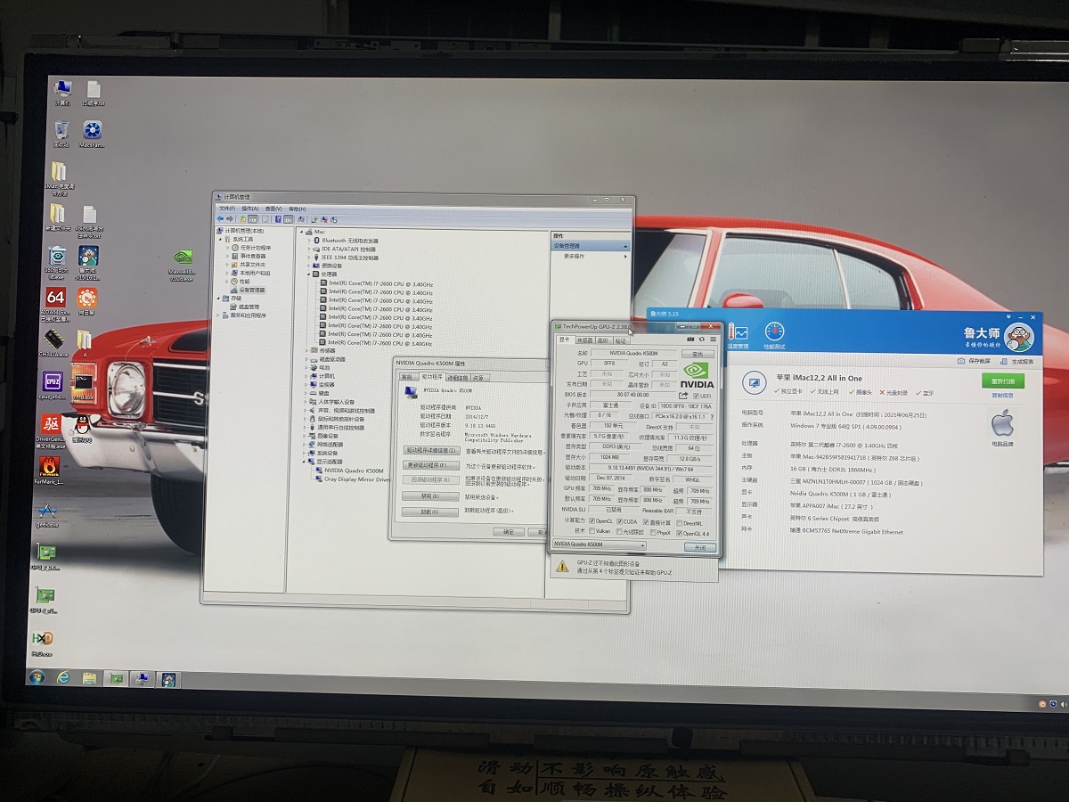

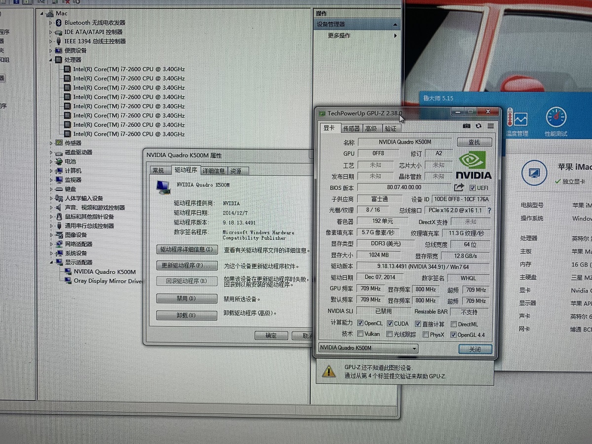

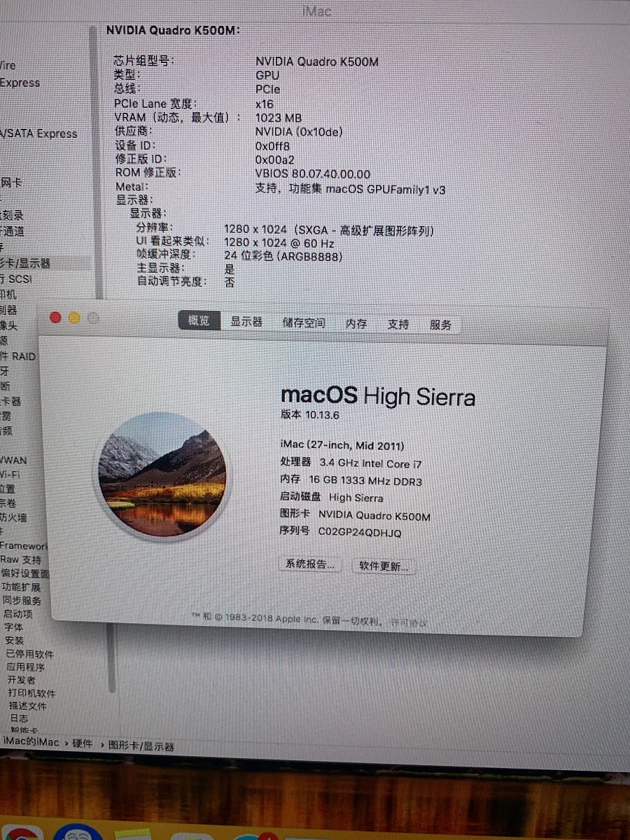

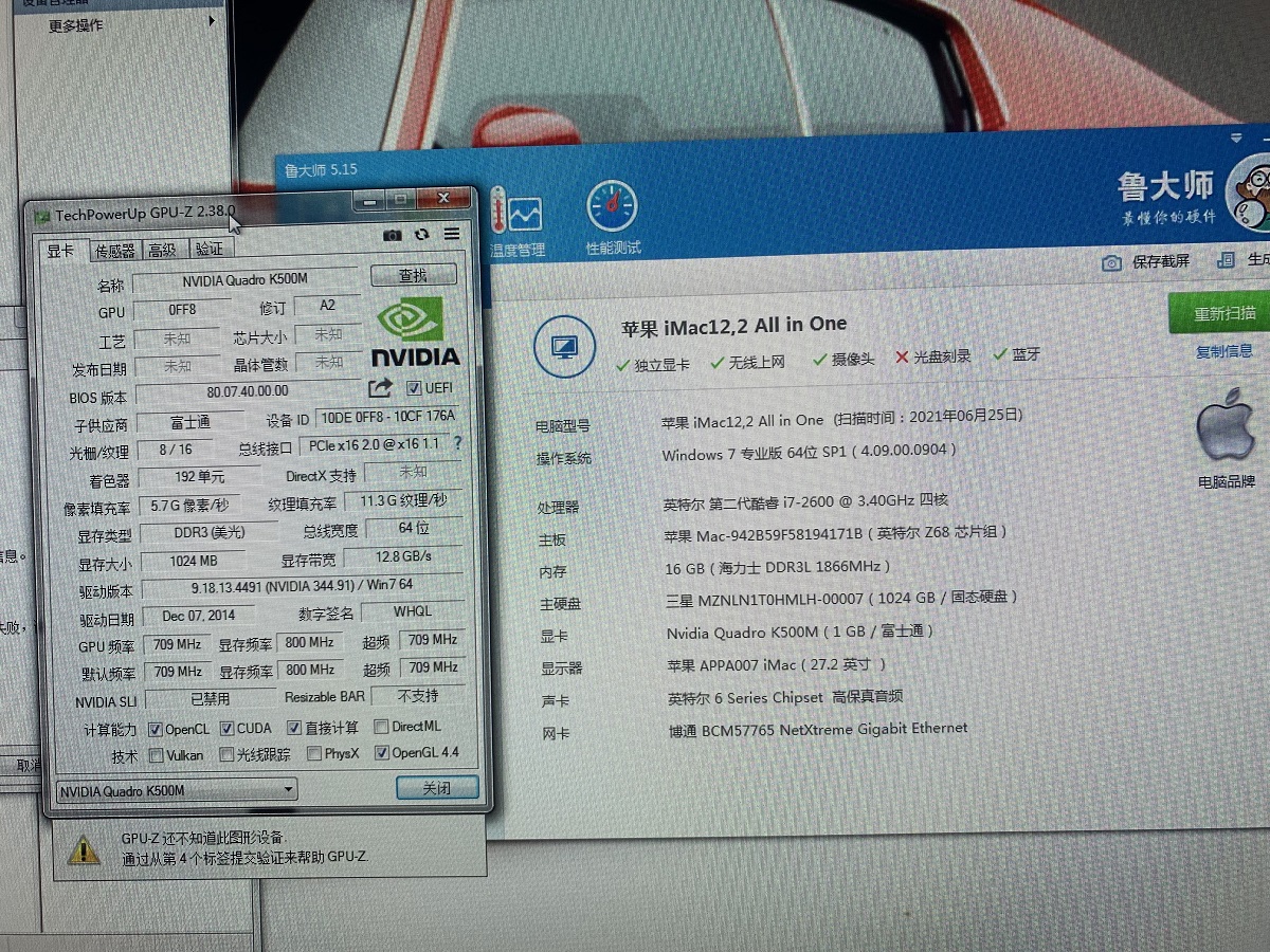

Hi @nikey22 in iMac 27 2011 tested W5170M in macOS High Sierra with Windows 7 two system replacement multiple VBiOS are invalid can not boot properly your guess is correct, do not understand why in HP 8770W model Black Apple can be used properly.
The previous K510m in macOS is normal to use the OC boot to achieve the system brightness adjustment and k610m use it almost, in the Windows system driver normal display screen is not normal to find the reason.

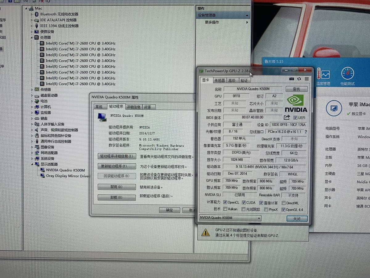

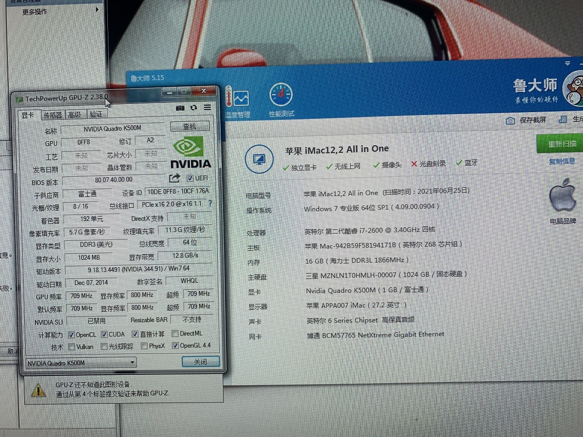

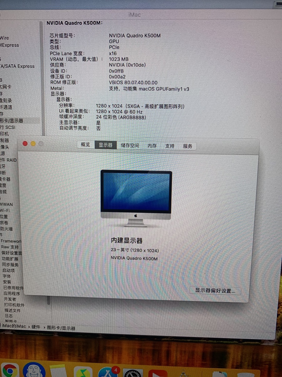

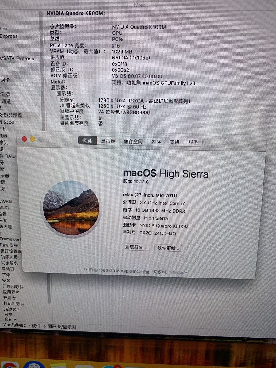

Today tested k500m modified VBiOS ID Fujitsu in window 7 system installed the correct driver inside the screen can be displayed normally, macOS High Sierra inside the screen does not show has been normal driver recognition of the graphics card, to help test the addition of the boot interface and boot interface.
Thank you!
Translated with www.DeepL.com/Translator (free version)
  • Quadro_K500M_80.07.40.00.00-Fujitsu.zip
That's something already! I don't need the bootrom of your iMac, but the original VBIOS of the W7170M would be useful. The 15,1 bootrom might still be better as the older the bootrom the more compatible the drivers possibly are with our old machines.

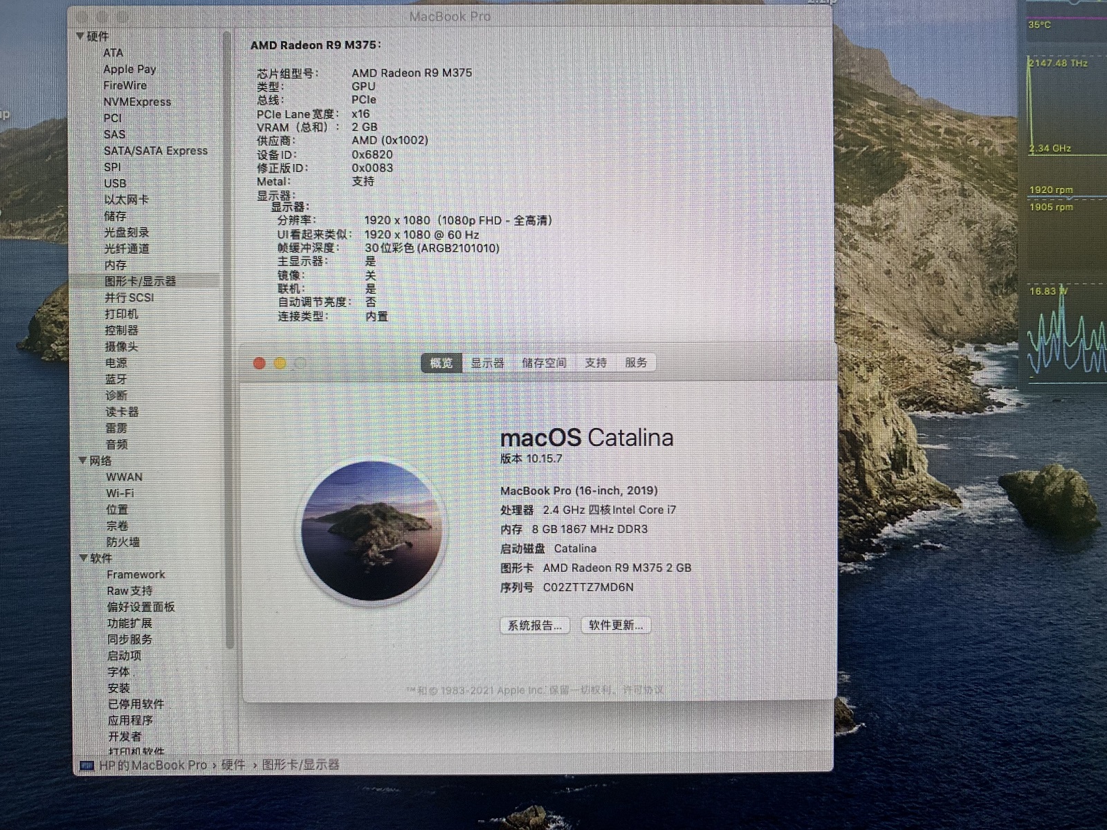

In iMac 27 2011 models tested W5170M two Dell an HP three different VBiOS, can boot normally motherboard has the front two LEDs on macOS High Sierra black screen do not know the exact results, Windows 7 heard the entry system sound on the crash cycle. My guess is that VBiOS does not match the reason, rather than many AMD graphics cards in 2011 models directly can not boot self-test start.
What I don't understand is that W5170M installed on HP 8770W laptop Black Apple is correctly identified without any modification to the driver normal use of the identified model R9 M375.

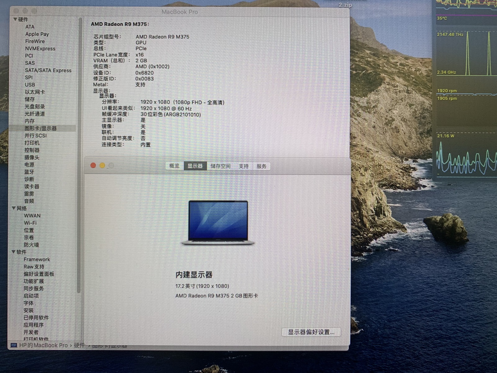

我测试过Quadro_K510M_80.28.52.00.03-Nvidia vbios原版,windows7 windows10 macOS10.13.6可以显示使用,但是没有闪屏和两个调整。
@niky22 提供的 K510m 具有使用 OpenCore 的启动屏幕,具有测试型号 iMac 27 2011 型号的亮度调整。
Multiple stability tests W5170M-R9 M370X installed Hackintosh in HP 8770W model Windows 10 and macOS 10.15.7 can work well, in iMac can not work is VBiOS incompatibility problems, right?
