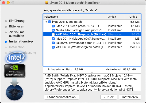

EDIT: 8/16/20 NEW AGC kexts have been added to change "board-id" to "board-ix" in the AppleGraphicsDevicePolicy binary. This has the same affect as "agdpmod=pikera" from Whatevergreen, this upload is for AMD users.
"instant on" K3100m/k4100m/k5100m/780m etc cards need this kext to fix DisplayPort Output.
I'm uploading a patched AppleGrapahicsControl.kext that is now necessary as of 10.15.4, the symptoms after this update are a blank screen but system sounds are heard when holding down the Escape key, as well a loss of any Displayport output. The cause of this is Apple Clamping down on 3rd party kexts from loading, this mainly affects hackintosh users, but affects us as our iMacs are no longer a supported platform.

To install this kext
1. unlock your System partition, open terminal enter
Code:
sudo mount -uw /
killall Finder
2. drag the kext on-top of the kext utility icon let it install/timeout with an error.
3. Open terminal and enter "sudo reboot" skipping this step may leave your iMac hanging at the desktop (A Catalina issue)
Make sure to unzip the kext to a new folder, so there aren't any "1" or "2"... at the end of the AppleGraphicsControl.kext filename. Remember the is replacing the System Kext in System/Library/Extensions and must be done using Kext Utility linked here http://cvad-mac.narod.ru/index/0-4.

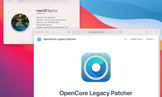

I got this card and it works perfectly thx again to nikey22 for the magical vBios

well that was pretty awesome... just loaded Big Sur 11.4 using OCLP and so far so good...
...necessitated by the failure of the GPU on my old 24" early 2008 iMac (but replacement GPUs are on the way, hopefully one of them will work!).
pretty stoked so far... see if the intermittent failure happens, I have a contingency for that too (my first K1100M installation failed possibly because it predated the Elpida based GPU ROM1 bios... if this installation is funky I'll re-burn that GPU and see if it works).
thanks for all the hard work all around.
I have revently had some time to test your package on our Mojave 2011 iMac's, and must say it works great !
I would like to mention that this kext fix, also fixes the no iMac speaker sound fix.
Dosdude1's Mojave patcher wont let me enable built in sound en Mic anymore with Mojave, dont know exactly what causes this but I think it's related to the upgrade to nvidia cards.
Anyway, if anybody wants to know, this package also fixes the sound/mic again 🙂
Many thx again for these awesome package installers 🙂

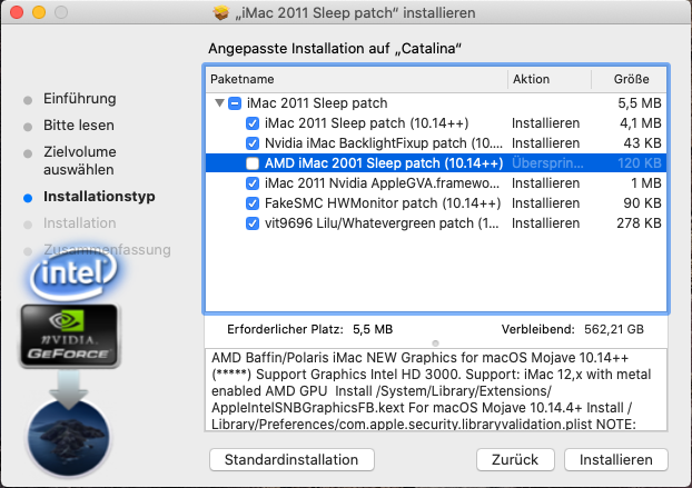

hmm strange, recently updated one of our 2011 iMac's today, still runing Mojave using dosdude1 patcher.
But I cannot get Audio to work anymore, after updating to the latest mojave security update.
I have postponed this security update for a few months, since this iMac is in production use all the time..
Anyway, I so far cannot get the internal iMac speakers to work again under MacOS.

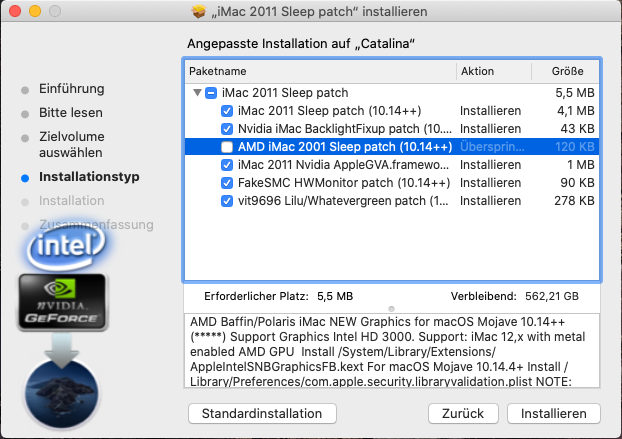

This problem was solved for me in the post by running the great iMac 2011 sleep patch pkg installer.
Everything else is fixed again greatly with the pkg, like HD3000,sleep backscreen but still internal imac sound speakers are not working.
The only sound device currently listed again is Soundflower (2ch)
This iMac runs a GTX765m with Nicks vbios, and Mojave 10.14.6 using dosdude1 patcher.
(yes I know, I will get all of the iMac's to OCLP in the future.. 😛 )
Perhaps I have overlooked this info within the Wiki, but will look for a solution again.
Or perhaps somebody can point me here to the right direction, thanks in advance..
