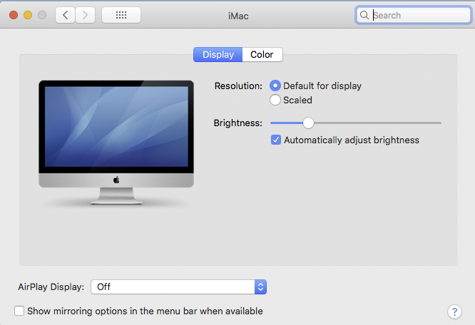

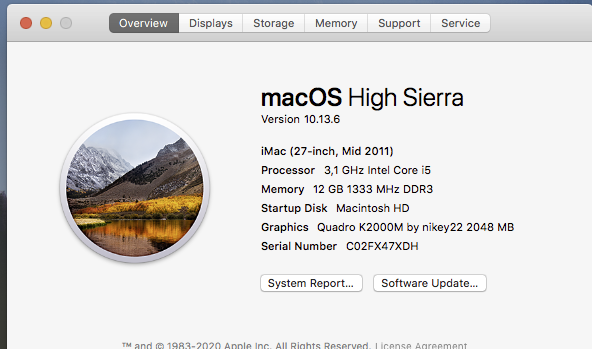

The following is a rom for brightness control for the people who own a K2000M card.
You will still need to use Opencore to do the necessary ACPI injections.
Appreciate @BadBiscuit for doing the initial testing and confirmation. His hardware and OS support is below.
Vram support:
Hynix H5TQ2G63DFR (tested)
Bootloader/OS support:
OCLP v.0.1.2, BigSur 11.3.1 (tested)
Machine support:
iMac 12,1 ( 21.5-inch Mid 2011) Mac-942B5BF58194151B (tested)
iMac 11,2 ( 21.5-inch Mid 2010) Mac-F2238AC8
iMac 11,1 (27-inch Late 2009) Mac-F2268DAE
iMac 11,3 (27-inch Mid 2010) Mac- F2238BAE
iMac12,2 (27-inch Mid 2011) Mac-942B59F58194171B
Again, now that @Ausdauersportler and the others are working to refine OCLP to our generation iMacs, these cards should be more easily compatible. Much appreciation for that. A reminder, they are not for power users because of their DDR3 ram and clock limitations. Enjoy!
