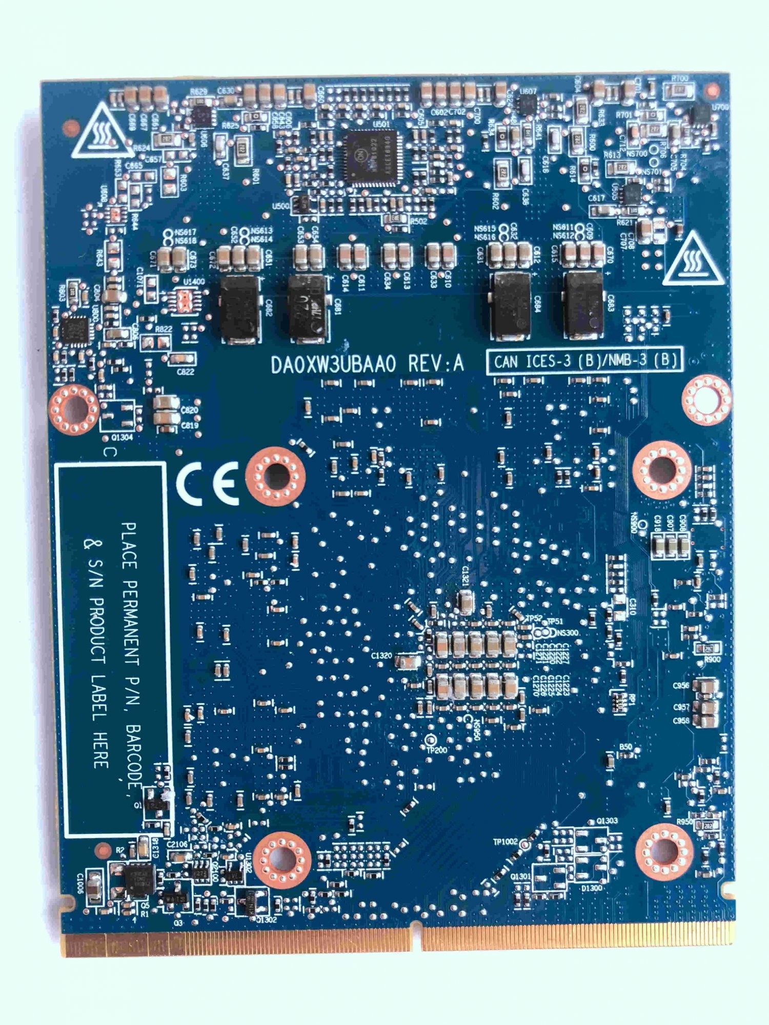

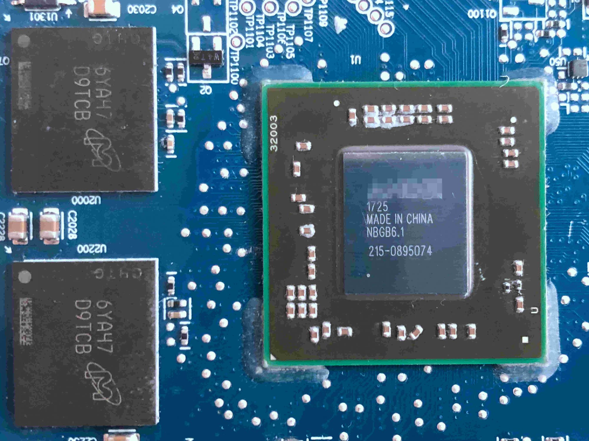

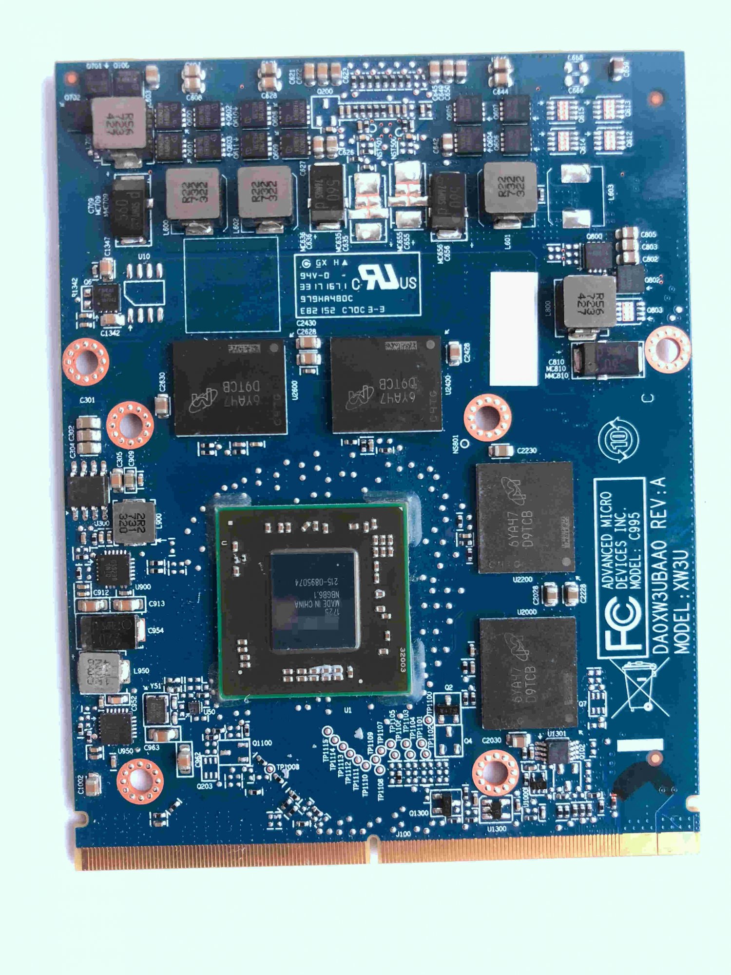

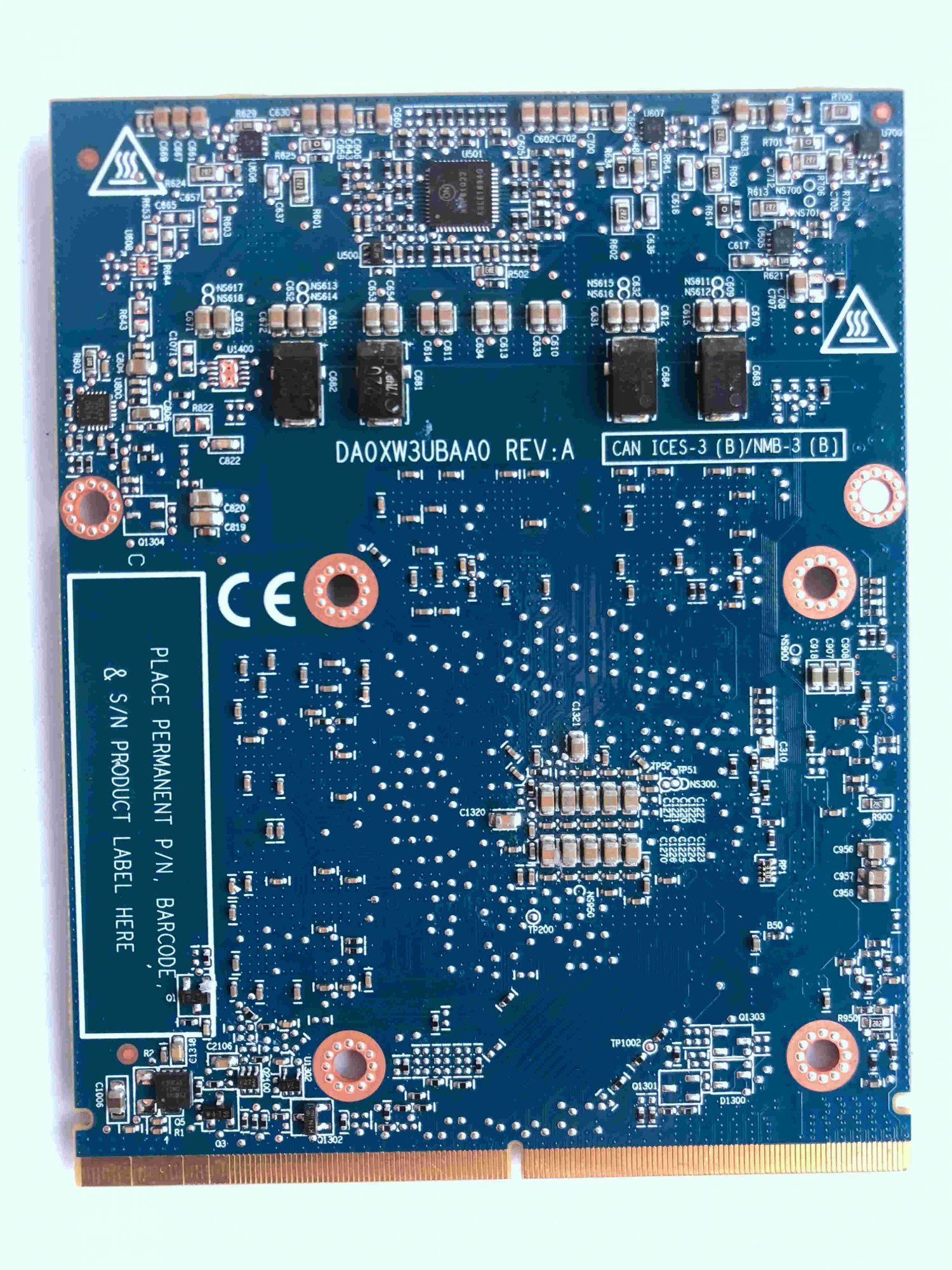

Can these information be applied to the vBIOS of other AMD GPU like WX4130/4150/7100, RX480 to activate the internal LCD even at boot ? Just curious as I am ignorant on vBIOS 😵

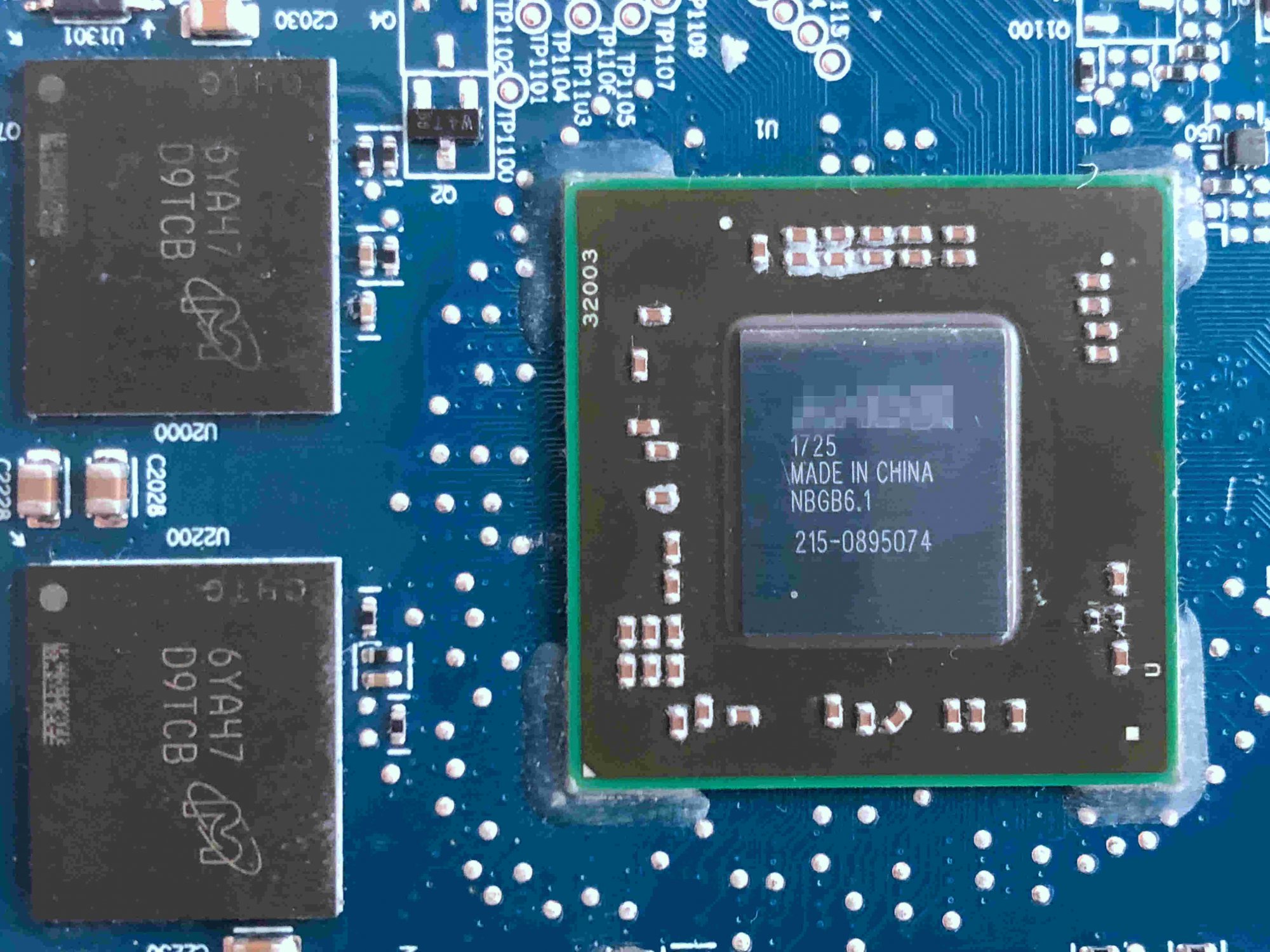

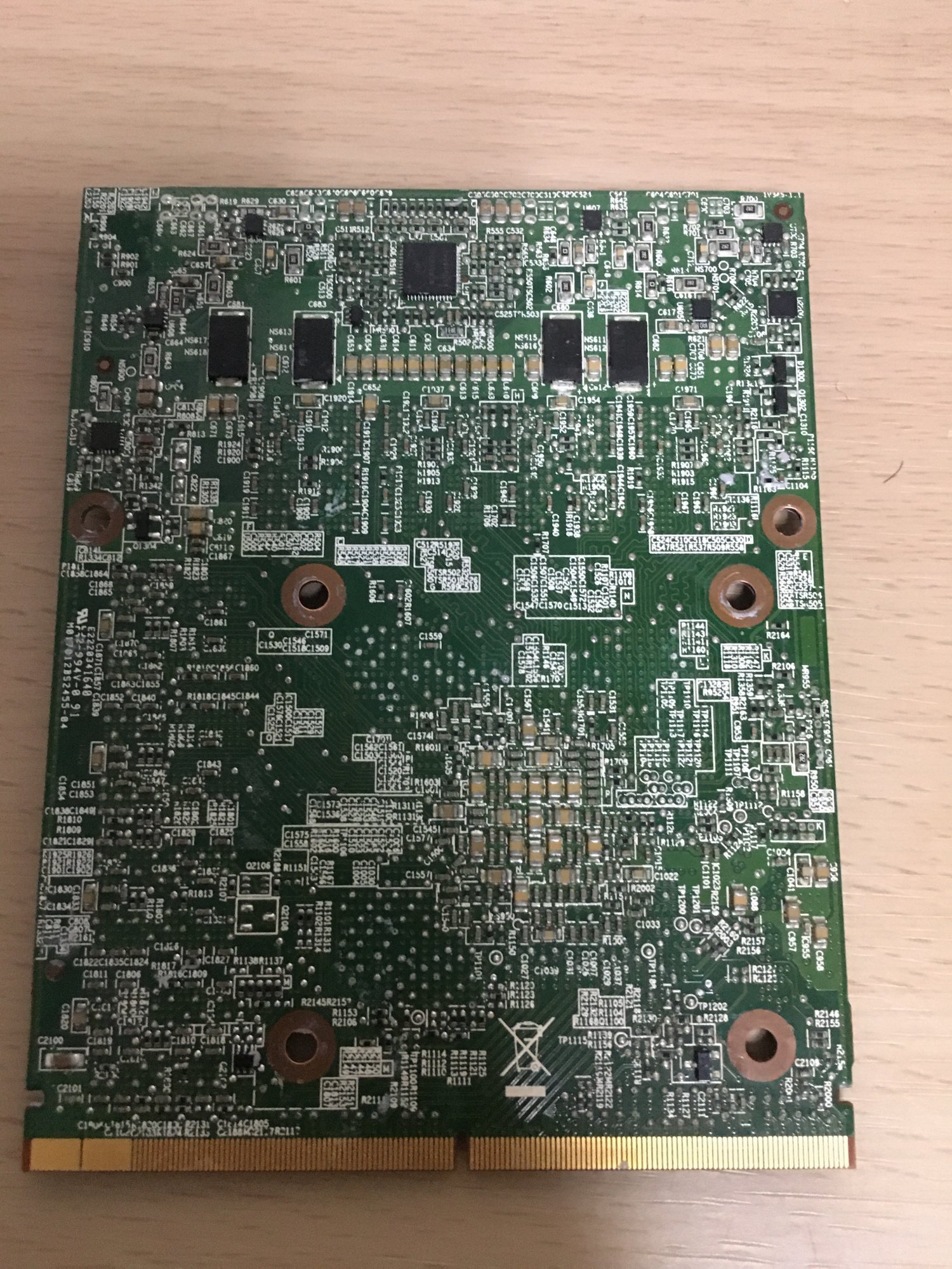

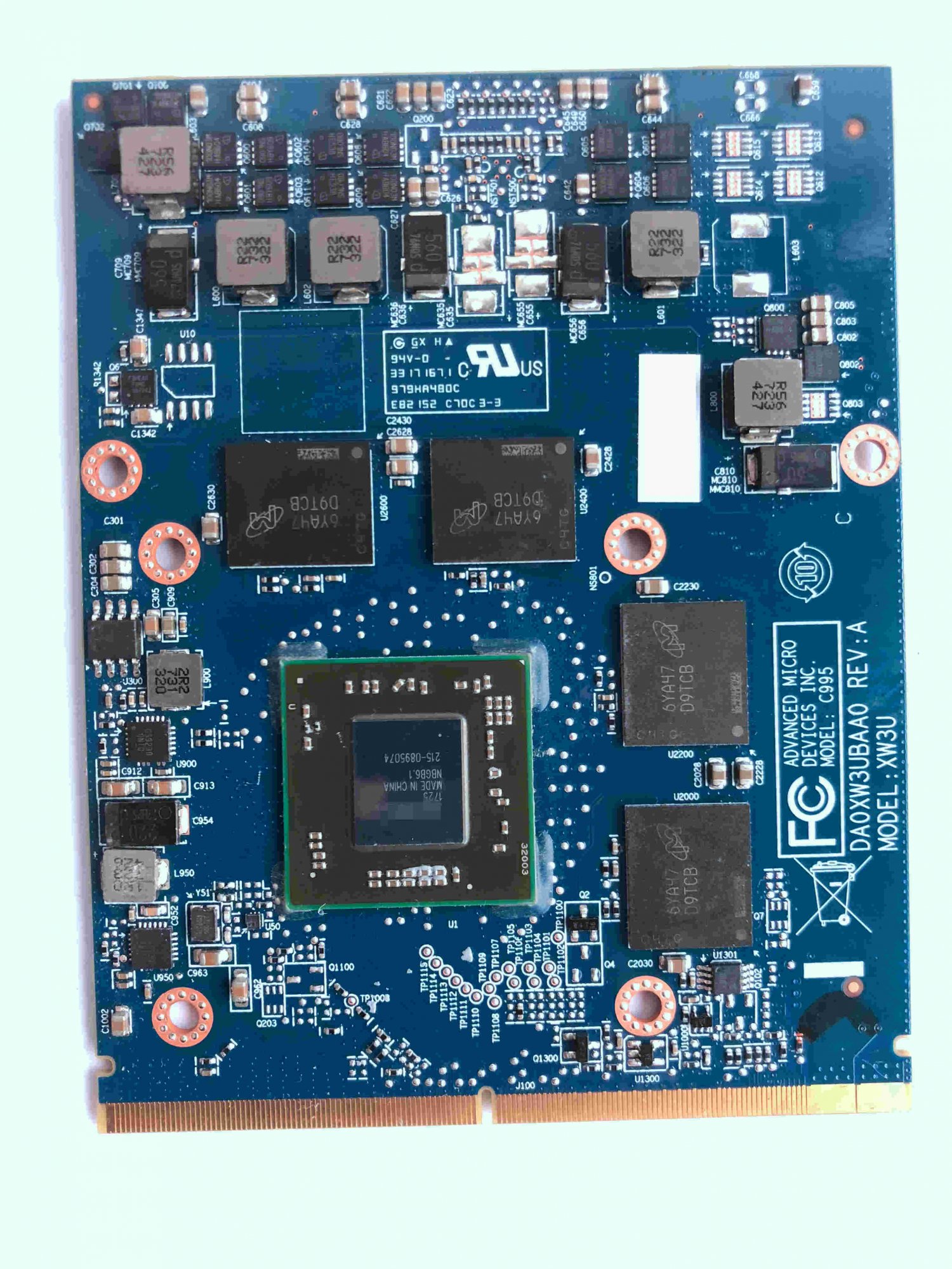

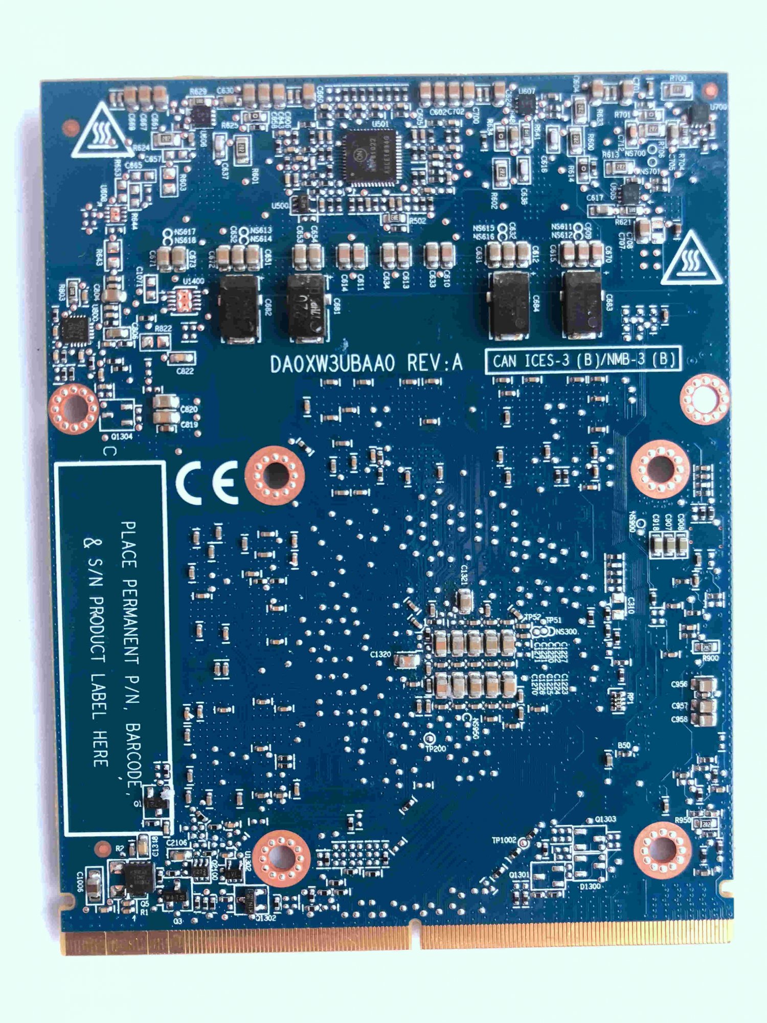

Today I tested three AMD WX4170 VBIOSes our developers provided with three AMD WX4170 cards I have in an 27' 2011 iMac. I will list the results by RAM type (from this post).
@nikey22: It appears there is a (possibly trivial) bug in your VBIOS. I tested it with cards having SKhynix H5GQ8H24MJR-R4C and Samsung K4G80325FB-HC25 RAM ICs. In both cases the machine would start with those consecutive cut-off chimes every 3 seconds and would not boot. (I did not test it with the card having Samsung K4G80325FB-HC28 RAM ICs.)
@internetzel: Your VBIOS does work with Samsung RAM ICs, but still doesn't with those SKHynix RAM ICs - once macOS tries to switch to GPU drivers during boot, the display just stays blank.
@edwardgeo: Your VBIOS works with all three cards I have, but (as expected) it doesn't fire up the internal (iMac's) display (image is there, just no backlight). I used the external display and measured a MetalBench score of 73 for all 3 cards! (This is amazing!) I did not notice any stability issues apart from the fact that the card with Samsung K4G80325FB-HC28 RAM ICs performs badly after a sleep cycle (MetalBench score of 13). (Other two cards have full performance after a sleep cycle.) (Now I also know that one card suspected as failing is OK!)
Another note: Performance of @internetzel 's VBIOS is unaffected if the internal display is connected or not. (In both cases it scores 52 with MetalBench.) Performance of @edwardgeo 's VBIOS is affected: without the internal display it scores mere 13 with MetalBench, so the GPU is apparently throttled. (I'm not sure if this is somehow related to throttling of the card with Samsung K4G80325FB-HC28 RAM ICs...)
Many thanks @nikey22 , @internetzel , @edwardgeo! If you are willing to develop further, I have my 'test rig' available for more tests. If I should provide / look for something specific for/in those tests, please do let me know. (But be prepared: I may have to be hand-guided for most part...)

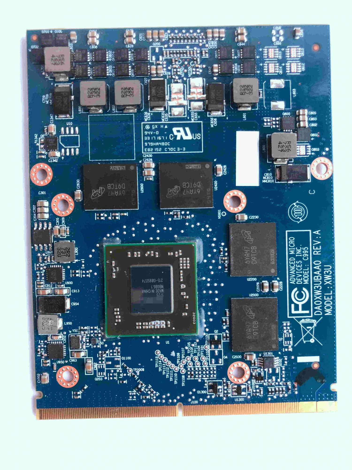

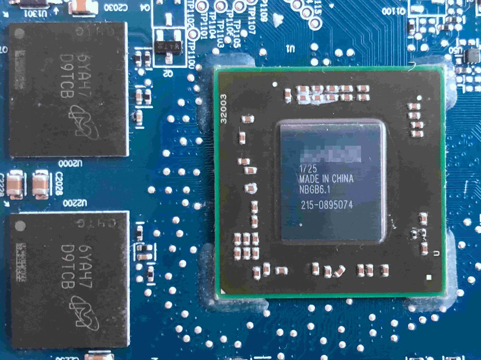

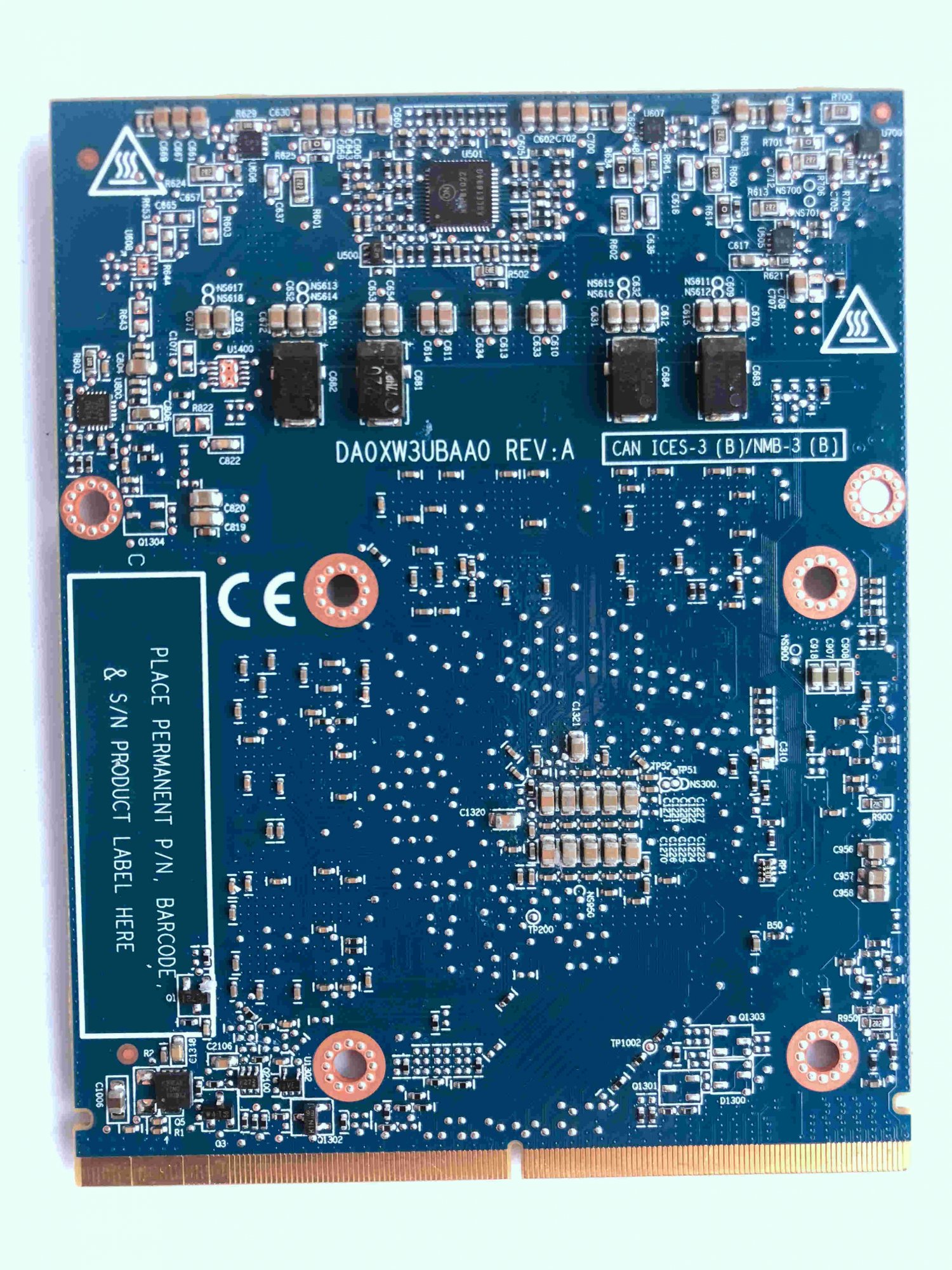

Do you have experience on this HP WX4170 which has a different VRAM type ?

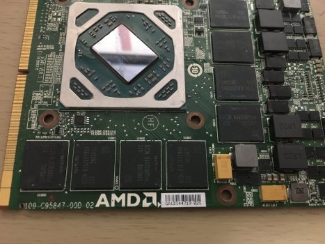

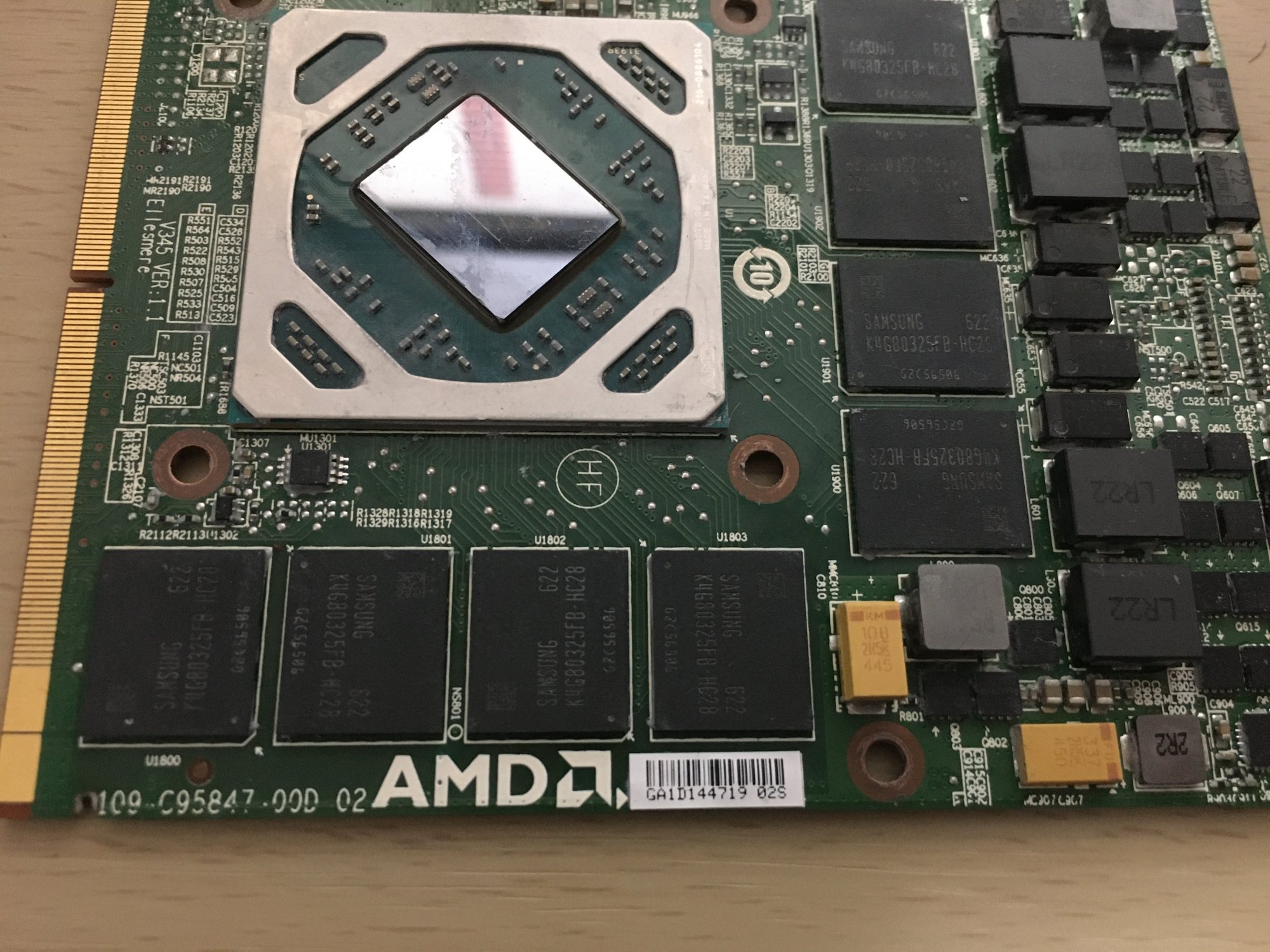

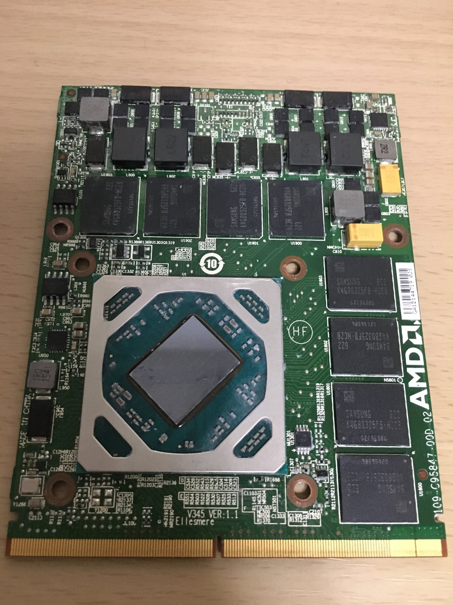

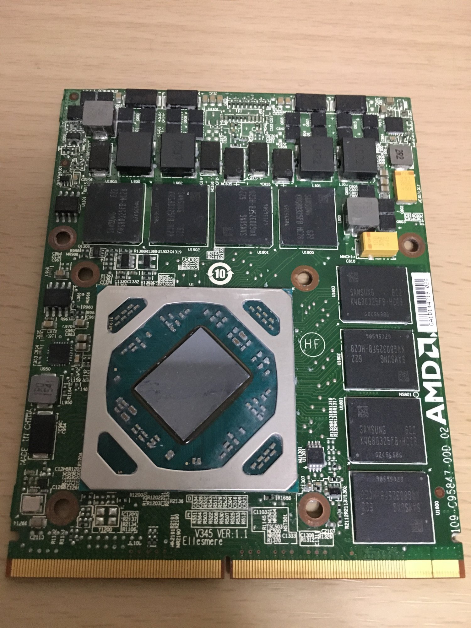

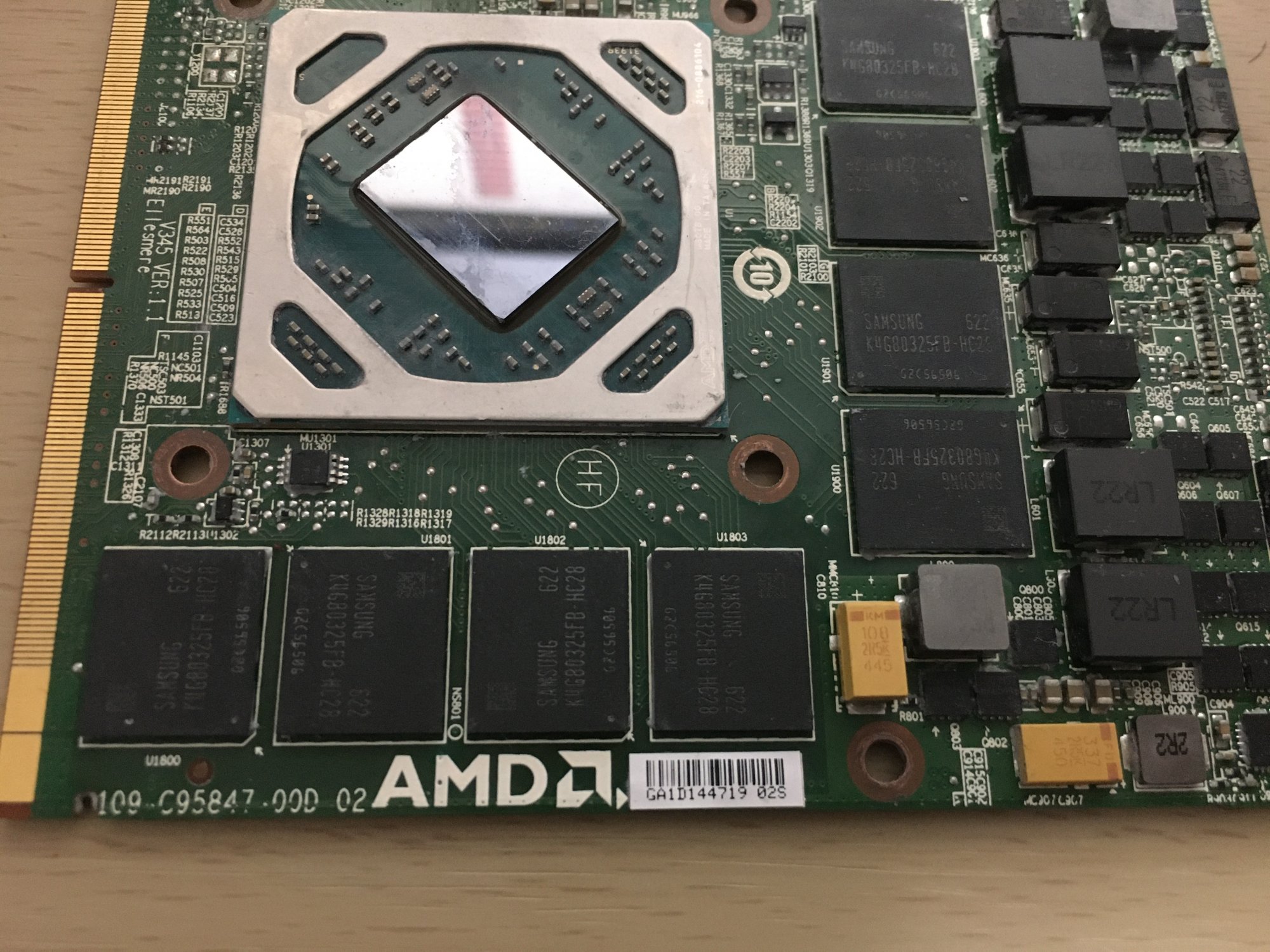

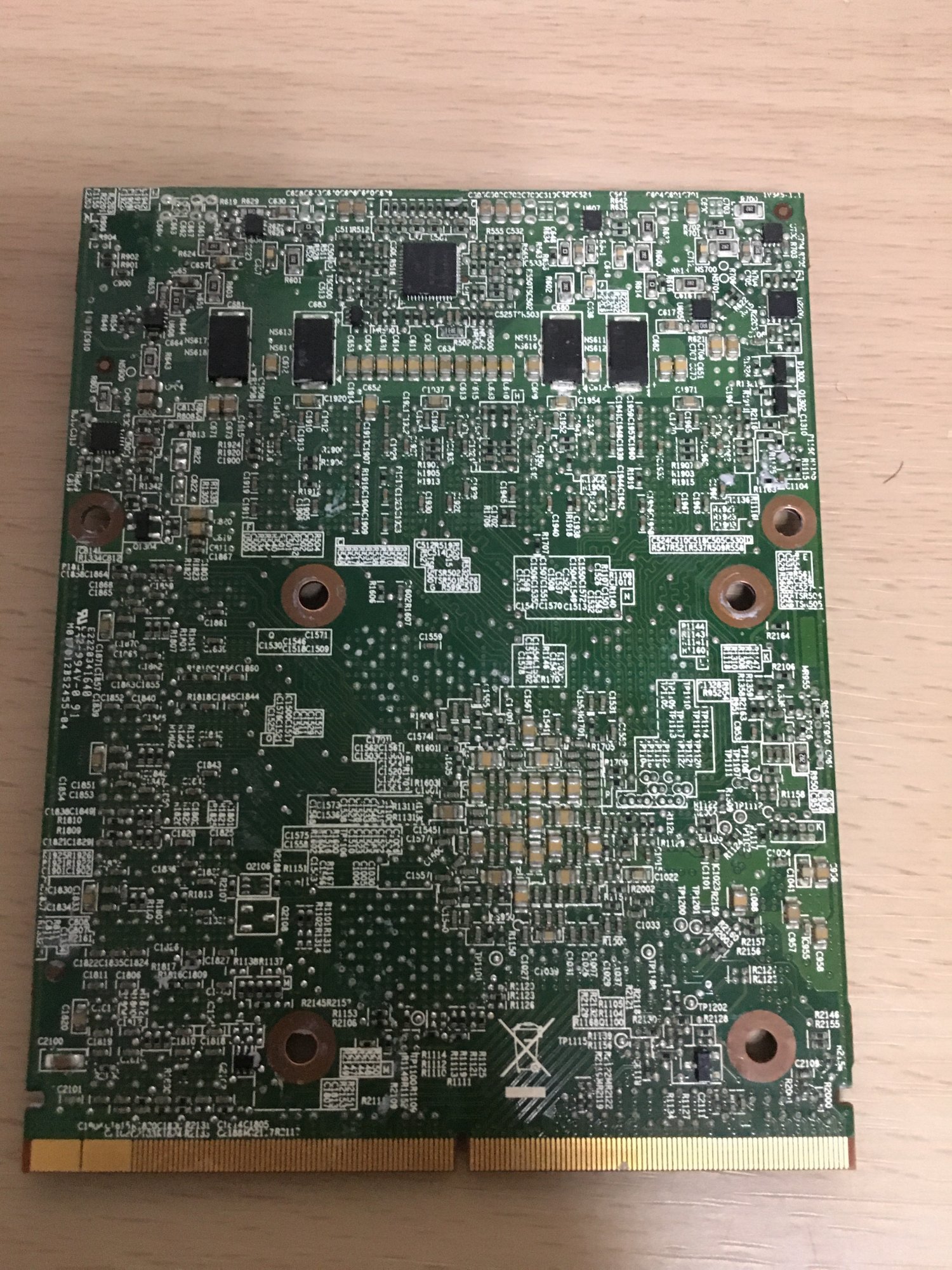

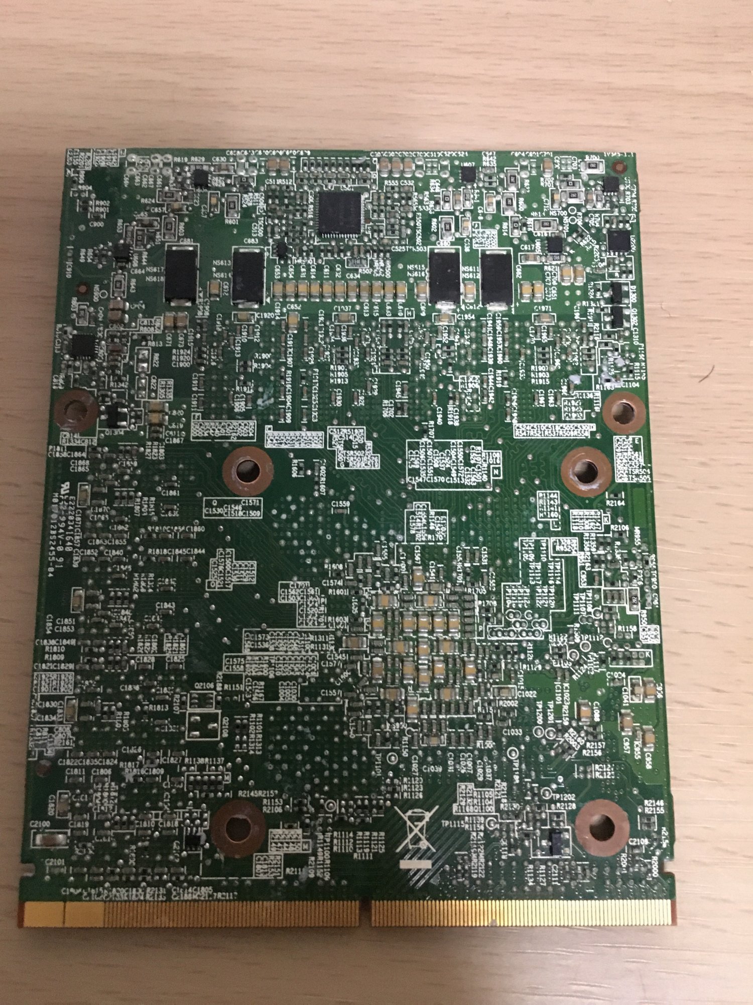

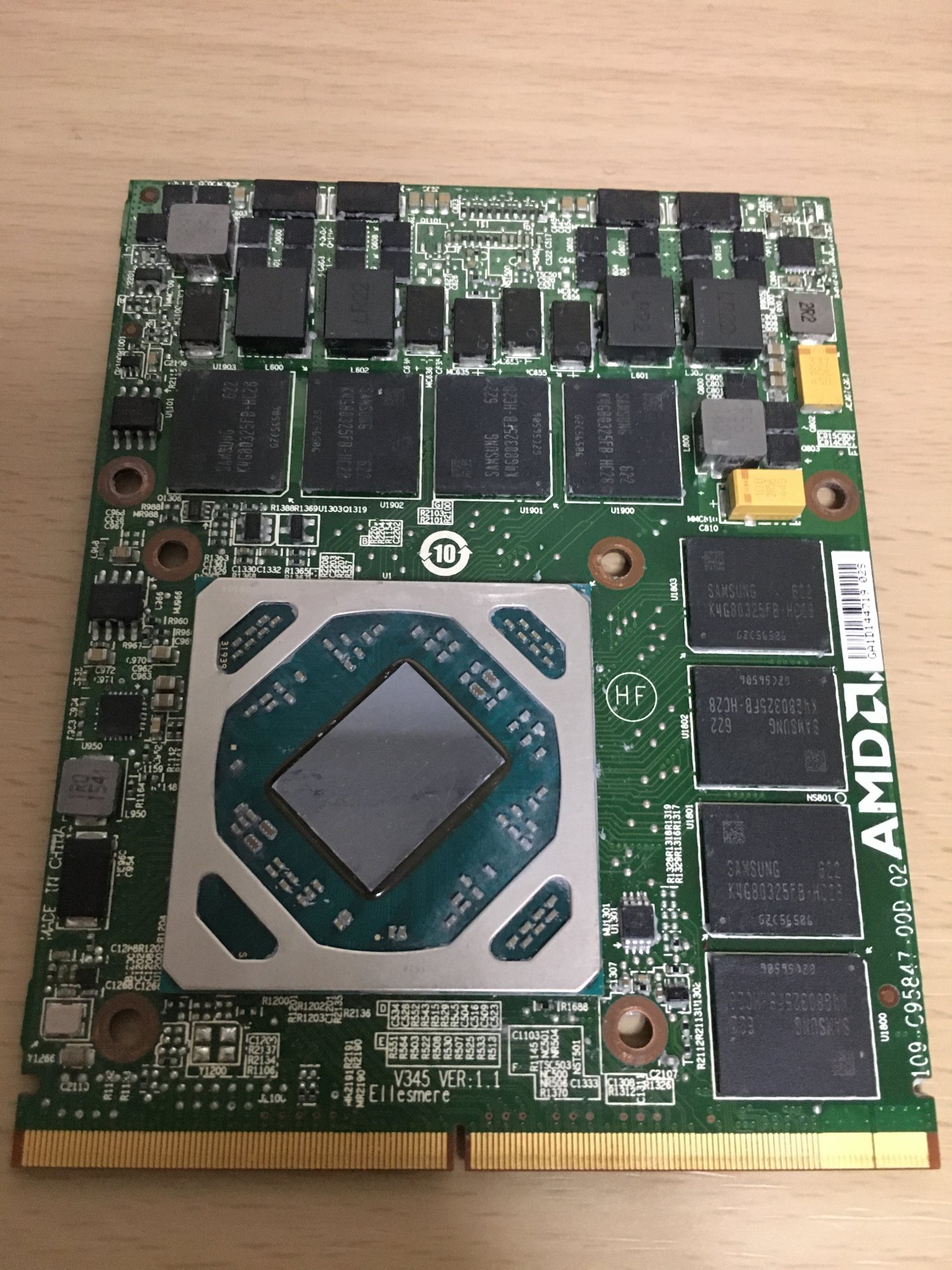

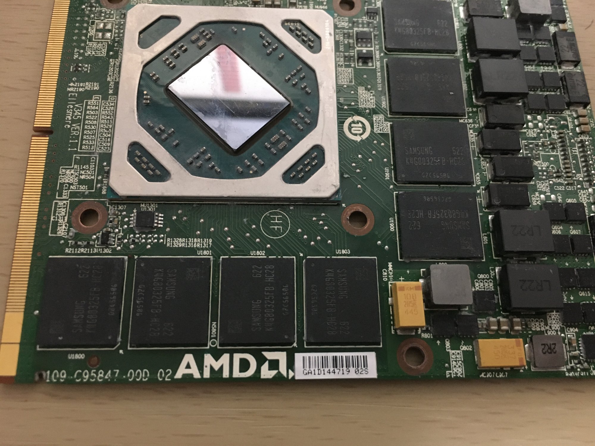

Hello everyone
I'm Japanese and can't speak English so I use google translate.
It may be difficult to convey the content, but please forgive me.
When upgrading the GPU, the wx7100 has the highest performance, so I considered upgrading with the wx7100.
(I purchased "Quadro 4100m" as a sub-plan. This can be used without any problem.)
<My machine>
iMac mid 2011 27inch (iMac 12.2)
OS: High Sierra 10.13.6 (security update applied)
(Windows is not installed.)
<Details of implementation>
1. I bought a card that seems to be wx7100 on ebay. It is attached to the photo.
* According to a recent post, it was reported that those with the description of "ver1.1" will work with imac12.2.
2. Flash vbios using "ch341a"
I rewrote vbios of eeprom with ch341a. As for the vbios used, I tried all the ones described as rx580 included in "amd beta 4" that was uploaded to the destination accessed from the link "rom0" of wx7100 described in post 1.
3. Install wx7100 and turn on the power
I installed OC on the SD card in a bootable state in advance and set the boot screen to start. As usual, the activation chime will work, but the card will not be recognized. The four LEDs on the logic board are lit up to the second, but there is no display on the built-in display, and there is no external display output from the TB port.
I tried to do the usb method by rewriting vbios, but I couldn't because the GPU is not recognized.
<Question>
1. There is a lot of discussion in this thread, but is it okay to just rewrite vbios to use "wx7100"? I understand that gpu upgrades are not plug and play. I also know that the information I have collected is not enough to understand.
2. Is my card wx7100?
3. Should I think of my card as a "dead card"?

0. Since you have booted with the card installed (you got the boot chime) it will work in your iMac12,2 (Mid 2011)
1. This is a VER 1.1 WX7100
2. You need OpenCore (OC) to light up the internal LCD on boot
or
3. You can boot without OC and you have just to wait until the boot has been finished, the macOS Radeon driver will switch on the internal LCD at the very end.
4. You could have tried the original Dell vBIOS on the card, in most cases it works, too.
5. The AMD_BETA4 version needs an external display connected to start up the internal LCD and the very end of the boot using High Sierra (this may be your problem!)
( copied from the Beta4 post)
Although the Beta4 roms enable native brightness control, there is a catch:
[1] To enable brightness control and keep full performance in MacOS we use the generic "Radeon frame-buffer", but this seems to break High Sierra, causing a black screen during boot that is fixable using OpenCore / WEG or by connecting an external display. High Sierra users could just stick with Beta 3, which used the Salado framebuffer to restore performance but doesn't allow native brightness control. Beta 1 & 2 used the Longavi / Berbice frame-buffer which can work with native brightness control but also applied mobile power-gating that cripples performance in MacOS.
6. Try the AMD_GOP vBIOS version and later install OC
7. With all the AMD vBIOS versions you get only the first two and the fourth LED working, the last only after activation of the internal LCD!
