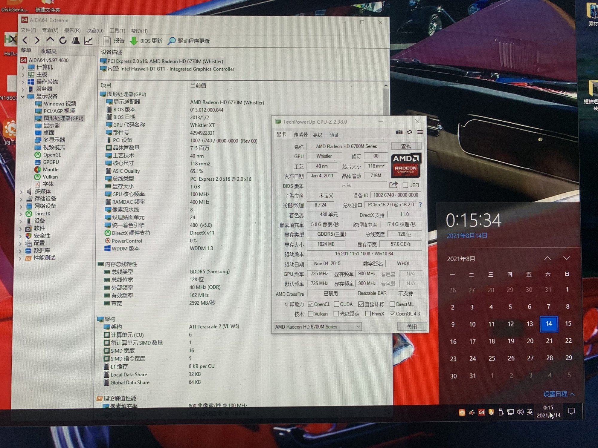

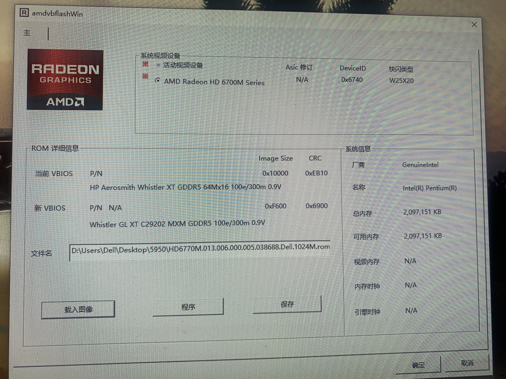

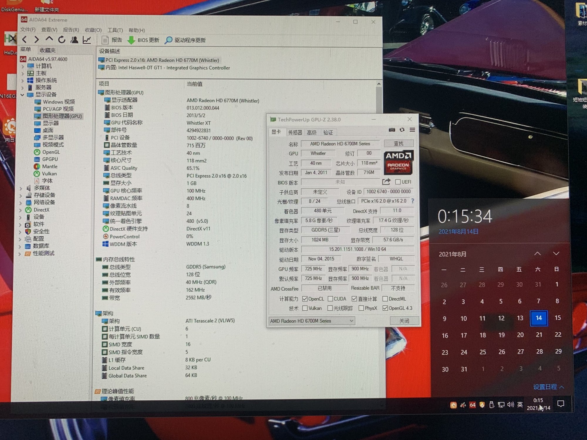

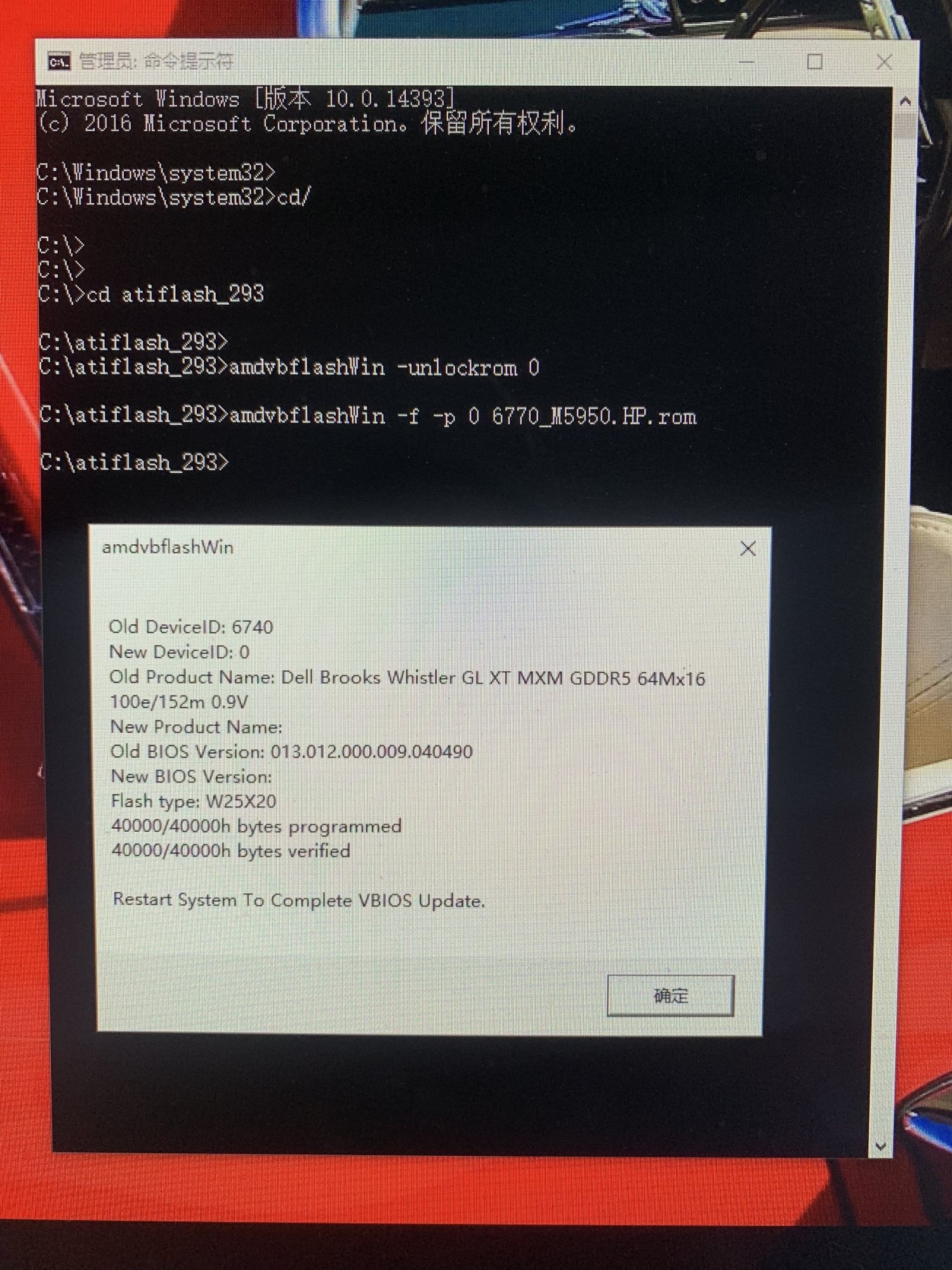

Looking for help moving the circuit, before looking at the forum someone shared a Dell Red PCB HD6770M replacement 128k capacity EEPROM to write a modified Dell HP VBiOS support iMac. i myself also have a Dell Red PCB HD6770M can work fine on iMac 2011 21.5 2011 27.
I recently acquired 10 HP M5950 cheaply, the pcb color has two kinds of blue and green compared to the Dell red PCB front missing EEPROM to make up for themselves, the back circuit has a difference part of the empty solder.
I'm pretty sure there is no problem soldering EEPROM, soldered 6 sheets are the same result can not read from the EEPROM to identify the correct VBiOS information written VBiOS written a different Dell HD6770M forum modified Dell HP iMac M5950 6770M are the same. It is blank in any case.
EEPROM is to purchase dozens of brand new Huabang 256kb capacity actual written VBiOS information is 128kb.
These M5950M 6770M are HP 8560W 8760W tested to determine that the graphics card is normal workmanship without any problems. In the PC PCIE adapter MXM development debug card test graphics card can also work properly run scores also no problem. gpu-z view VBiOS information is blank did not correctly read the various tests written by CH341A VBiOS information.

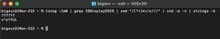

May be your panel type is a non standard. Find it out using this and post your type.
For what it's worth on my iMac 12,2 with a K3100M I get a null answer to the panel type. (I too have an issue with sleep and figured it would be worth looking)
Code:
$ ioreg -lw0 | grep IODisplayEDID | sed "/[^<]*</s///" |xxd -p -r | strings -6
Check each of @nikey22 vBIOS upload posts - he described another method.
Anyway this cannot be the root cause - IMHO it is only related to the range, not the core functionality.

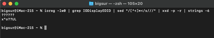

That ioreg output may not be 100% way to check LCD type, because running this on my 27" returns just nothing.
Will follow @nikey22 posts them - maybe find something I could hook up to and try to solve the problem...

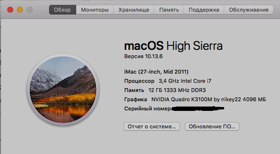

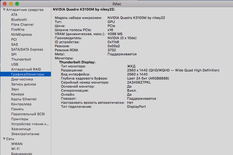

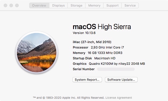

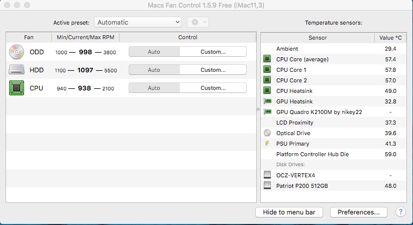

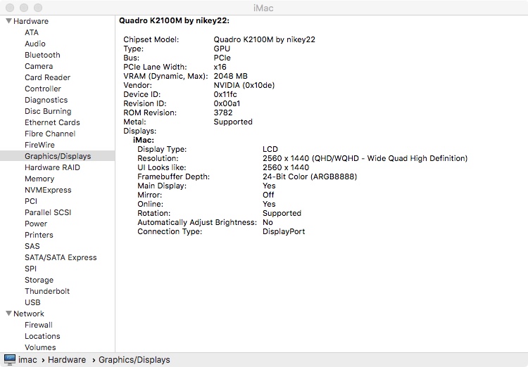

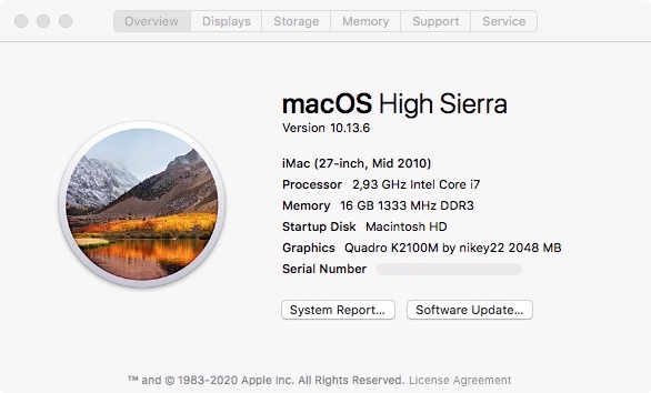

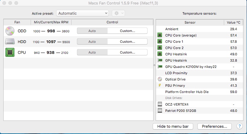

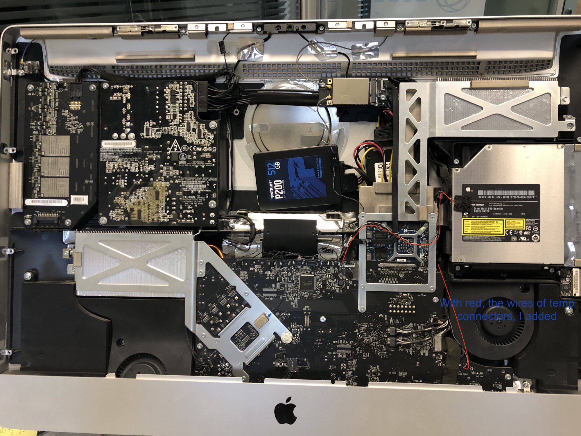

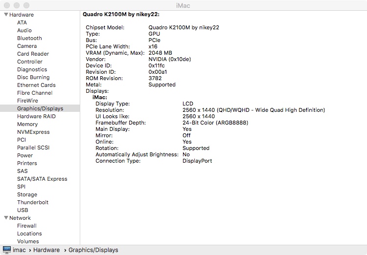

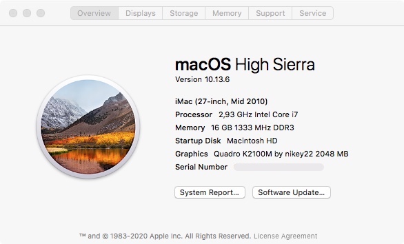

Hi guys!

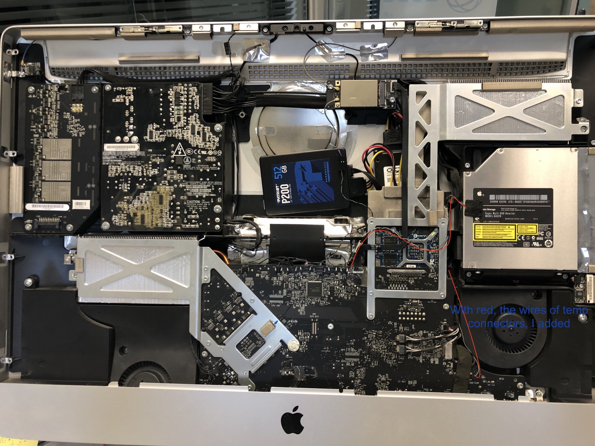

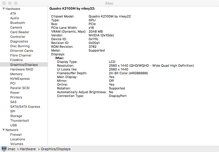

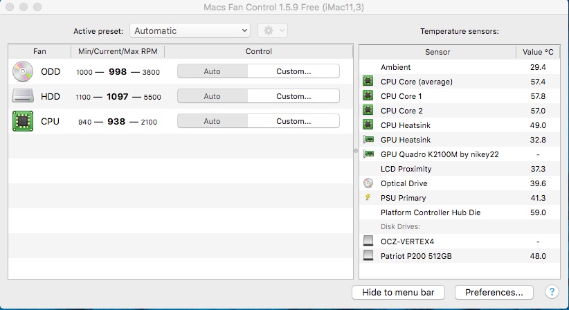

Just finished the update of my iMac 27, Mid-2010 - i7 with the QUADRO K2100M nvidia. All went OK. It took several hours because I was enjoying every step and wanted to be sure for anything.
A big thank you, to all of you that help us to do the upgrade with the instructions, the custom ROMS and your experience.
I wanted the least hardware modifications so I choose the K2100M as the most powerfull without the need of the 3pipe heat sink. I also did the temp sensors transfer (ODD to heat sink and GPU heatsink to ODD) witch needed to make the wires a little bit longer - so the need of some soldering. I also added the macs fan control for safety.
Only the brightness control is not working but I thing it will with OLCP and big sur.
I did not upgraded the OS - still in high Sierra. I'll do it tomorrow or the next day cause it also needs some extra hours. i'm attaching some photos.
Valley test: 25.2FPS, 1053 Score.
Geekbench5 Metal score: 2402.

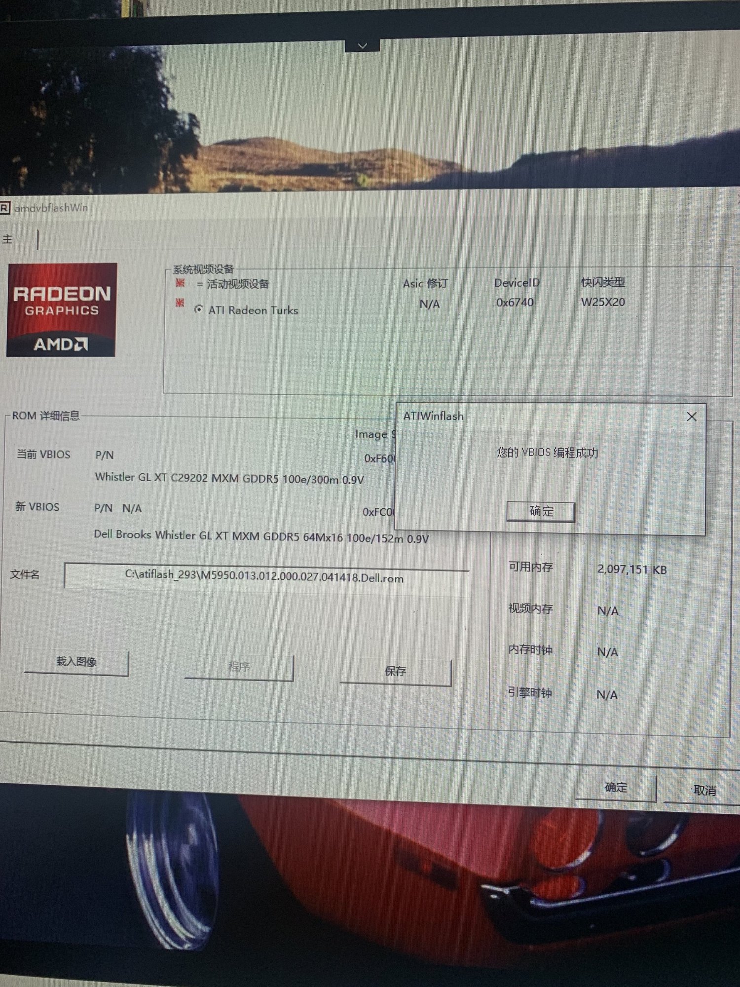

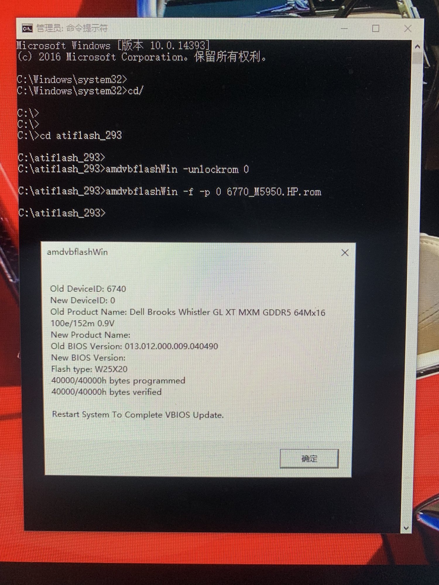

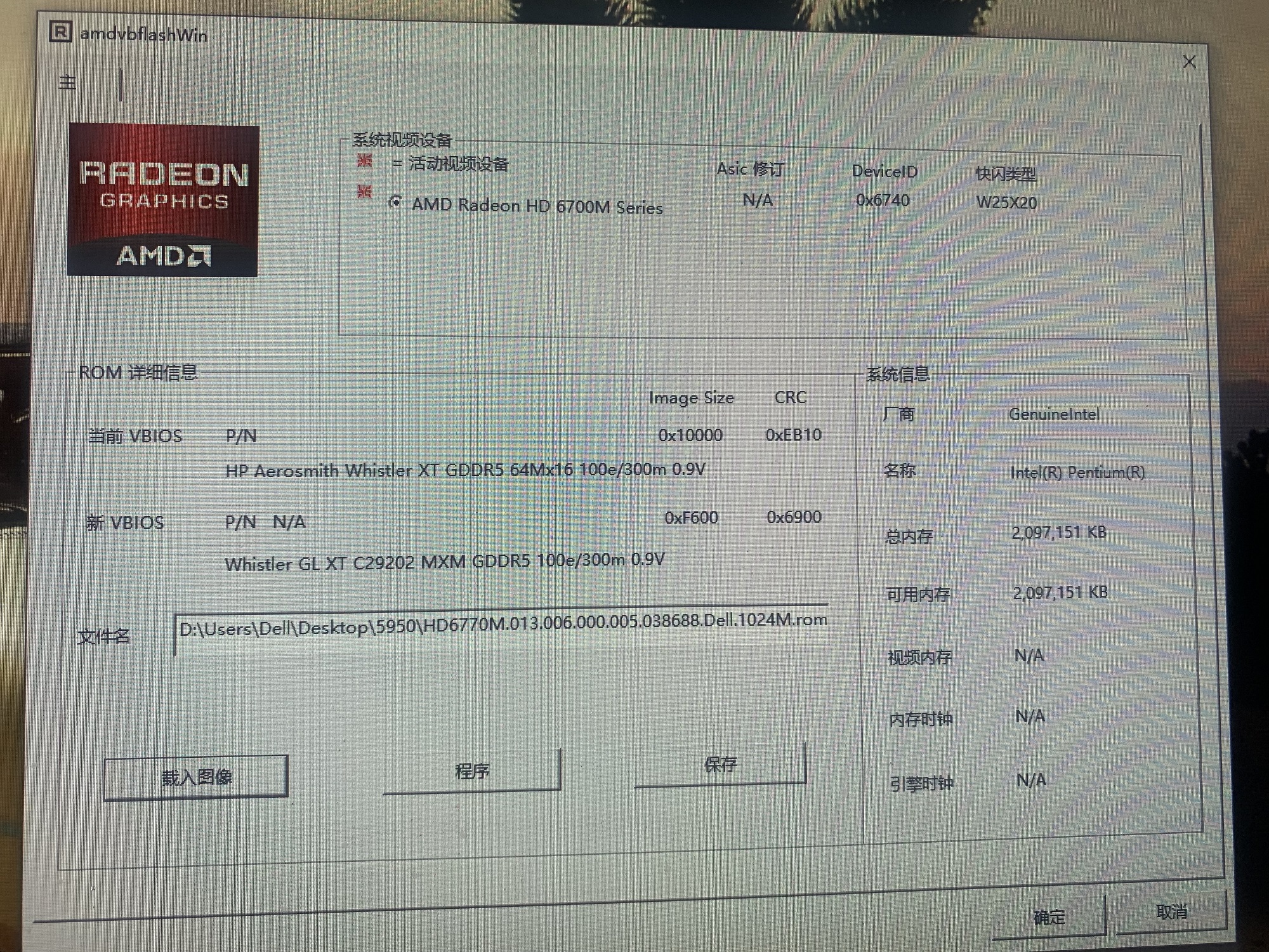

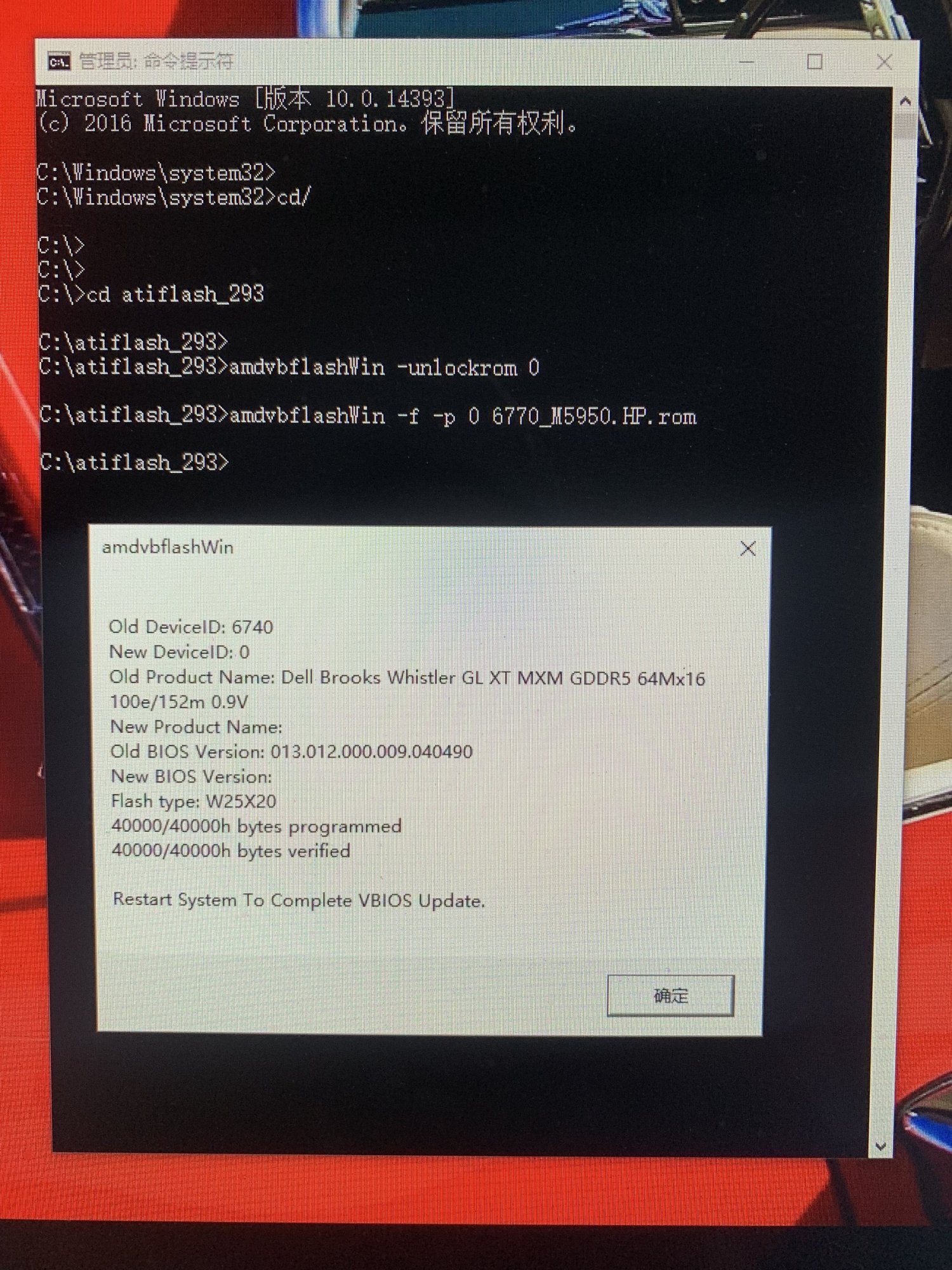

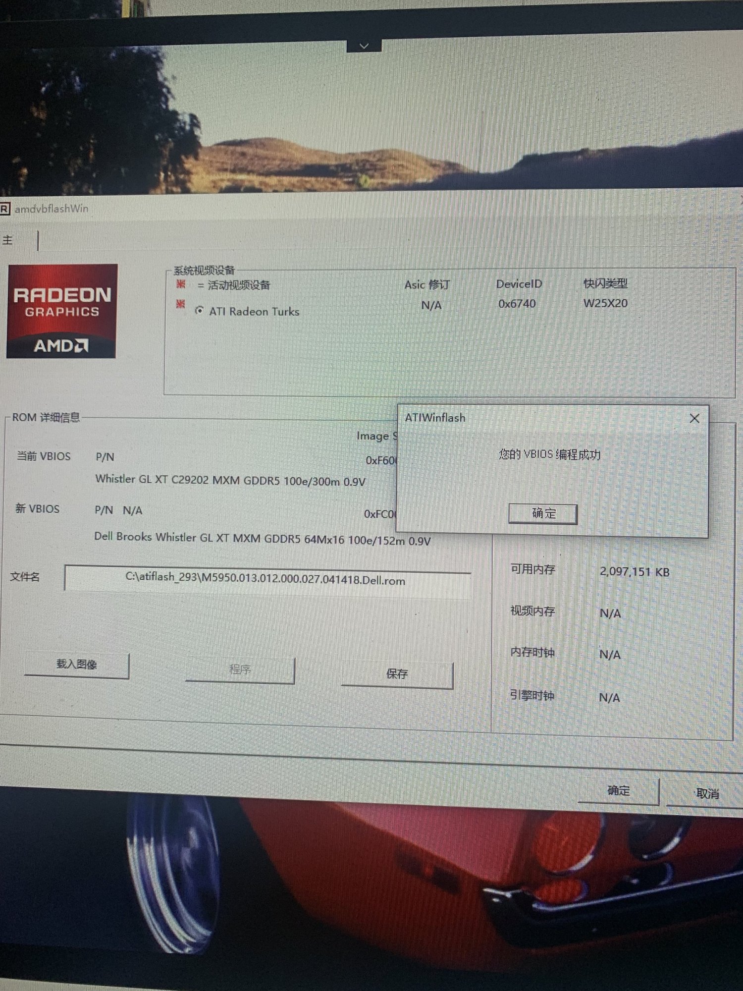

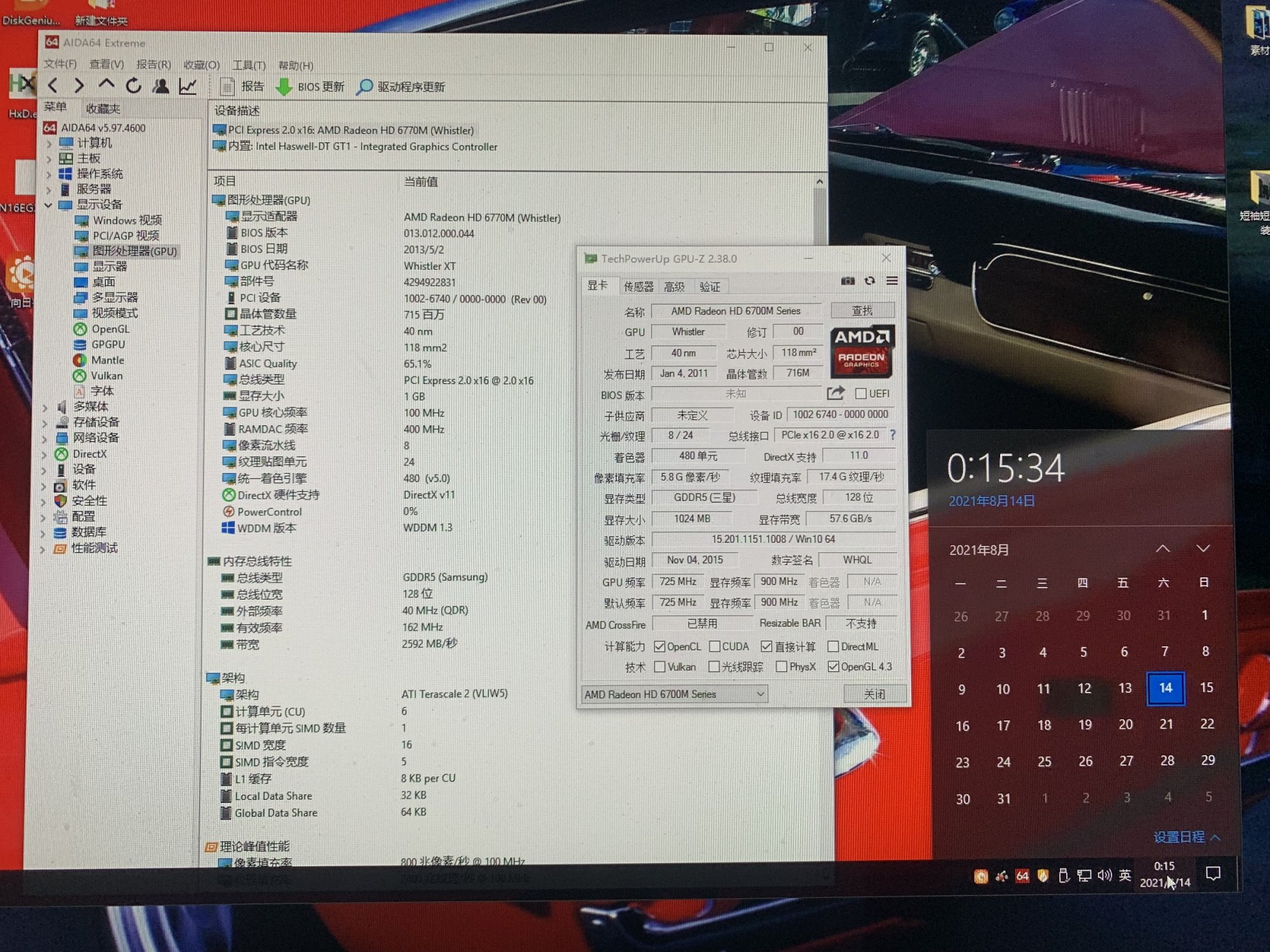

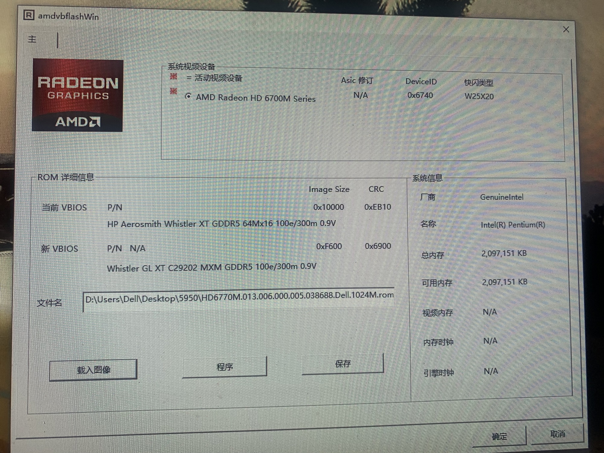

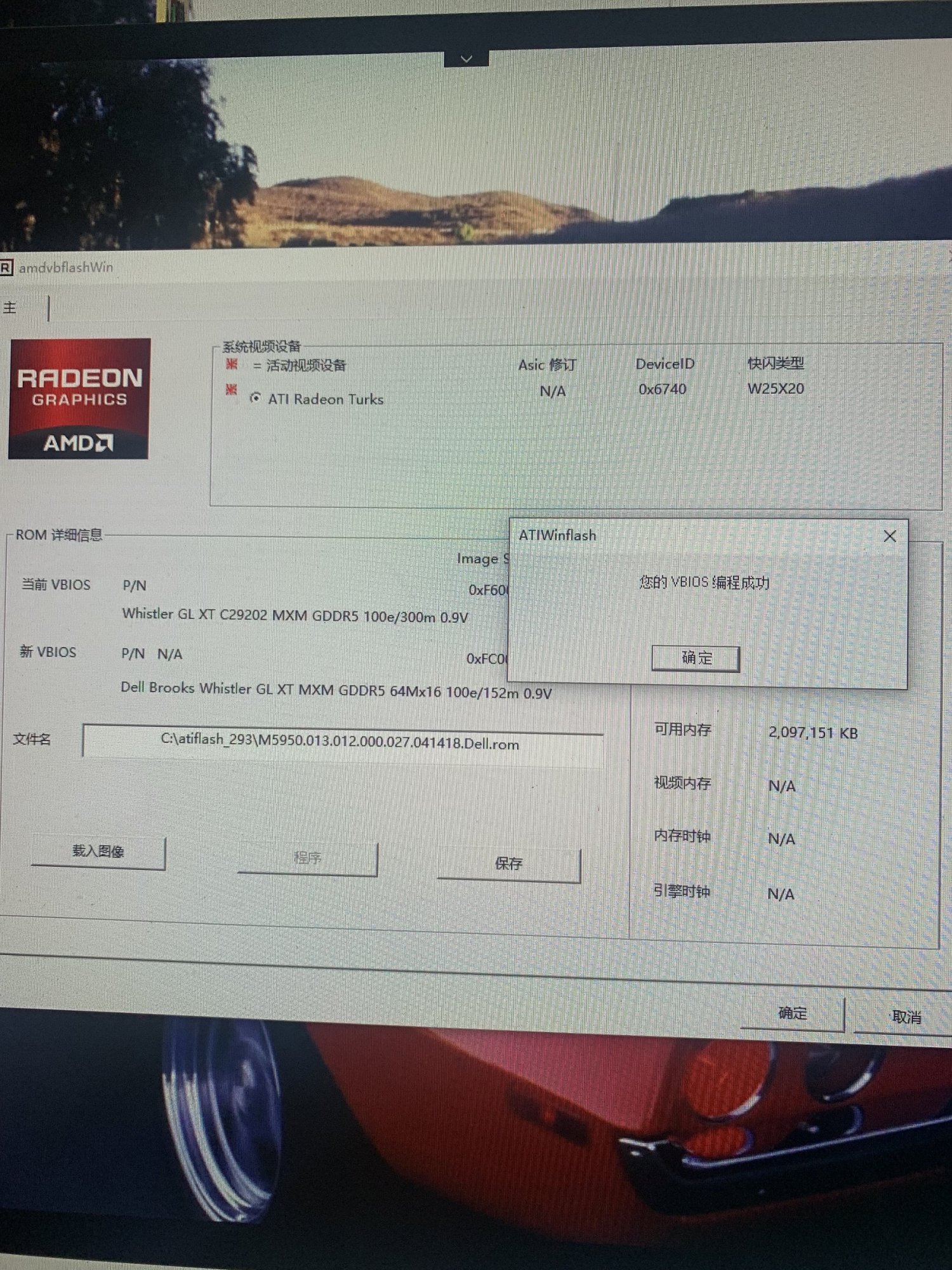

Did you try to flash using amdvbflash?
Hi @internetzel Using amdvbflash graphics tool with CMD command to refresh Dell original M5950 HD6770M shows programming success, test GPU-Z tool shows VBiOS information is still blank no correct reading of VBiOS information written by programming. I guess it's still a hardware problem.
amdvbflash shows valid version and product name for the EEPROM contents - so I'd say that flashing has indeed been successful. It doesn't show anything for the new VBIOS you are flashing, but if I remember correctly that happens when old and new VBIOS have identical version and product name.
As the translation into English isn't very clear, I maybe didn't understand your actual problem yet. So you try to flash the VBIOS but the old VBIOS stays in place?
Maybe you're trying to flash the VBIOS in an HP machine? Many HP machines will always use and load the VBIOS from the system firmware and not from the graphics card itself - and it is VERY difficult to change that VBIOS in the system firmware.

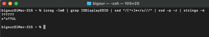

Code:
I also have a green PCB 1GB version that had no bios chip, I soldered one from a dead 4670 and put it in the correct vbios but as you experienced already it is not read like the card still has no bios chip as before, I suspect it has some missing stuff, resistor or whatever on the bios line, if you find a fix please let me know.
