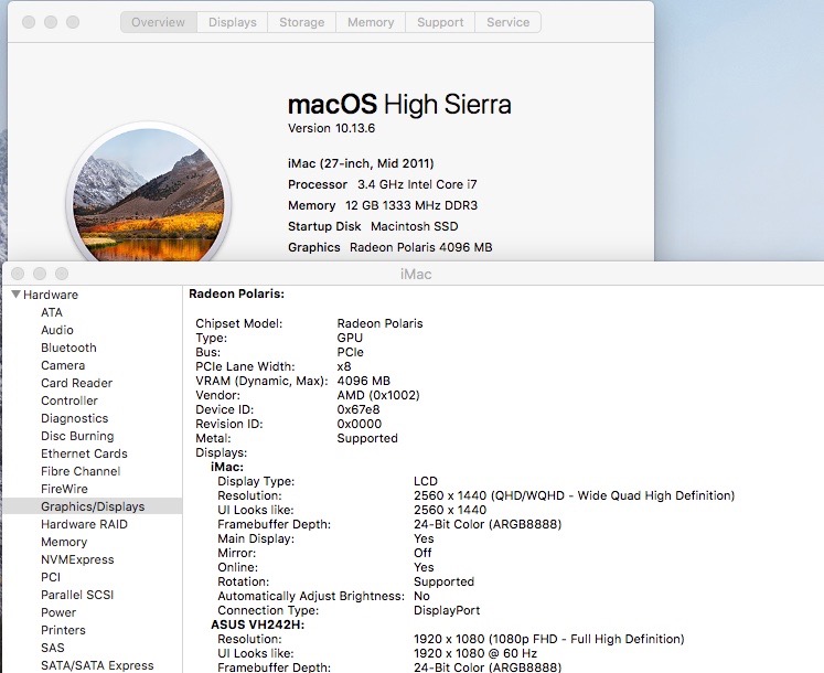

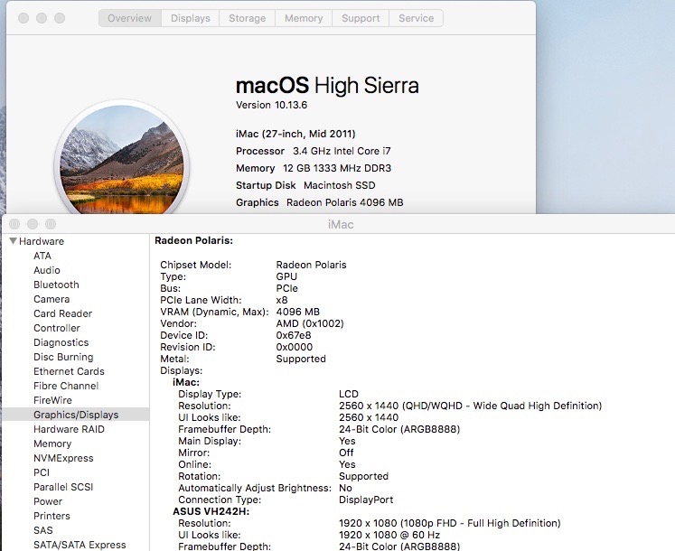

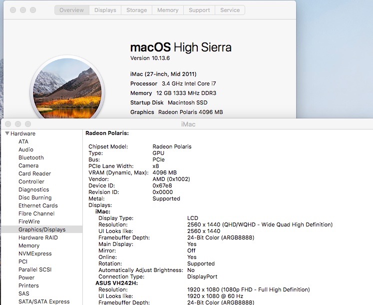

I've been trying to upgrade to Monterey, but I can't get the boot screen to pop up. I've been assuming it's because I needed to play tricks with my iMac so the screen will work, but I'm wondering if there's something more fundamental going on here. I just looked at "About this Mac", and this is what came up:
Is a "Radeon Polaris" the same as a WX4150? If not, then the ebay vendor sent me the wrong card and explains a couple of things. If it is the same, do you have any idea how I can upgrade or downgrade out of high sierra without using a boot screen?
I've been trying to upgrade to Monterey, but I can't get the boot screen to pop up. I've been assuming it's because I needed to play tricks with my iMac so the screen will work, but I'm wondering if there's something more fundamental going on here. I just looked at "About this Mac", and this is what came up:View attachment 1904940
That's exactly the expected behaviour, so all is well!
