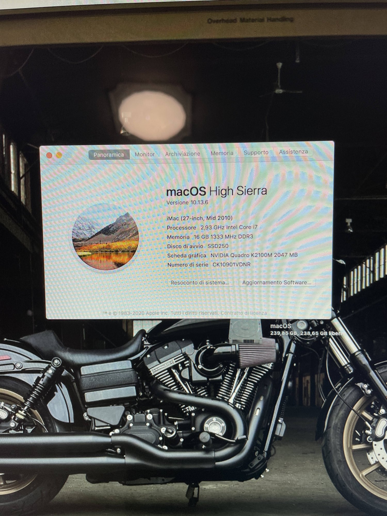

I have a problem. Help me
My network card sometimes doesn't work
I mounted the K2100 and started osx
Black screen but works in wifi mode

I do not understand
I was unable to patch the network card problem but does it work?
Now what do I do
Which network card problem? There is no with High Sierra.
