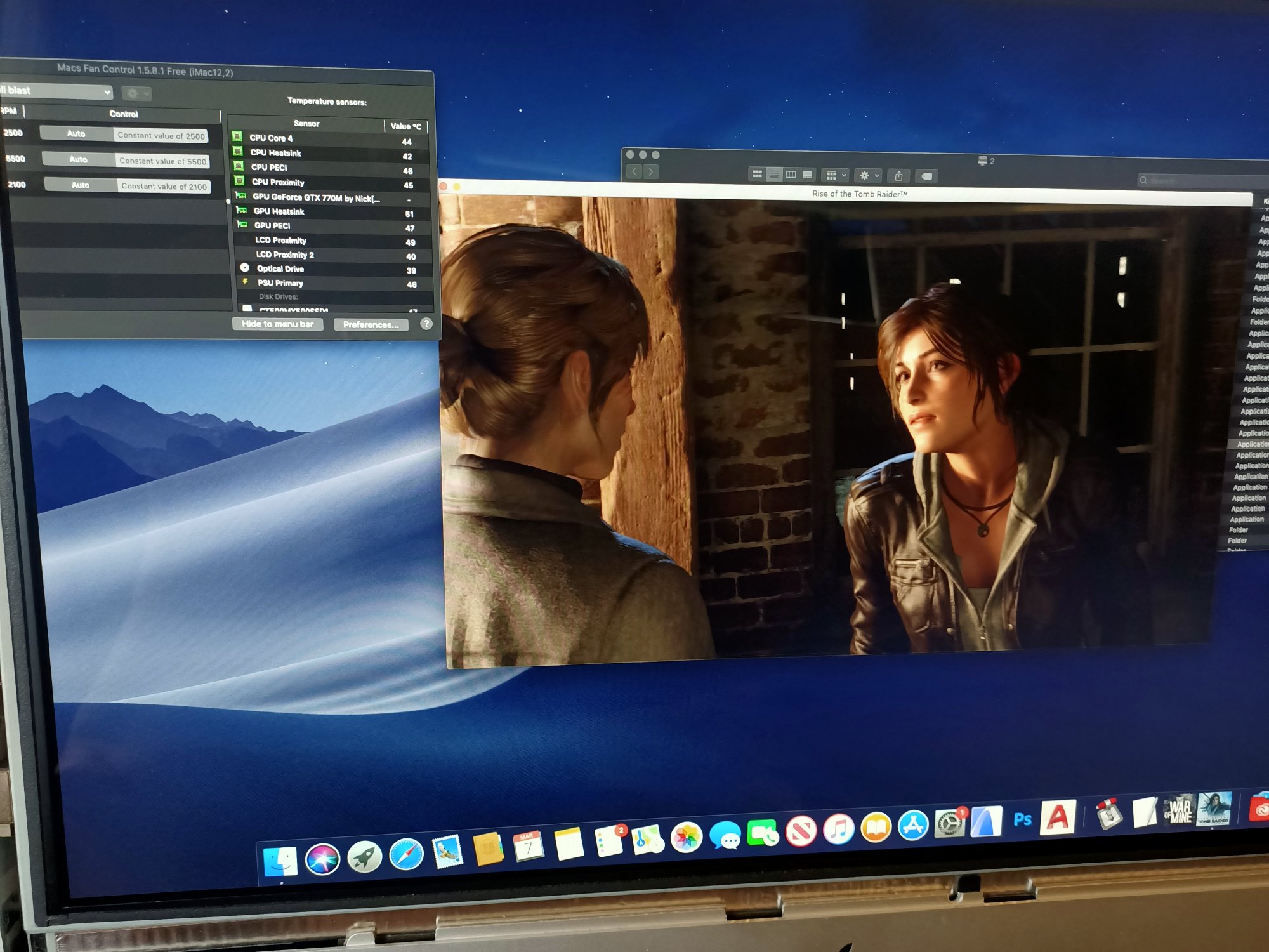

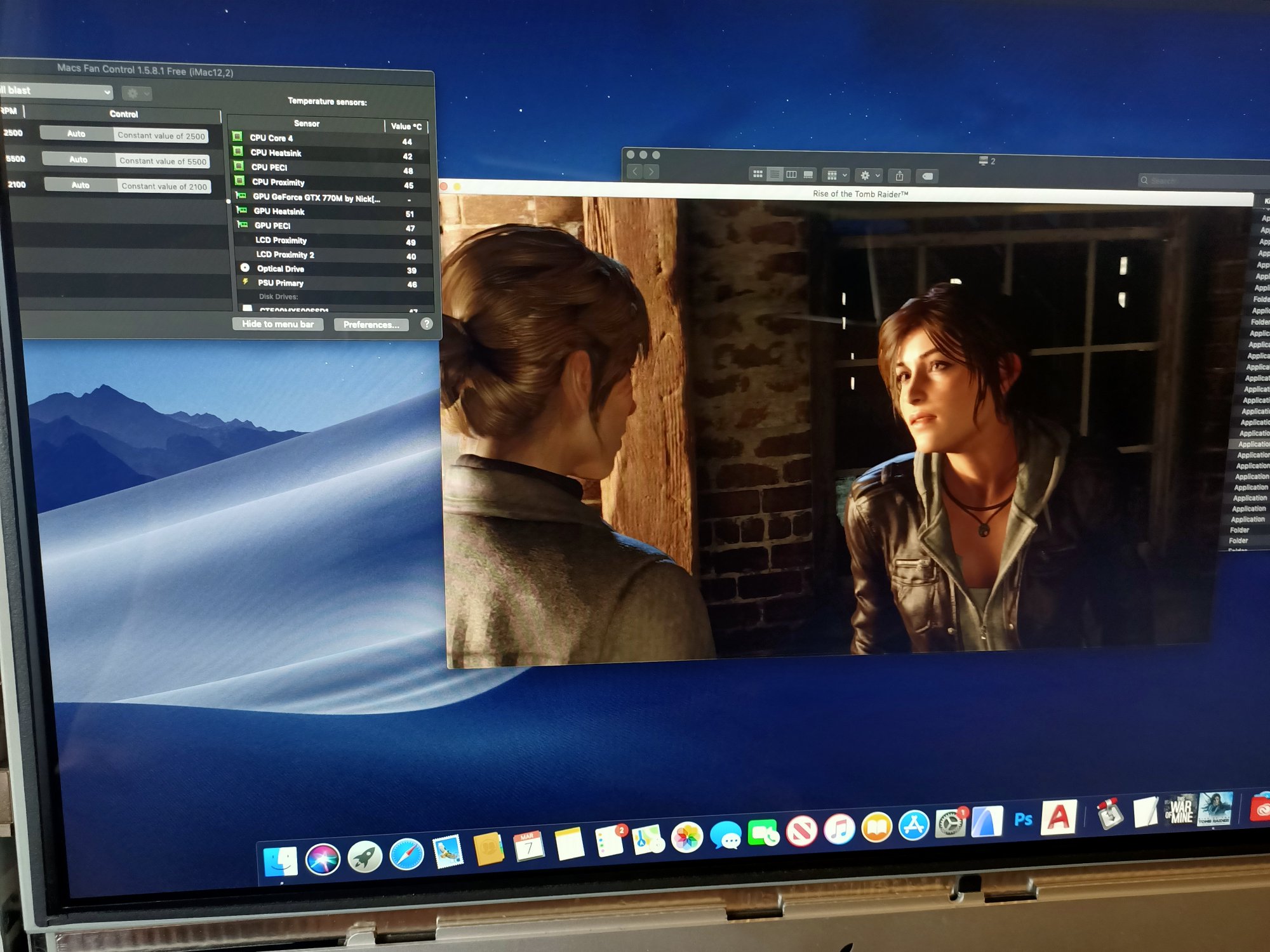

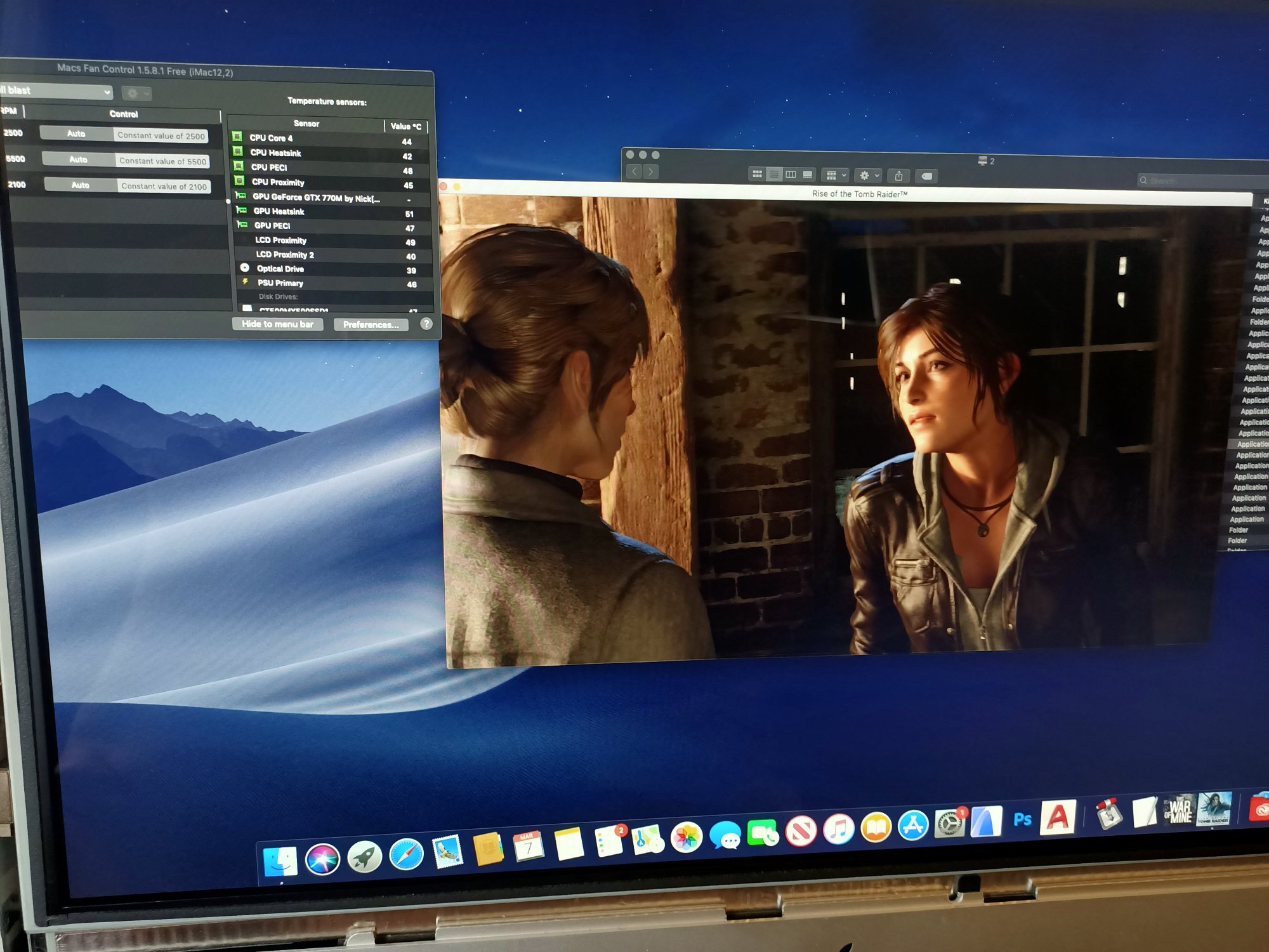

When gaming I always have the fans set to full blast in MFC, i noticed the LCD get super hot.
I just stripped the iMac down and baked the 770 (probably not a wise move but the card was not to expensive) and all is good for the last hour, I will try the patched bios as suggested, and probably invest in better paste and invest in some kryonaut, currently using arctic mx2 and blue eBay 1mm thermal pads.
Hi, did you ever find out if it worked with the new vBIOS with lower clock rate? Did it fix your issue? My heatsink temp goes up after booting till 60 degree Celsius. and stays around there. With fans on full blow I get to 55degree. Sometimes I get artifacts as well and sometimes the iMac freezes. It starts mostely when I start browsing the web. I installed the GTX 770m into my late 2009 and it was perfectly recognized after i installed Nick's custom vBIOS. Is the vBIOS posted here different from the verison linked on the first page? It would be nice to know if you just got a faulty card or if you found a fix for it?
