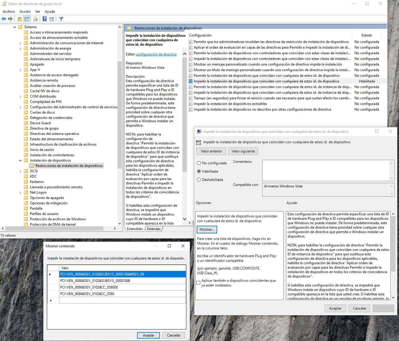

I'm not sure about bootcamp install, but on UEFI Windows 10 installs OCLP disabling the HD3000 does not work, and that causes the well known driver problem BSOD on first boot with internet (as soon as Windows downloads and installs the HD3000 drivers). You have to manually disable the device or (better) create a policy to avoid any further driver installs for the iGPU.

ok now I do not know what to do, I have Windows 8 installed in dual boot and I have not yet made the internet access, and I tried to disable the hd3000, I attacked the network and unfortunately still finds it in the updates. so as soon as you install it will not work anymore, and in the site OC in the end say to follow this method, I have not yet installed OC. NOW I have a doubt I tried from a USB pass the drivers for the 880m but when the installation starts it says it does not detect hardware components, thank you for the help
You have to create and enable the group policy before windows connects to the internet. I wrote about it on a past post.
This is how it looks in my (spanish) windows 10:
Is this by any chance the same as described here ??
This link can be found within the great OCLP online docs with in the Windows 10 installation section.

Yes, it is exactly the same procedure. I'm pretty sure it's also somewhere in this thread... :)
On the very first post within the short Windows installation section and the best thing is, the video linked in there was made by a guy from Italy in Italian language...
