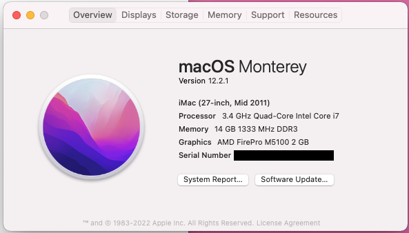

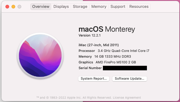

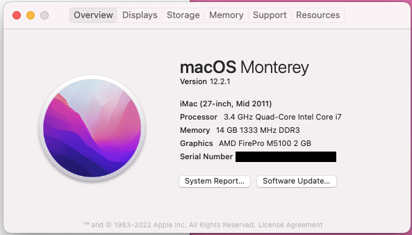

Wanted to thank everyone who built this amazing thread, I was able to follow and upgrade my 2011 iMac to macOS Monterey, also upgraded the graphics card to M5100! After a constant battle over the last few days finally (mostly) everything works smoothly and I am really excited that I can use this wonderful machine for a few more years to come!
The only thing that makes it less than perfect is, the wifi seems to be not working as expected, shows On in the settings but is not able to detect any wifi network to connect to. :(
I am using a TPLink adapter to connect to the wifi network, a nice workaround for now and too afraid to touch the configs anymore..
