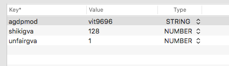

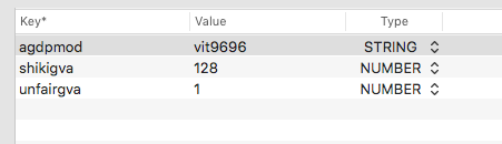

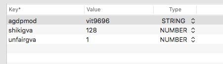

I decided to add the command agdpmod=vit9696. Without connecting an external display, the backlight of the system works 10.13.6. Without this command, a black screen after loading 10.13.6, this requires an external display connection, which is inconvenient. Thanks to this command agdpmod=vit9696 works great!
Who has a wx7100 video card
Now boot into Mojave, Catalina, Big Sur, Monterey or Ventura and report back if the internal and external displays are both still working?
Check this post or just search for the keyword vit9696 and post I made before. The most easy solution would be patching High Sierra….
Reactions: The_Croupier
Monterey boots normally without a display connected and without the VIT 9696 command. I needed a 10.13.6 system to work with old programs.

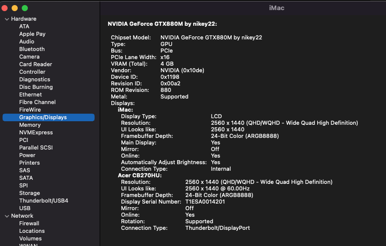

I was successful in installing a new Nvidia GTX880M and re-flashing the vbios. I've now got OSX Monterey installed using OCLP and I've noticed that in Mac's Fan Control there is no temperature being reported for the GPU. Is this normal for this kind of upgrade?
I double checked and I can see the heatsink temperature sensor is plugged into the motherboard.
Also, is there anything that can be done to prevent the fans from spinning up full speed at boot up. At the moment only Mac's Fan Control is stopping that from happening when I log in.
Thanks

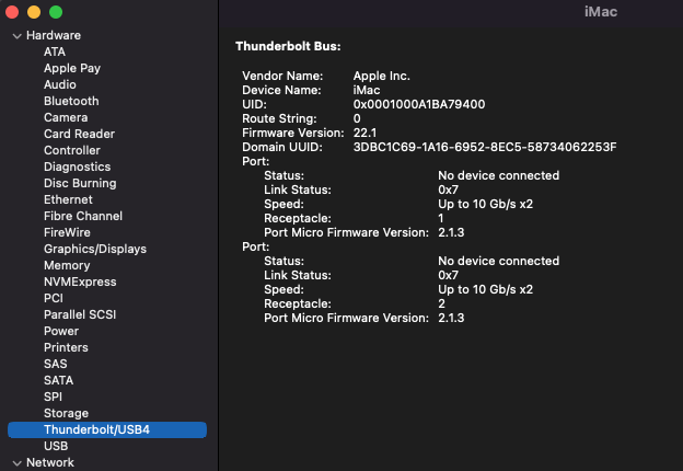

I've also just discovered that one of my Thunderbolt ports (the one right next to the ethernet port) no longer works with my second monitor.
Any ideas what that might be?
Hi Guys

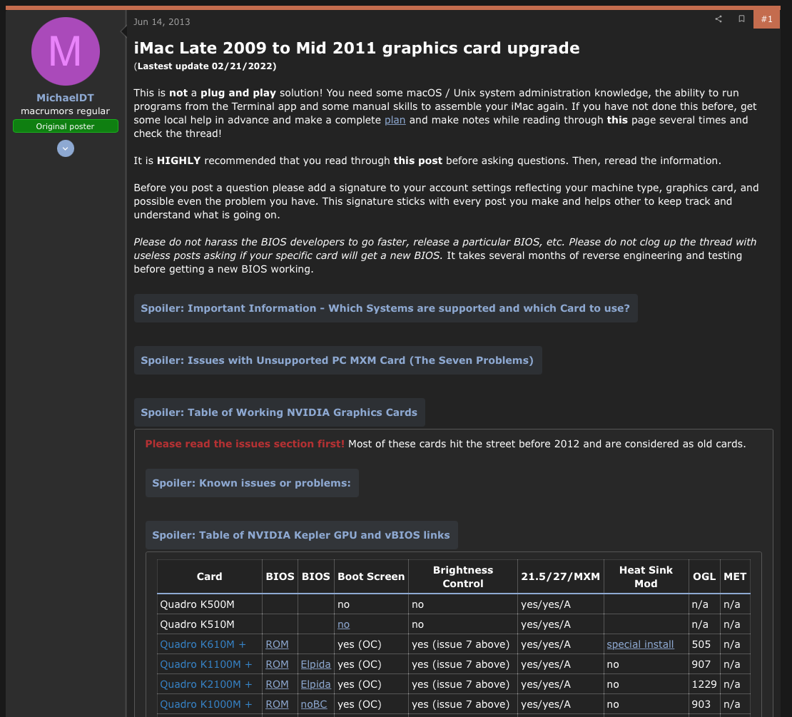

Check out quickly the last ten posts to get an idea where to search and read.
Thanks, yes I'm aware of the first page, it's where I started before posting.
Any way, I did stumble across one of your other posts. (https://forums.macrumors.com/threads/2011-imac-graphics-card-upgrade.1596614/post-30819372) Are you suggesting that my GPU choice (GTM 880M 4GB) is incapable of running two external displays? My previous card was the stock AMD Radeon 6970M 1GB and it ran the two monitors no problem. It feels like it's just this one port that does not want to recognise any thing plugged into it.
My iMac does show that I have two TB ports on my system, it's just that if I try any monitor attached to the first TB port, it does not work. The TB ports seems to be there in the system but not switched on??
Both of my external monitors work when plugged into Port/Receptacle #2 but are not listed in the Thunderbolt hardware report. Refer below image.
As you see in the below image, my GPU is recognising one monitor plugged into TB port #2
3. Despite having 2 miniDisplayPort outputs, the 27" 2011 iMac will only output to one external display. There is currently no fix or workaround for this.
😭😭😭 How on earth did I miss this when I was selecting a new GPU!
@Ausdauersportler Sorry for all the stupid questions, I honestly thought I was thorough in my reading. Somehow this one issue went right by me.
Do you know of anyone on here that might be trying to figure that one issue out?

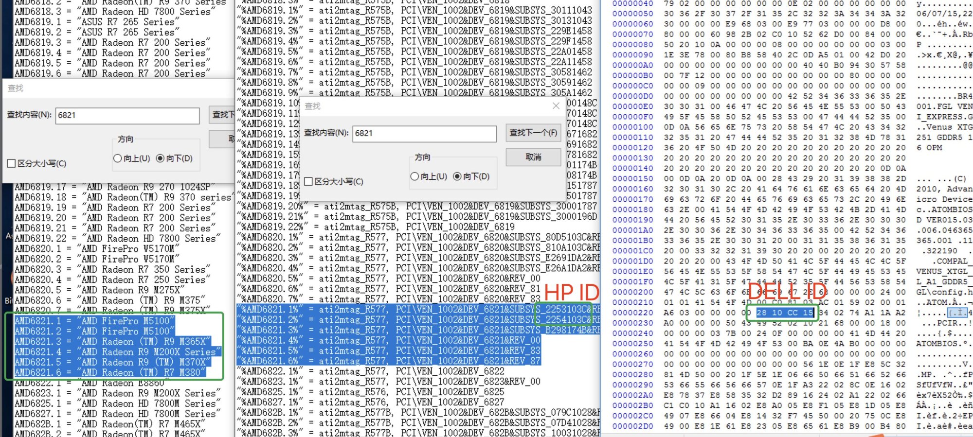

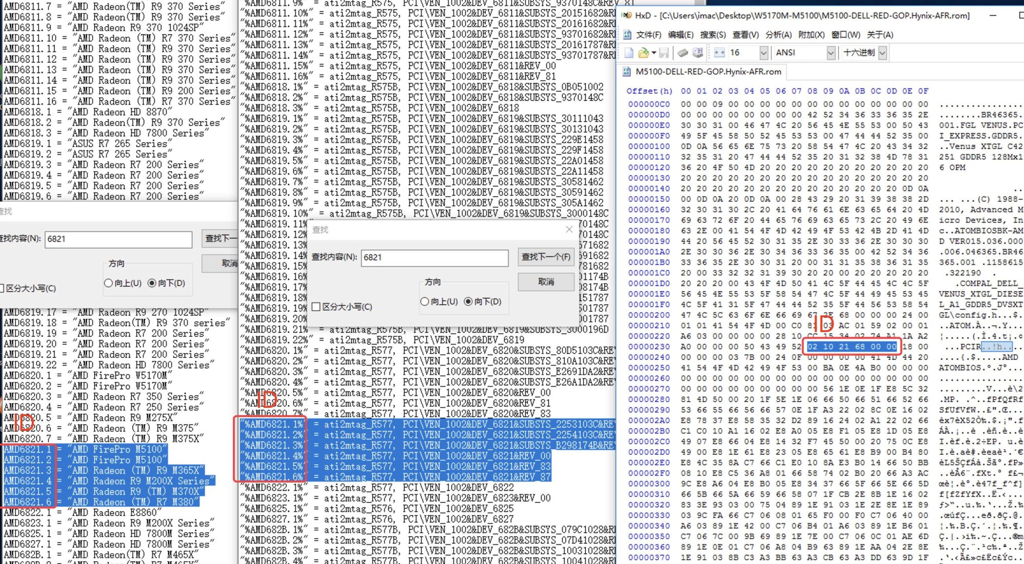

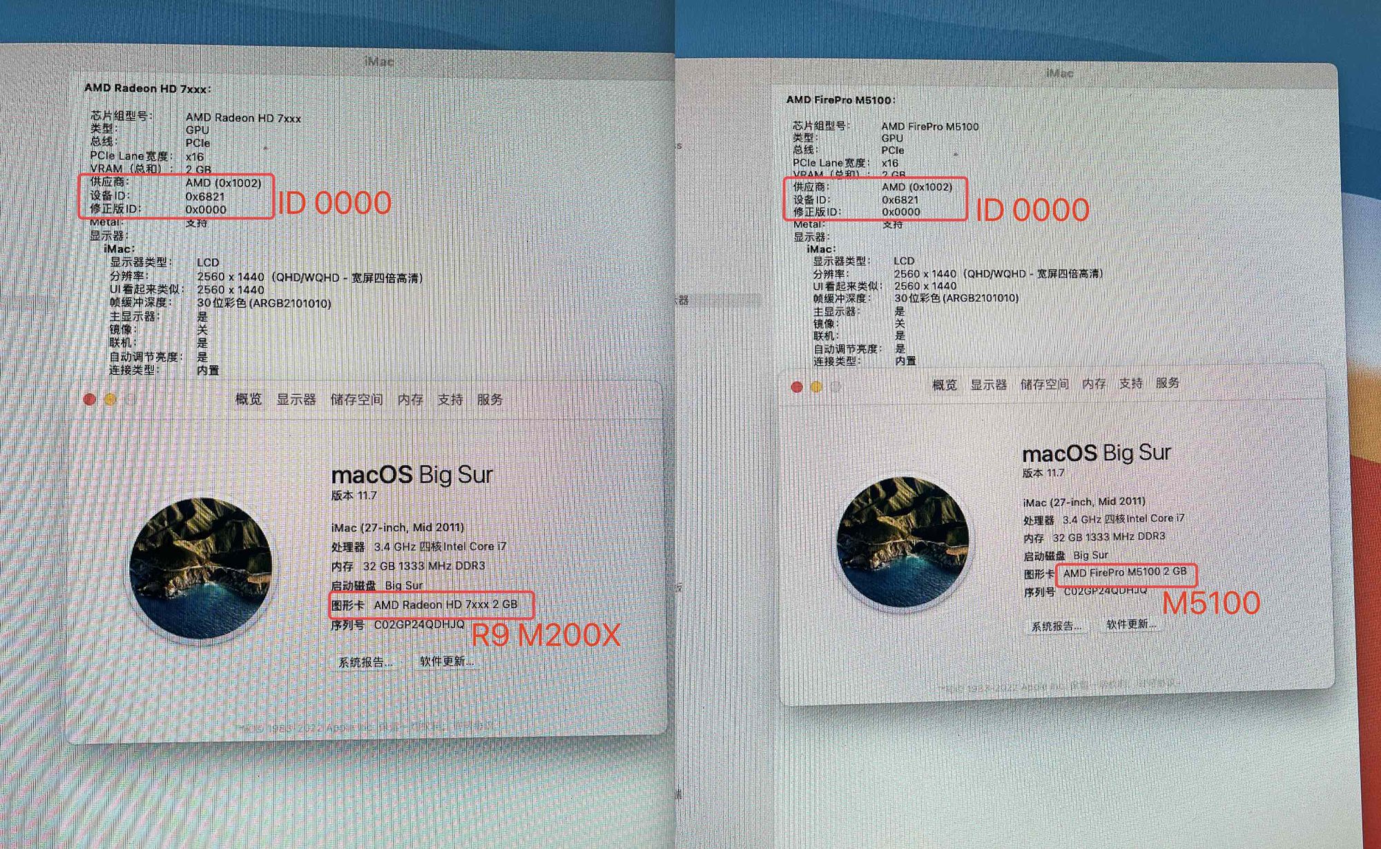

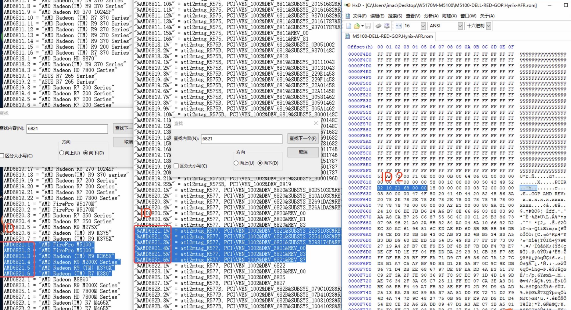

@Ausdauersportler @nikey22 @internetzel

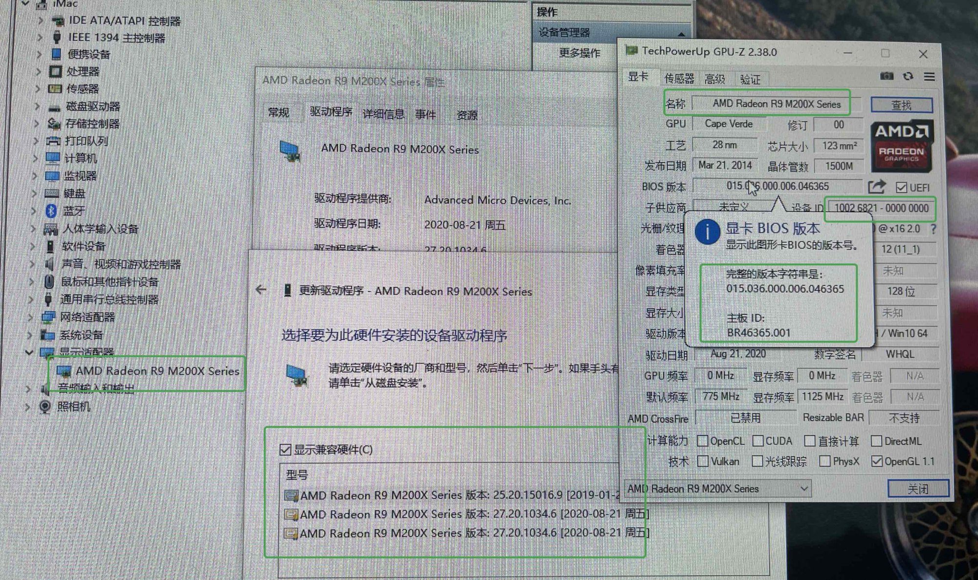

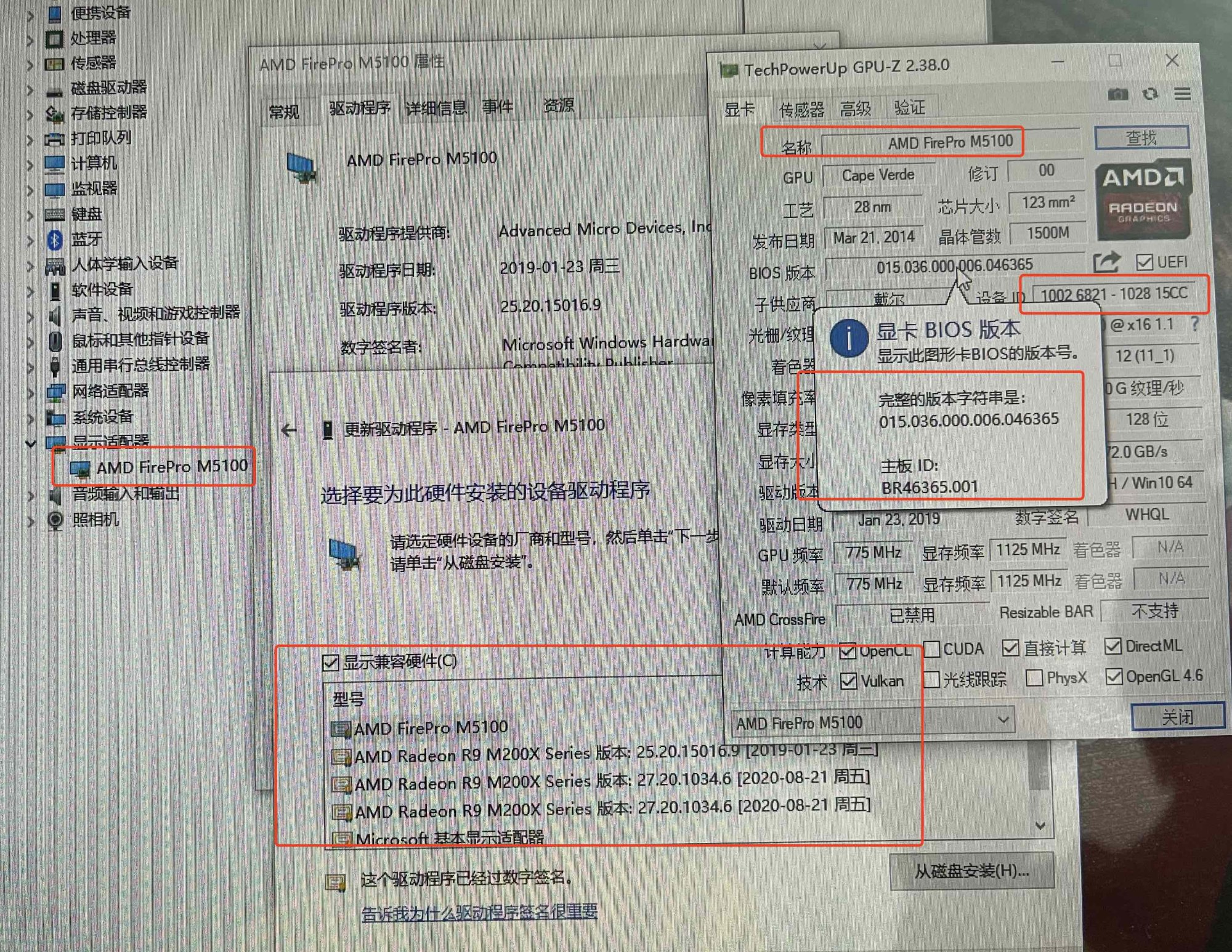

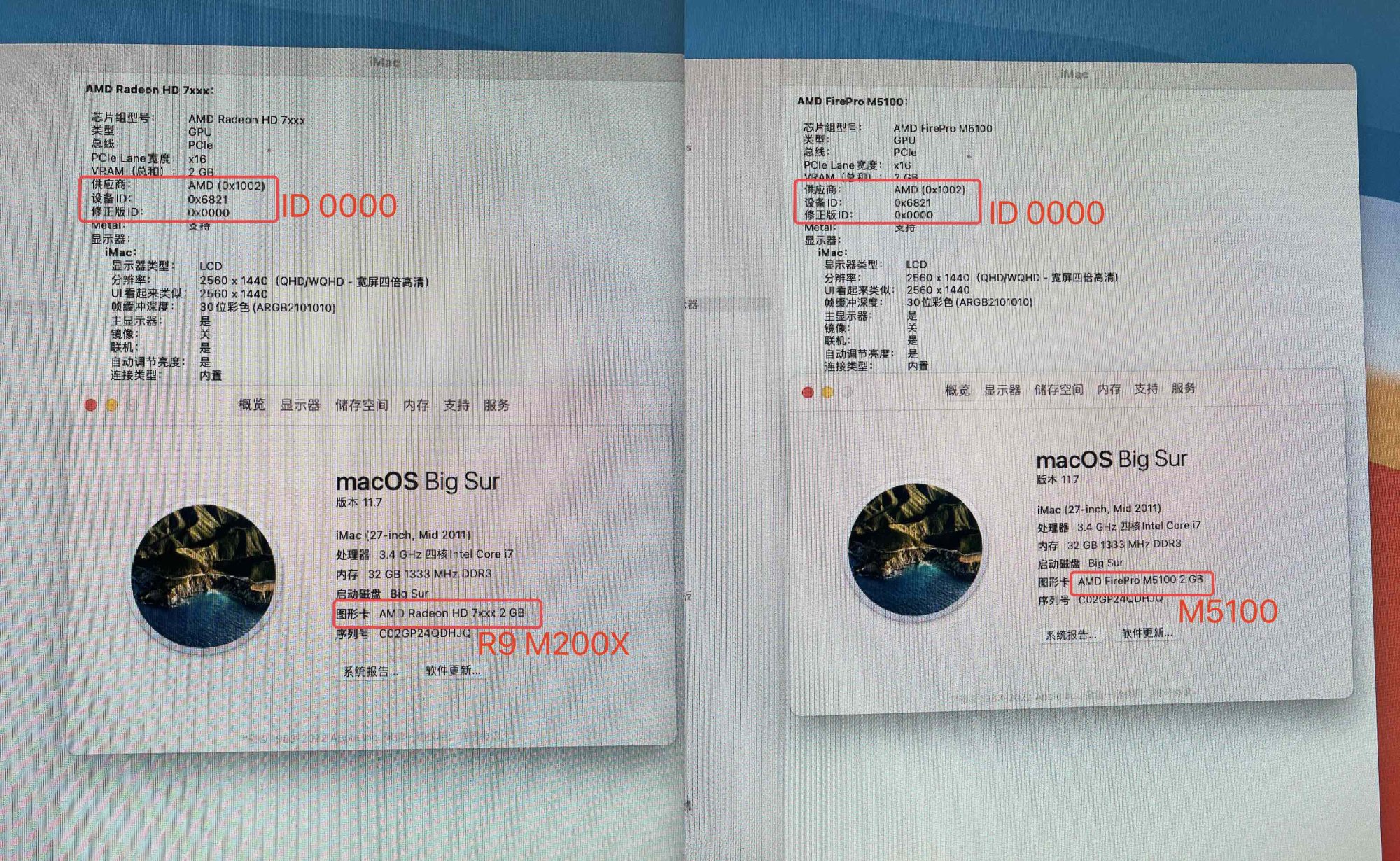

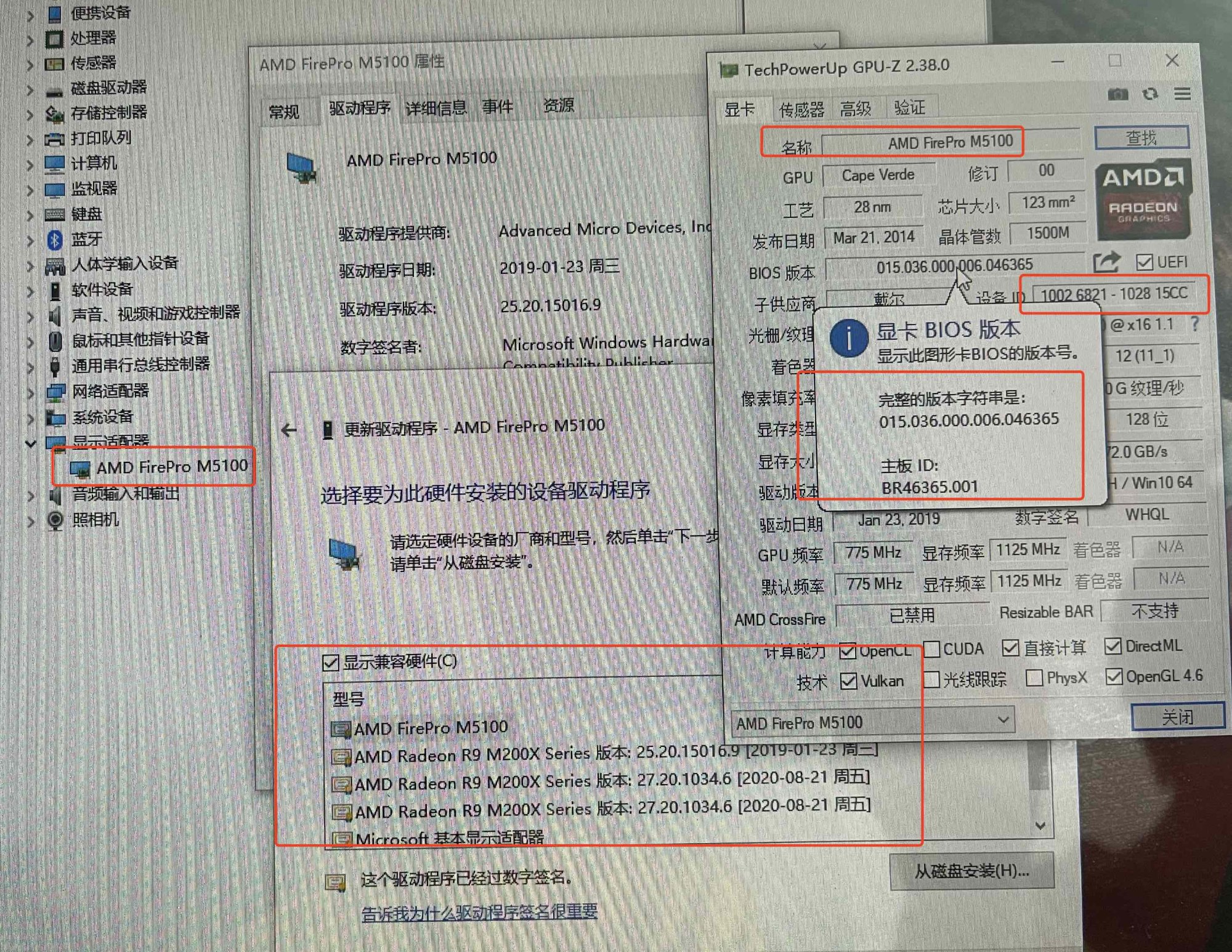

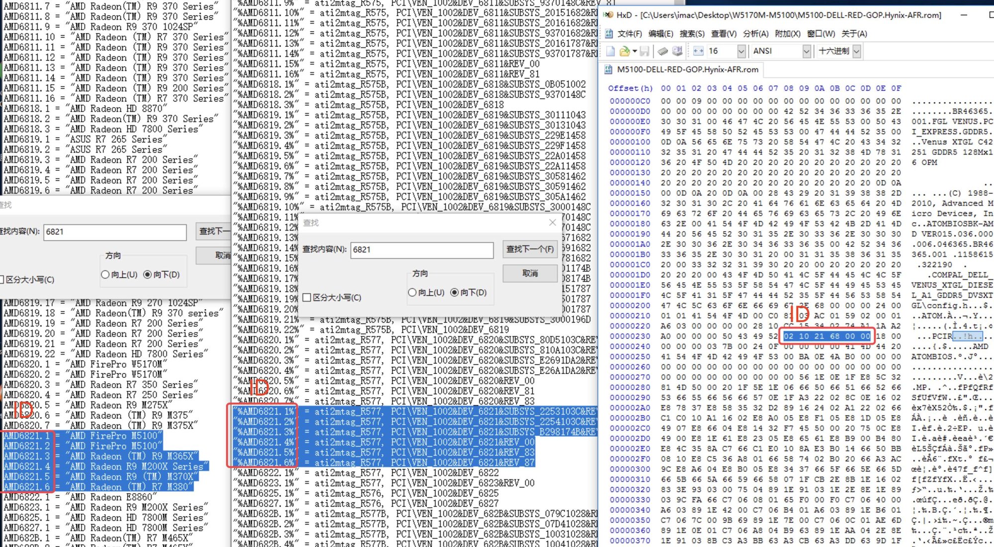

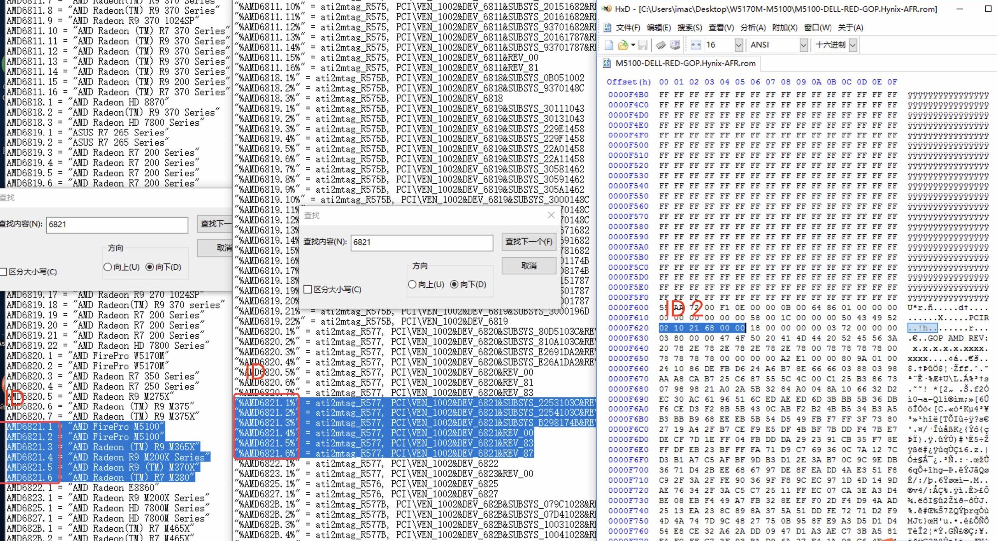

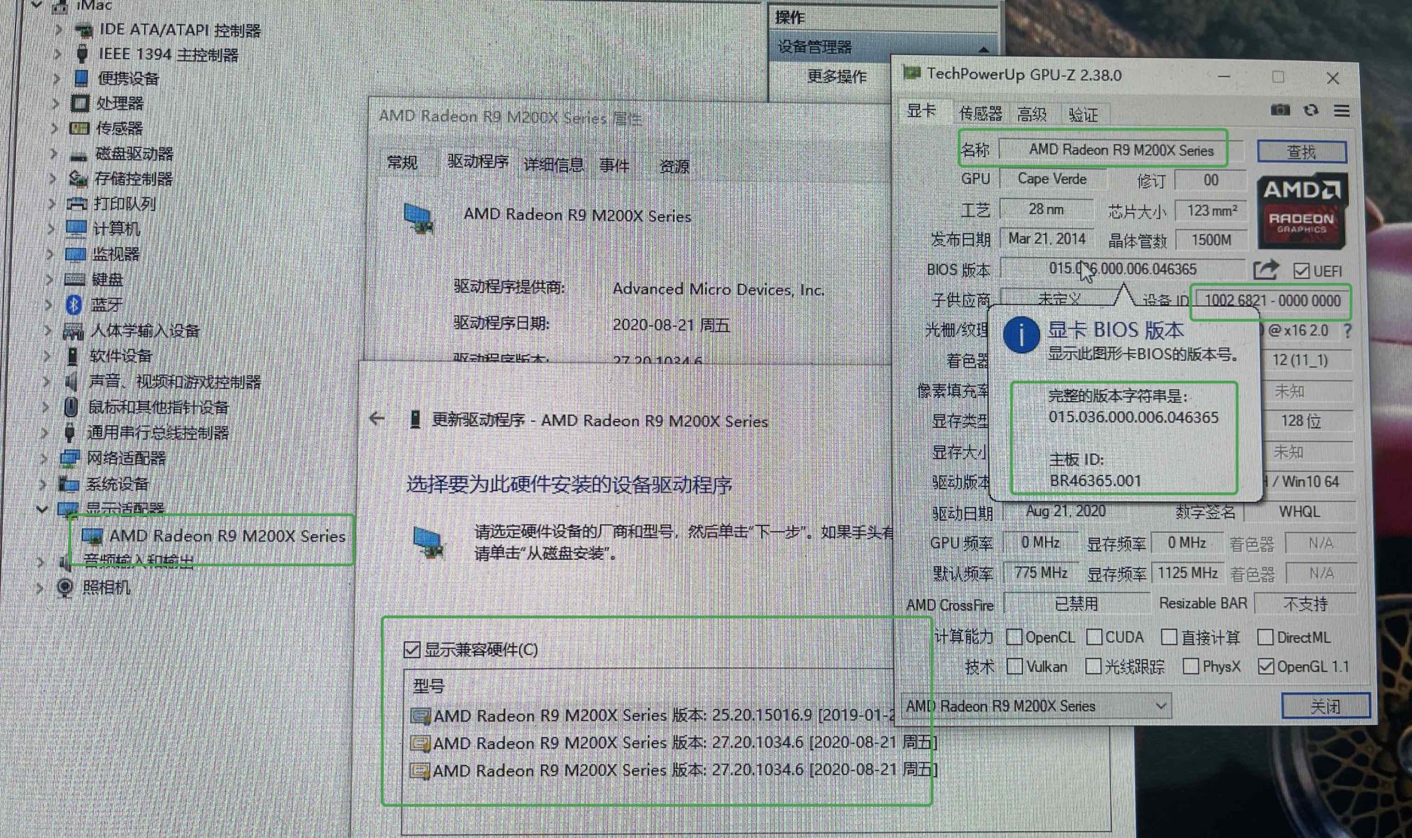

Test M5100 macOS window read vbios information is randomly different every time
Check the hardware ID inside the windows driver inf information and macOS inside match both (6281)
macOS display HD 7XXX corresponds to the windows R9 M2000X driver
macOS shows M5100 corresponds to windows is also matching M510 driver

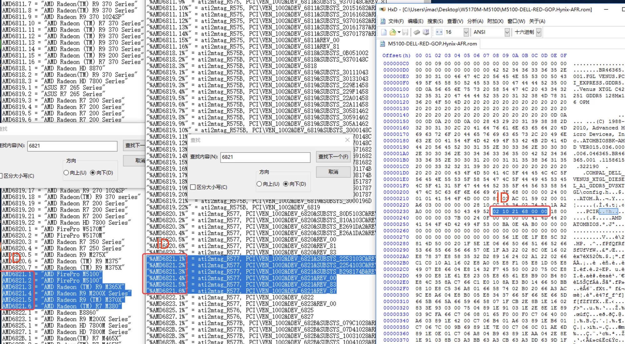

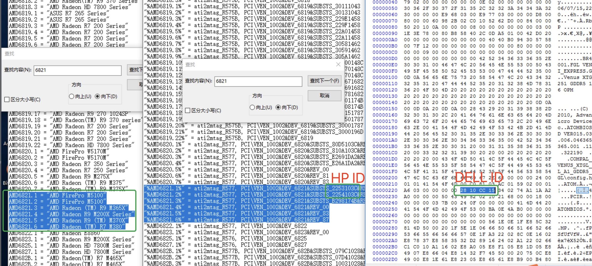

Check vbios information hardware ID: 21 68 00 00 can be corrected to lock fixed loading driver so macOS windows is fixed will not show the error.

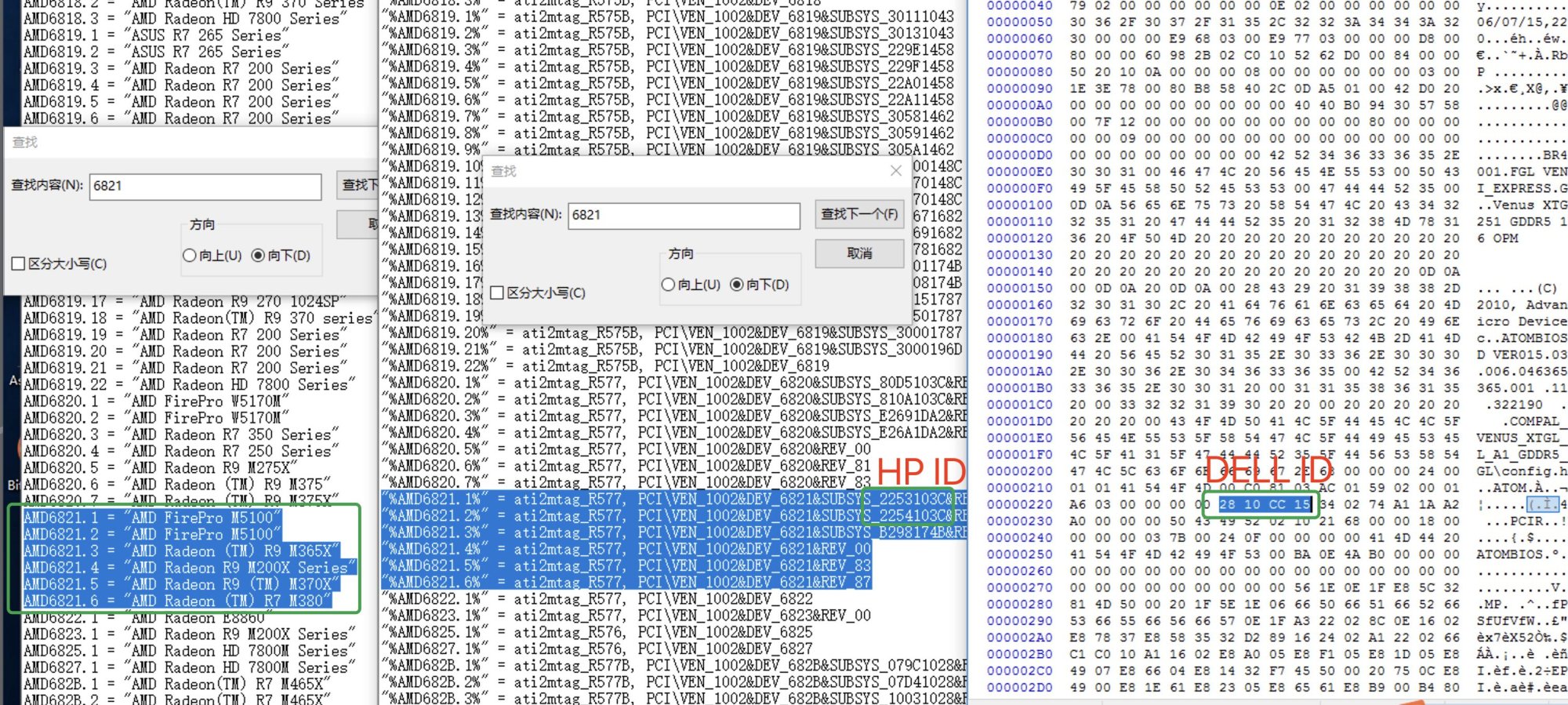

Check vbios information Dell driver ID 28 10 CC 15 and windows match the M5100 driver ID matches
Check the inf driver ID inside is 10 3C which is HP's ID, query vbios inside the information does not match, HP also has the original M5100 vbios
Check the inf driver list ID 6281 contains multiple models
AMD6821.1 = "AMD FirePro M5100"
AMD6821.2 = "AMD FirePro M5100"
AMD6821.3 = "AMD Radeon (TM) R9 M365X"
AMD6821.4 = "AMD Radeon R9 M200X Series"
AMD6821.5 = "AMD Radeon R9 (TM) M370X"
AMD6821.6 = "AMD Radeon (TM) R7 M380"
Match the loaded driver here
ID "%AMD6821.1%" = ati2mtag_R577, PCI\VEN_1002&DEV_6821&SUBSYS_2253103C&REV_00
"%AMD6821.2%" = ati2mtag_R577, PCI\VEN_1002&DEV_6821&SUBSYS_2254103C&REV_00
"%AMD6821.3%" = ati2mtag_R577, PCI\VEN_1002&DEV_6821&SUBSYS_B298174B&REV_87
"%AMD6821.4%" = ati2mtag_R577, PCI\VEN_1002&DEV_6821&REV_00
"%AMD6821.5%" = ati2mtag_R577, PCI\VEN_1002&DEV_6821&REV_83
"%AMD6821.6%" = ati2mtag_R577, PCI\VEN_1002&DEV_6821&REV_87
M5100 W5170M W7170M AMD GCN v1-3 GPU

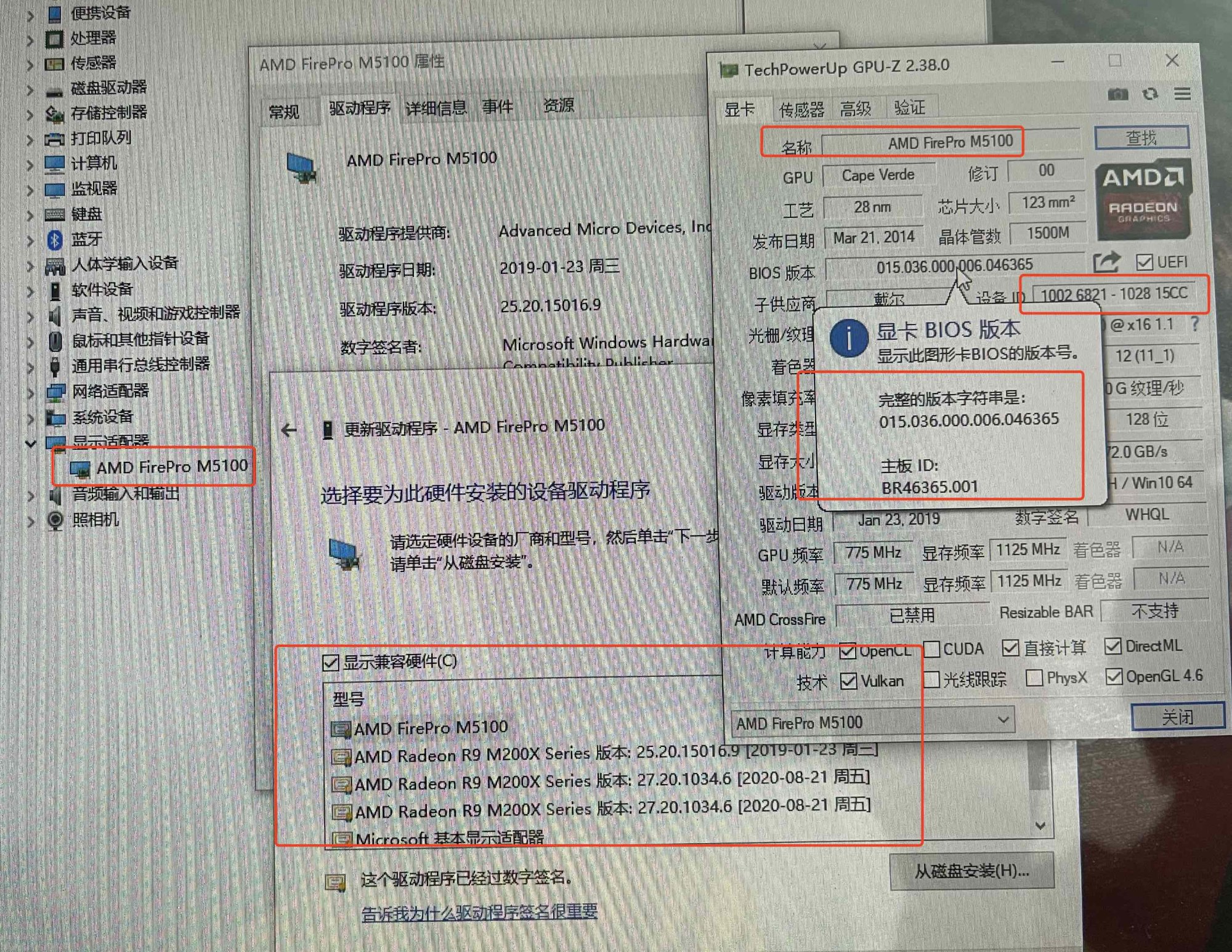

Is it possible to correct the model display error caused by macOS windows driver matching error by fixing the blank ID: 00 00 inside vbios?
windows system by gpu-z check vbios version information are the same just load the driver is not the same.

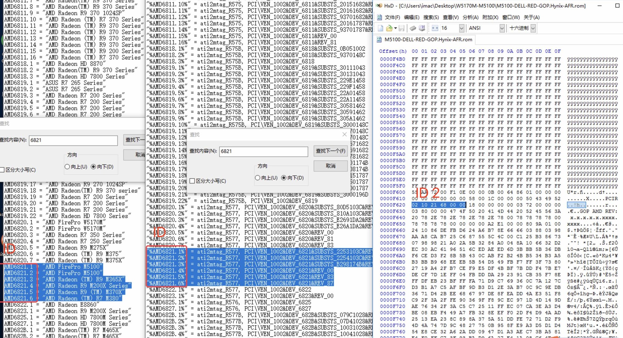

Fix the blank ID 00 00 information inside the vbios to lock the fixed id information with the matching driver instead of loading the driver randomly each time resulting in display errors
Translated with www.DeepL.com/Translator (free version)
The place in the VBIOS you found does not represent the PCI subvendor and subsystem ID but it is just reserved space. Those sub IDs are set by the EFI driver itself upon booting - and I've also seen that changing from boot to boot, without knowing how to fix it. All in all I don't care about Windows...

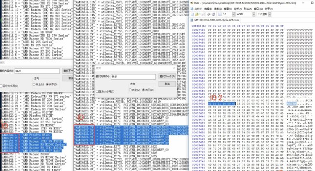

Can you fix the id in the efi driver to lock the fixed loaded driver?
This will not only solve the driver loading problem in windows, but also solve the problem of macOS not displaying the correct model number?
You can try to add the reserved space ID 0000 to lock it.
I can help test macOS windows

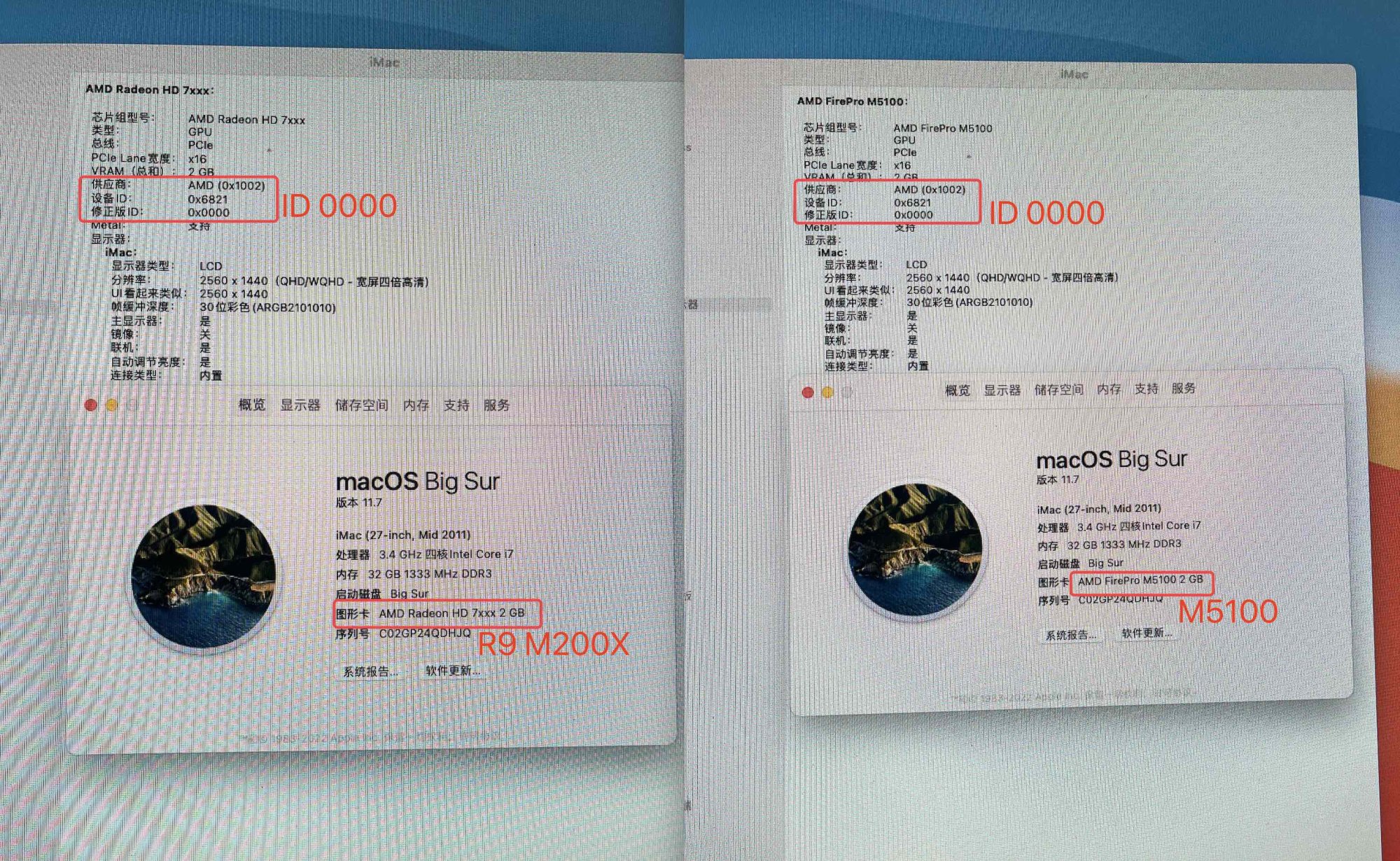

The model name in macOS is purely cosmetic, OpenCore contains an updated name list database which will be used when the rebuild-device-tree property has been set in the config.plist (which should happen by default):
Code:
                                <key>rebuild-device-tree</key>
                                <integer>1</integer>
Since most cards cannot be used without OpenCore properly just keep track of this particular entry. OCLP during it’s development tends to forget about this (cosmetic setting) and I do not interfere each time to get it back.
There is absolutely no technical reason to touch the vBIOS or the OC(LP) config or the EFI driver to have the same name showed up each time, it is a cosmetic issue within macOS.
M5100 and W5170M are different cards with different device-ID which may show up with different names when running macOS. And both cards may also load different Windows drives.
Reactions: Nguyen Duc Hieu
Code:
m5100 id is 6821 w5170m id is 6820
window system two models with similar drivers. Check the entry inside the inf to know. Dell HP id is just different.
I mean to fix the blank missing id inside the vbios to correct, so that each boot can automatically identify the fixed id. Not automatically assigned.
I don't know of any possibility to achieve that.
In order to get the same ID on each boot you may have to always power off the machine before (cold) booting into Windows.
Maybe even an NVRAM reset is necessary on each boot...
Reactions: 0607557
Does the NVRAM issue cause a different id assigned to the efi driver to load each boot?
On my model m5100 w5170m no NVRAM problem encountered
Cold boot, reboot, no need to reset the NVRAM problem macOS windows system sleep are normal is each load different assigned id lead to each match different driver I just thought of fixing the solution. I'll try it myself to see if I can fix it.
