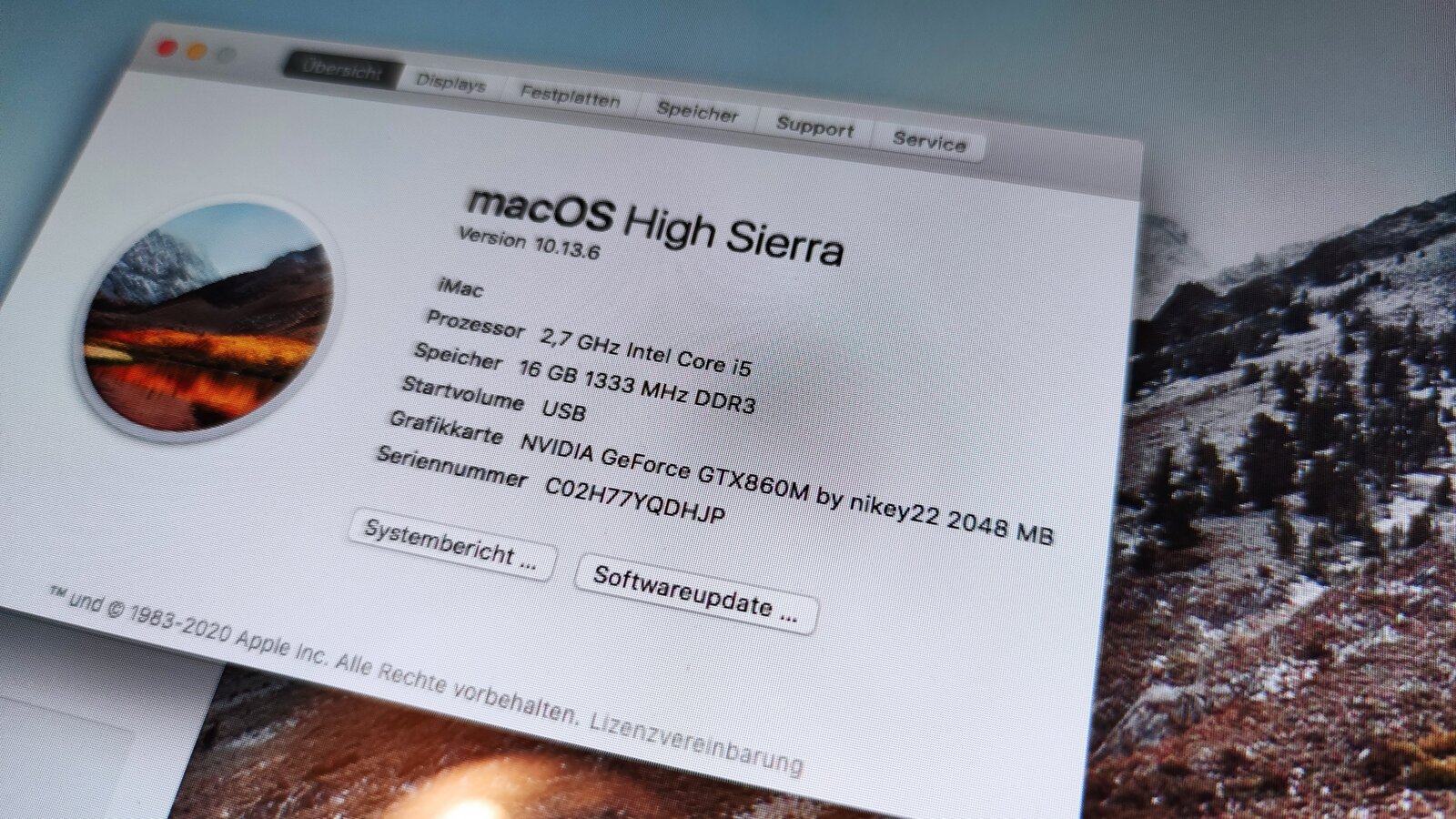

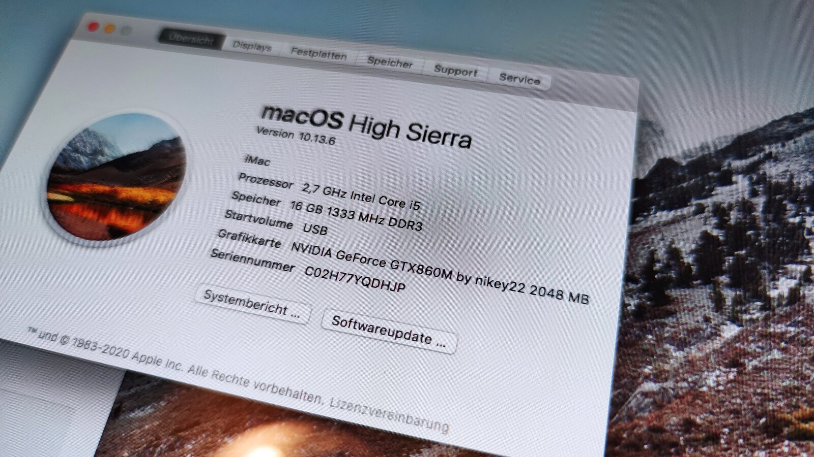

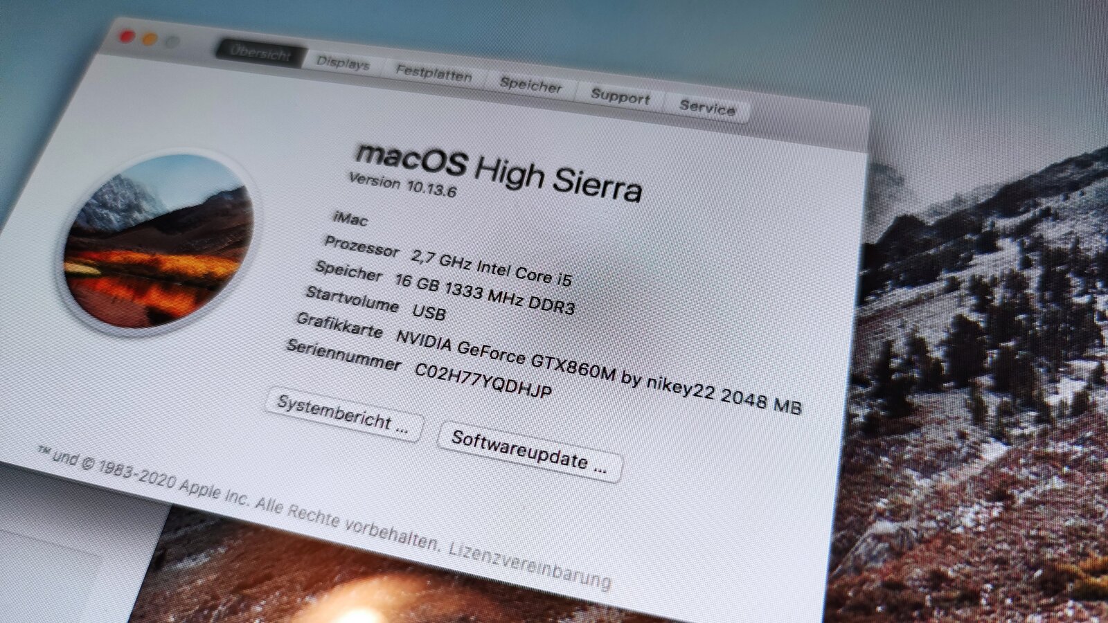

Nvidia GTX 860M installation on 27" iMac 2011
Part 2/2

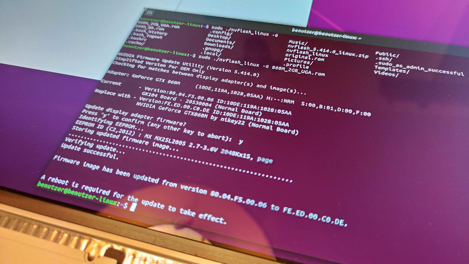

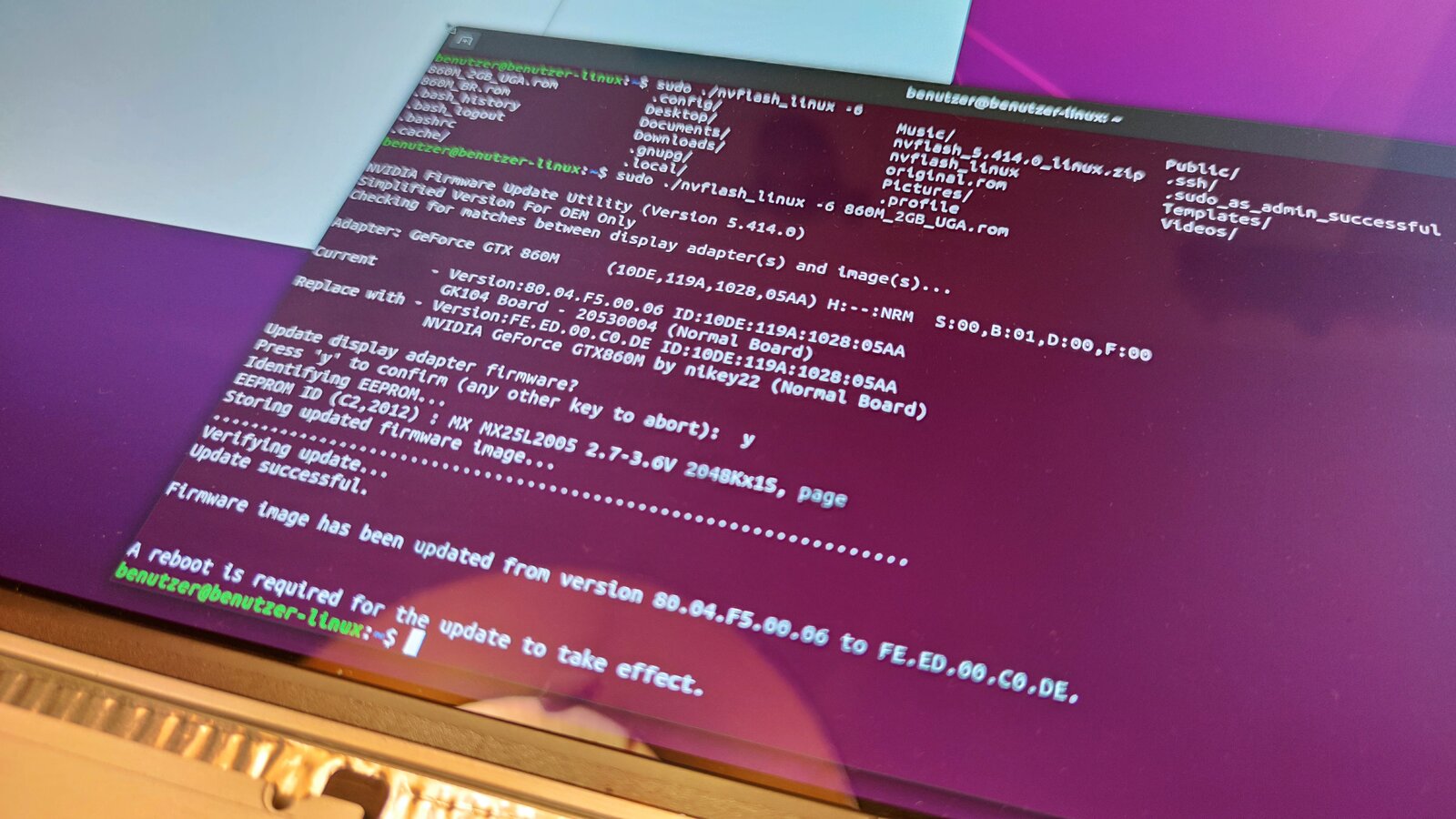

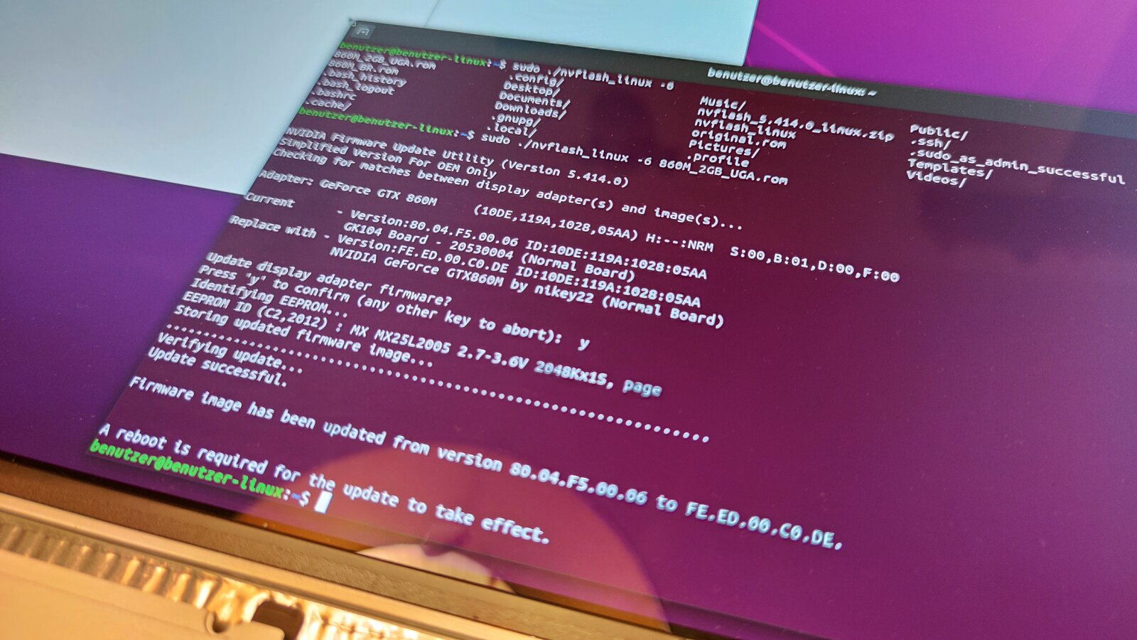

11. Flashing BIOS in Linux on this iMac without SSH.
- Opened Terminal in Ubuntu and swithed to home directory to my flash files.
- Made nvflash_linux executable: sudo chmod +x nvflash_linux, or it will not run.
- Saved original ROM from GTX 860M: sudo nvflash_linux --save Original.rom
- Flashed 860M BIOS: sudo nvflash_linux -6 860M_2GB_UGA.rom
- (Only in case the display would have gone black or something wrong i would SSH to the Ubuntu-System with my second machine and run the commands from there to repair the failed flash).
- Pressed y and let the process finish. Poweroff the iMac.

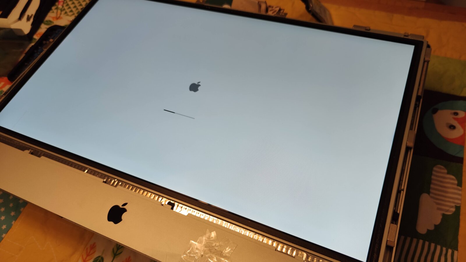

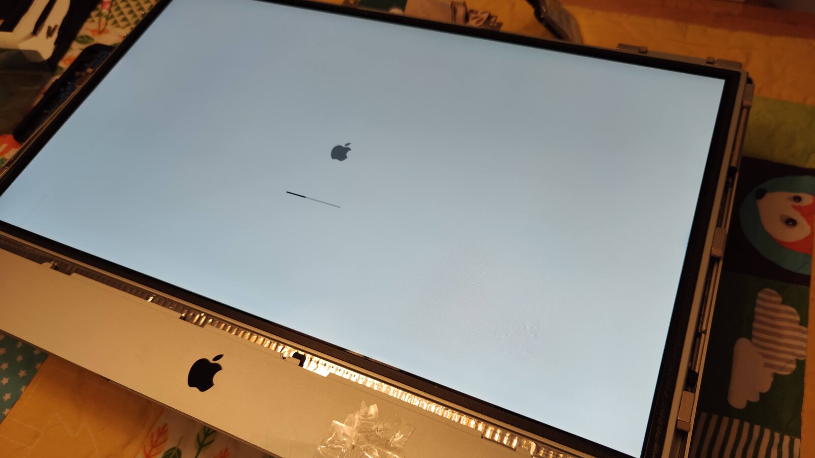

Switched back MacOS SSD and removed Ubuntu SSD. Completely reassebled my iMac. and

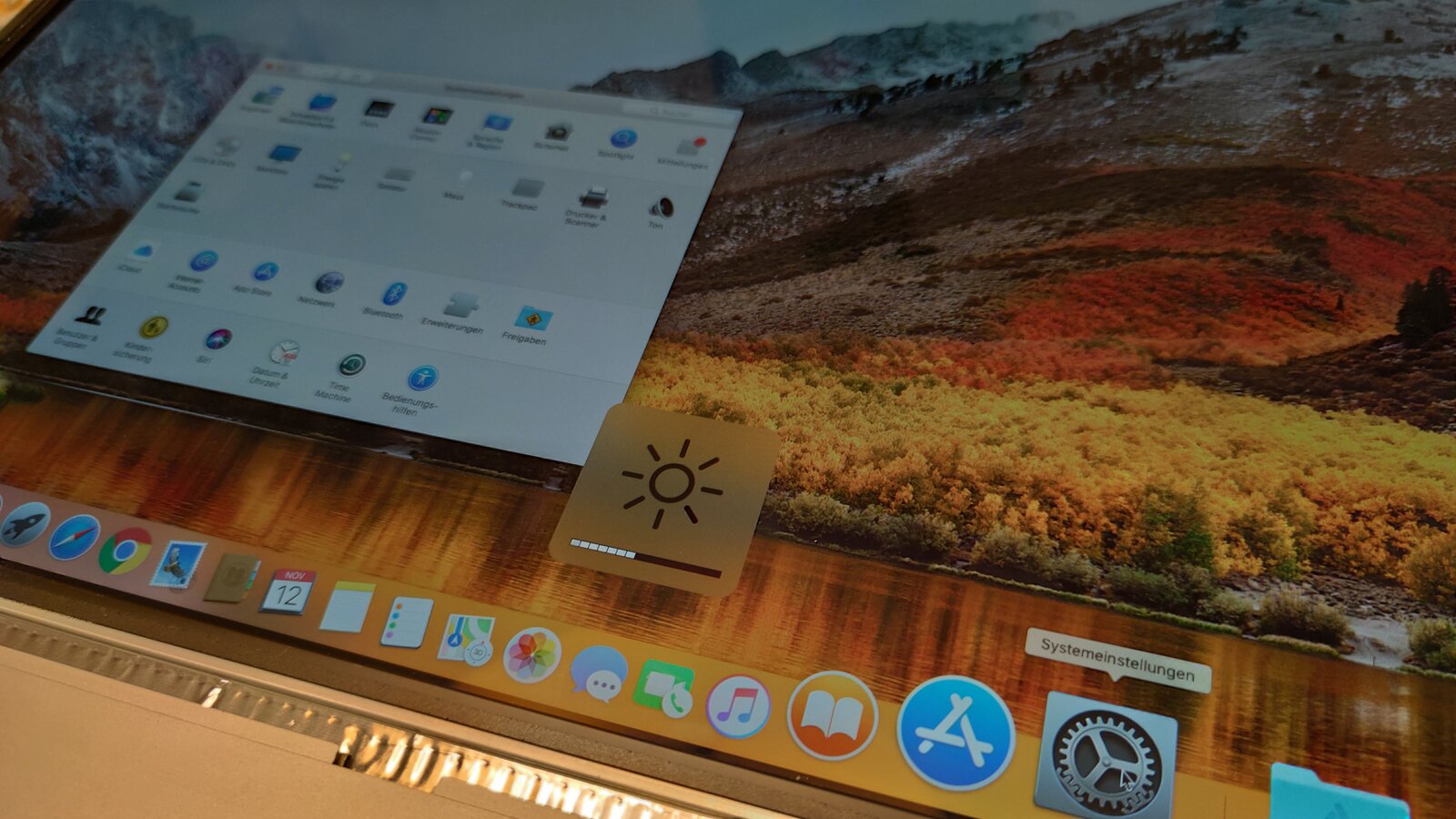

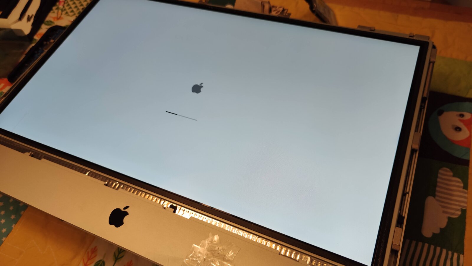

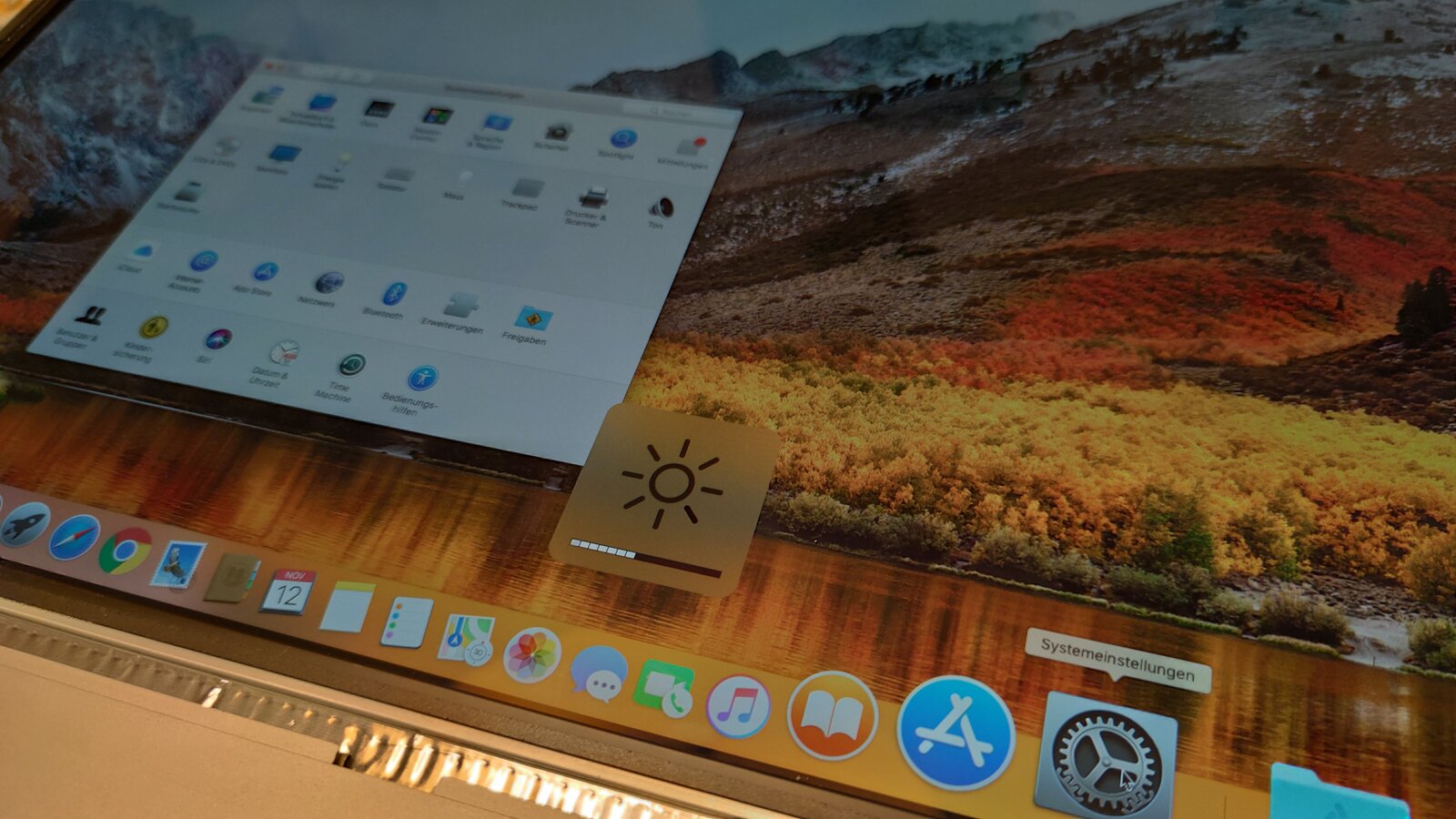

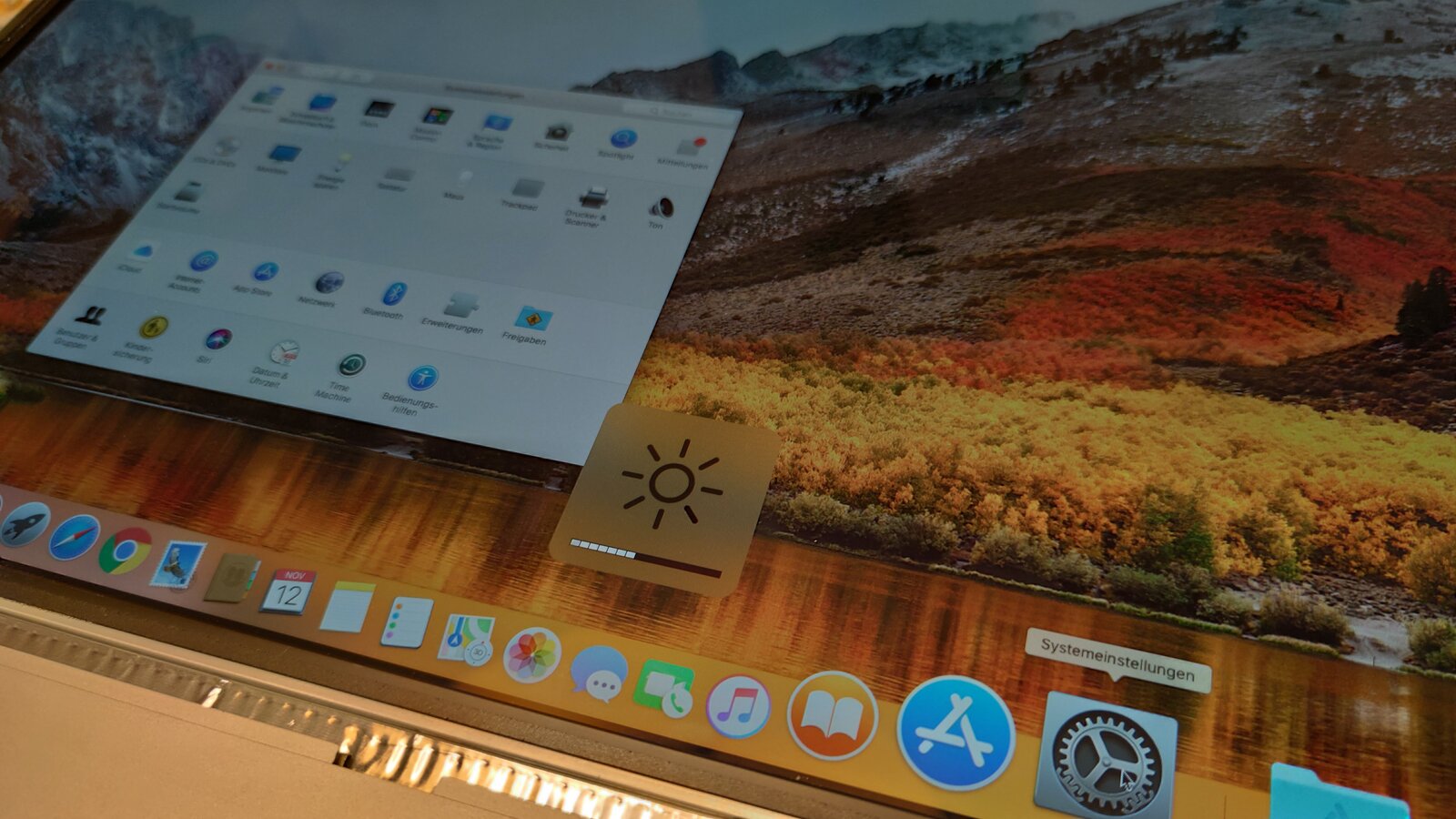

12. First boot with Apple bootscreen / brightness control:
DO A PRAM RESET ON FIRST BOOT (with Key-Combo)
Brightness control works, but maximum brightness is ~75% of original brighness. This can be fixed in next step easily.

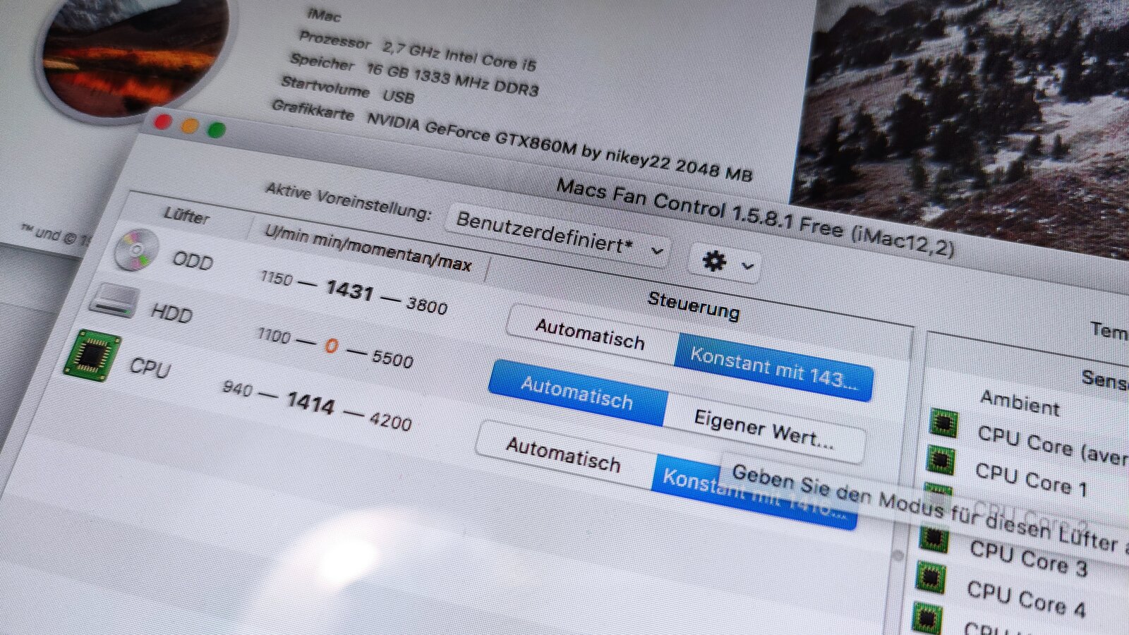

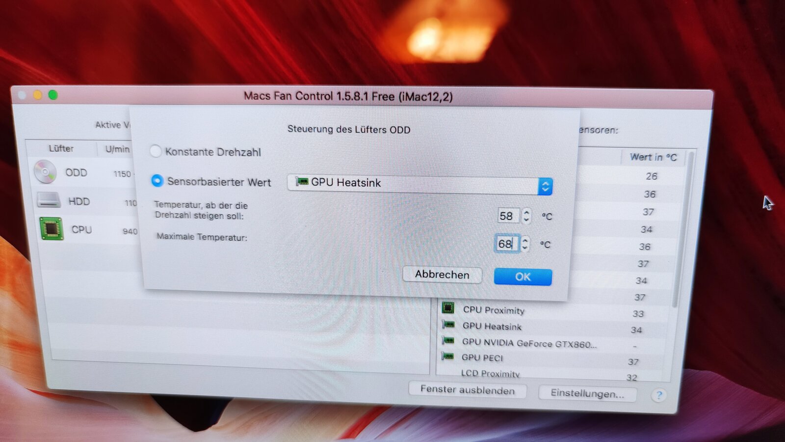

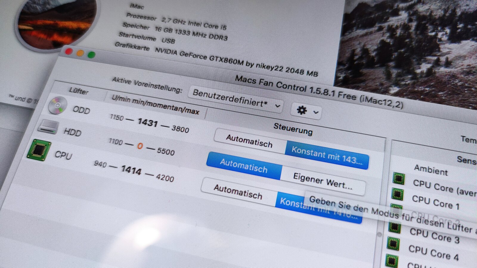

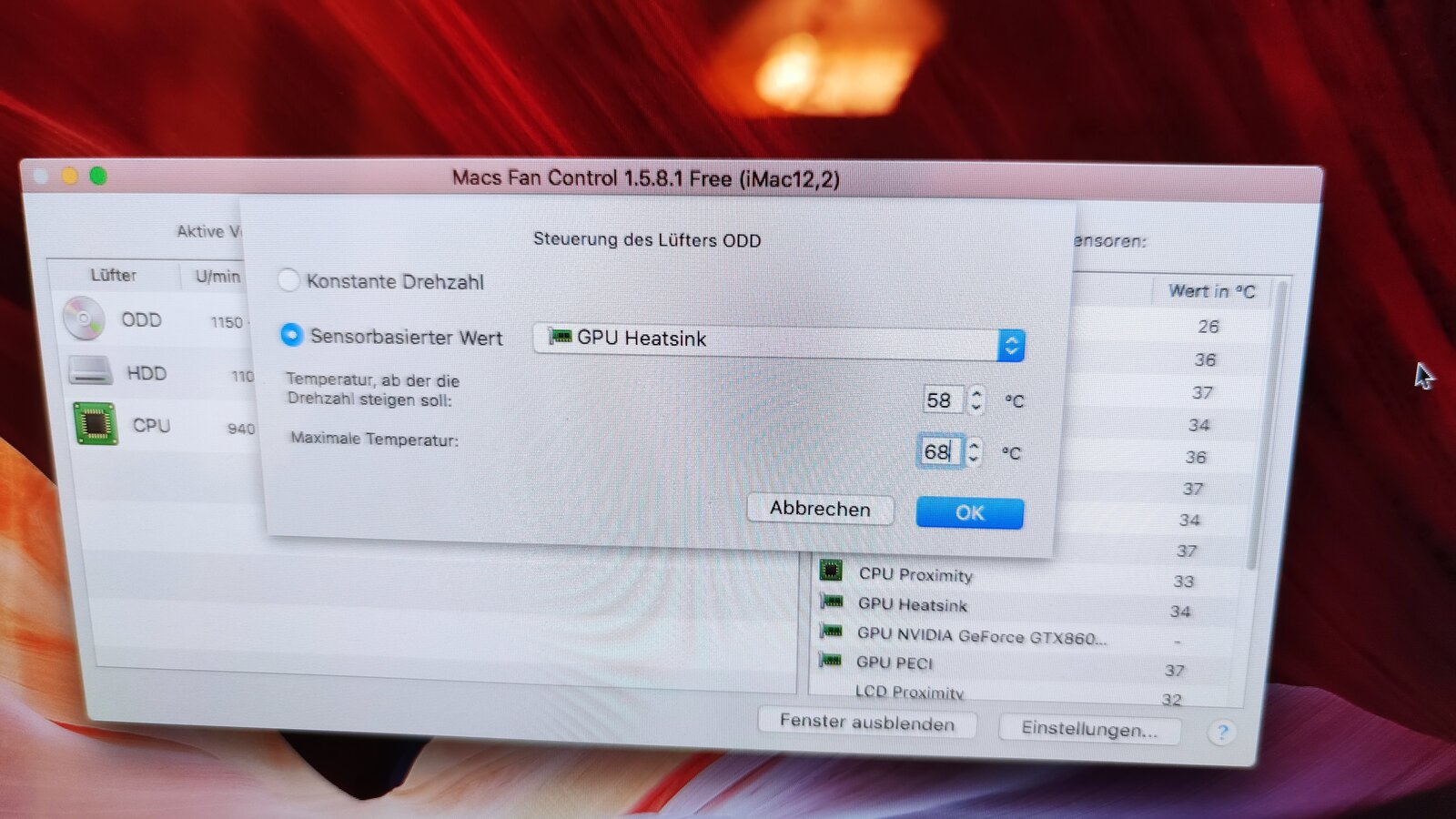

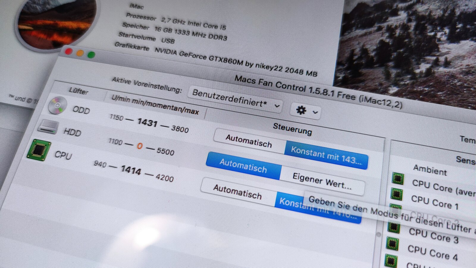

Fans are quiet again with nikey22 BIOS, but i wanted control of fan speed.
Installed Macs Fan Control (optional). It shows all temperature sensors and lets me enable fan speed at certain temperatur levels.
My center HDD fan is not attached to the mainboard with the fan cable, because i use SSD and no HDD. So there is less noise and the SSD needs no extra cooling. HDD fan rpm value = 0 when disconnecting the HDD fan.

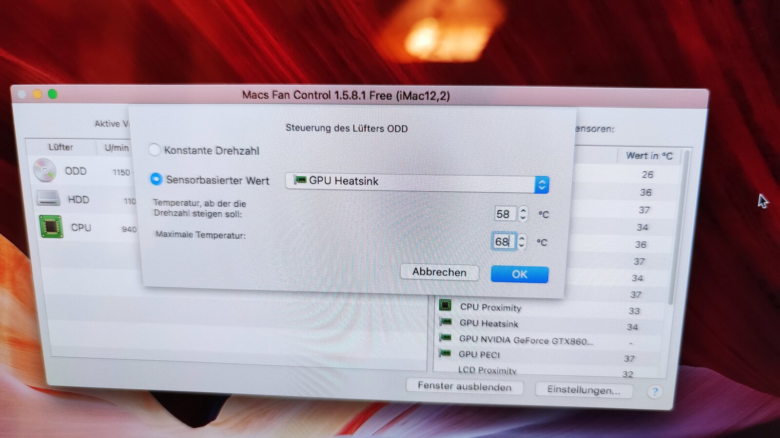

I set the ODD fan (=GPU-side fan) to "GPU Heatsink" and 58/68°C. Will set it higher after test period, maybe to 68/80°C, so it will be at minimum fan rpm until 68°C and start max rpm at 80°C.
I set the CPU fan (=CPU-side fan) to "CPU Heatsink" and 70/90°C.
13. To get 100% display brighness:
Follow nikey22 guide (where the ROM download is linked). Done in 10 minutes.
You need to disable System Integrity Protection first!
Can be enabled again after brightness mod applied.
Thanks nikey22 and all who have made this possible.
DONE

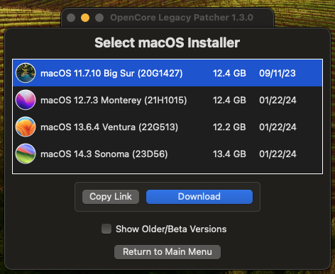

I have a problem: I upgraded a 12,2 iMac with WX7100 card, 1 TB SSd and 12GB RAM and Monterey. Everything works fine. I updated to Sonoma 14.2. Still everything works fine. Recently I tried to update to 14.3 but failed. It loads the OS but during the preparation for the update a message pops up "failure occured, try again later".
Can you clarify exactly where failed? OCLP macOS installation reboots the Mac multiple times. Which one of these "loads the OS" are you referring to? I think one of the last reboot runs shows a % progress counting towards 100. After that reboot, I believe it boots towards setting up Mac (if virgin install) or existing accounts (if update macOS only)
I encountered an install error and stop towards the end of installation phase like this 2x ( bottom of this post including the solution ) Happened with stock GPU also so OCLP related. Once installing 14.2.1 + stock GPU, 2nd time installing 14.3 + metal GPU.

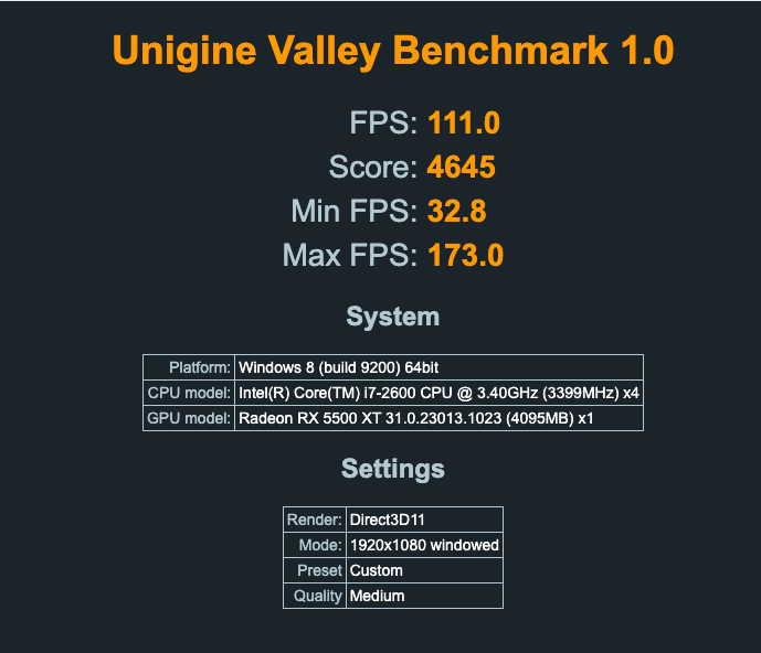

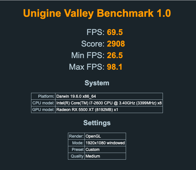

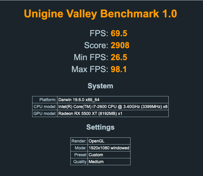

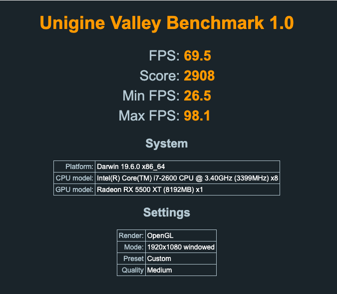

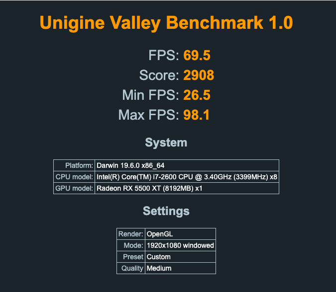

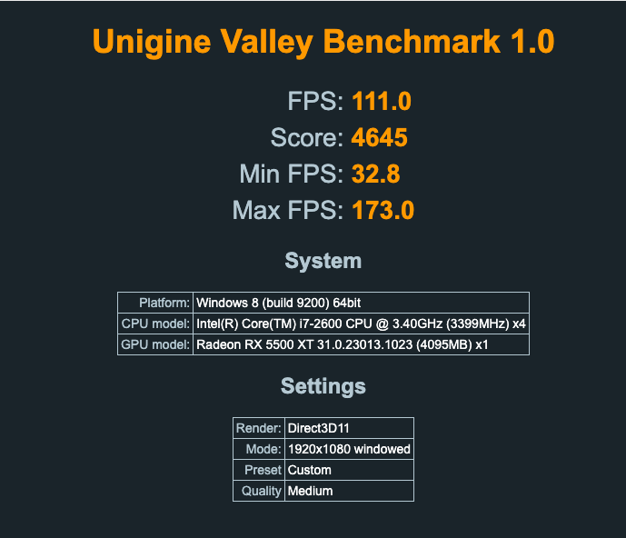

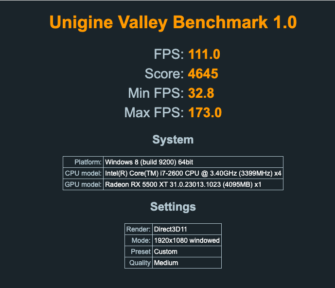

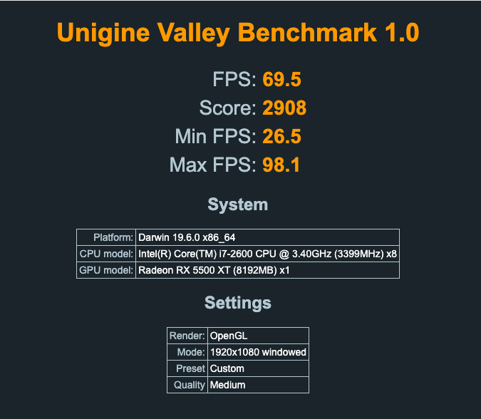

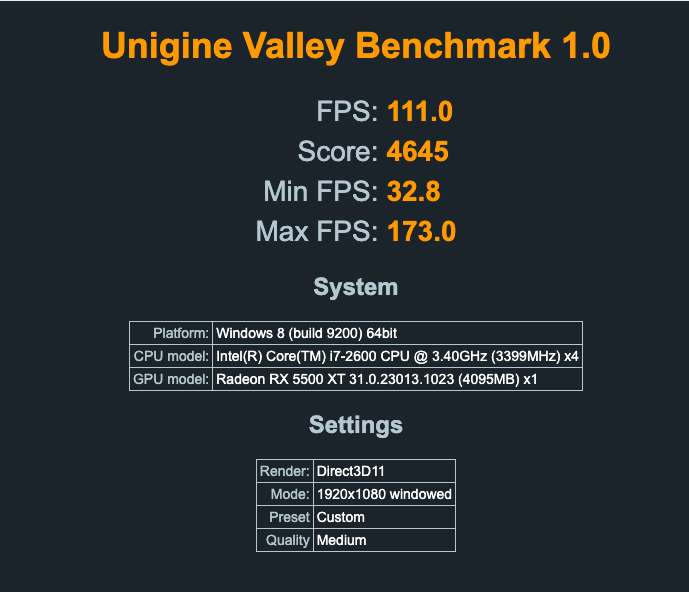

Hi. Bought an AMD WX3200 GPU from an Aliexpress vendor. The process was really easy
and along with an i7 2600s CPU and an SSD drive it runs excellently with a score of around
40 fps on Unigine. I'm running Big Sur and it's really stable. Eventually, would like to upgrade the OS
to Ventura. I've included the instructions in a pdf. The reason I got this model GPU was because the 4150
was out of stock.

The installation image is taken from where? With OCLP or the installation original?
Show errors when installing OCLP
I downloaded the 14.3 image from some other website, maybe that was the problem. But I don't understand why the regular update process which worked on all my other iMacs doesn't work on this one?
But I will try again with OCLP USB stick (with download from OCLP).

At idle, 40-42 degrees. At full load, for example, I run graphical tests, it shows a maximum of 69 degrees. The temperature did not rise above
I'm sorry, I lied.
I checked again. On the GPU, the minimum is 46 degrees and the maximum is 78 degrees through the Furmark test
