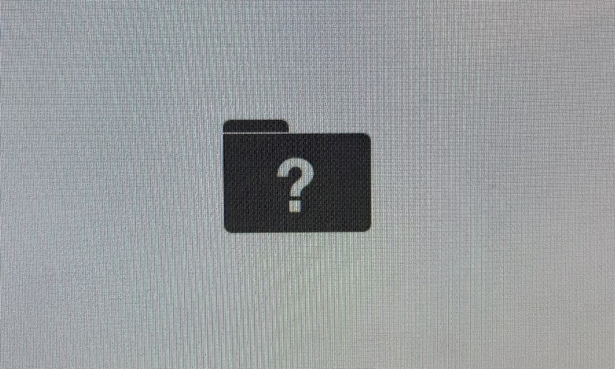

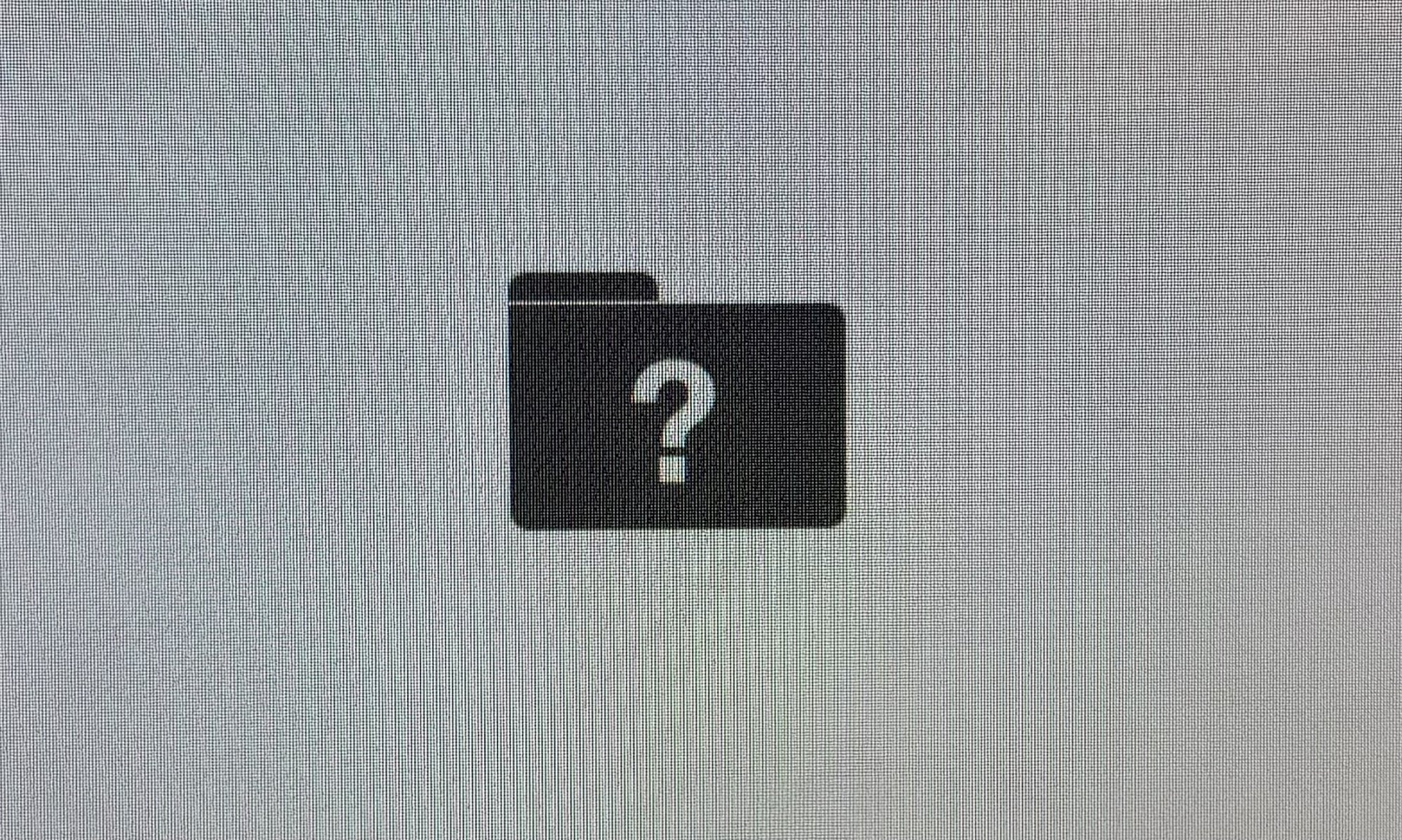

No boot into Sonoma possible. Got greeted with the folder with a question mark. Will try safe boot later.

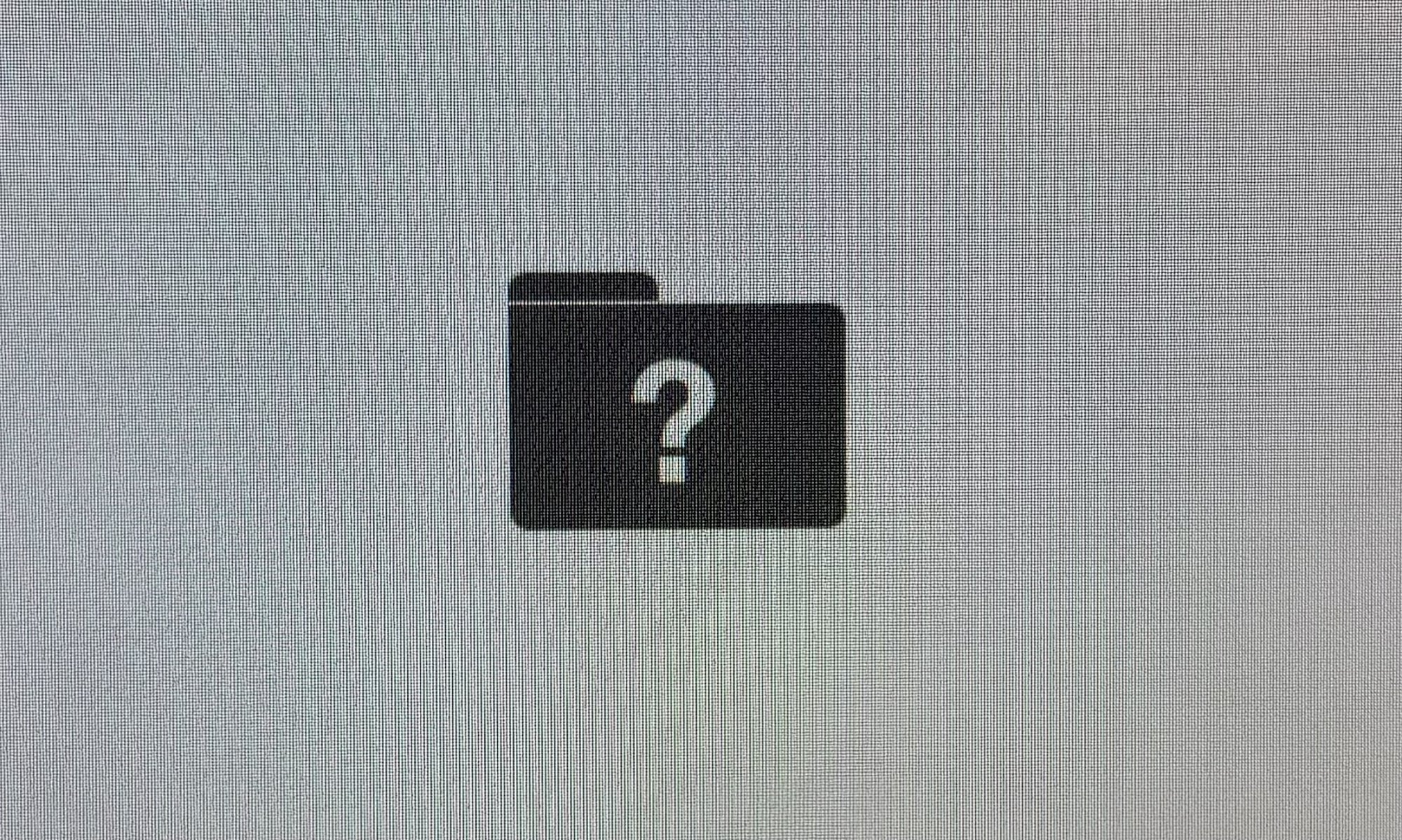

Assuming you checked AMD GOP Injection + Polaris? Anyway, unlikely your problem. Just double checking.
Sonoma installer should boot the iMac to setup screen (assuming you wiped the SSD and cleaned installed)

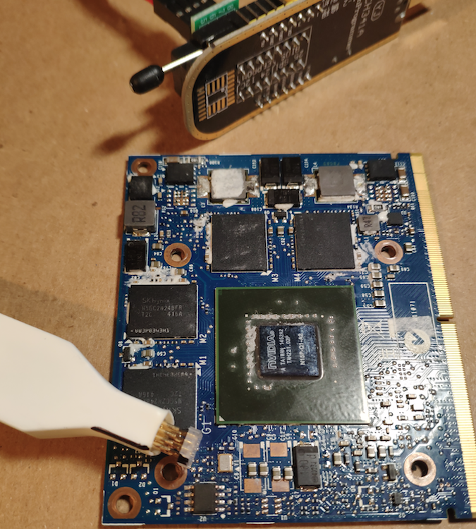

hi, i found a different clip to flash a card with ch341 programmer, this one has to be hold when flashing but works every time...the original one was hard to clip for me...

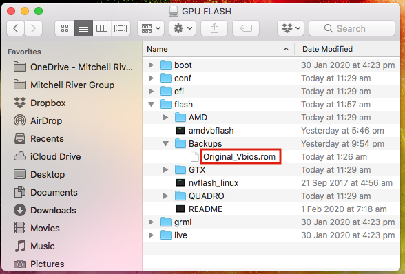

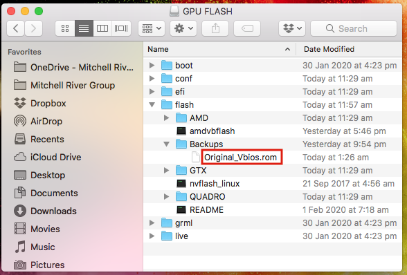

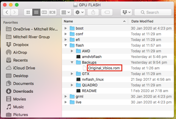

If anyone is interested I have updated and modified the awesome grml-linux vbios flash boot disk that @xanderon shared with the macrumors community.
The changes include adding amdvbflash, thanks to @Ausdauersportler add-on, all the current ROMS from post 1 and a local Backup directory to store your backed up original ROMS directly on the Bootable USB using the persistency function in grml as default.
By doing this the directory structure has changed so please see the detailed guide below on instructions for using this modified bootable USB.
Create your USB using my modified @xanderon boot disk and connect to your target machine via SSH as outlined in @xanderson post HERE.
At root type:
Code:
lsblk
This will list list your mounted disks and is important as this disk order may change, sda/sdb/sdc, depending on what disks you have connected, how fast they are loaded by GRML etc, therefore the path to your working directory may change. You will see a example of this if you look at my terminal.txt file, I flashed 1 AMD and 1 NVIDIA GPU on seperate Macs.
In terminal copy the path to the root of your Flash USB, Example:
Code:
/lib/live/mount/persistence/sdd2
cd paste and add /flash to get to the directory:
Code:
cd /lib/live/mount/persistence/sdd2/flash
Press enter, you will now be in your working directory.
Code:
root@grml ~ # /lib/live/mount/persistence/sdd2/flash
In this example I will be using amdvbflash to backup and flash my stock AMD apple vbios.
1st - lets look at the working directory:
Code:
ls
2nd - Verify your adapter is recognised:
Code:
./amdvbflash -i
3rd - save a backup of your original bios to the Backup folder on your USB.
Code:
./amdvbflash -s 0 Backups/Original_Vbios.rom
4th - Verify the bios is saved to your Backups folder:
Code:
cd Backups
ls
Now if your paranoid that when you shut down your bios will be gone you can stop, shutdown and actually check the USB drive Backups folder.
5th - flash new bios for example:
Code:
./amdvbflash -f -p 0 AMD/WX4150_GOP.ROM
WARNING: There is no pause asking you if you wish to continue as in nvflash so make sure you have your backup and are flashing the correct ROM.
You will be greeted with some code similar to this verifying the process is complete:
Code:
AMDVBFLASH version 4.71, Copyright (c) 2020 Advanced Micro Devices, Inc.
Old SSID: 0B00
New SSID: 0B00
Old P/N: 113-C29609-103
New P/N: 113-C29609-103
Old DeviceID: 6720
New DeviceID: 6720
Old Product Name: Apple K62 Blackcomb XT C29609/C29611 GDDR5 64Mx32 2GB
New Product Name: Apple K62 Blackcomb XT C29609/C29611 GDDR5 64Mx32 2GB
Old BIOS Version: 013.011.000.020.017256
New BIOS Version: 013.011.000.020.017256
Flash type: M25P10/c
Burst size is 256
20000/20000h bytes programmed
20000/20000h bytes verified
Restart System To Complete VBIOS Update.
Shutdown and hope for the best 🙂
Code:
shutdown now
For NVIDIA cards the process is the same but the nvflash_linux commands will be different see my attached Terminal example.txt if you need more info. Also attached a quick visual guide and both Nvidia/AMD flash tools help text.
Enjoy.

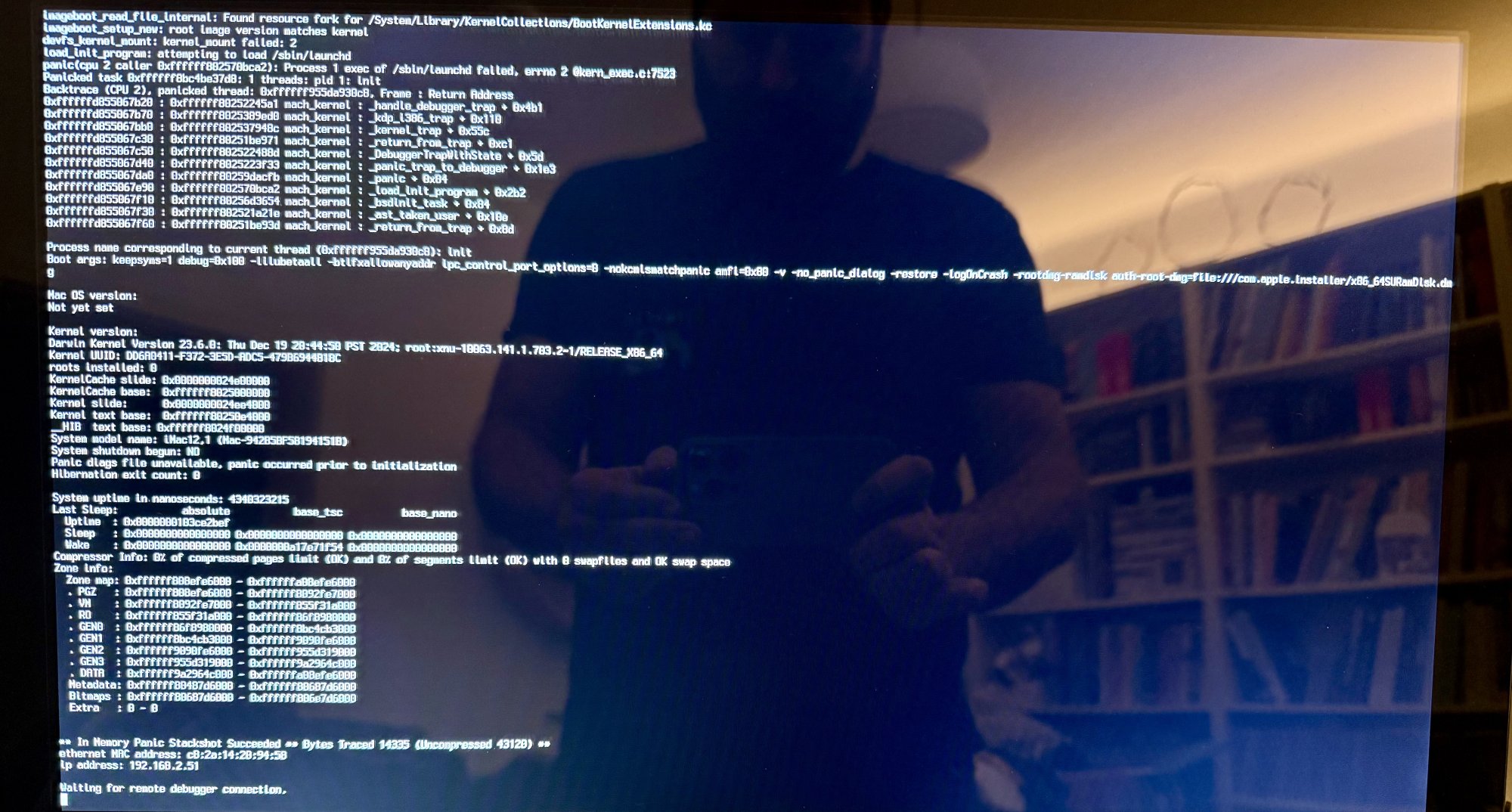

No luck so far. Check pic. Asked ChatGPT for feedback:
The error on your iMac 12,1 when trying to install macOS Sonoma with OpenCore Legacy Patcher (OCLP) seems to indicate a kernel panic or a failed boot process. Here are some possible causes and solutions:
How far into the install does it kernel panic? Overall installation takes like 20min+ with multiple reboot phases. Latest OCLP 2.2.0 will root patch all the driver stack before macOS setup (probably just before reboot to macOS setup? Just a guess) Maybe this is where you got k panic?
Maybe double check stock HS install still boots wx4150 with external monitor.
License agreement done, install after this done, one reboot, more installing on a grey screen with an apple logo done, switches to verbose output, then kernel panic. Guess "before macOS setup" is right. I'm on 2.2.0 definitely as this was released on Dec 11th 2024 and I started after. Worth a shot to revert to an older version?

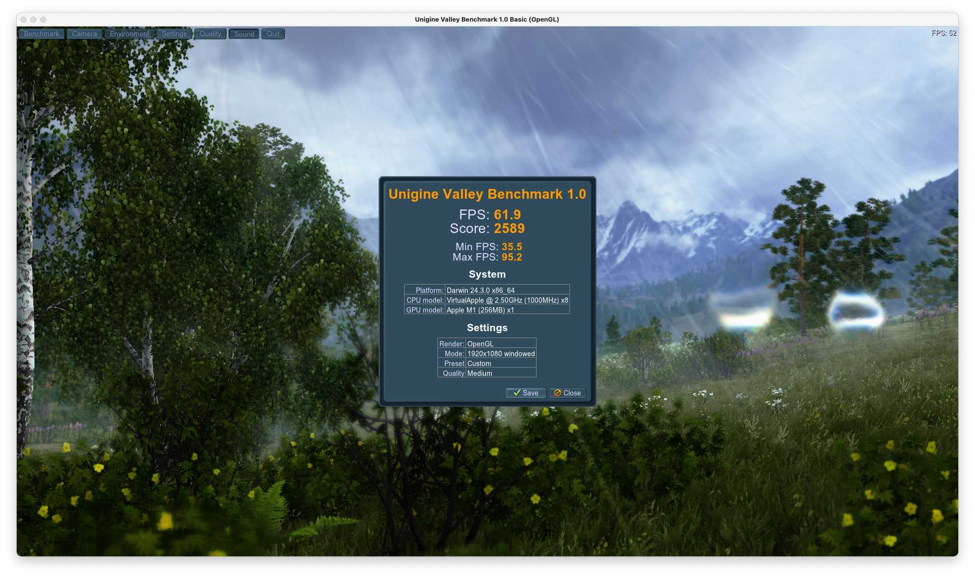

:apple: 1st Valley Benchmark - Mac Mini M1 (16GB) :apple:
I don't think it's about showing off or posing ! When choosing the graphics card for an iMac from
2009 - 2011 + Update to MacOS Sonoma or Sequoia via OCLP, it might be a good idea to calculate
the performance increase as well as the required performance for demanding and / or AI-based
(App-Store) programs and whether it makes sense based on today's standards !
I have a number of older programmes (32-bit High Sierra, Parallels Desktop WIN10, 64-bit
MacOS BigSur) that I can run under STEAM (High Sierra + WIN10 Emulation + Games).
The Mac Mini M1 + OS Sequoia have strict Gate Keeper Software, so it's not soo easy to run
things with Porting Kit / Wine or other Software which is not 100% compatible to Apple CPU...
I can't say how fast and energy-efficient the new CoPilot+ notebooks with ARM Snapdragon+
(Qualcomm) CPUs are, but in contrast, the Mac Mini M1 (16GB) is exceptionally fast (FTL), and
as many of you will have read or seen on YouTube, the New Generation offers an impressive
amount of performance for the money !
