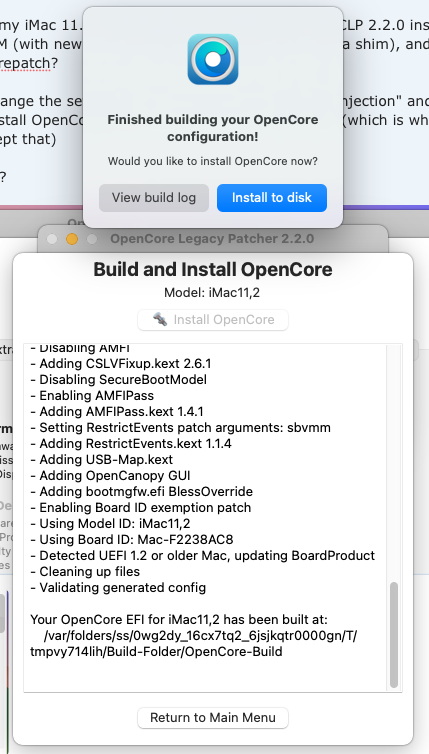

I noticed that if I set the MXM GPU to AMD GCN and attempt to build Opencore (which is what the GPU seller in China suggests) before installing the new GPU that the installer is unable to build Opencore (it starts and then delivers an “Unable” error message)
Thanks very much for all the advice so far and any new advice related to my question today:)

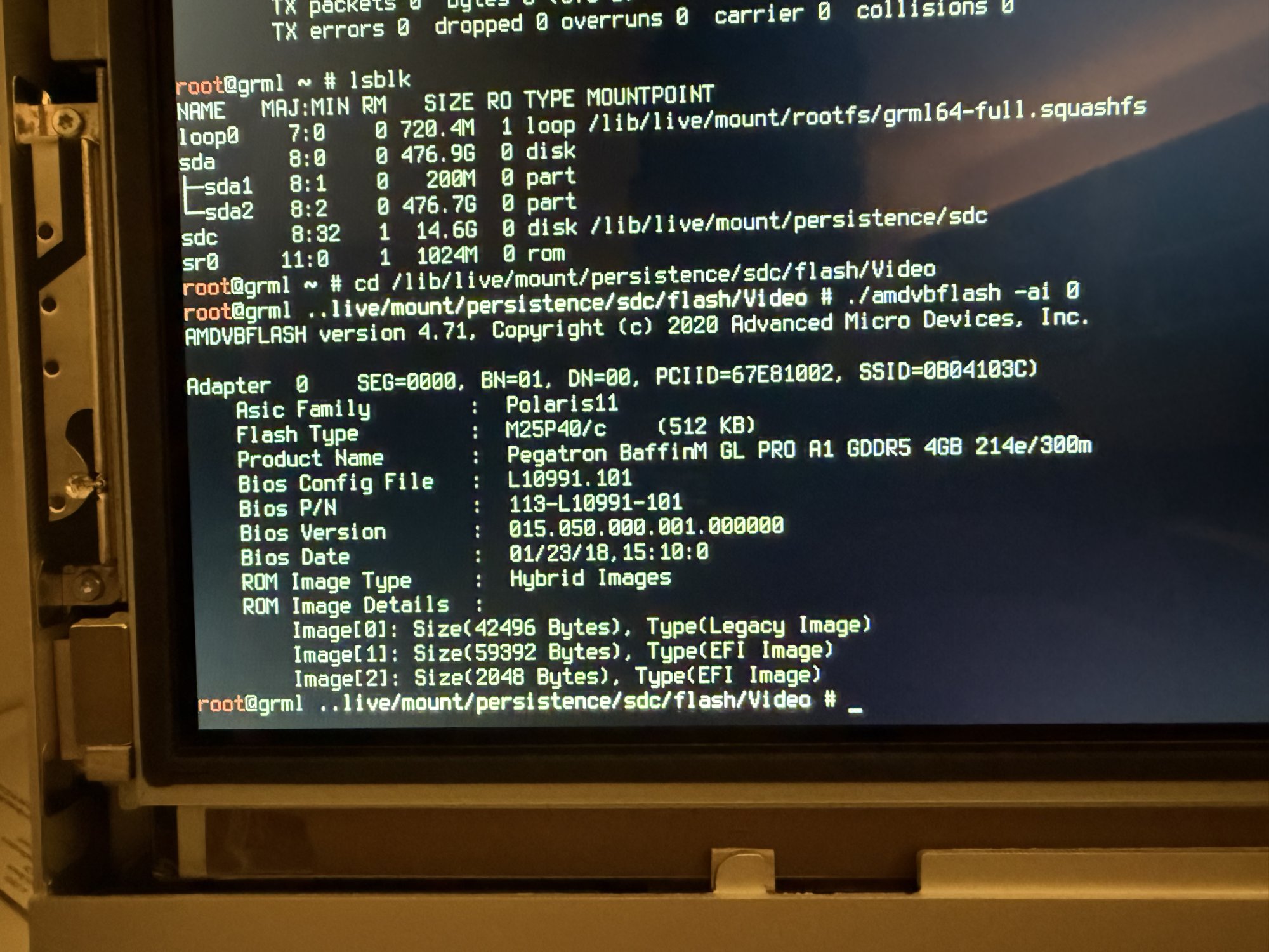

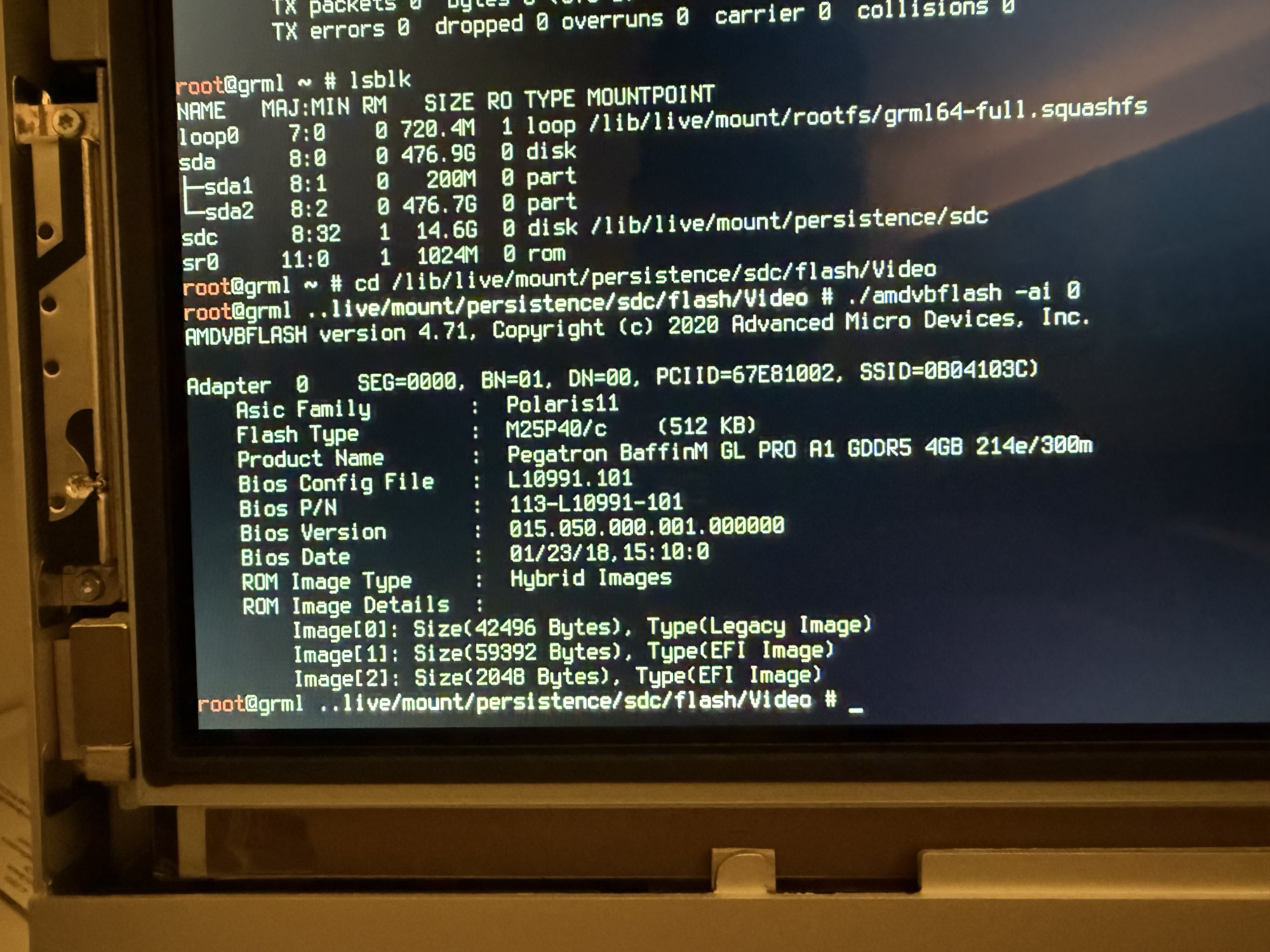

Hello again!
Did a whole lot of trying out to get my WX4130 to work again. New USB stick for both GRML and OCLP. Was able to get GRML to boot and SSH'd in. Confirmed card to be showing the correct vbios build after initially having "SSID mismatch" on the first flash. "SSID mismatch" went away after force flashing the vbios. Backlight comes on at boot and it displays the boot picker as well as GRML. Check pic.
I then tried several OCLP installs to get somewhere at least. Wiped the SSD each time:
- Ventura: Install seemed to run ok but black screen.
- Sonoma: Install seemed to run ok but black screen.
- Sequoia: Install didn't run until black screen.
For both Ventura and Sonoma I ended up with a black screen with backlight on after the expected several reboots from install just like last time. During install for both versions I could see progress bars and normal imaging. I could also see verbose output until black screen. I suppose this is when the install switches over to internal video drivers. Then something breaks.
Sequoia didn't install cleanly and I didn't pursue further as Sonoma was my target install due to stability.
For both installs with the black screen I could see a running system with an active IP in my router's dhcp table. Tried to SSH into it but was denied as expected as SSH access wasn't yet configured.
For both installs with the black screen nothing was shown on an external display. External display went to auto-off.
I'm out of ideas as I have tried every possible variation. Any comments are welcome.View attachment 2483373
Gday,
Sounds like a similar experience I had with one of my 4130's.... My Post
Long story short.. It was faulty
Not sure why, I run OCLP on my fastest macs not running OCLP to build installers. Make sure set model ID + GPU settings correctly per above.

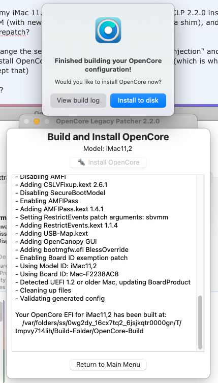

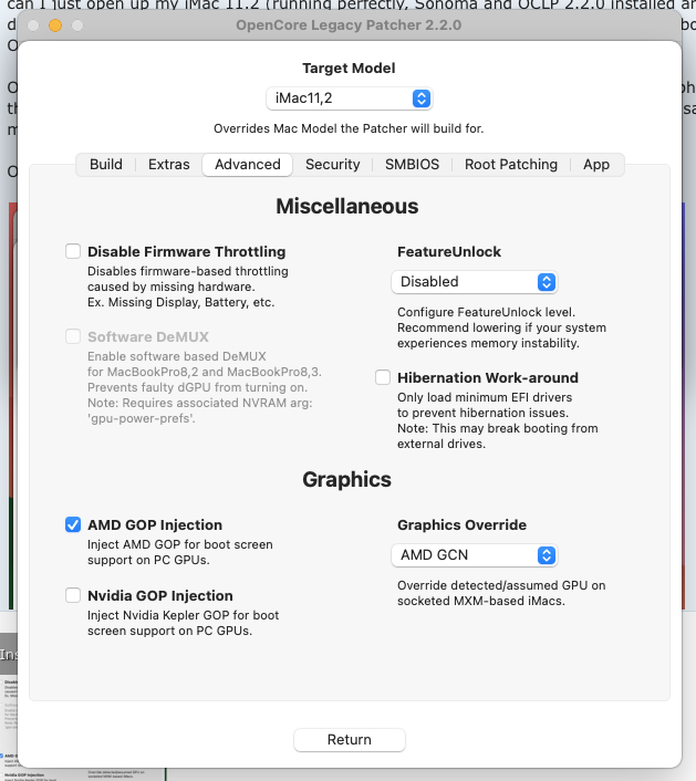

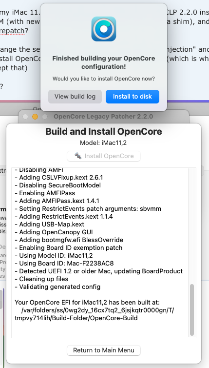

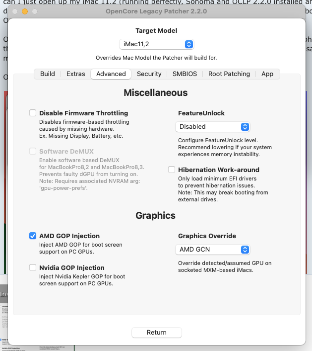

Thanks guys,
unfortunately I'm not sure that we're talking about the same thing, although it's probably just my lack of understanding.

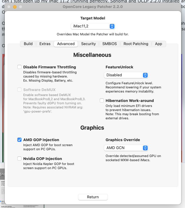

My specific question is:
can I just open up my iMac 11.2 (running perfectly, Sonoma and OCLP 2.2.0 installed and patched on internal SSD), drop in the W5170M (with new thermal paste and pads and maybe a shim), and then bootup the mac and check the OCLP settings and repatch?
Or: do I need to change the settings in OCLP to "enable AMD GOP injection" and "Graphics Override: AMD GCN" and then rebuild and install OpenCore AND THEN drop in the W5170M? (thanks howardc64 and internetzel: setting the model ID actually took away the error message that I previously had 👍)
Or: something else?
Thank you very much for whatever advice you might have 🙏,
Paul
Do this (If don't update EFI OC to W5170M before changing GPU, mac won't boot after shutdown) AND the following before shutdown and change GPU
  • revert root patch (remove drivers for the OEM GPU)
  • close all applications and turn off any auto launched apps during login (see below)
  • have to do ALL these 3 steps before shutdown to change GPU. If skip some steps, likely encounter problems
After W5170M install and boot up again, it will run slow with visual anomolies (no new GPU drivers installed) until root patch + reboot.
This is a more advanced installation method as I explained in prior reply. (OCLP macOS already installed on prior GPU followed by changing the GPU without wiping the drive) It is more difficult to explain and understand due to the multiple manual steps required.
For newbies, usually its far easier to make an USB installer and wiping the drive (wiping drive has its own complexities depending on what EFI is on the drive so best just remove drive, wipe entire drive using another mac, and reinstall) to avoid having to do more advanced method requiring 3 manual steps and potentially making mistakes.
Not sure why you need to set model ID if OCLP is running on iMac 11,2. It should just auto detect to this Model ID.
Or: something else?
Paul
Images:
These settings are correct.

@howardc64
I’m really sorry for asking a question that you’ve pretty much already answered in detail but punctuation and quotation marks are messing with my head
Prior to cracking the case the 3 steps are:
1) change the settings in OCLP to "enable AMD GOP injection" and "Graphics Override: AMD GCN" and then rebuild and install OpenCore
2) revert root patch (remove drivers for the OEM GPU)
3) close all applications and turn off any auto launched apps during login (see below)
Correct?
No guarantees of course, just trying to minimize errors 😃
Thanks again (and again),
Paul
Reactions: DAVID-200026

Correct.
After GPU change and boot up. Confirm AMD GOP Injection + AMD GCN still set (latest OCLP remembers last setting) and root patch then reboot.

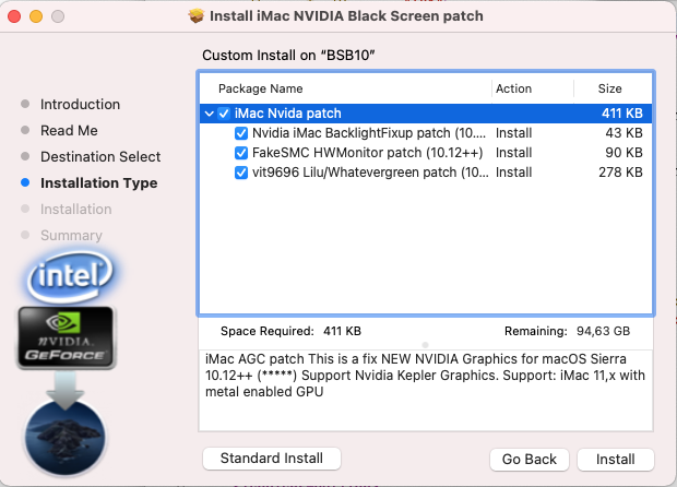

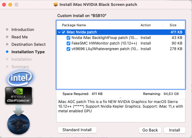

Sierra and High Sierra Package Installer
( iMac 2009-2011 AGC, FakeSCM, Lilu, WhateverGreen, AppleBacklightFixup installer)
(not compatible with OCLP or Catalina Loader/OpenCore, replaced in functionality by OCLP)
Attached you will find the a kernel extension package installer currently working on Sierra 10.12 and later. SIP needs to be disabled. Boot into recovery, start Terminal app, enter csrutil disable and reboot directly into your macOS and install the package.
It will patch the current installed AppleGraphicsControl (AGC) as described in this post addressing the black screen issue and install the AppleBacklightFixup needed for ++ type Nvidia cards side by side with the @vit9696 Lilu and Whatevergreen. As an option you can have the FakeSMC extensions get installed.
The NVIDIA ++ cards are this running with a BIOS from @nikey22 and marked in the table on post #1 as type ++.
After starting the Apple package installer (double click) you can choose the destination and select the packages to be installed according to your wishes. For this reason I separated the complete sets in several subsets. You can use the installer to patch AGC (this will be done in any case), and install addionally BacklightFixup, FakeSMC, and WhateverGreen/Lilu. You have to select at least one kernel extension to be installed. Only the FakeSMC is really optional.
FakesSMC will be needed b the HW Monitor app to provide full details on all sensors available on your system.
What will this package installer do:
  1. Patching AppleGraphicsControl AGC (all iMacs, Nvidia card users, only)
  2. Nvidia BacklightFixup (all iMacs, only NVIDIA ++ GPU)
  3. FakeSMC Package (all iMacs, all graphics cards)
  4. vit9696 WhateverGreen and Lilu (not compatible with OCLP and Catalina Loader)
Supported hardware:
iMac 11,x (Late 2009 and Mid 2010) with NVIDIA Kepler GPU
iMac 12,x (Mid 2011) with NVIDIA Kepler GPU
Supported MacOS:
macOS Sierra 10.12.1, High Sierra, only!
on iMac11,x please use OCLP
on iMac12,2 please user other packages with Mojave/Catalina
Recipe:
Disable SIP, download package, double click, enter password if asked for, select disk and the extensions to be installed, finish installation and reboot.
You may select only a single of the packages below! The AGC patch will be applied in any case.
Attached you will find some selections screen shots. You can use the installer to select a single package only.
Have fun and please report back!
Notes:
12/07/2020: Late Nikolaus gift, new package installer and deinstall package
10/20/2022: You may use the AppleGraphicsControl AGC patch only using AMD GCN4 cards, too. Deselect all three other options (Nvidia, FakeSMC, Lilu/WhateverGreen) to avoid the black screen issue on High Sierra!

Hello, you can use KEXTDrop App + added KEXT files to save this into S/L/E (System/Library/Extensions).
I hope, that are the right ones for High Sierra, additional Mojave & Catalina are zipped on my SSD.
If you can use that for AMD/ATI I don't know, that are I think only for NVIDIA Quadro + NVIDIA GTX 😊

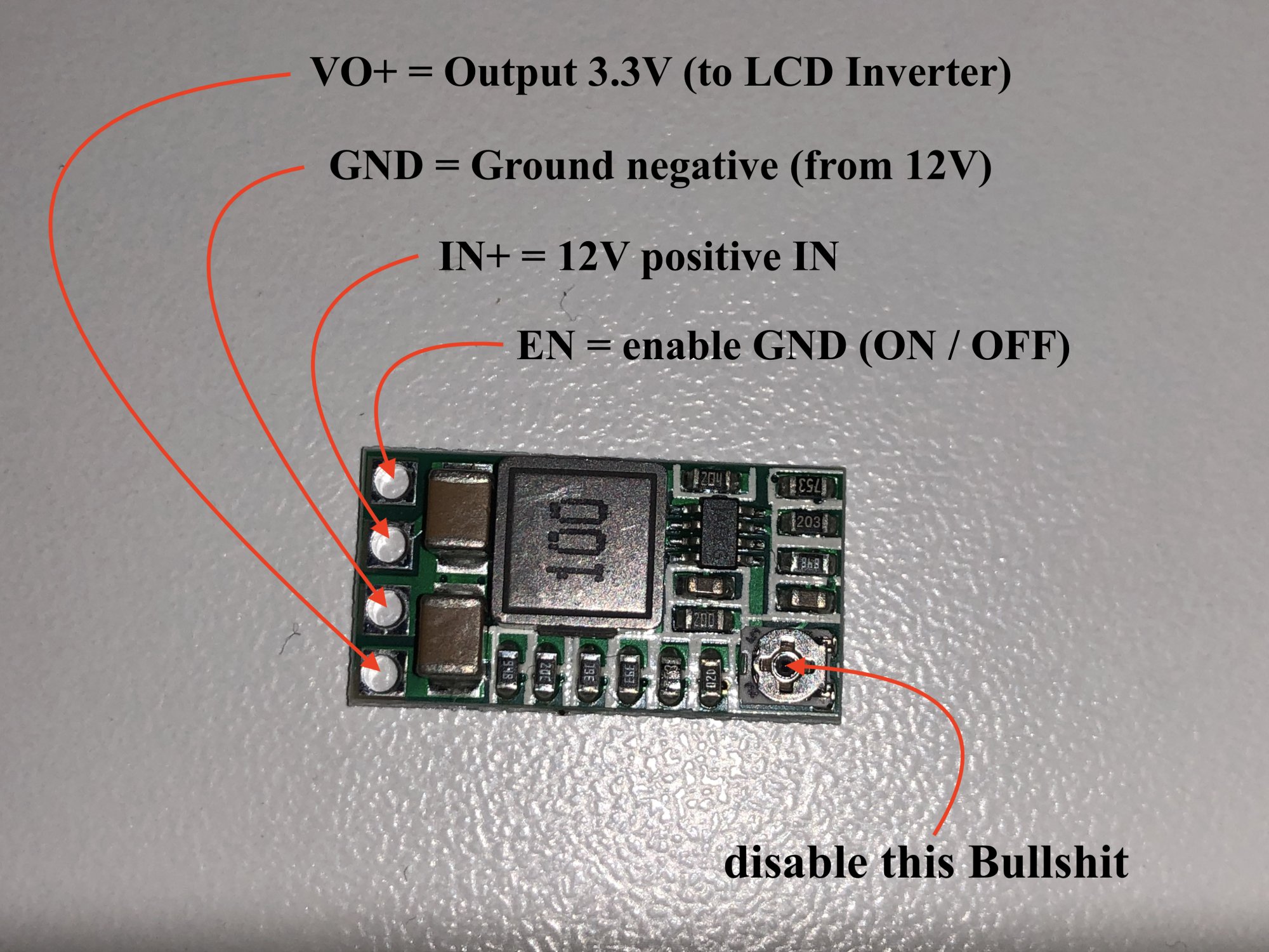

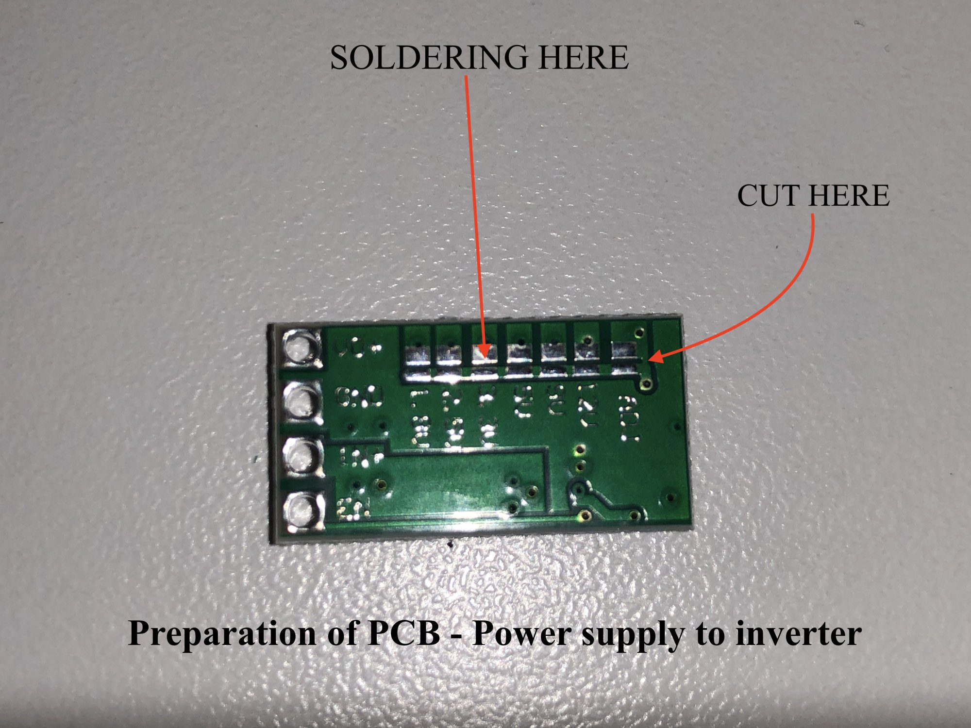

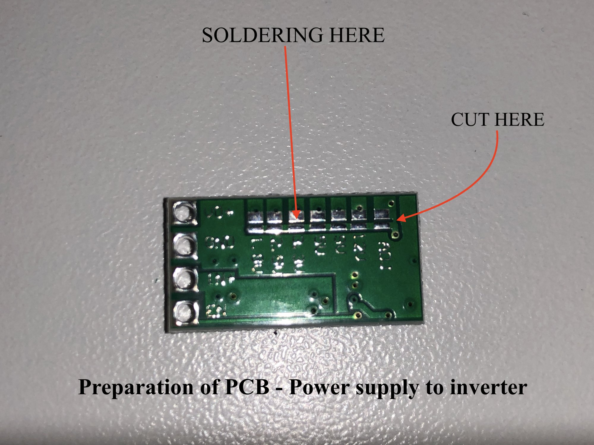

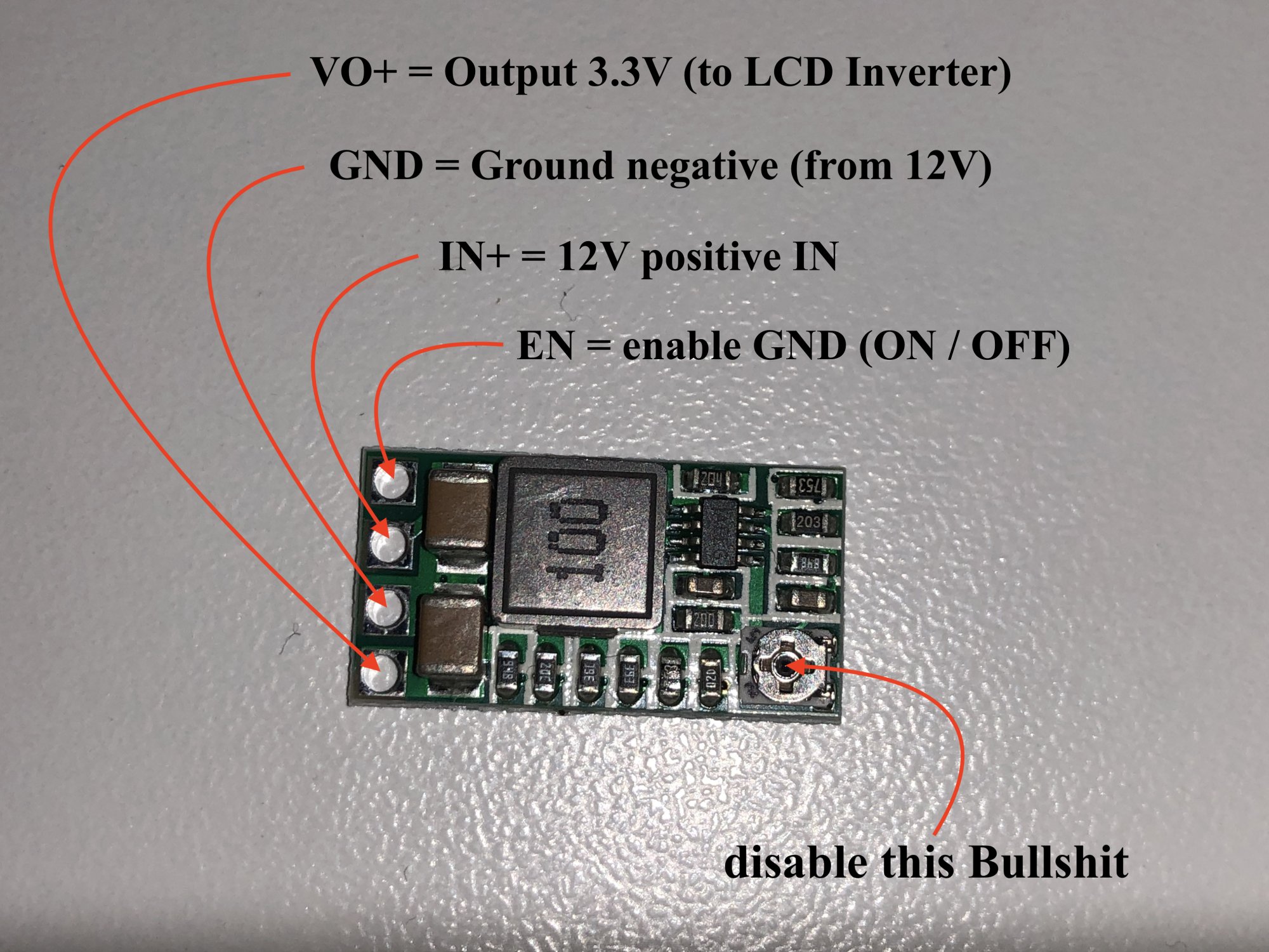

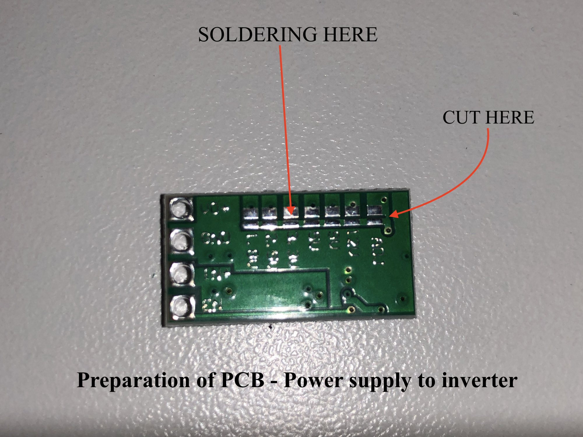

Hello, with the Quadro K4100 it's worth to get a HDMI Ghost Adapter which you can try to connect
with Thunderbolt II Adapter to one of the sockets of the A1312 (I don't know yet which one) to emulate
an external screen.
The other try is to make a power supply to inverter patch with 3V or 3.3V IC switch.
12V to 3.3V step-down power module + cable ;) but perhaps no screen dimming anymore possible...
an external screen.

Thanks for that proprosition but I won't go in such hardware job (too complicate for me) :eek::eek::eek:
