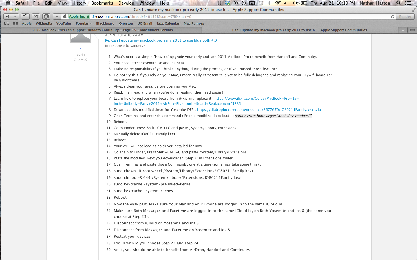

Ok so I have the working CAX chip in my early 2011 MBP. I've been trying this with public beta 2. I can't get the enable handoff option to come up in system preferences. Can anyone give me some tips?? I tried using the terminal commands as well as the kextdrop app, and I had no luck. I appreciate any help you can give!
If it helps, my wifi never stopped working like the instructions said it should. Not sure what I can do to make that happen. Thanks
UPDATE: I got the wifi to stop one time (said no wifi hardware detected, is that right?) but i'm not really sure how I did it and then when I tried to install the new kext it said it wasn't supported and couldn't be installed. Still don't know what to do haha. Also when i did the kexstat | grep AirPort command, it shows the Brcm 4360 thing like it's supposed to after you replace the kext.
UPDATE 2: GOT IT!!
what did you do i can't get handoff to show either ,wifi works,bluetooth works ,and kext shows what it suppose to

Well...I installed the new card in my late 2011 15 MBP and the wifi and bluetooth are both working. I can make and receive calls. Don't know about texts. The computer will see my iPhone/iPad, but it won't stay connected. I had to confirm the connection codes as well. I have not changed any kext files. However, I'm on the public beta release 3. I've heard that Continuity/Handoff were disabled for this version...I'm also not sure if I need to hack any kext files. Been reading a lot, but it's a bit heady. Any suggestions as to what kext file I should use to modify my Mac? I currently downloaded Wireless Diagnostics 11.17.52 from Aug 23. Not quite sure how to apply that...
SMS continuity was disabled on Public Beta 3 but phone call continuity is active (and also works with older versions of Bluetooth - no LE Bluetooth needed, as it's actually going through Wi-Fi)
