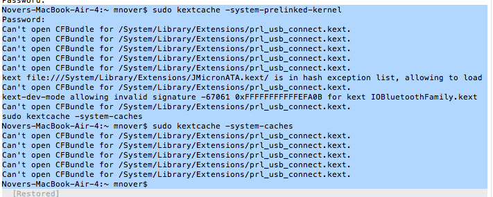

I have a Mid 2011 MBA. Tried the tutorial 3-4 times.
No Enable Handoff, No Airdrop (Airdrop show up in finder, but no computer are there). I can make and receive call though.
Terminal shows this as below.
Does that mean my first KEXT was accepted, but the 2nd wasn't?
