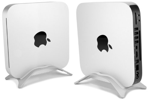

Get a $1.00 stand from Ikea
My temps hover around 41*F idle (2010 Mini 2.4 GHz) and I've never seen load temps go above 65*F for hours on end on ambient air temp of 34*F. I have it standing vertically, with PSU/power button on bottom since it heats up substantially, and having it in this configuration seems to cool down the PSU as well. I have had it overheat once already and taken to Apple store to get the mainboard replaced. It has not happened since.
I also use FanControl and set the max temp to kick up max fan at 80*F. I have fan speed on default until it reaches 55*F (since I'm trying to get the northbridge at least lower than 43*F at all times). I use Temperature Monitor to monitor temps on all my macs.

yeah I'm looking at i7 mini. Been following threads on the heat thing. Seen many innovative ideas, Interestingly though I've noticed several examples of mini being set on side (with/without stand)I haven't seen any where it's placed with rear up.
Would've thought in that position air flow would be maximum - exit vent above, intake below. Would be interesting to hear if anyone has tried it. Perhaps it makes cable management more difficult I'm not sure....

The ikea product is very interesting. You are saying that you rest your mac mini vertically on it? Since its designed for napkins, does the stand show any signs of cracks yet?
Cuz my local ikea has this stand too

Eh, I defer to darknite's response, but my overheating problems weren't rectified until I moved it up on its side using

The problem in my case is that when it's horizontal, the rear vents are barely above the desk surface and gets clogged with dust. I cleaned those vents after moving it up sideways - so it's not so much that the move "fixed" the problem, it's more proper to say that it prevents the dust build up which caused my problem in the first place.
