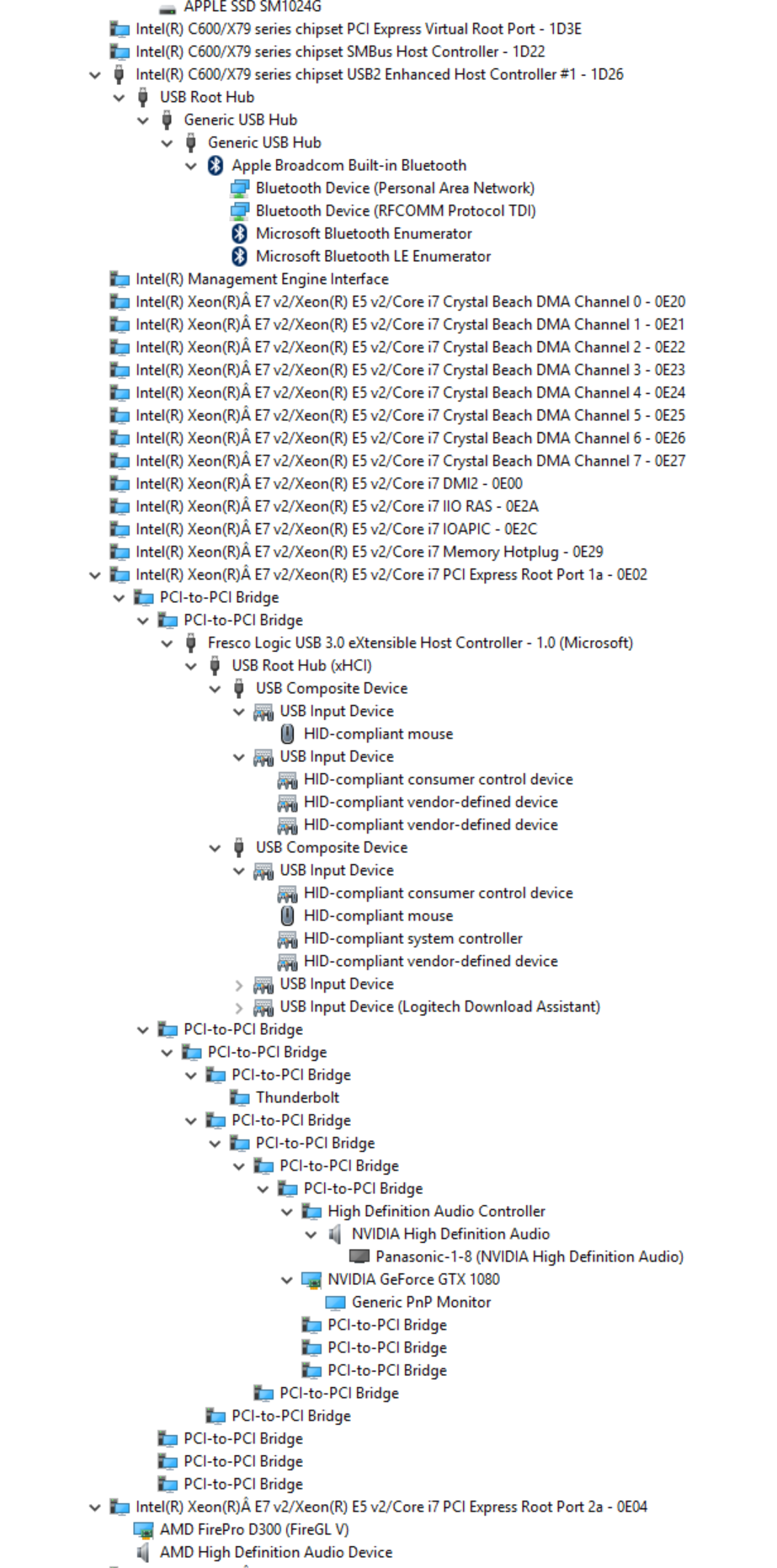

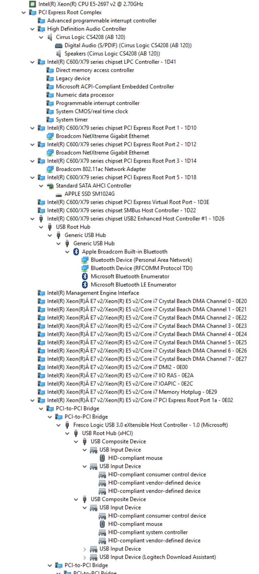

Here we can see how 6,1 connects resources. Note that the PCIE SSD is hanging off the 600, can it dole out PCIE 3.0 lanes?
If not, will require some re-wiring things. Probably won't be run through a SATA controller anymore either.
Note how the specific items are connected to specific things, not just handed out like Christmas Candy.
Took more than a year to get these to work. Always amusing when I get lectured on how it all works.
The images are doubled, it wouldn't all fit in one screen grab, still missing bottom and top. Same thing on 2014 Mini is...well...Mini.

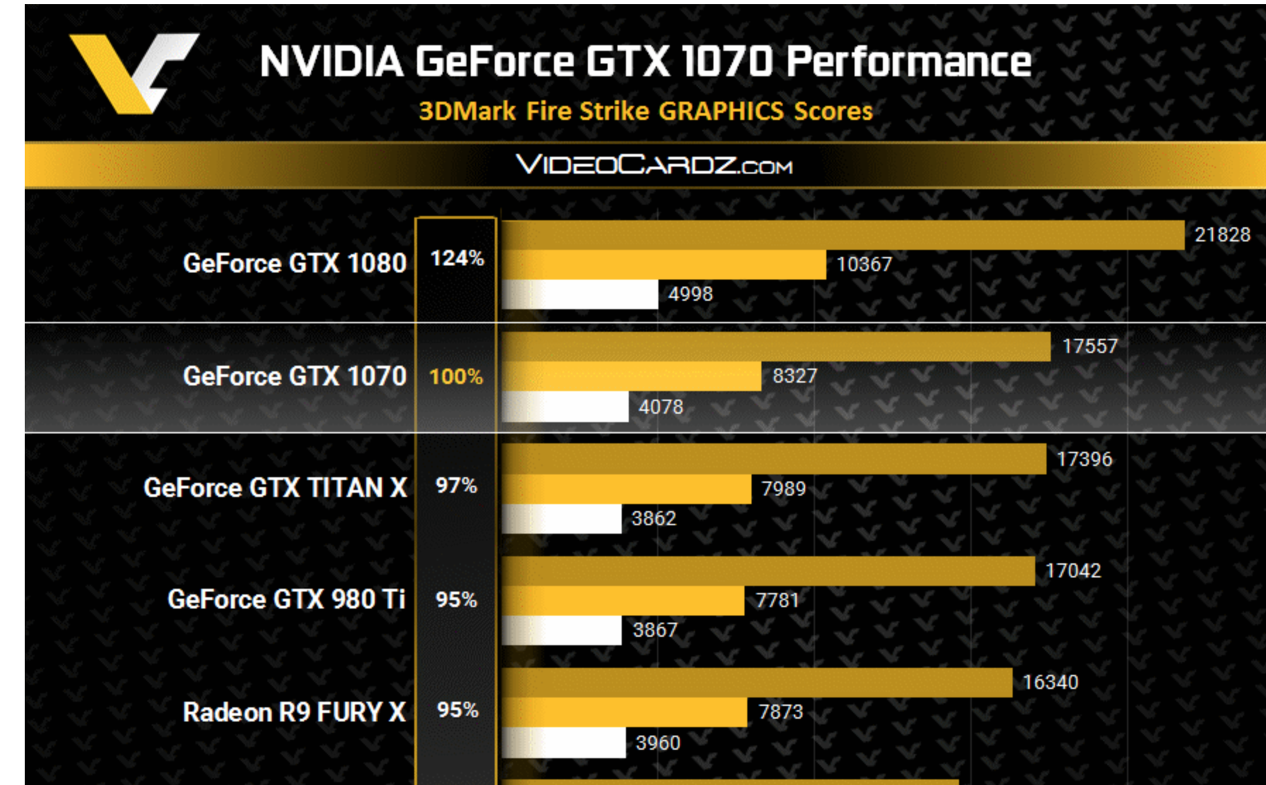

Anyways. First GTX 1070 review was up yesterday. It looks like it is not faster than Titan X, not faster than Fury X even, mostly on par with GTX 980 Ti and Fury. In some resolutions it is heavily bottlenecked by GDDR5 memory bandwidth.
In another GPU news:
I wonder how this compares to other GPUs.
Even If I do not see half of the posts here because of ignored content I can imagine what is happening :D.
So Nvidia will only have 4 of the top 5 GPU spots.
Hopefully "Mediocre Islands" present a challenge finally.
