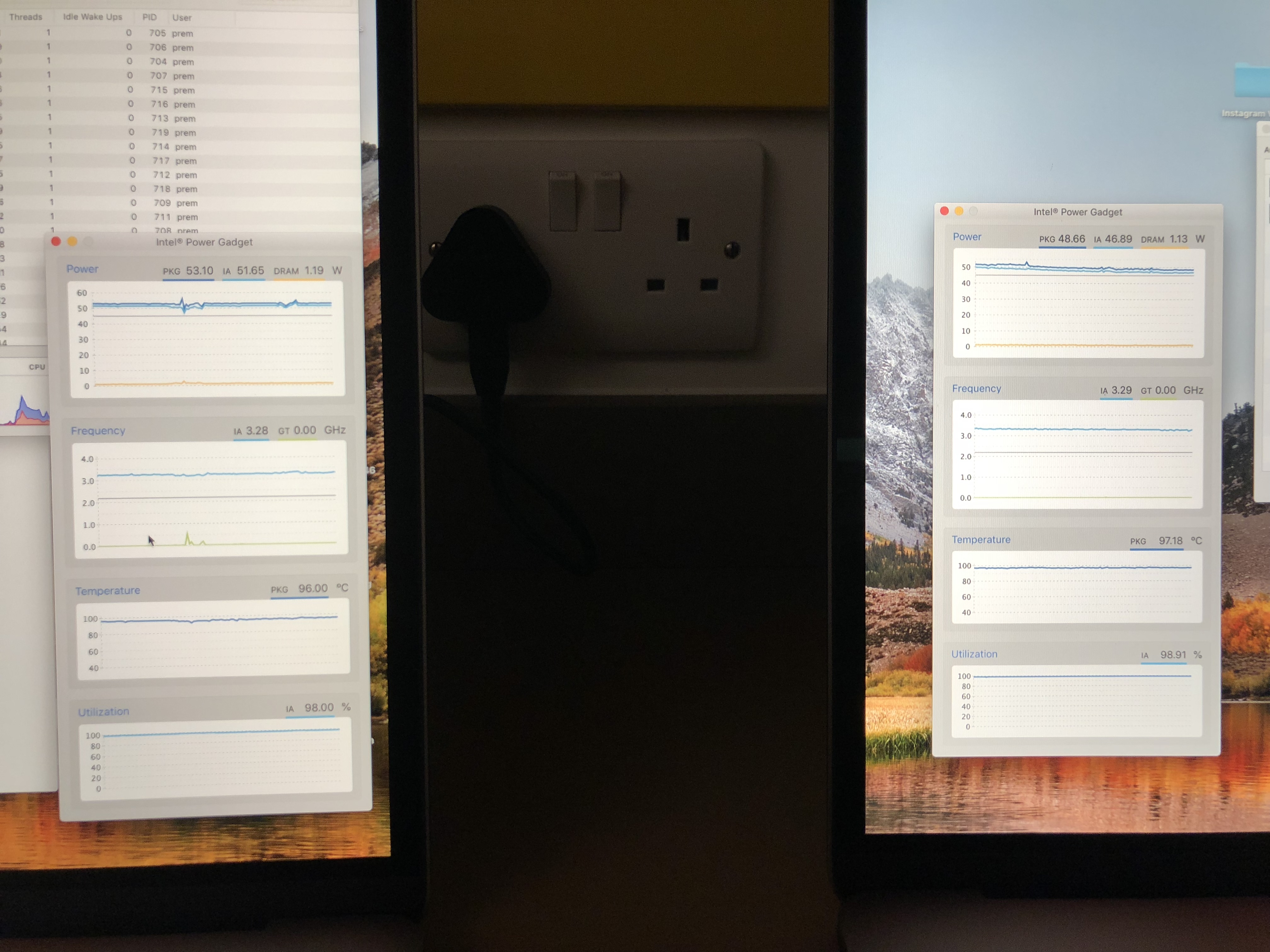

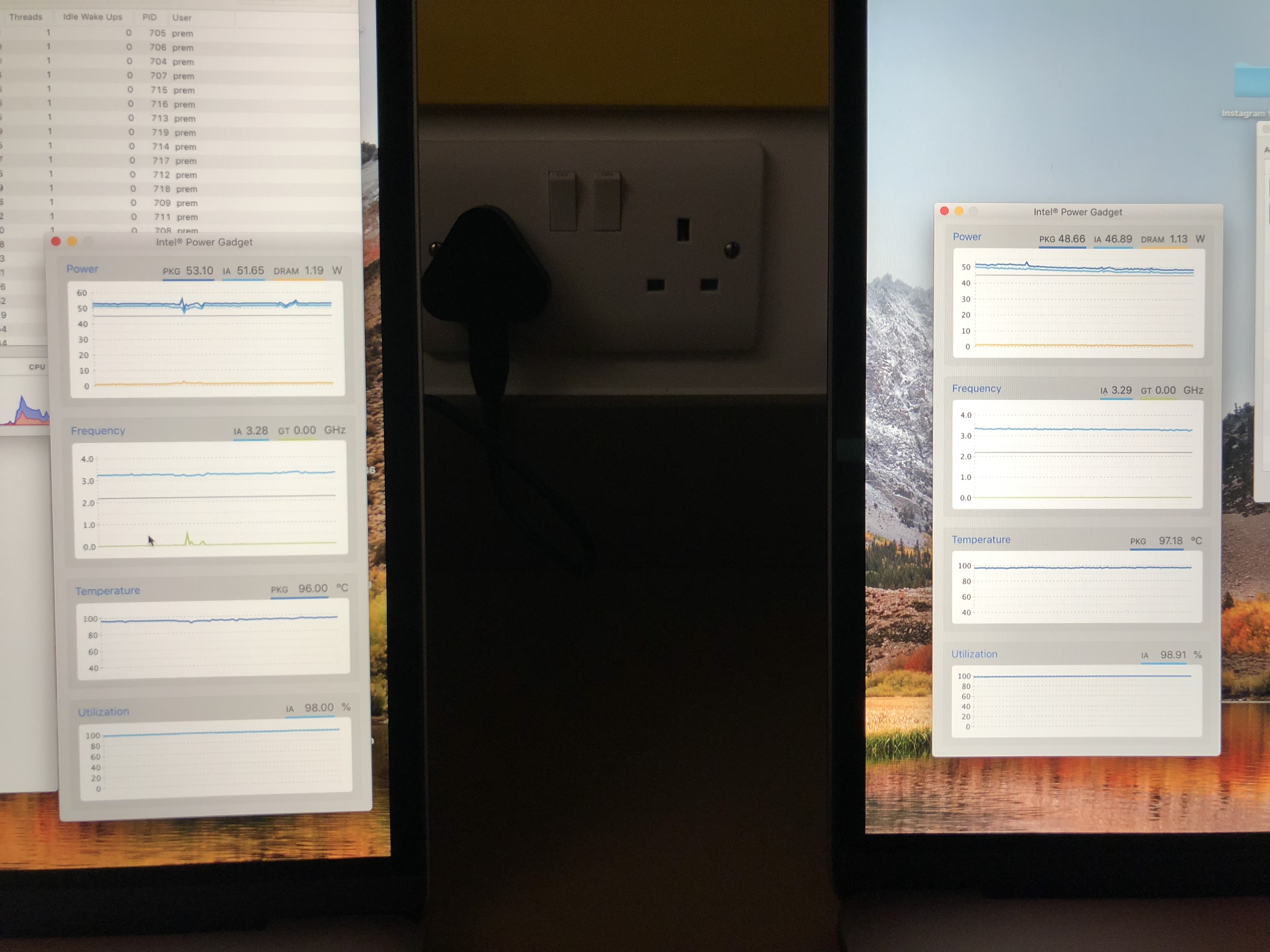

Sorry for repost. But two machines, on the left is with update. On the right is without. Both identical in hardware spec.
Running a yes command I.e. max CPU usage. Will post another later this week with istat temps.
Just noticed this. I’d take the one on the right, 5W lower power consumption for the same frequency. That’s a lot. Do you still have both of them? The fans were at max I assume? It is weird, I would expect higher clock for the same TDP, looks like the one on the right has better binned CPU but worse cooling.

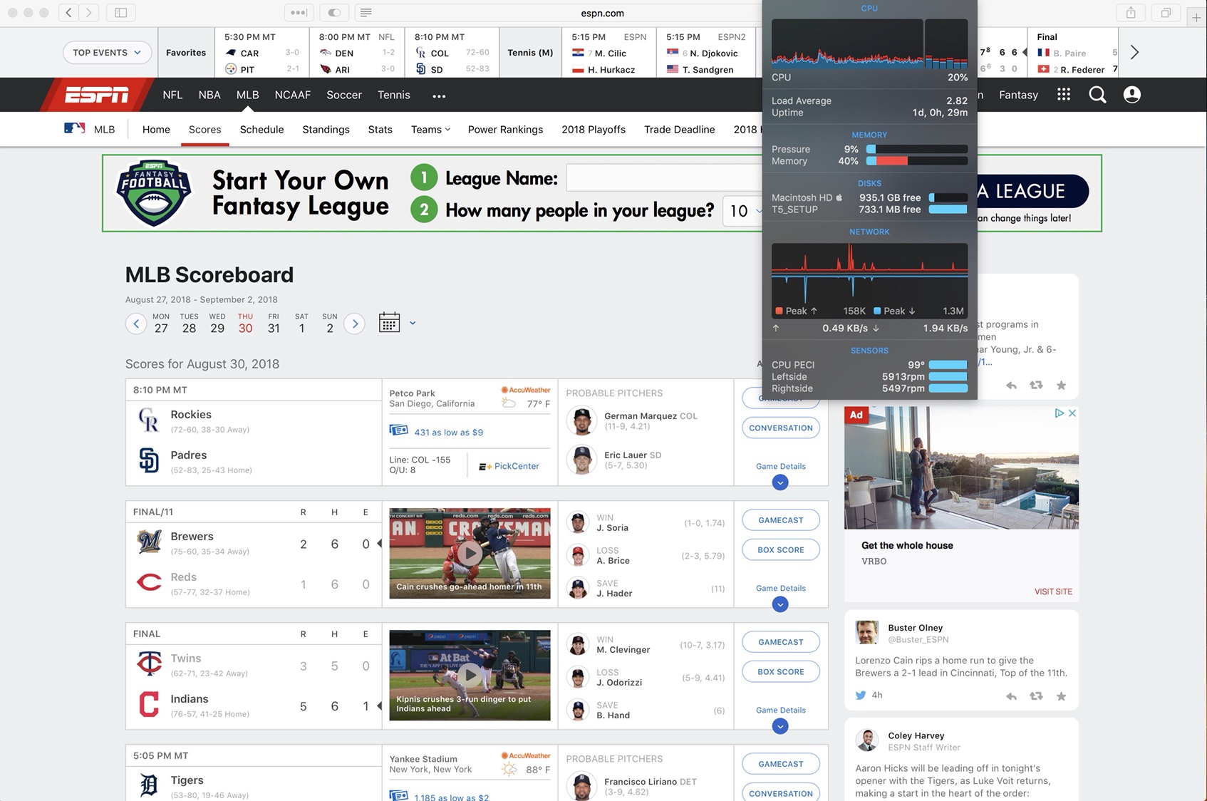

I still get readings like this with certain web pages and earlier today got similar results only sinking my phone via iTunes
Just Safari with one tab open and nothing else.
That's bad, are you sure there is nothing else running? I opened the same page and Safari shows eating 50%, so I guess this is around 4% overall. Fan at idle, 2.2 CPU.

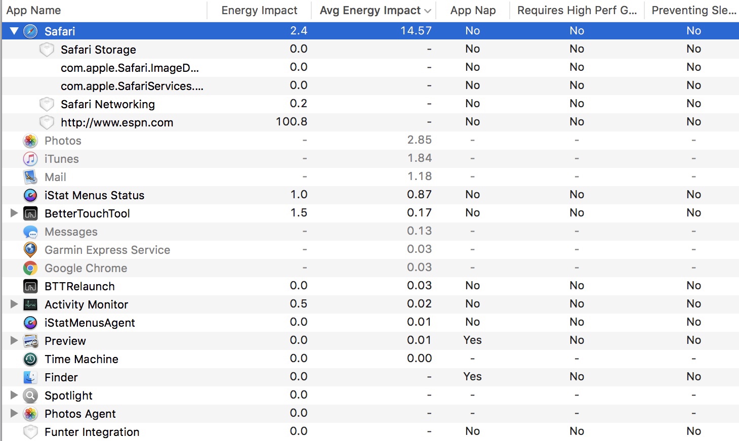

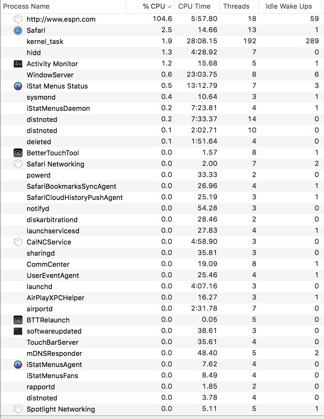

Absolutely sure and it only does it randomly. It was doing it a couple of days ago and I was like WTF?? And then they had the supplemental update yesterday and I checked it and temps were in the mid-40’s to low 50’s. Today, back to that.
Earlier today the only thing I had open was iTunes to sync my phone and it did it. Shut down iTunes and temps went down.
Tried syncing my phone the same way probably half a dozen times since then to try to replicate it and I can’t. Dunno. This is on an i9
Next time it happens make a screenshot of the activity monitor, sorted by CPU usage. That's bizarre.
Will do. I should have done that when I had the page open. I left it open about 15 mins to see if it would be ever stop without closing it or see if the temp would ever exceed 100c and shut down. I am still in the return period, so if something bad is going to happen, now would be the time hahaha.
I actually got them to extend the period to 30 days, so still have 3 weeks left.
Okay. Don’t know if this helps any...
But that page has a huge energy impact and seems to be using almost 105% of CPU?
100% is one virtual core, so it means only 8% total. In my case I get 100% when the page is loading, and if I leave it open it goes down to 10-15%, when scrolling goes to 50%. Maybe you have some Safari extension?
Hmm. That was a good thought. I had LastPass (which I was sure wasn't the problem) and 1 Blocker installed. But I disabled them both and I still bounce off 100c. Really not sure what is going on there.
Regardless of what is causing high CPU usage in Safari you should not be hitting 100C with 20% total utilization and fans at max. If it was my machine I'd run some benchmark that loads the full CPU, and compare to the known results. It really looks like something is wrong with thermal paste/heatpipies.
I will try that. Do you happen to know a good one for that purpose? At idle with nothing loaded it sits at around 44C, 0-1% CPU utilization.
Geek Bench will cause it to hit 100C a couple of times, but only for a split second and it cools right back down.
Yeah I do. I’ll run a few tests tomorrow evening. Gunna give it back on Saturday. Fans were max yes, it was weird, I thought it was underclocked? Not entirely sure what to think.
