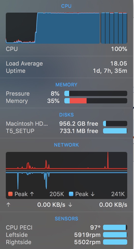

Let us know how you get on. You’ll know for sure how good your cooling is this way.

Ok. Here is the temp and fan speeds after doing it 4 times ...
Not going to lie that is hot. But bare in mind you’re maxing 6 cores at 2.9ghz. That’s expected, my 2.2 pushes around 95c. So marginal difference in temp considering the extra performance.
However it’s more so the temps you’re getting when you’re just above idling. Least you know your heat sink is working, might be a dodgy bug.

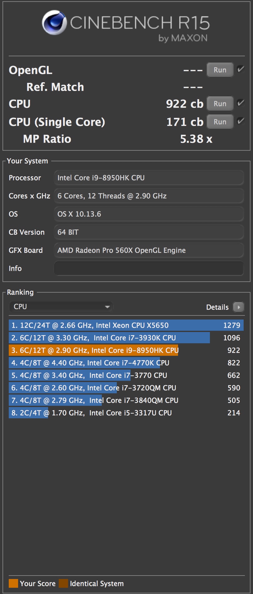

When running a banchmark I had something like Cinebench in mind, so that you can compare the score. Or a least open Intel Power Gadget when running the ‘yes’ commands. You’re hitting 100c at 20% already, so you’re going to hit at 100% also. I mean everybody will. The question is whether your cooling system is compromised.
Mine has just a few days and although I don't hear the fans it gets a bit warm when watching YouTube videos or browsing Facebook. I have the 13-inch Touch Bar i5 quad-core model.
Cinebench will also result in temps at or near 100c, particularly the CPU (Single Core) text.
Results seem disappointing....
But it’s not catastrophic, I thought you may be getting half of that. Check if your dGPU is not active, maybe that’s causing additional heat. On the plus side - that may be a perfect opportunity to create a YouTube video bashing Apple and i9. Once you’ll find the cause it will be too late.

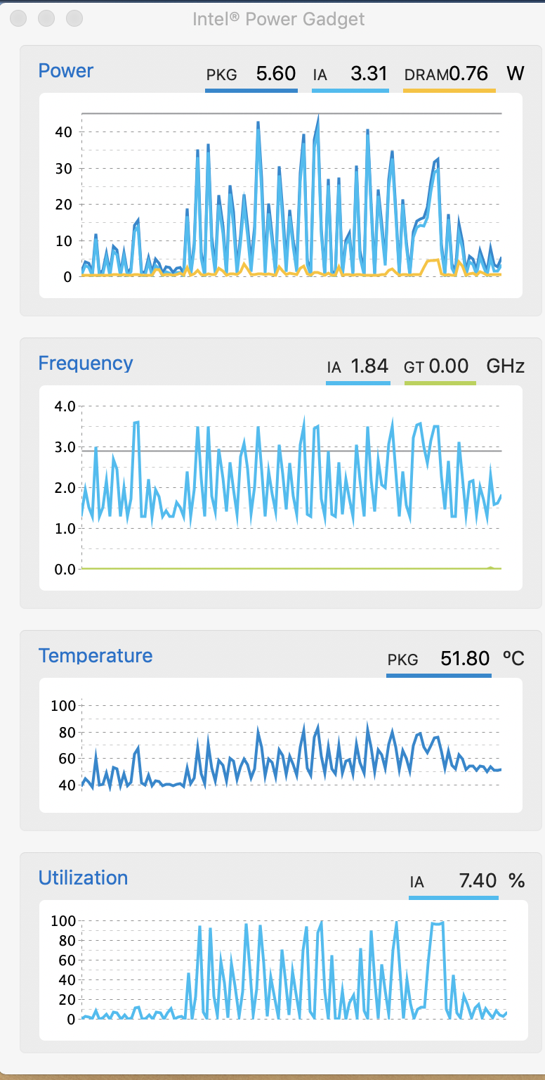

I read posts that Mojave runs cooler then High Sierra. Overall the 2018 are going to run a little hotter then previous versions 6 cores vs 4 cores same chassis as 2016/2017.

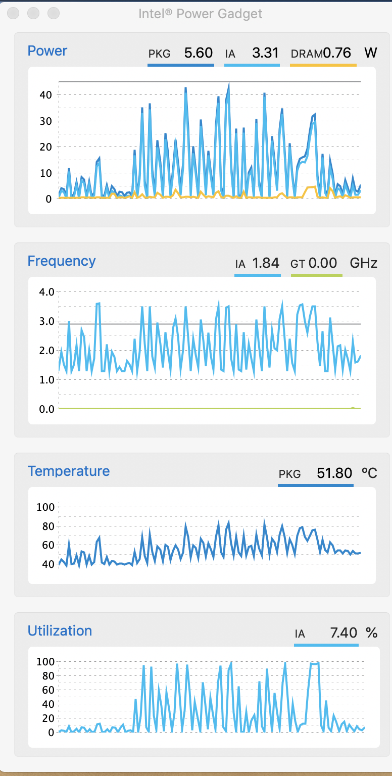

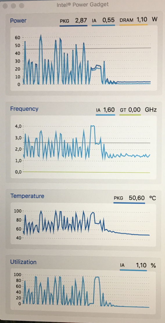

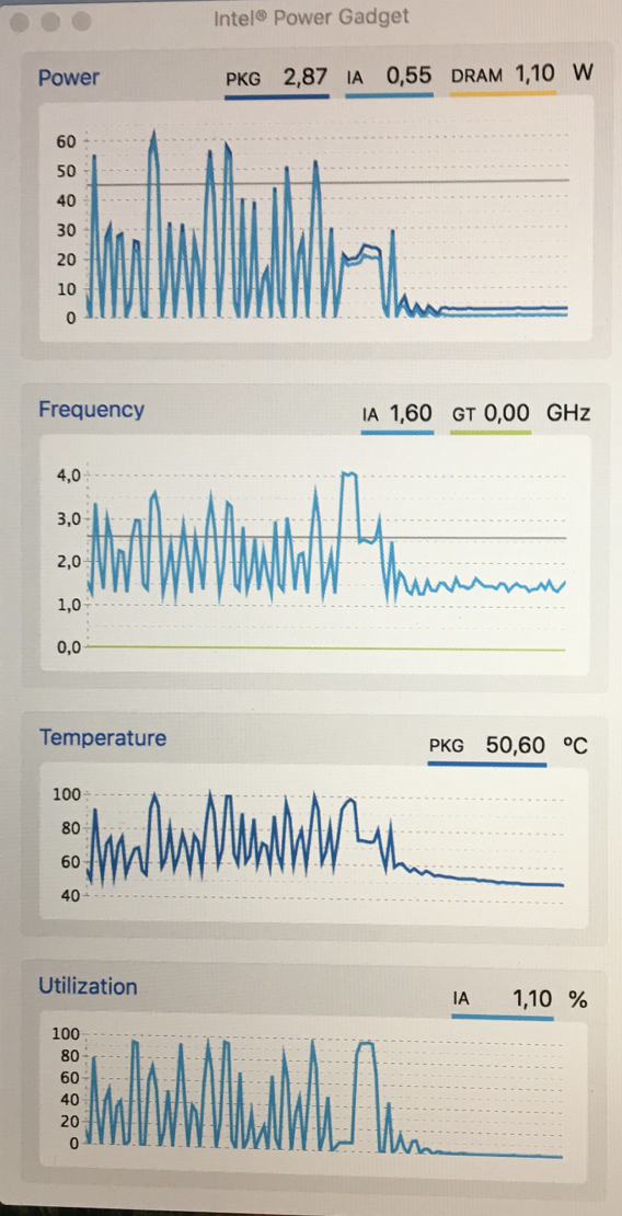

If you download the free intel power gadget you can see and post actual usage and temperature which may help to decide if you have an unusual problem. For example I attached the snapshot of a 2017 MBP 15" 2.9 and a 2018 MBP 15" 2.6 both running Geekbench 4 test.
I hope that helps.
