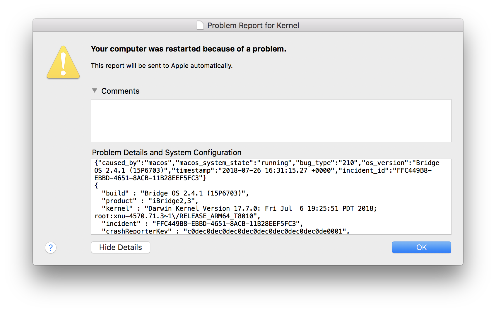

Mine just crashed again early this morning during sleep with the Brigde OS error. This is now my third time in 5 days. I do have the supplemental update installed.

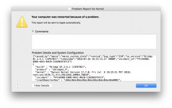

Just happened to my MBP 15 2018 (2.6GHz, 560X, 512GB), if the attached screenshot is anything to go by. This is with the latest update installed. I'll see if it happens again and maybe then I'll contact Apple.

I spoke way too soon. Just had some sort of a kernel panic and my machine restarted. Not good Apple.

This seems to be an issue w/ t2 chip machines. I'm sure there are people who don't report this issue even though they have kp due to 'bridgeos error'.

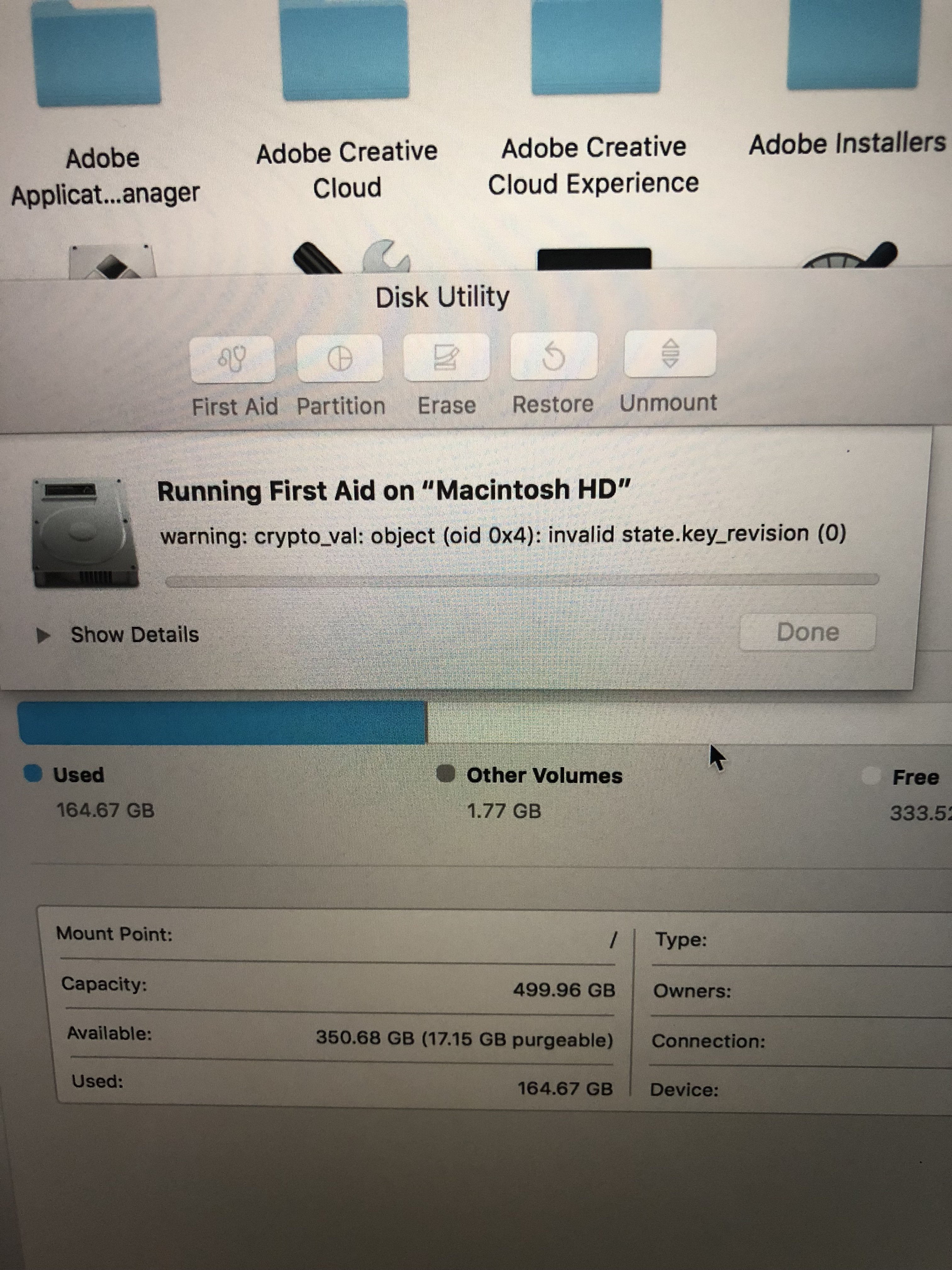

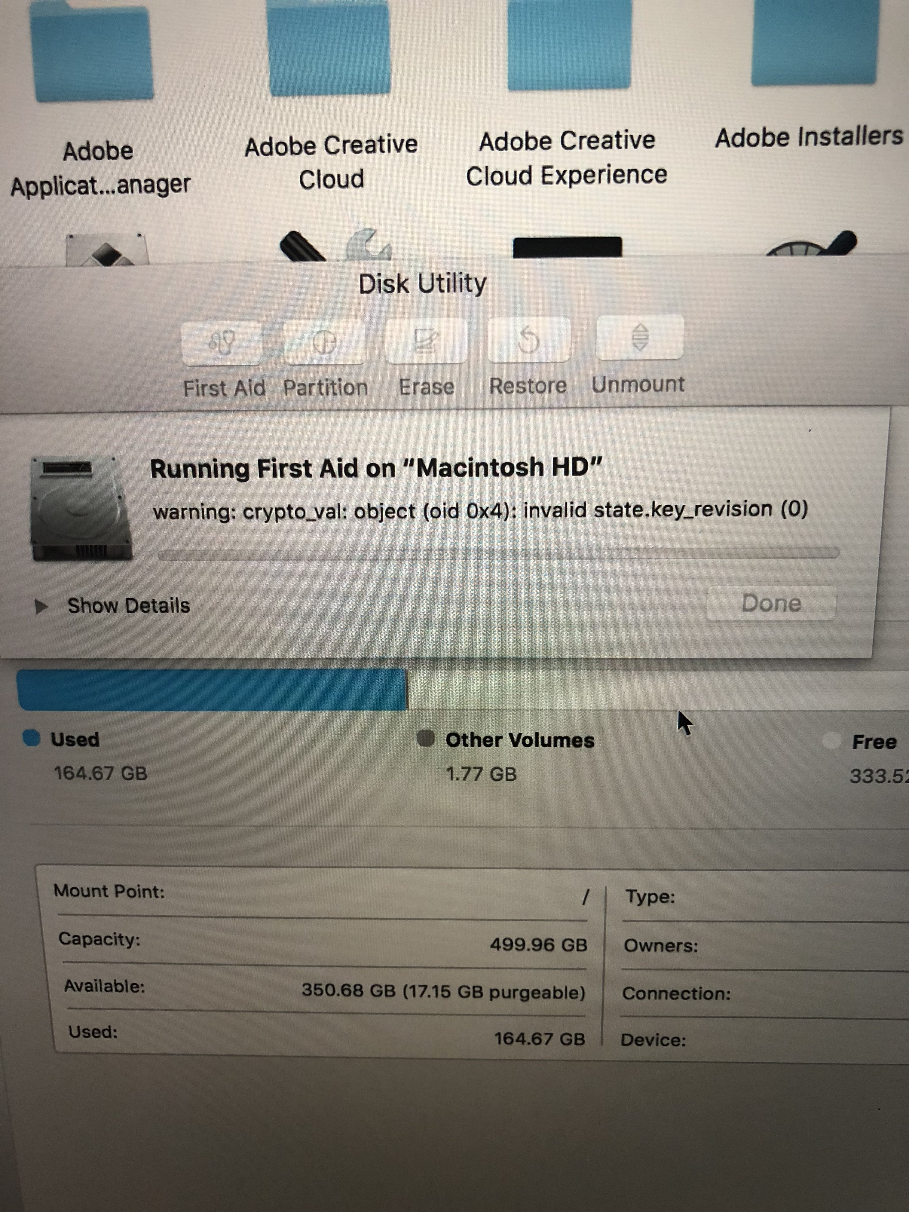

I’m currently wiping my hard drive and doing a Time Machine restore. At least this will clear the crypto var errors and When support tells me to reformat I can say I already did. If the problems continue after this, I’ll return it and get my $4800 back.

All the T2 machines have those crypto val errors fresh out of the box, even Apple’s own display models. I don’t know if it’s related to the crashes though.

I just talked with an AppleCare rep (he called me after seeing posts on the Apple forum) and provided him with all the crash reports info and the crypto_var errors.

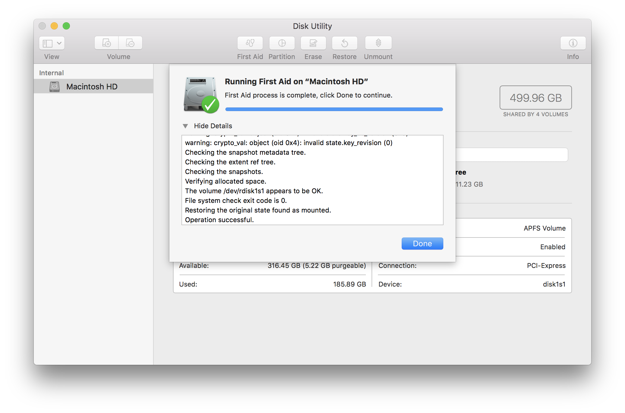

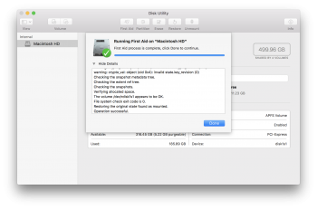

I just finished booting from recovery, wiping my hard drive, restoring from a Time Machine backup (of this machine from earlier today), and reinstalling Mac OS 10.13.6 and the 10.13.6 Supplemental Update. The crypto_val errors are gone after wiping the hard drive. Time will tell if the machine crashes with the Bridge OS error again.
