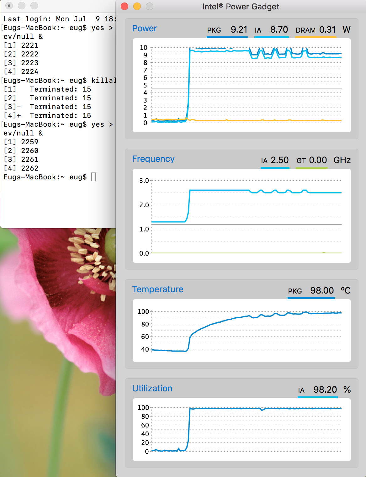

By the way, this is how my 2017 iMac Core i5-7600 behaves with the YES x 4 test, which pegs the quad-core quad-thread CPU at 100% usage.
Even though this is a 65 Watt TDP chip, at full tilt in this test the power utilization is only 45 Watts (for the package). There is no throttling at all because the temp has remained under 90 degrees C. The base clock speed of this chip is 3.5 GHz, yet it runs solidly at 3.9 GHz, which makes sense since the all-core Turbo of this machine is 3.9 GHz. So, for all intents and purposes, this machine is a 3.9 GHz quad-core machine, despite being labelled a 3.5 GHz machine. The temp is slowly climbing though.
For comparison, let's look at my 2017 MacBook Core m3-7Y32 with the same YES x 4 test.
Here this (presumably) 7 W dual-core 4-thread chip (using TDPup) running at around 10 Watts (for the package), maxed out at 2.6 GHz. But the temp climbs much quicker since the the machine is fanless. Eventually the temp hits 90C and then it throttles, but only slightly down to about 9 Watts, to limit the speed to 2.5 GHz. I tried running Volta to control the wattage to see what happens, but for some reason everything is greyed out so I can't use it.
So again, there is no wattage control of the chip by the machine, until it throttles. However, even though it does throttle, it's OK because it throttles very mildly and performance is relatively maintained. Max all-core speed is 2.6 GHz but under throttling it never drops below 2.5 GHz.
I'd be curious to see how the 2018 MacBook Pros behave with a YES x 12 test. (It was just x 4 for me since both of my 2017 machines are only quad-thread).
http://osxdaily.com/2012/10/02/stress-test-mac-cpu/
On a 6-core 12-thread machine, the Terminal command would be:
yes > /dev/null & yes > /dev/null & yes > /dev/null & yes > /dev/null & yes > /dev/null & yes > /dev/null & yes > /dev/null & yes > /dev/null & yes > /dev/null & yes > /dev/null & yes > /dev/null & yes > /dev/null &
To stop the test, it's:
killall yes

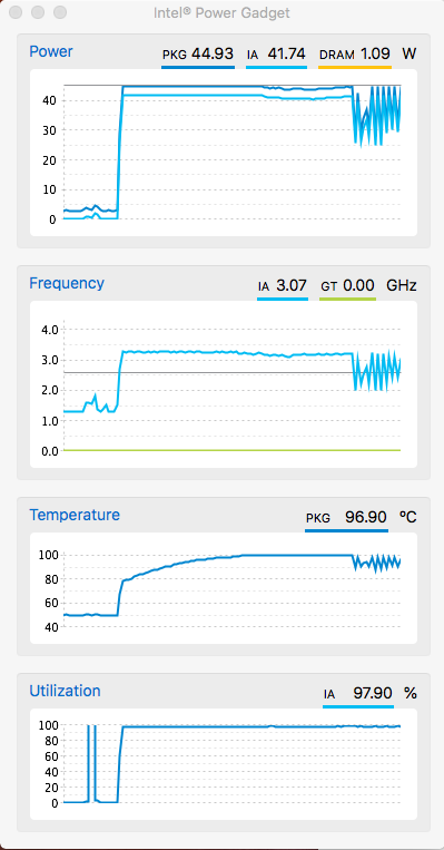

So here is what I observed with the YES X 12 test
This is Default with no Volta or FAN control:
This is with Volta set to 45W MAX:
This is with Volta set to 45W MAX and Macs Fan Control (CPU PECI 50 C):
This is just Volta at 45W MAX for longer sample
Appears to me that once the system gets to 100 C is when the aggressive behavior starts regardless of Volta usage or not. With Volta it was fine until it hit 100 C then it wobbled and if you look at the last graph it eventually starts to normalize somewhat once the temps are regulated around 98 C. With Macs Fan control and Volta it simply takes much longer to get towards 100 C but it seemed to hang out at 98 C. Hope this is helpful
