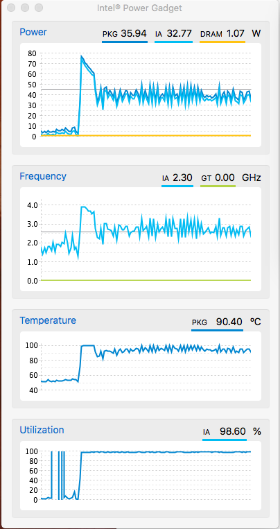

So here is what I observed with the YES X 12 test
This is Default with no Volta or FAN control:
Wow, almost 80 Watts with this YES x 12 test. It immediately jumped to 100C. :eek:
Your so-called 45 Watt TDP mobile i9 looks better suited for an iMac. Ironically, my so-called 65 Watt TDP desktop i5 looks pretty good for your MacBook Pro, as it hovers below 45 Watts maxed out at 3.9 GHz.
Either way, it would be useful to see the results of a YES x 12 test with Intel Power Gadget. My guess is it would throttle at least as hard as the videos have shown with other applications, or perhaps would throttle even harder.

So it seems Apple designed the cooling system for a TDP of 45 Watts, and the system actually works decently well for a TDP for 45 Watts.
However these chips use way more than 45 Watts for sustained loads. I could understand if it was with power viruses or something, but these results are with actual and common applications, what people might actually use their MacBook Pros for in real life.
IOW, it looks like Apple took the MBP chassis, and essentially just dropped new 45 W TDP chips in there... except some of the higher end chips really shouldn't be rated as 45 W TDP.
The decision to let the i9 run above 45W is in Apple's hands.
I want to see one more column of test with factory settings but in an extremely cool environment (ie what if chasis could properly dissipate all heat), to see whats the most performance one could get.
If I had a walk in freezer I'd help test that :p
Your confusing Intel's definition of TDP and power draw 80W is to be expected given the performance these CPU's can deliver in the right chassis.
i9 can pull over 150W and put many a desktop to shame, the rest is on Apple...

I’m not confusing TDP vs power draw at all. The point is the TDP is simply too low. YES x 12 is not real world but it’s far too easy to far exceed the the TDP with common real world workloads. Furthermore, judging by the tests the MacBook Pro can handle 45 W workloads just fine.
This is not inherently an Apple design problem. This is an Intel 8950HK-45W-TDP-is-bullcrap problem.
The TDP & power limits will be documented in Intel's data sheets which will be made available to all OEM's with engineering samples well in advance.
Same will be made publicly available in time. Apple simply either got it's maths wrong or doesn't care...
I own a notebook with the 8750H and it has zero throttling tendencies pulling close to 90W under max load. Then again the OEM clearly spent more time with Intel's specifications, than it's sales & marketing department....
Intel clearly state the TDP derived from base frequency, the rest is in the data sheets. People want thin & light, people want big number's you got it, pity the performance is so clearly compromised.
