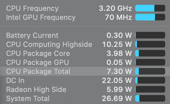

Here you go buddy:
This is under general browsing. Its the first time I've seen the iGpu being used while an external display is connected. Though the dGpu seemed to be doing most of the heavy lifting. The iGpu now work in tandem with the dGpu.
Seems like they managed to get both the iGpu and the dGpu to work concurrently or some sort. Maybe some expert can chim in on one this for me.
My temperature used to idle at around 60c-70c while under general use. But its at 54c now (ambient temperature 26c).

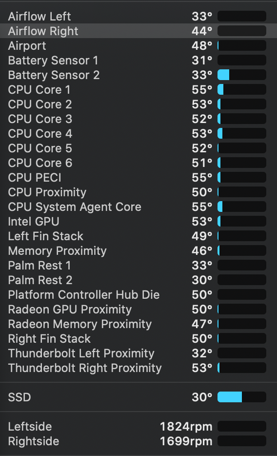

This is my temperature and fan information:
