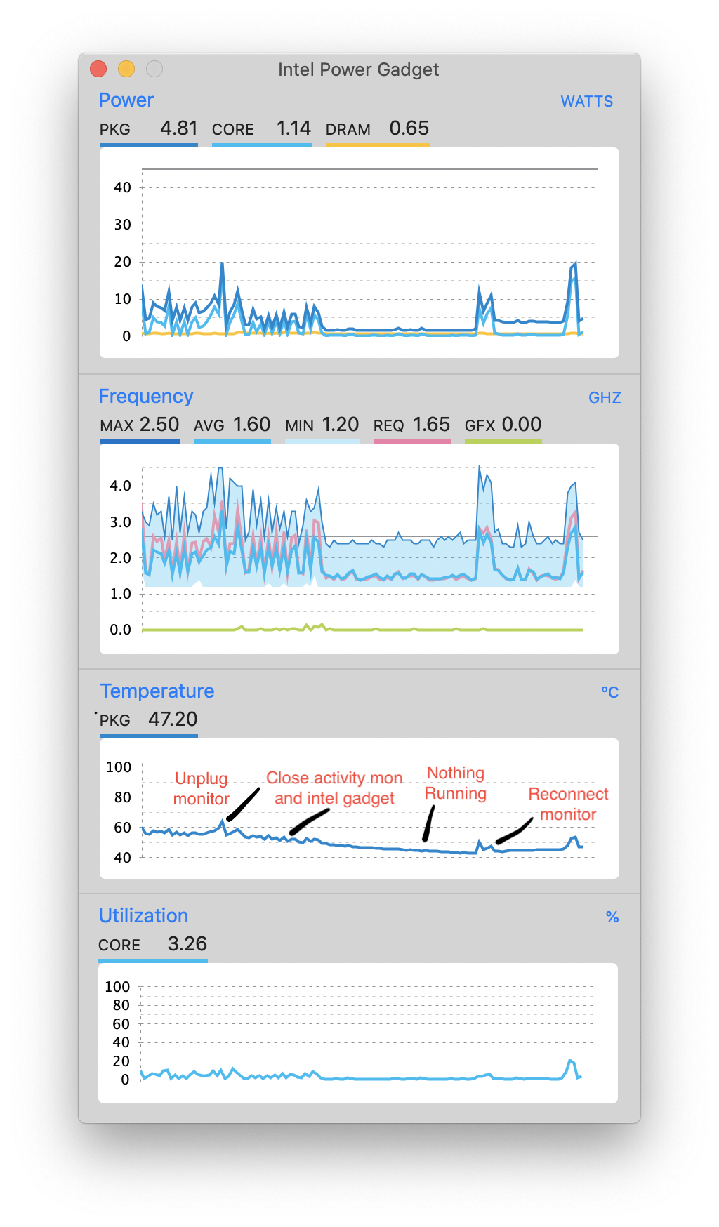

Here is the Intel Power Gadget that monitors your CPU temperature, utilization, and frequency. It also draws some nice graphs. I have labeled the temperature graph. You can see it go down as I unplug the monitor. Then I close the programs I had open (Activity Monitor and the Intel Gadget), and you can see how low the temperature goes. Almost down to 40 degrees. I plug the monitor back in (Acer 27" 2560x1440 connected with a USB-C to DisplayPort cable) and you can see the temp go back up slightly. Again, nothing running, this is just the mere act of plugging a monitor back in which activates the dGPU.
There are people here who say things like "I can hear my fans, all I have open is Firefox and 3 tabs, this computer is defective and I am returning it to Apple tomorrow." Then, they post a screen shot of some kind of temperature monitoring app, there's a hundred graphs and number, you can see in their menu bar that they have 6 other apps running...
Your machine is running hot because you are using the CPU. It's that simple.

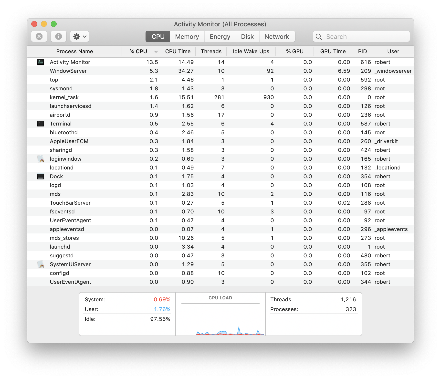

Activity Monitor alone can take a decent chunk of CPU.

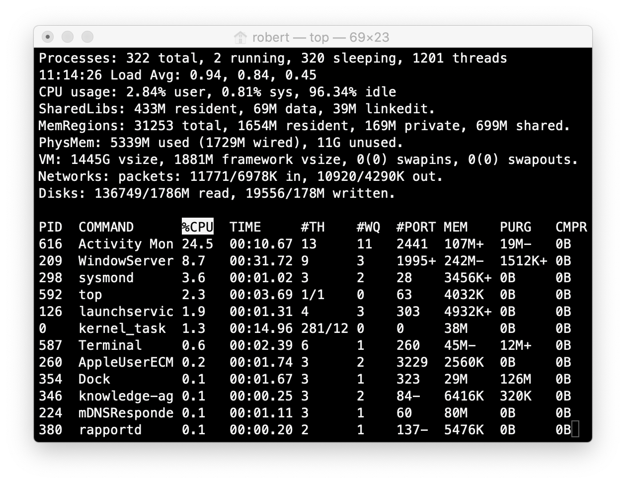

It says 13.5% for itself. But if you look at top, which is a command-line UNIX tool for seeing similar information, it shows Activity Monitor using almost double!
Which one should we believe? Anyway, what I am getting at is that you need to look at what's running and what's generating heat - AKA, using power. You might only have two tabs open in a browser, but those tabs might be running all kinds of Javascript that is showing ads, drawing graphics, collecting user data...so look and see how much CPU your browser is using. 5 tabs of one website might be equal to 1 tab of another website.
