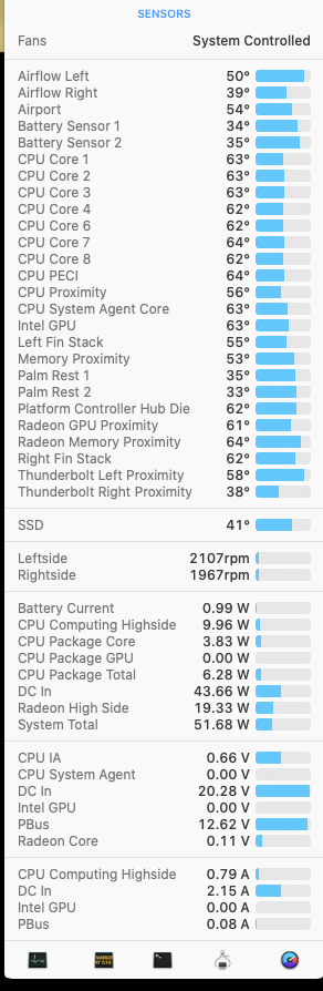

What app is this? https://forums.macrumors.com/attachments/bildschirmfoto-2020-10-07-um-22-45-28-png.964017/
I'd like to report on my experience with my new MBP 16" 5600m. I'm only playing a video on Udemy and have pages open and my fans are very loud. I guess about 2800-3000 rpms (I have an MSI GS60 which is a bit louder than this so I have a base case to compare off.).
Edit: I found out elsewhere that this is iStat Menus by bjango: https://bjango.com/mac/istatmenus/

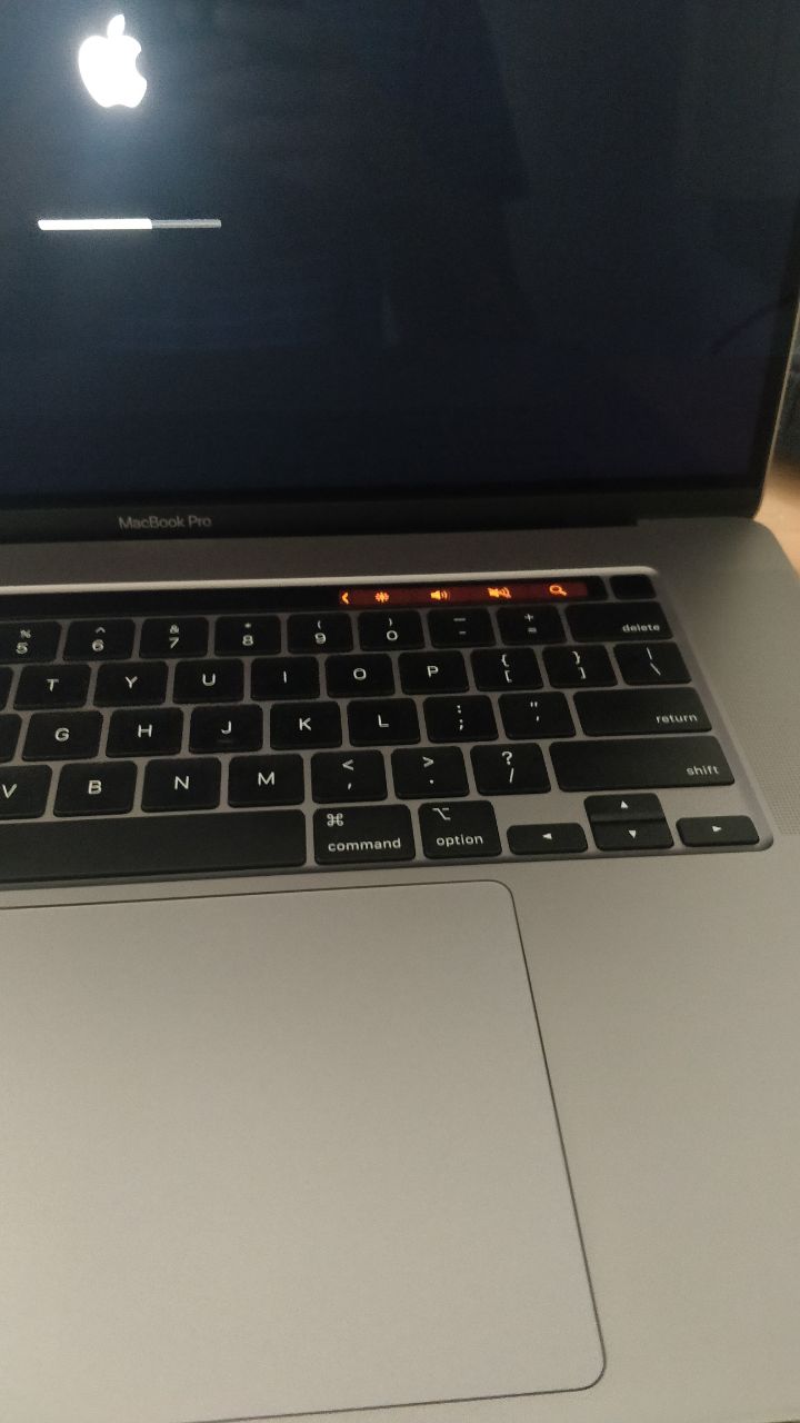

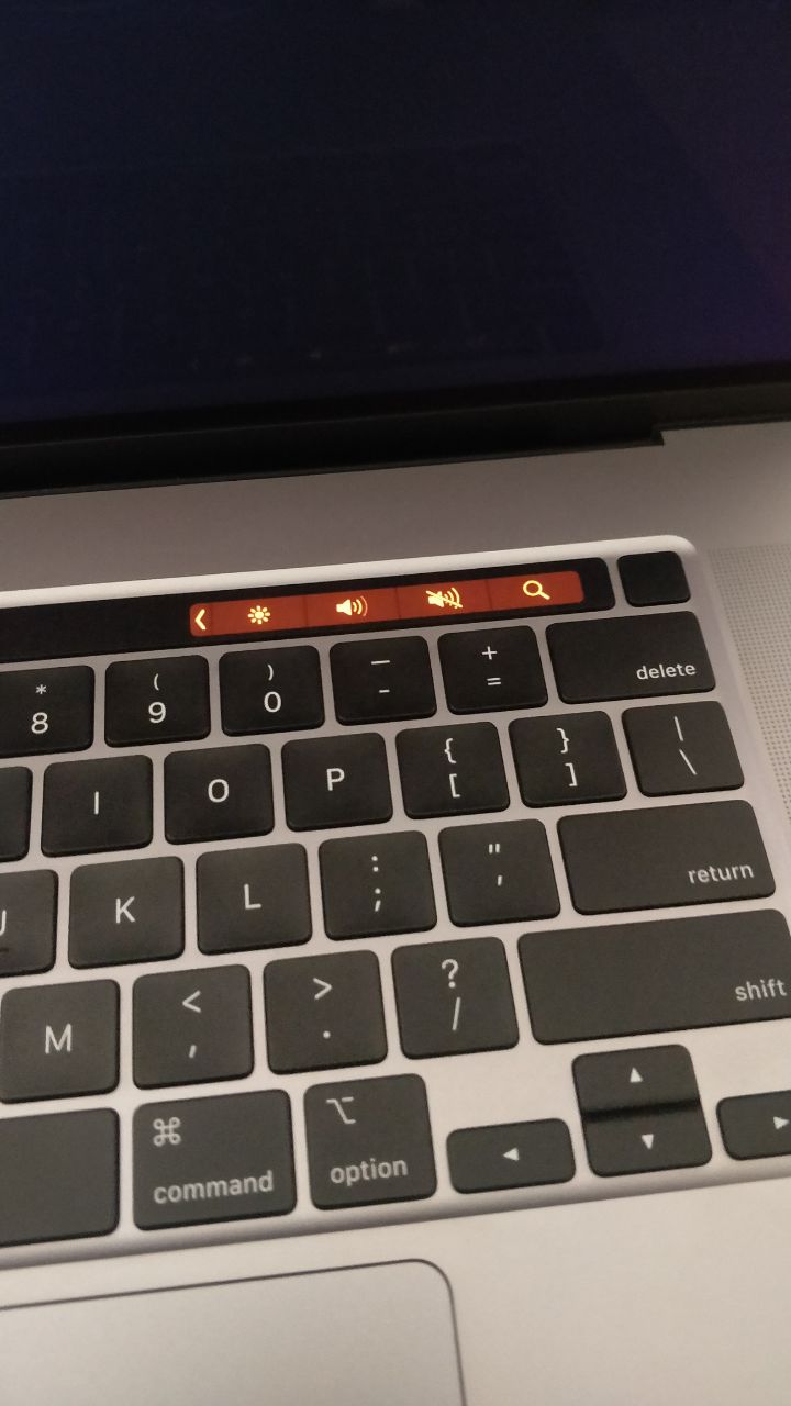

Hello everyone, I have a 16" MacBook Pro base model running 10.15.7. Since yesterday when I turn on my Mac I am getting the Touch Bar in orange color, and once the device turns on it becomes white again. PFA the images for the same. Anyone any idea why is it happening?
