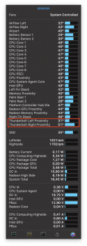

TL;DR: In my 2017 15" a Thunderbolt 3 dock/monitor made the Thunderbolt chip in the side I was plugged in heat up +20°C, while a USB-C dock didn't. So I returned my Thunderbolt dock and got a USB-C one. The 2019 16" seems to light up the Thunderbolt chip even with no Thunderbolt peripherals attached (just USB-C monitor).
Take a look at this screenshot, in which the Thunderbolt Right Proximity (which is the side I'm docked to) is constantly 20°C higher compared to the Left, a behaviour that didn't exist in my 15". Unfortunately I don't have my old MacBook anymore to test and compare where these watts are being consumed/accounted for, but what I remember is that as soon I sold my Thunderbolt external dock my problems were fixed in the 15", but either with USB-C docks something is lighting up in there and warming things up for no reason.

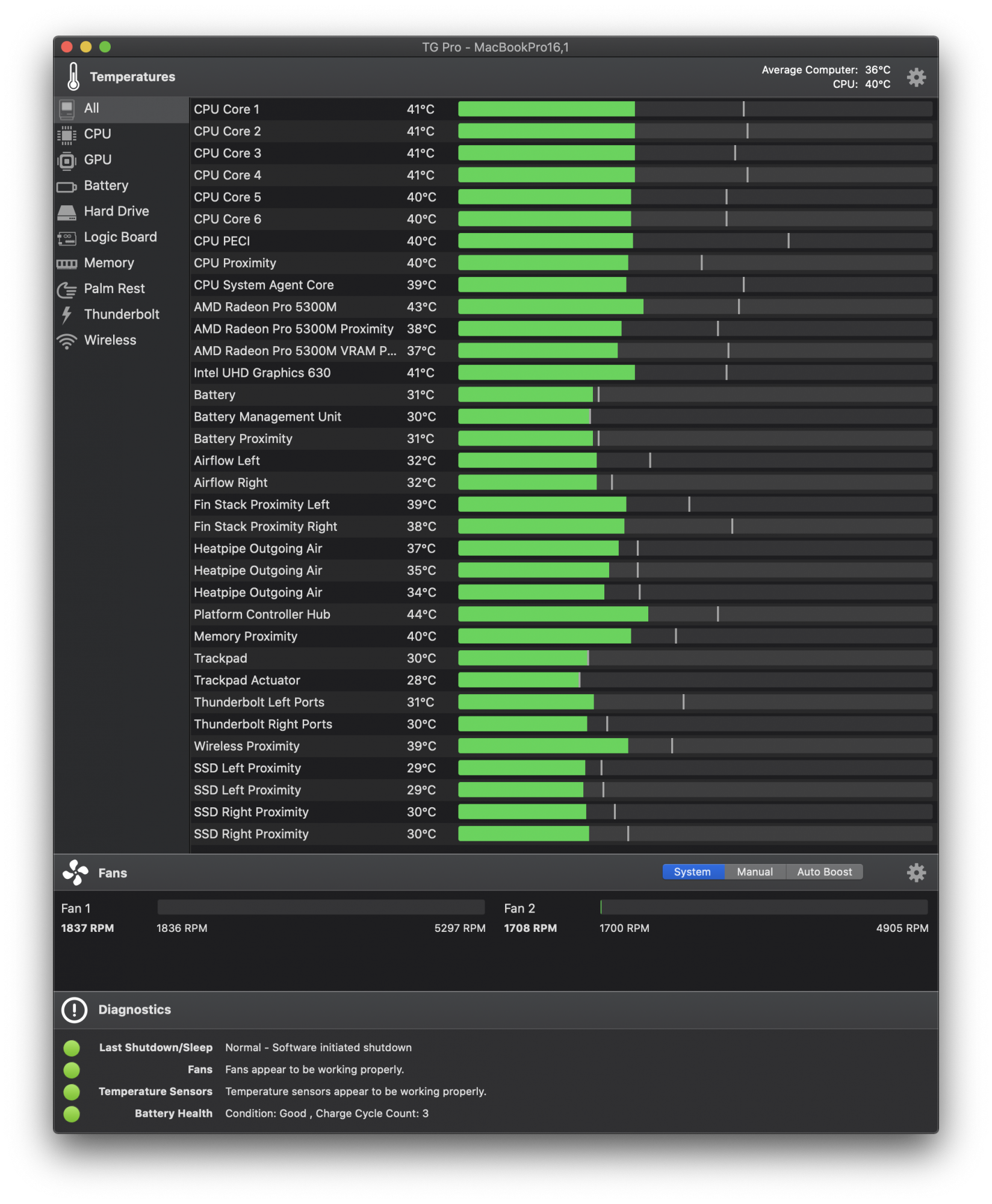

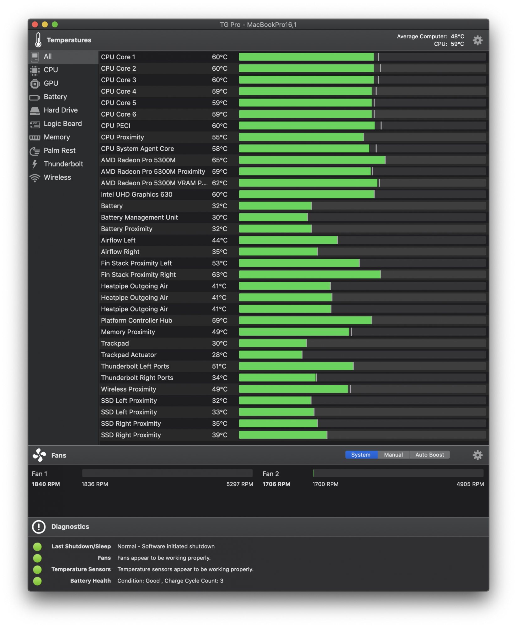

Idle temperatures with and without a single USB-C connected 2560x1440 display.
MBP 15" 2015 definitely had much lower temps when idling with connected display. I would expect lower temps considering the newer internals in MPB 16" not vice versa.

View attachment 888125View attachment 888126
Yeah looks absolutely confusing on why this happens as soon you connect an external display. I mean it doesn't make any sense for it to increase 20c.

I tried different solutions besides using the laptop only in clamshell mode when connected to my 4K monitor.
  1. I connected the laptop directly to the 4K monitor via a USB-C to USB-C cable or a USB-C to HDMI cable and used the apple charger.
  2. I connected the laptop to my cal digit TS3+ thunderbolt 3 dock and then to the 4K monitor via a USB-C to HDMi cable or a Displayport to Displayport cable.
Even in mobile mode when on battery the fans go crazy when some application like the epic game launcher force the AMD GPU to turn on. The only time when I really like the laptop is when I use it mobile and it stays on the Intel GPU.
Nothing helped to alleviate this. I am also sad that I have to use clamshell mode to prevent the fans from going really nuts. I would be happy to being able to use the quite big 16" MacBook Pro display as my secondary screen besides my monitor which I sadly can't at the moment.
