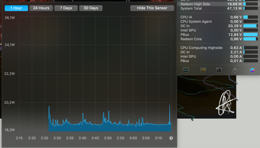

I have a Dell U2518D and it still pulls 18W in clamshell mode. 2560*1440 @60 HZ with HDMI cable connecting through the Twelve South StayGo hub. My usb-c to hdmi and usb-c to DP cables are on the way, and will test if that makes a difference.

Nice! any chance you could share some wattages for the GPU when you have it running with different loads and open vs clamshell mode?

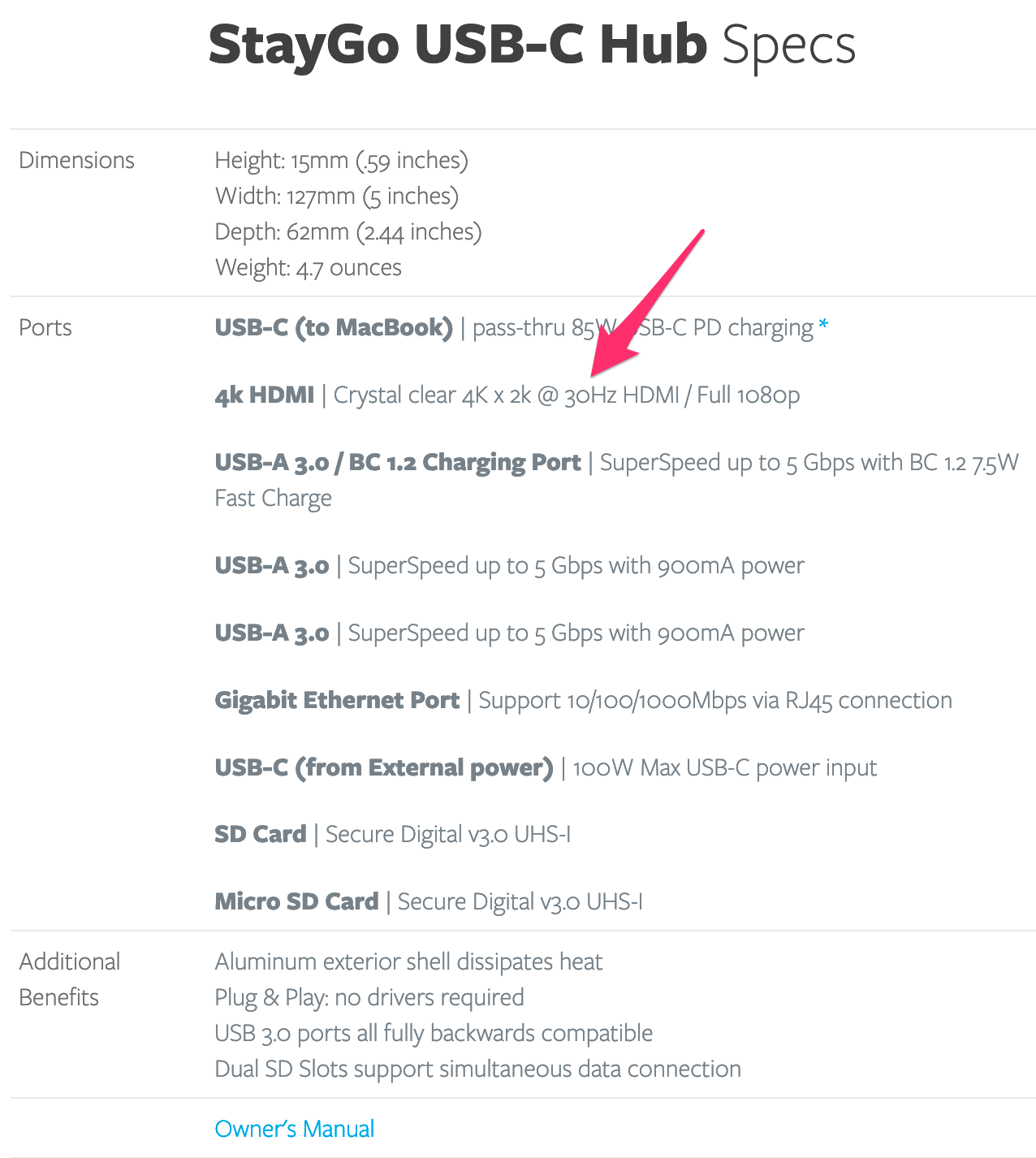

Note that the "Twelve South StayGo hub" only seems to support "Crystal clear 4K x 2k @ 30Hz HDMI / Full 1080p" (not 60 Hz).

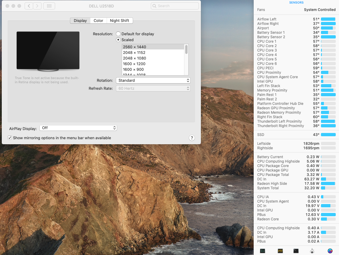

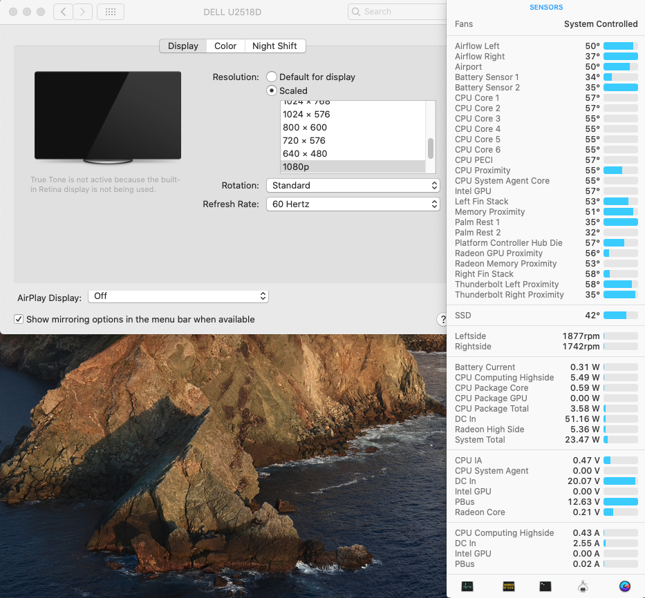

Yeah but the display shows it's running at 60hz, and I've seen other people reporting clamshell still heats up at 2560*1440. Also interestingly, if I change resolution to 1080P, it only pulls 6~7W as you observed on your 4k monitor. Pics below, but I think it might worth for you to change resolution to 1440 and see how it impacts the GPU power.

@Spartan23R
Thanks for sharing the details above.
- Could you please post another screenshot that shows your fans' RPM readings?
- Do you use custom fan profiles (example here)?
Please note that your "Radeon High Side" reading is ~19-20 W which is what the rest of us are complaining about - prolonged use with ~19-20 W Radeon dGPU in open-lid mode easily drives the fans to ~4200-4500 RPM.

I played around a bit more with the resolution settings on my Dell P2415Q following your reply. Please note that the following results are with 30 Hz, Retina (2x), and in clamshell mode. My 2015 model P2415Q doesn't have HDMI 2.0 - so no 60 Hz for me over HDMI.
  • 2560 x 1440 @30 Hz actually draws ~19-20 W on my Dell P2415Q too - this was rather unexpected for me.
  • 2560 x 1440 @24/25 Hz draws ~6-7 W for me.
  • 3840 x 2160 @30 Hz draws ~6-7 W (previous result posted here).
I'm using EasyRes to change the resolutions and refresh rate.
I have noticed that after changing to a 30/25/24 Hz resolution in EasyRes, if I change "Scaled" resolutions with Mac's display preference, it will switch resolution, but not refresh rate e.g. change from "Default" to "More Space" in Catalina system preferences, and then crosscheck in EasyRes, you'll notice that the upper/lower resolution has been selected but the previously selected refresh rate persists.
Secondly, it takes a little while for "Radeon High Side" to drop from 19 W to 6 W e.g. waiting around 1 minute has been sufficient for me.

Updated clamshell info.
2560x1440 @60hz or 30hz is a problem even in clamshell mode. Can currently only be fixed if your monitor can support higher or lower refresh rates @themcfly confirmed this earlier in the thread on his own setup but I think at this point there's enough supporting evidence from others.
Connection method does not seem to make any difference unless it opens up extra working resolutions/refresh rates.
For the most part most gaming or modern monitors outside of the Dell U-Series have some sort of variable or higher than 60hz refresh rate. I believe Freesync allows this so that may be something to look for.
If anyone has found any other problematic combinations please post them. I believe there are a few other "bad" configurations.
Possibly running 2 monitors with different refresh rates could cause issues even if fine by themselves. I've seen at least one post that would suggest this.

I did some testing with EasyRes on my LG 4K 27UL850-W, connected with a usb-c to usb-c Cable. (clamshell mode)
For some reason I had 3 options of the problematic resolution of 2560x1440 in the "Standard (x1)" category, two options with 60hz and one with 30hz.
-2560x1440 60hz: Worked fine, 4,3-5W idle (System Report showed 2560x1440 @60Hz)
-2560x1440 60hz: Resulted in 18W Radeon High Side (System Report showed 2560x1440 @59Hz)
-2560x1440 30hz: Worked fine, 3,8-5W idle (System Report showed 2560x1440 @30Hz)
So maybe those of you that have problems running 2560x1440 monitors actually use 59Hz instead of 60Hz?
Please double check in System Report and always close and reopen it after a resolution change, it will not refresh by itself.
Edit: Connection type is called "Thunderbolt/Displayport" in System Report.

Another interesting find: while using a usb-c to HDMI cable with the same Lg monitor as mentioned above, I get some different numbers. (again tested in Clamshell mode)
There are 5 Options of 2560x1440 in "Standard (x1)" of EasyRes, one with 60hz, 50hz, 30hz, 25hz, 24hz
-2560x1440 60hz: Resulted in 18W Radeon High Side (System Report showed 2560x1440 @60Hz)
-2560x1440 50hz,30hz,25hz,24hz: all worked fine 4-5W (System Report showed the same in all cases)
Typ of connection shown by System Report: "DVI or HDMI"
-3840x2160 with usb-c to hdmi: same 5 different refresh rates, all worked fine 5-6W
-3840x2160 with usb-c to usb-c: 60hz and 30hz both work fine 5-6W
edit: conclusion for 2560x1440 60hz: in my case Displayport/(usb-c) connection seems to work ok 4-5W, HDMI connection results in 18W Radeon High side.
