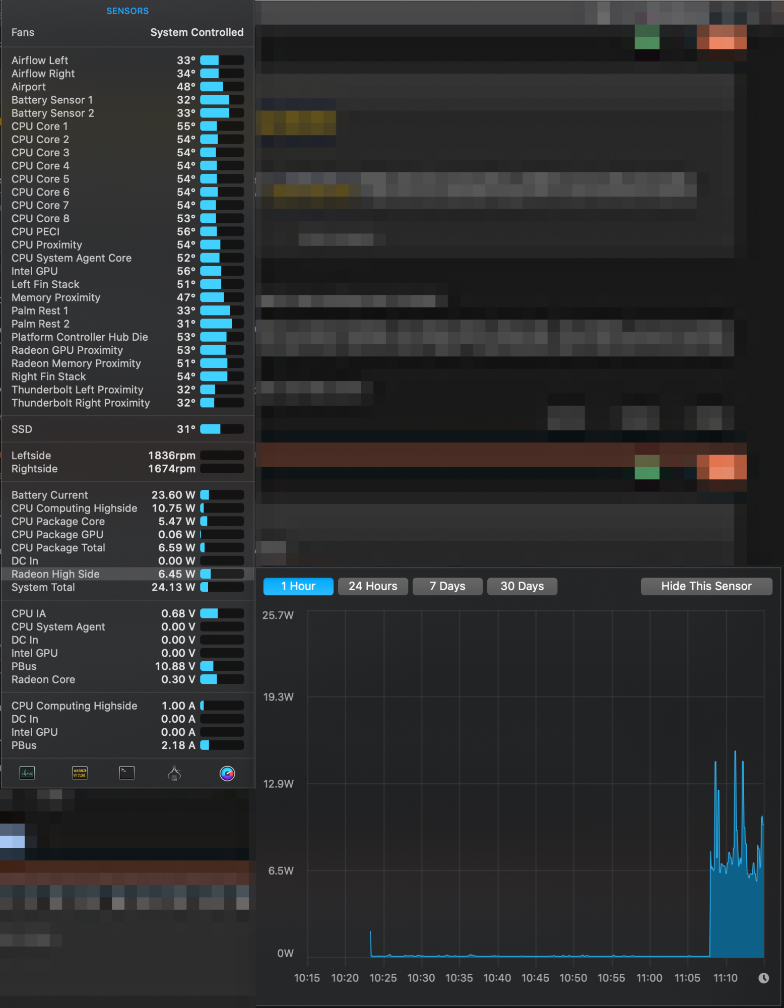

If you have iStat installed, I'm wondering what the value of "Radeon High Side" is when you are connected through the eGPU.

Are you saying that the Radeon GPU chip drawing ~19W immediately after connecting an external monitor to the MBP-2019 in idle mode is a normal behavior?
If yes, I think you are about to find most of the people on this thread in disagreement with you.

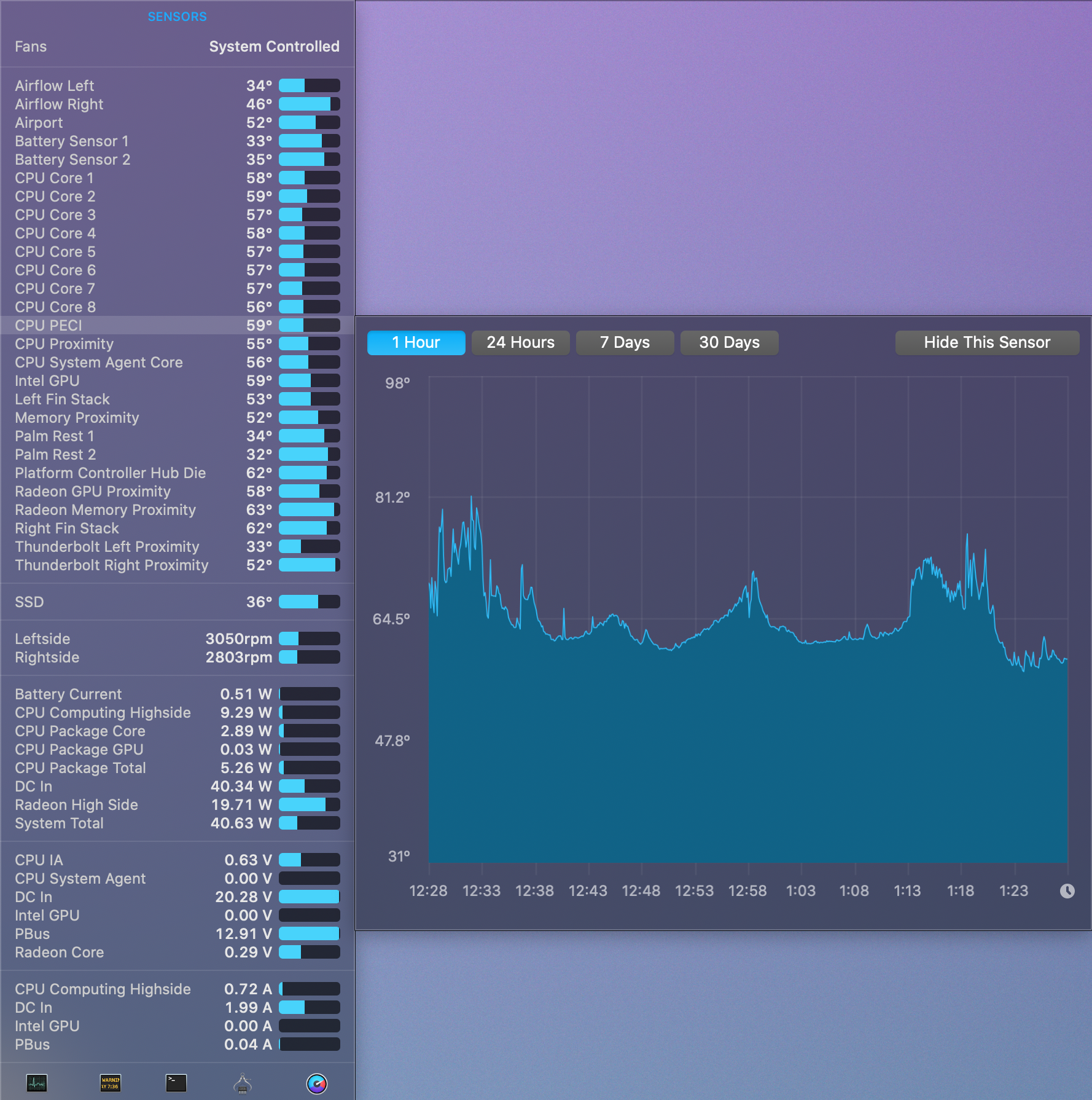

## Disabling CPU Turbo-Boost in Catalina 10.15.4
Folks,
I have some positive (but no less shameful) results to share - it looks like if I disable Intel CPU turbo-boost in Catalina 10.15.4 final, the overall temperature stays around ~60-62 C, and fans stay around ~2800-3000 RPM in open-lid (non-clamshell) mode with my Dell P2415Q 4K external monitor.
The fan noise feels reasonably bearable on my end for the time being. Some additional notes below:
  • Radeon high side temperature is still at around ~19-20 W
  • I'm using Turbo Boost Switcher to enable/disable Intel CPU turbo-boost
Hope this helps. Thank you.

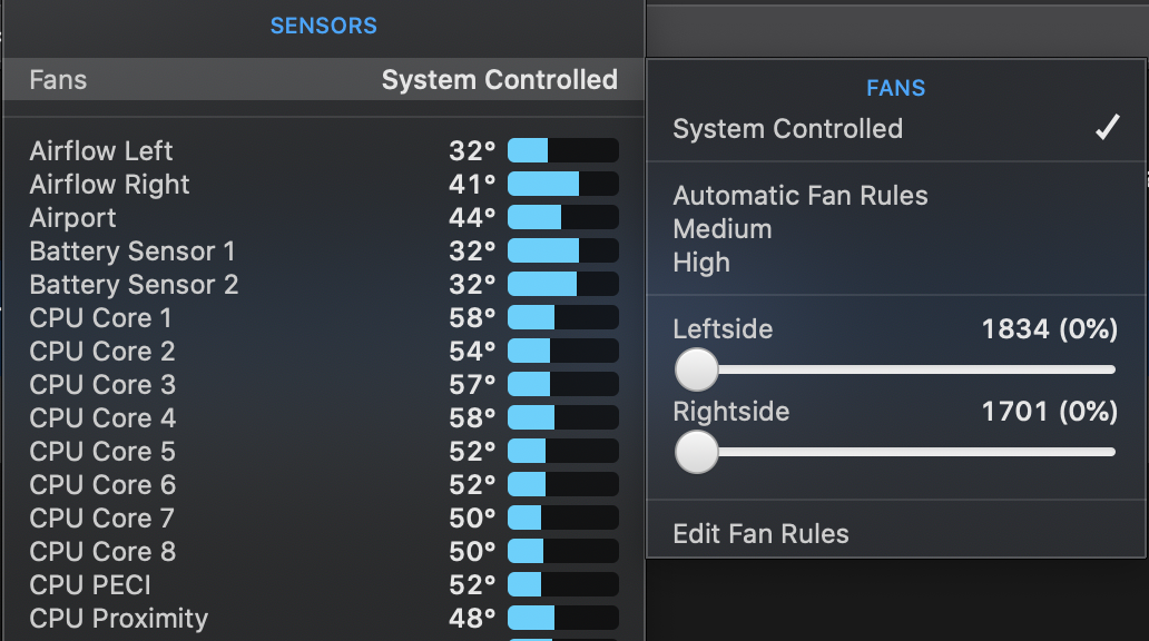

Did you modify your fan profiles? For example, you could change them with iStat Menus (screenshot below).
Please let us know. Thank you.

Yes I’m using manual control at around 30% latest iStat version
Thanks for confirming.
Could you please share a screenshot or some more details so that we can see the kind of custom fan profiles you are using?
Thank you.
