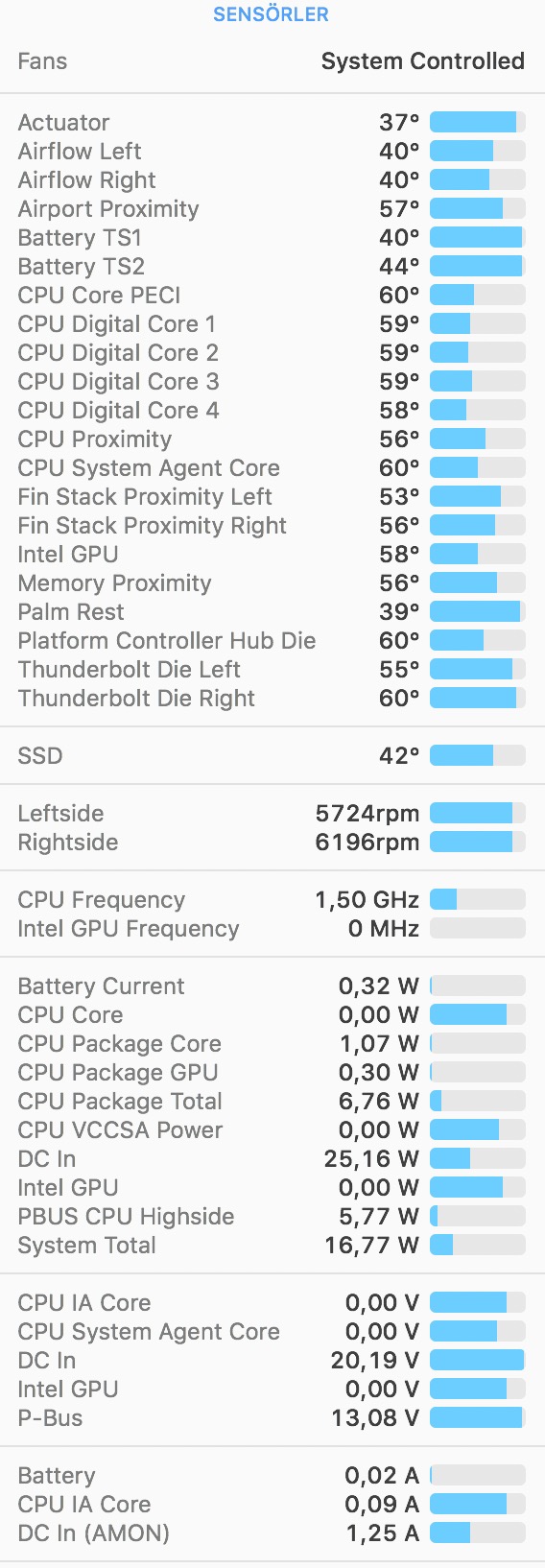

My MacBook Pro 2019 13” with 4 thunderbolts gets crazy, fans are full blast 6000 rpm when I connect it the this monitor. I chatted with apple support and they say it is because of the monitor. I tried to connect it my 55” Samsung tv and it is very normal. What could wrong with the monitor and what can I do to resolve it?
That's worrying to hear! What kind of monitor is it and what kind of connection/adapter did you use to connect the monitor and TV? Presumably the TV is 4K? What resolution is the monitor?
monitor is SAMSUNG 28" UR550 UHD 4K I tried all resolutions (mostly 1920x1080, current is 2560x1440). Monitor is connected via type-c to display port cable. and yes tv is samsung 4k.
Doesn't sound like an overly unusual setup. How did you connect the TV as I'm guessing it won't have a displayport input. HDMI adapter of somekind? Does your Samsung monitor have an HDMI input you could try to see if that's reduces the fan noise?
Are you using the laptop open in dual display mode or closed/clamshell with the TV/Monitor as the only display?
I connected to TV via hdmi cable. and after that I tried monitor with the same hdmi cable but result didn't change. I use the macbook clamshell mode.

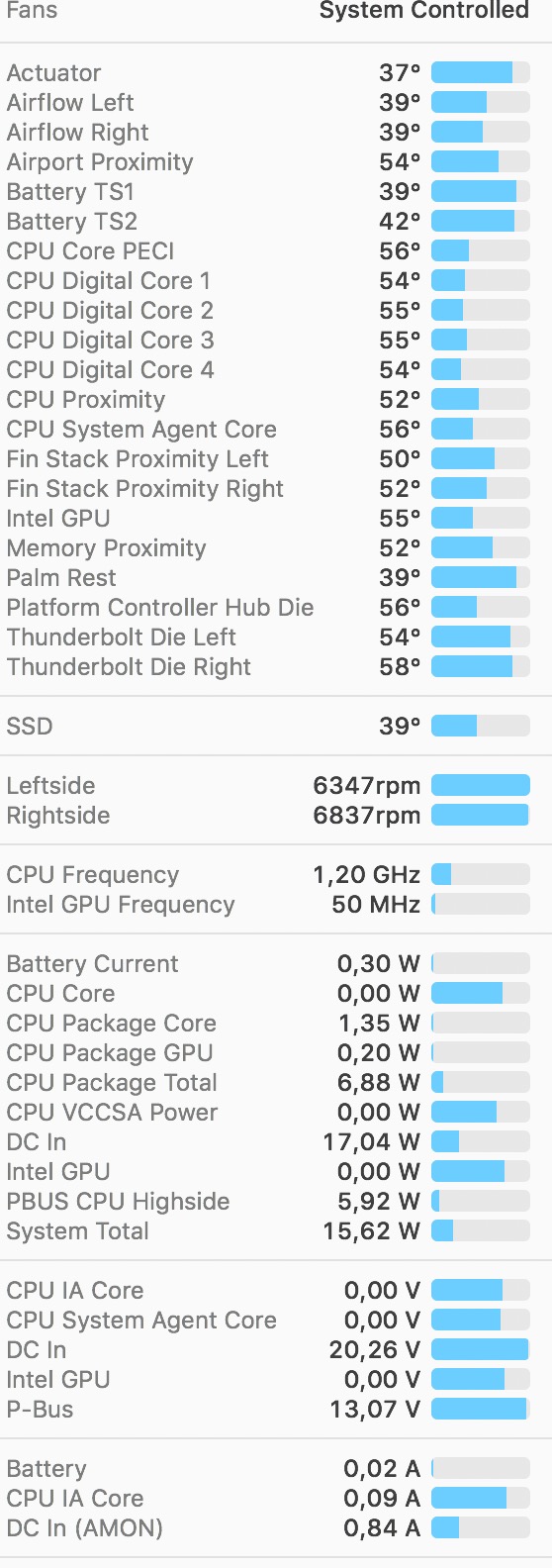

How can I understand which part is make cause the fans run at 6800 rpm?
It's odd that would happen especially in clamshell mode where it's only driving a single display so the load should be lower? Does it happen as soon as you plug it in or when running certain apps?
I can't understand why there would be a difference between two different monitors connected using the same cable with the same resolution? Are they both 60Hz monitors? Would changing the refresh rate make a difference?
